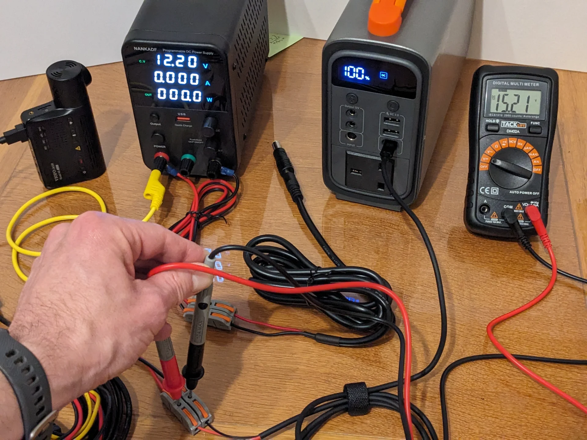

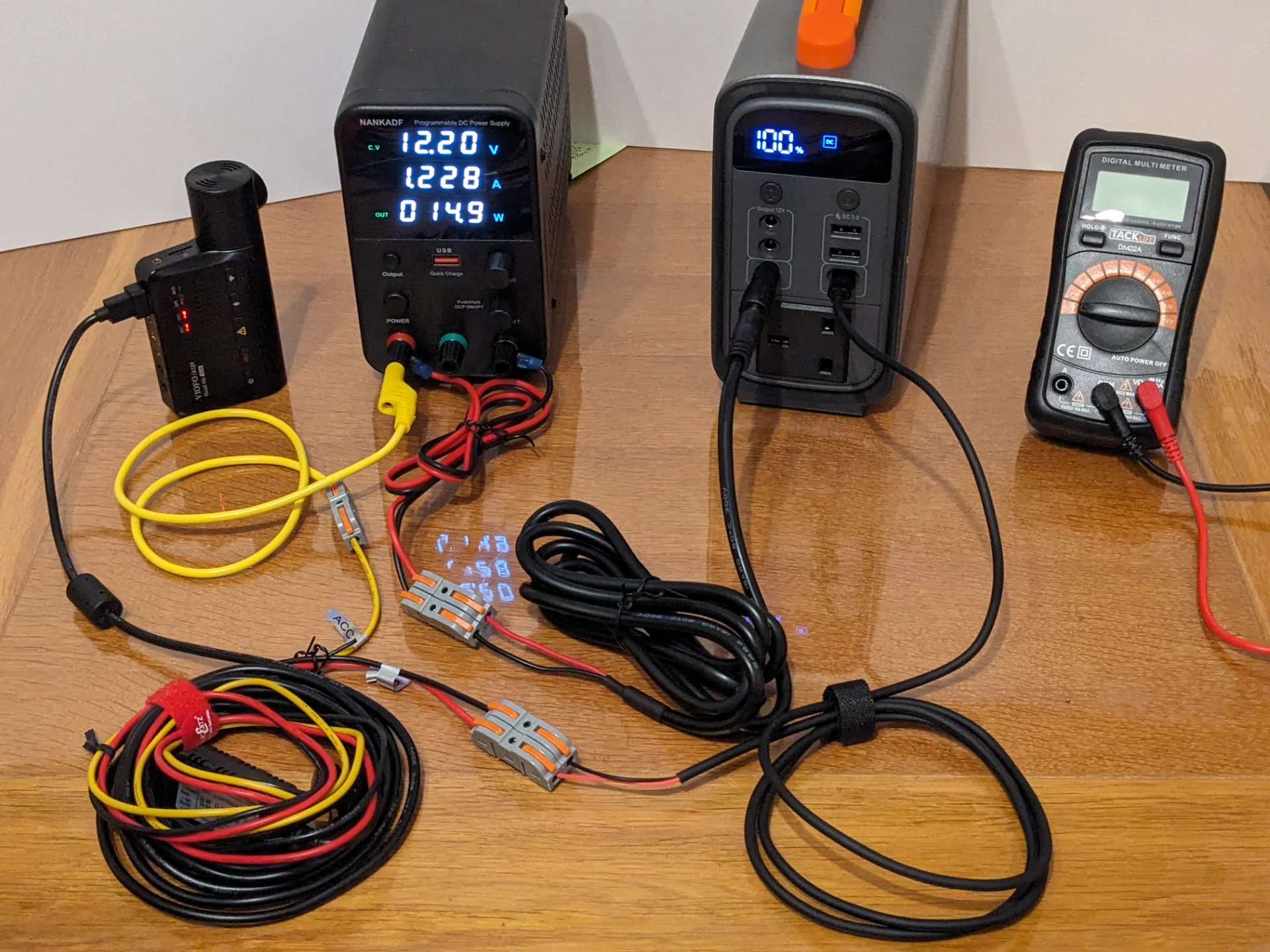

My bench test setup is working so far, following the diagram in post 301. I'm using a USB-C to 15V connector from my CTECHi GT200 320Wh power station to Viofo HK3-C, powering the A139.
Parking mode switching is working as expected when turning the ignition on and off.
On work days I don't drive much, just 10 minutes to the office then park for 9 hours. So I was planning to charge the power station at home rather than in the car. However, during further bench testing I found that if I unplug the charger cable from the PS, the dashcam does not turn on with the ignition, even if I turn on the PS manually. I checked and there's 15.2V going from the PS to the HK3-C, but no 5V out to the dashcam.
Reading some earlier posts it sounds like this might be a grounding issue? But my electronics knowledge is not great so I'm really not sure what is happening.

However, during testing I found that if I unplug the charger cable from the PS, the dashcam does not turn on with the ignition, even if I turn on the PS manually. I checked and there's 15.2V going from the PS to the HK3-C, but no 5V out to the dashcam.
You must connect the charging cable.
Without the charging cable, there is no ground for the yellow signal, i.e. the circuit is open (incomplete), and HK3 without yellow signal will not turn On the dashcam.

Sorry for not being clear. This is just on the test bench. It works well when the charging cable is connected. It does not work without the charging cable. I see GPak has figured out the problem.
