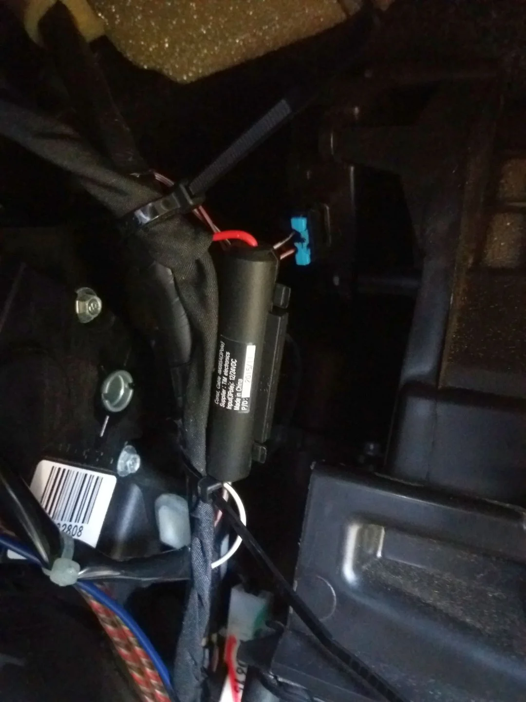

Fuse holder hidden behind glove box,All connections made behind glove box as well.
