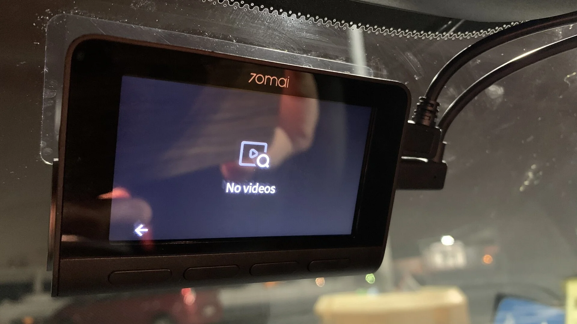

after shaking, hitting the car and windshield...

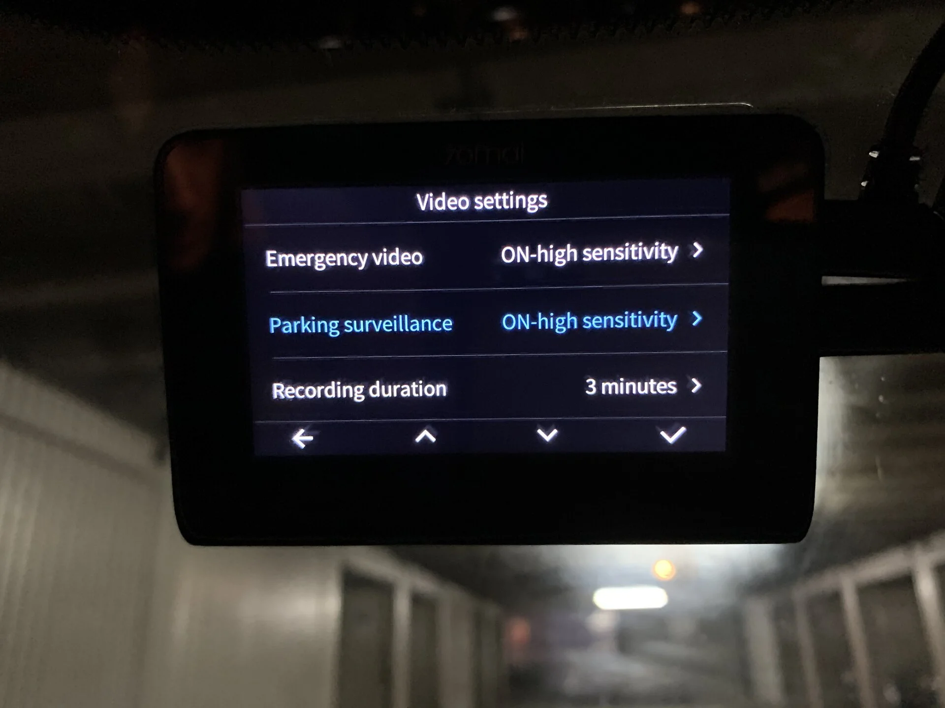

I am reading in other forums that setting could be the issue?
About the high sensitivity/low? Maybe is the way arround and need to be on low?
anyone can help?
Does anyone know how to make the sensor more sensitive?
