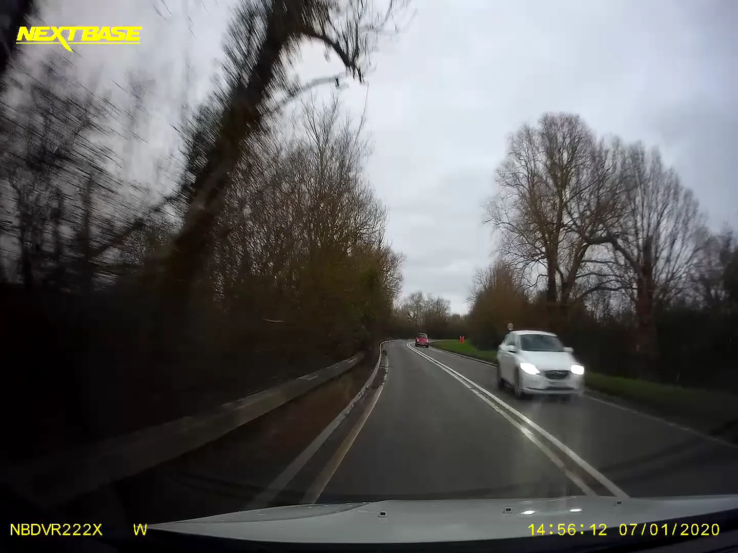

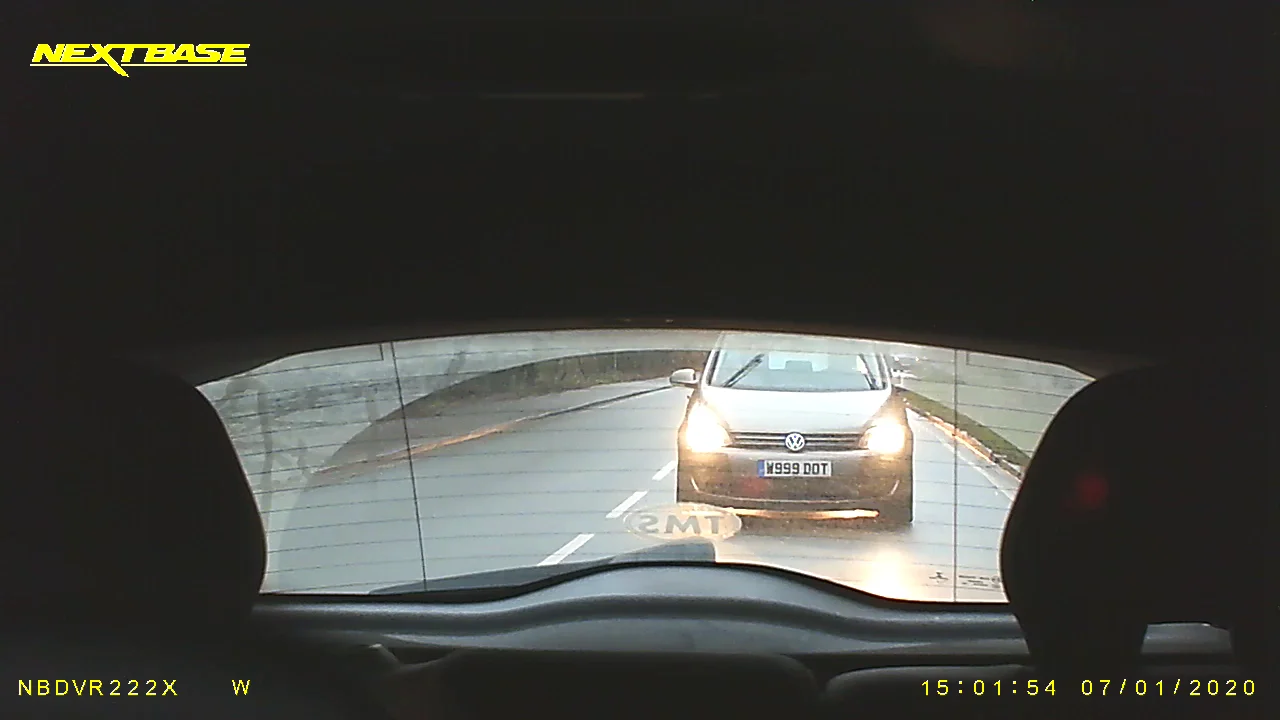

Greetings.
I purchased the 222x as it was a bundle, front and rear cam.......both attached at the front with the rear one next to it working on a 30 degree telephonic lense. Front 1220 and rear 720. I actually think the rear cam is much better at capturing number plates whereas the front
one really struggles unless I am up very close. Is this normal?
I bought a CPL filter. Don't know if I am doing something wrong. I have a sandisk U3 32GB memory card. Any suggestions?
Placing of the camera is very limited as I have a Volvo and lots of plastic because of the city safety system so at present it is to the passenger side right mirror as far across as I can get it, baring in mind I also need to have it positioned so the rear cam can look through my back window.
See some screenshots taken from the Nextbase player app.
many thanks
Thomas. 200107_145544_002_FR.MP4_30086.png200107_150145_004_RE.MP4_11983.png200107_151044_007_FR.MP4_88865.png

Use CPL = reduce light = worsen motion blur = harder to read plate
From your pictures, cars behind you likely moving at the same speeds as your car while cars in front of you not, so it's not strange for front cam to not capture plate.

I thought CPL was suppose to help with reflections hence reading plates better?
I could adjust the exposure, that is set to 0?

It makes the picture look cleaner, but reduces light which means reducing shutter speed at the same lighting condition, hence more blur images. Also with CPL night time picture will look darker. It's a trade-off.
Adjust exposure may be help but will make image darker.
You can also reduce reflections without using CPL.
