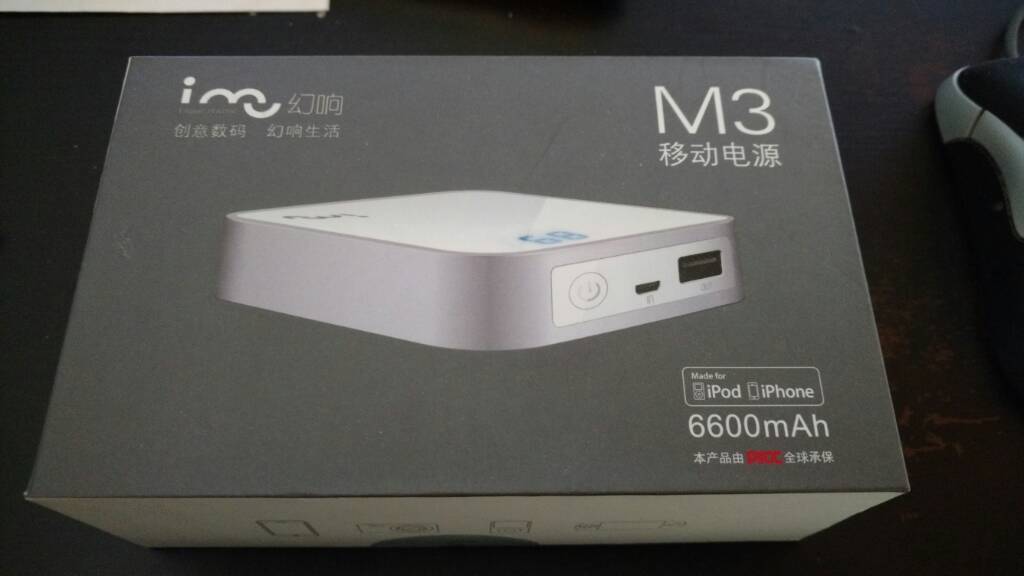

I think the problem has more to do with the power bank, some power banks have no intelligence to them and if they don't see a significant load draw they shut off as they assume the connected device has finished charging, I think I've got one cheapy power bank here that does that but the rest of them (I have around 10 different models) all power any dashcam I've connected without any issue
@jokiin : Hi, can you give us some names of the ones that are working OK? I am looking to buy one to power my two dash cams at the same time. Thank you.
most of the ones I have aren't branded, the best one I have is a Chinese brand but don't know if they sell it anywhere else, I have each model of the Xioami power banks and they work fine also
This is the one I like best, not sure if one of the Chinese sellers like @GearBest can get these but I'd recommend them for sure, very high quality
I have used an Anker Astro E5 and E7 as well as a Jackery Giant+ to power a JooVuu X on my hat with no issues.
Thank you @jokiin and @DT MI and @CheckYourLights I will look for xiaomi since the other ones mentioned I can not find on Romanian stores. I also need to have at least 12 months warranty. Keep well
