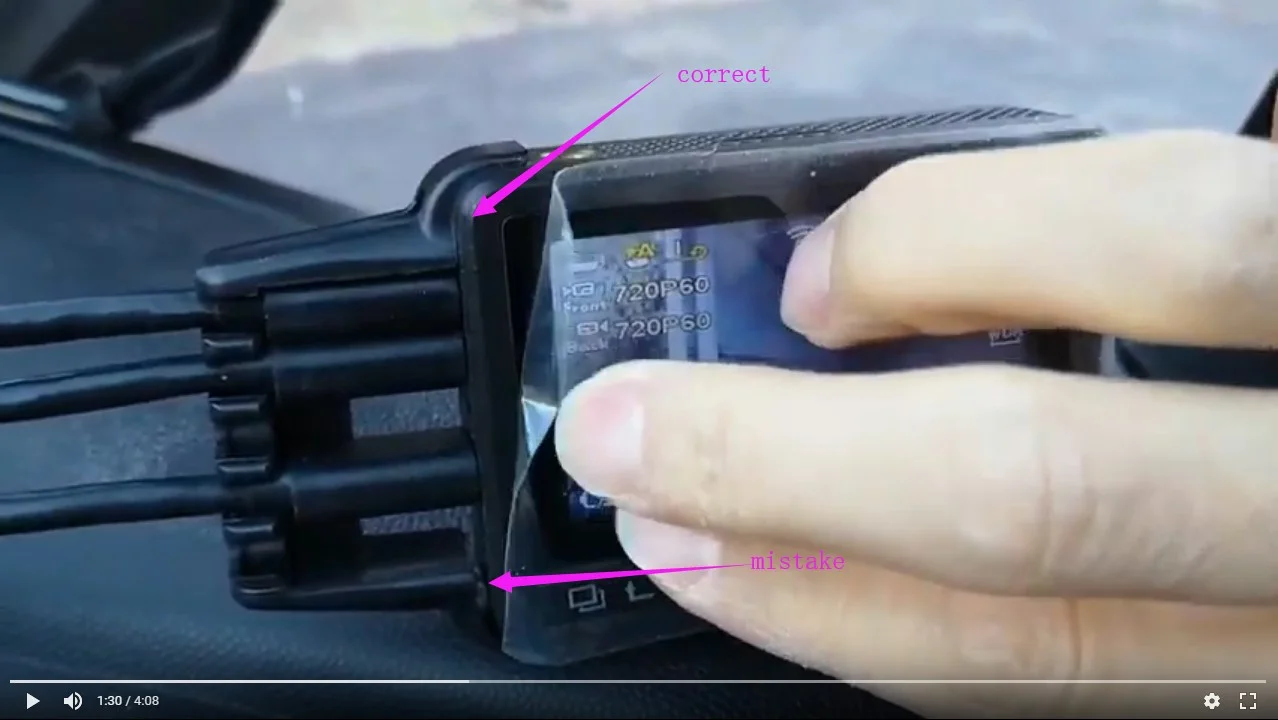

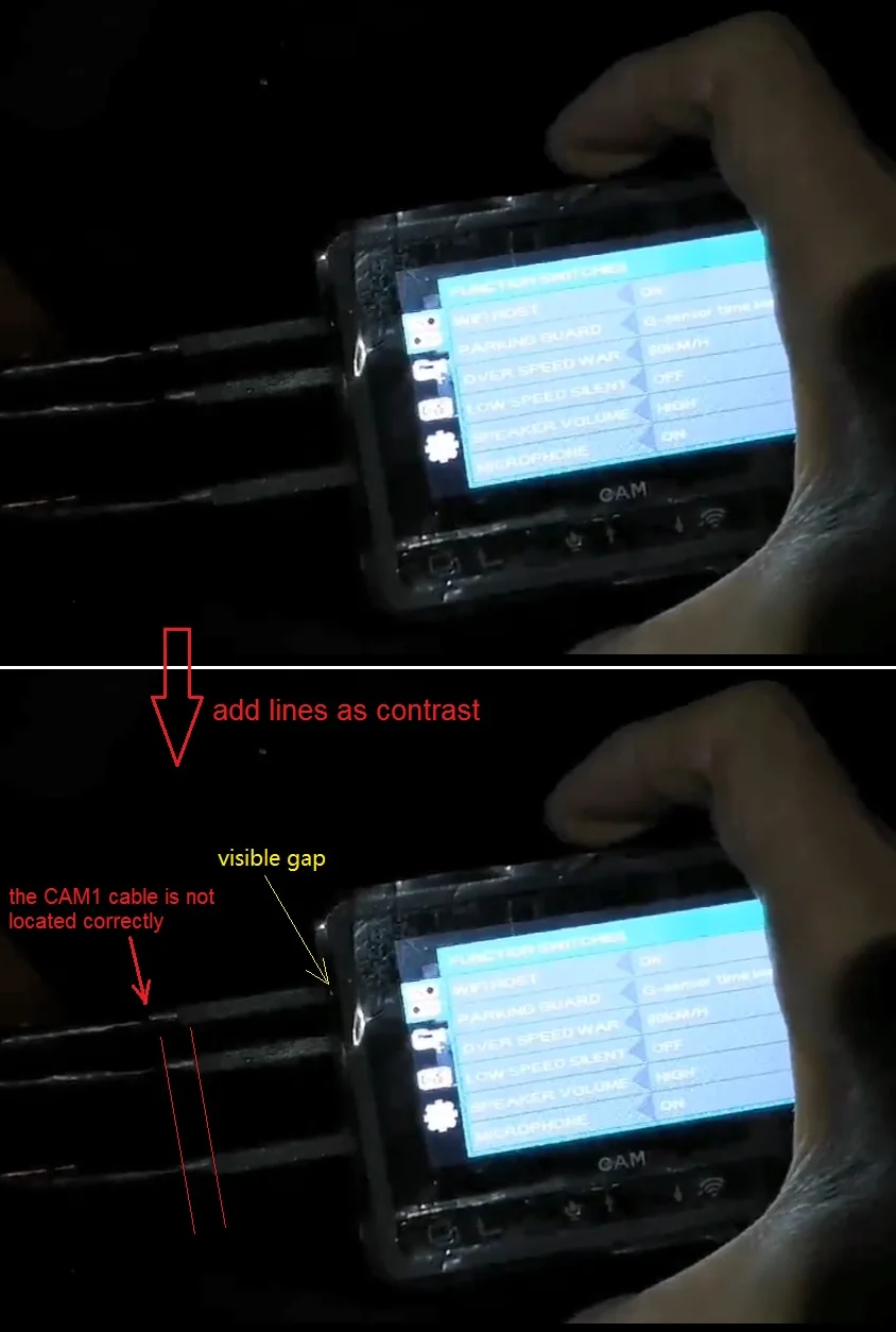

Manufacturer and seller opinion
The camera was tested very careful and several times, sensor is not so easy to have problem.We still think that the issue is the connection
