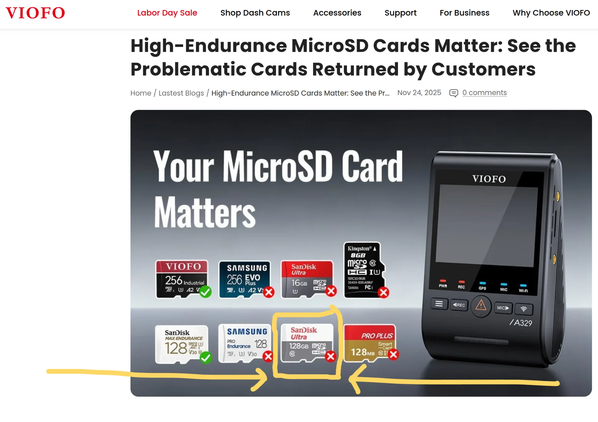

My A329S keeps giving me an error message about needing to format the SD card. This occurs when the car is parked in hot sun for a while (I'm in central FL). The card is formatted - and even if I select "format card" in the app, it just fails. The body of the camera gets very hot (hard to hold). Once it cools off it works fine again. It does not fail every time - but it has now done this 3x. Is there a known problem with this camera operating in hot environments?
The SD card is a Scandisk Ultra 128GB.
The camera is about 3 months old on firmware VIOFO_A329S_V2.0_260104.
Is there some type of heat shield I could put around the camera? Has anyone done this?
If you would like to update to the latest firmware it’s HERE
Or you can also update OTA, but you need to have the latest version of the smartphone APP.
To make sure you have the latest smartphone APP it’s easier, and faster to delete it, and re-install it.
