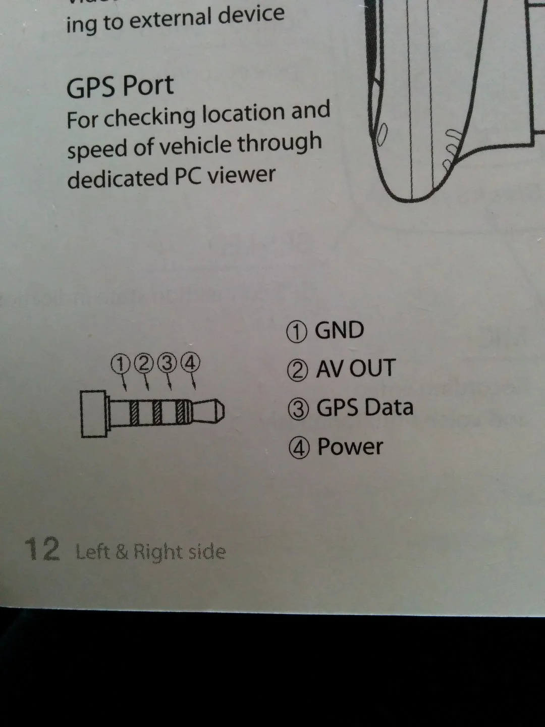

Have you made sure the 3.5mm jack you're using to plug into the camera matches the pin-out of the camera itself? Just because the cable you're using fits the socket does not automatically mean it is compatible, unfortunately. I've attached a photo of page 12 of the manual:
It shows the rear camera in a PIP window so aiming isn't a problem. The pinout did not match the generic AV cable I bought. I had to rewire an adapter to swap the signal and ground pins.
