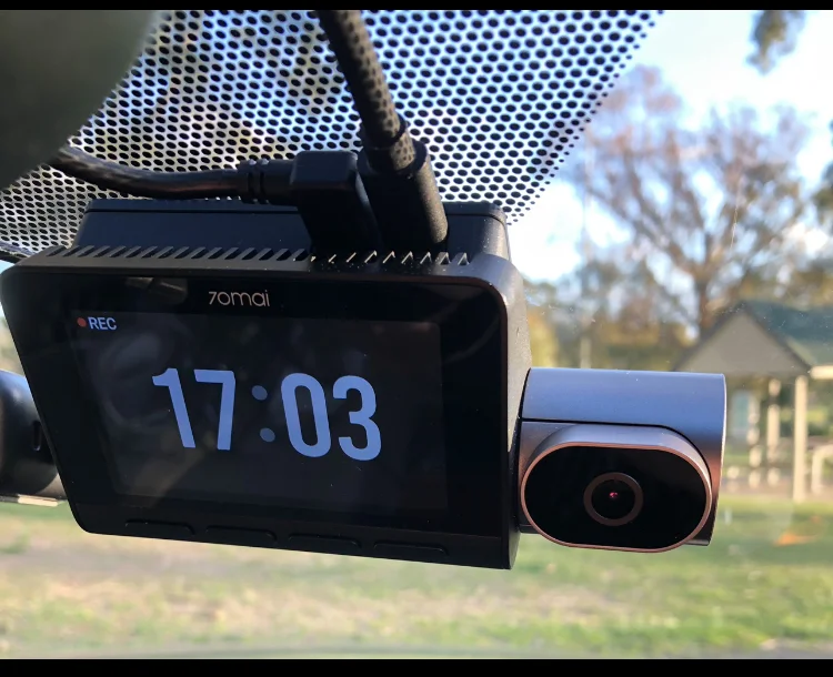

70mai confirmed in Kickstarter that you can use either end of the rear cam cable. Planning to do the same when I get mine.

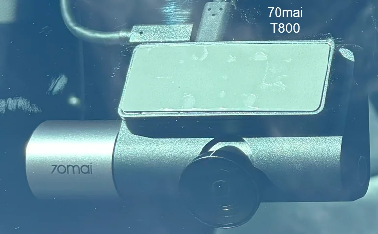

Note that a problem using the straight end in the front camera could be that it interferes with the power cable that also have a 90degree bend and is designed to bend above the camera cable.
I have the power cable 90-degree bend at the UP05 LTE module end of connection. I plugged the straight USB-C power cable connector into the T800 kike it shows in the T800 user manual.

I thought so too so i reversed my cable but for me it works fine.
Is it possible that the plug isn't seated completely? Check the cable is plugged in all the way and is squared off to the T800
With the cable in reverse for testing.
