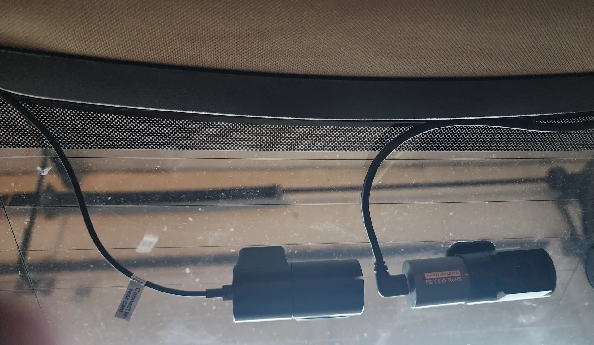

On the right is the N5S and left is the Viofo A329T rear camera. @VIOFO-Support @viofo
I'd recommend Viofo make a Right Angled Cord for Rear Camera. Or make an accessory that attaches to cord to turn it into right angle for existing installs.

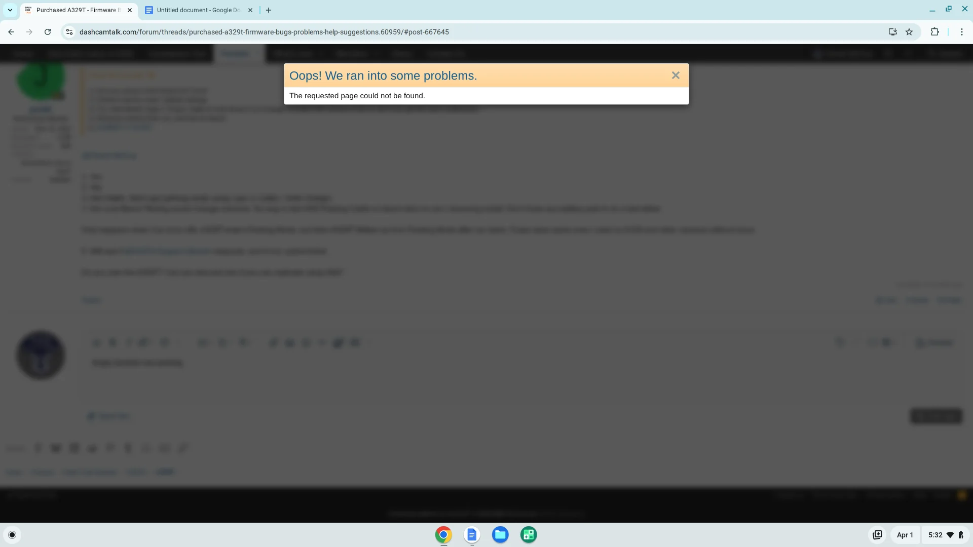

Reply function not working.
No to right angle cords. Thats a good reason why we do not install Rove and some Vantrues for that very reason.
