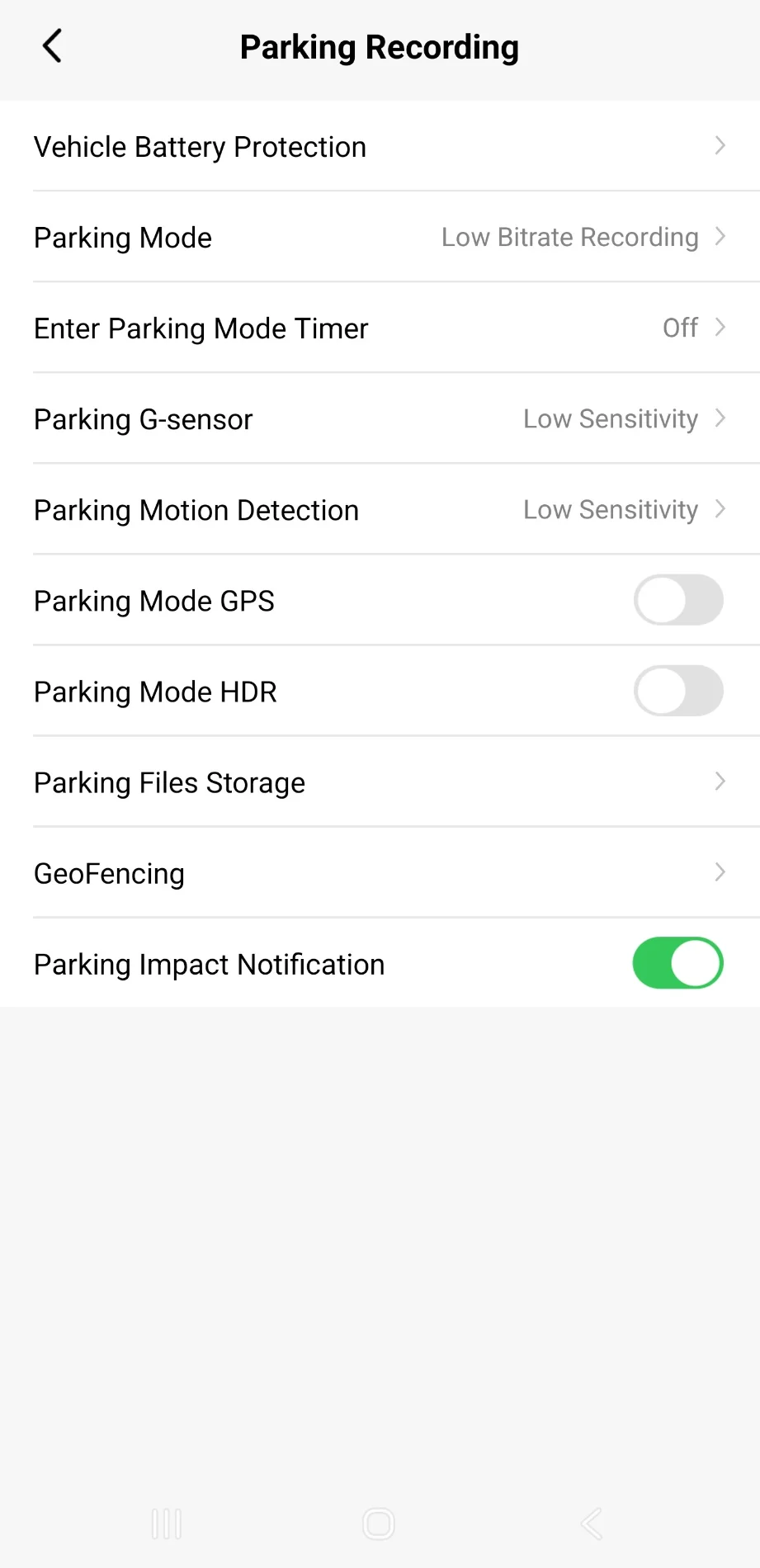

First of all there are (2) two G-sensor settings.
One is intended for normal recording mode while driving, and the other is for Parking recording mode.
The G-sensor for normal recording while driving can be completely disabled (set to "OFF"), however there is No OFF setting for Parking G-sensor, only "Low", "Medium" and "High".
Here is what I tested:
- If Parking G-sensor set to "High", it reacts to any—even the slightest—jolt (including pressing the three-line button, no matter how carefully I attempt to do so), which wakes the screen and a "Yellow Triangle" icon appears on it with a snapshot sound.
- If the Parking G-sensor set to "Low," it does not react to pressing the three-line button; in this case, the screen simply turns on, but without the "Yellow Triangle" icon appearing.
- If the Parking G-sensor set to "Medium", the reaction depends on how hard I press or shake the camera.
- Turning on the ignition (without starting the engine) never resulted in the appearance of the "Yellow Triangle" icon.
So, if you have set the Parking G-sensor to "Low" and the "Yellow Triangle" still appears, then either, your firmware may be installed with some error/glitch or your camera is defective.

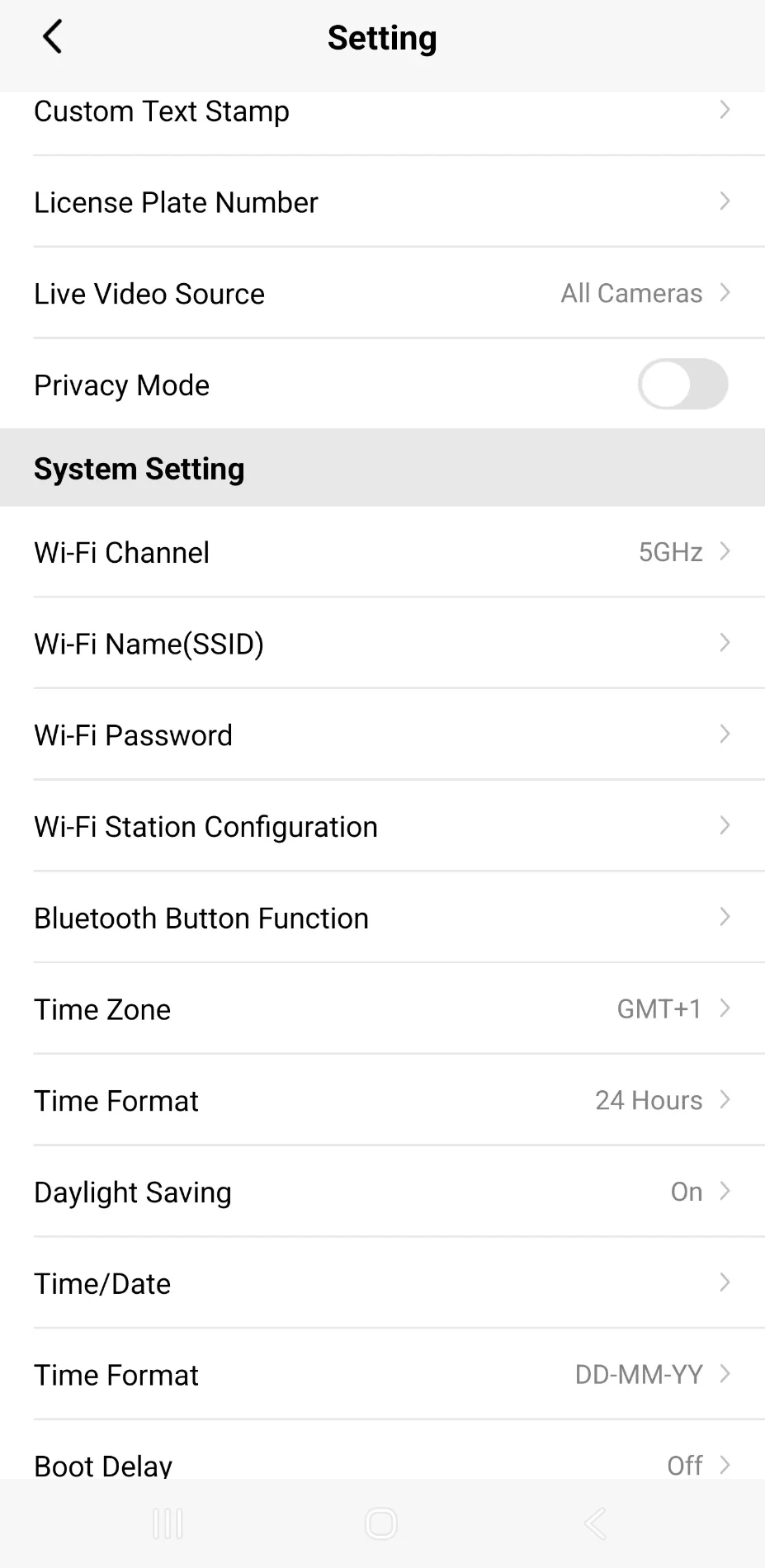

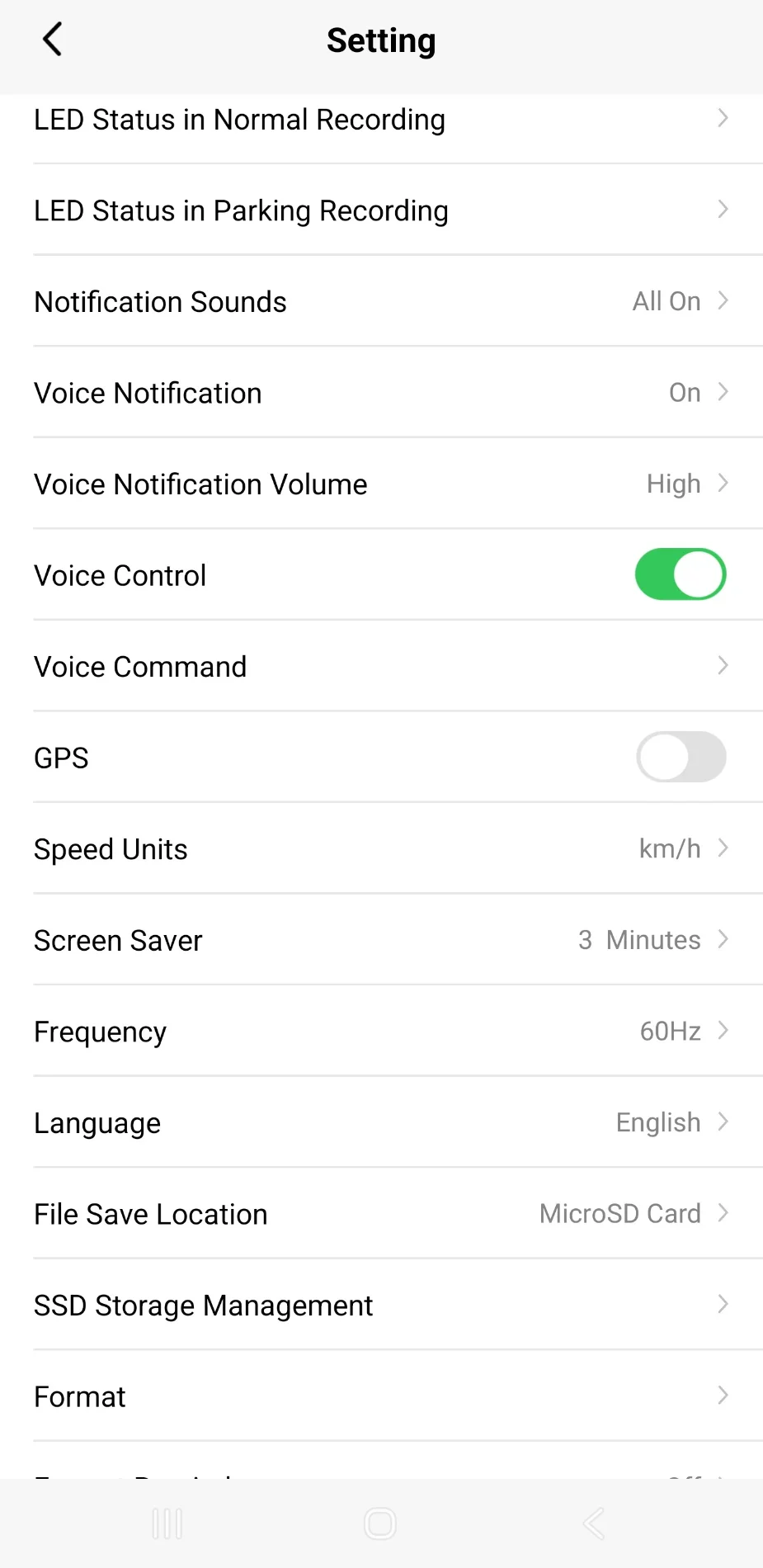

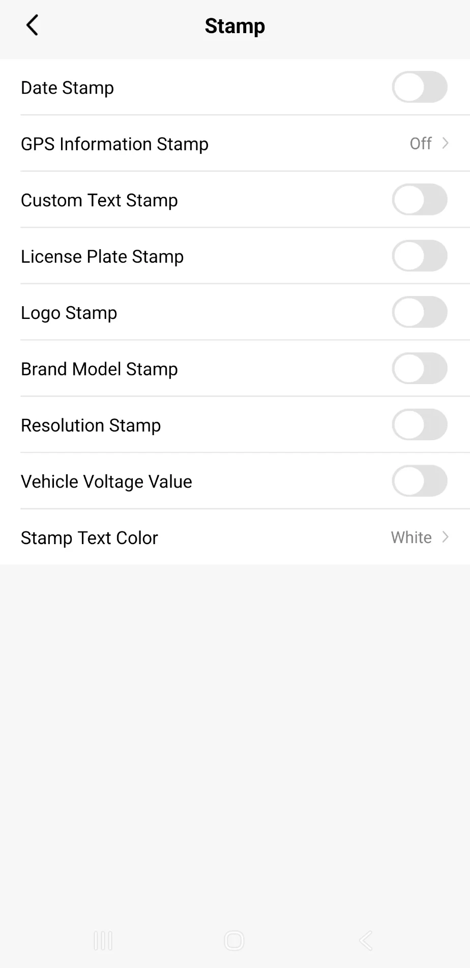

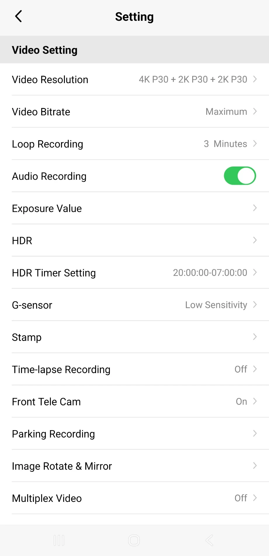

Here are the current settings on my A329T as requested. If I forgot something, let me know. Thanks.
Based on your answers it looks like the flickering is due to low ambient light levels, (light metering hunting).

@jsmith
Thank you for the screenshots, I think we are getting close.

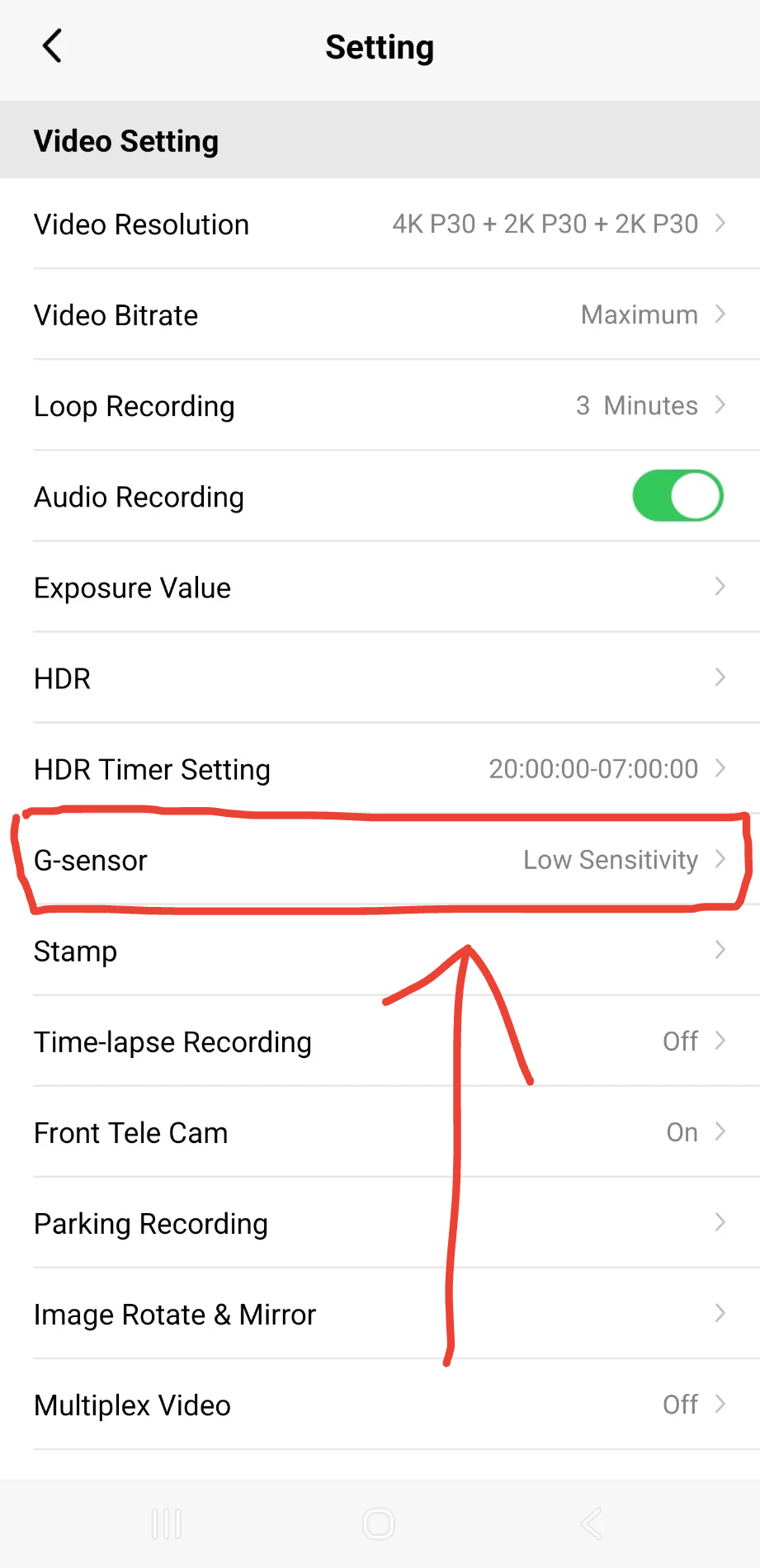

1.) DRIVING G-Sensor
In Post #44 @GPak said there are (2) “different” G-Sensors.
a.) One for driving / normal mode
b.) One for parking mode
You have DRIVING G-Sensor set to Low Sensitivity it "should" be set to “OFF”.
Can you set it to OFF, and see if that fixes your issue?

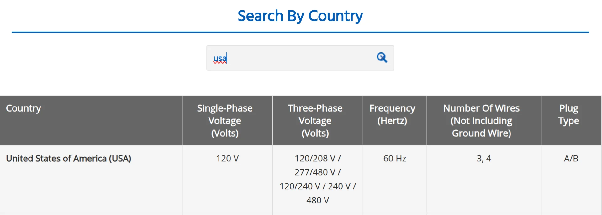

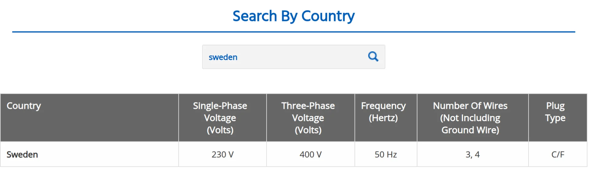

2.) Flickering

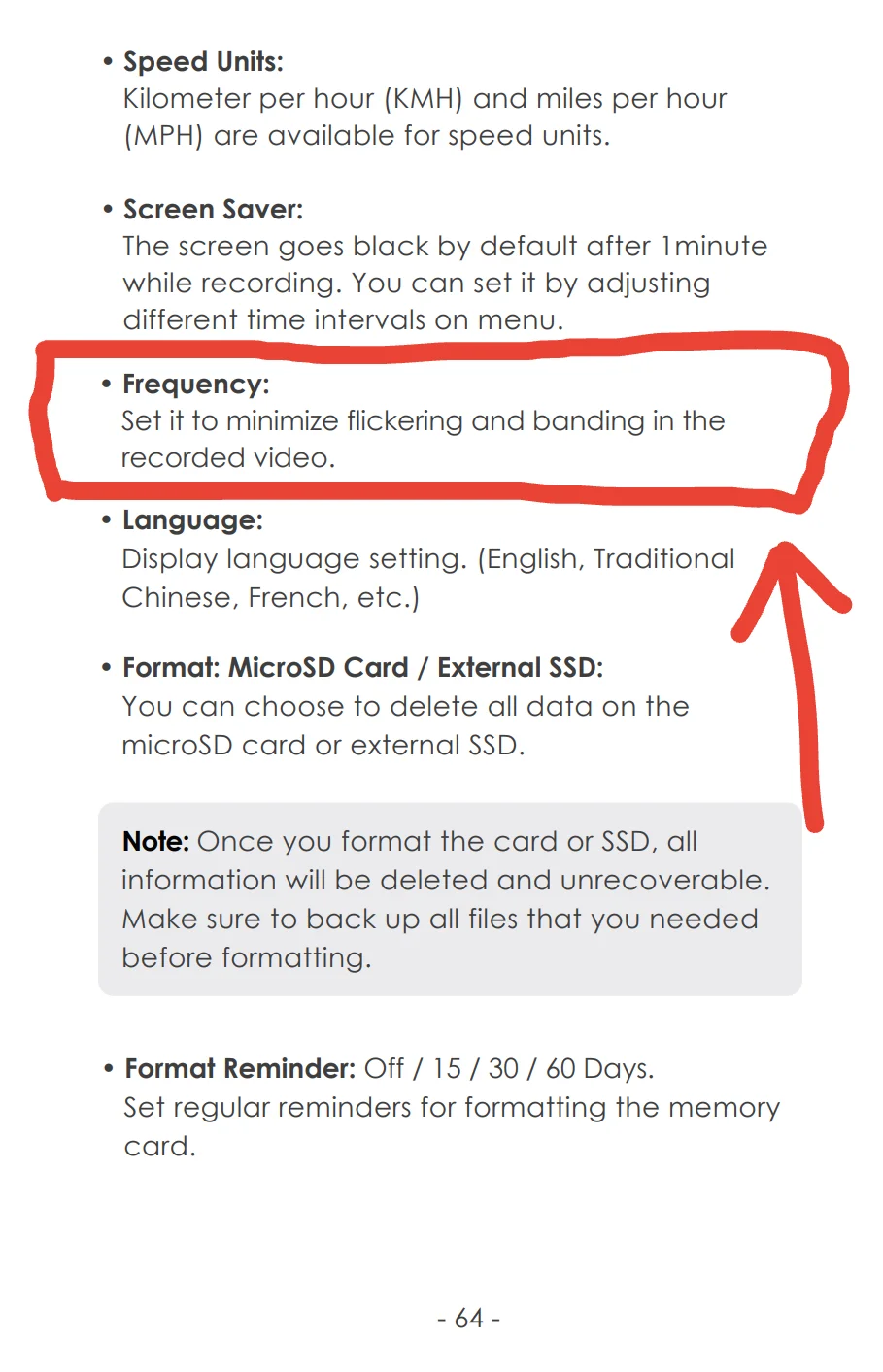

You have “Frequency” set to 60Hz, (Sweden 50Hz).
Page 64 of A329S User Manual says;
“Frequency: Set it to minimize flickering and banding in the recorded video”

@jsmith
2.) Flickering

1. I tested G-Sensor "Off" and it didn't resolve the lock issue from Parking Mode ---> Normal Recording. That was part of my initial testing, and thus I set it back to low sensitivity.
2. I can test 50hz and see if it makes a difference, but the default was already 50hz before I switched to 60hz. I'll test again with 50hz to verify flicker doesn't go away.
@Chuck McCoy said:

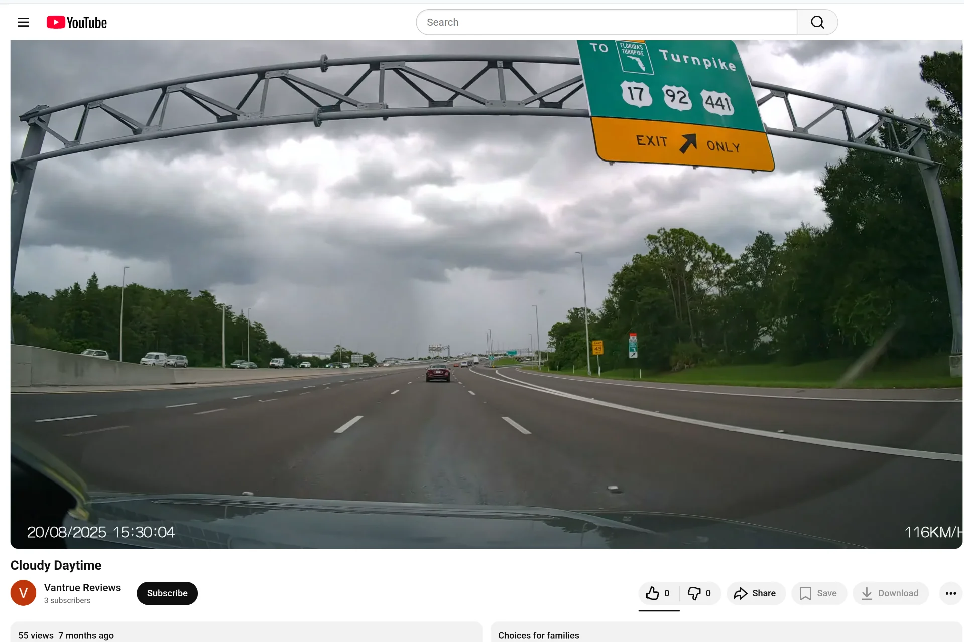

Why would you change Frequency to 60Hz in Sweden?

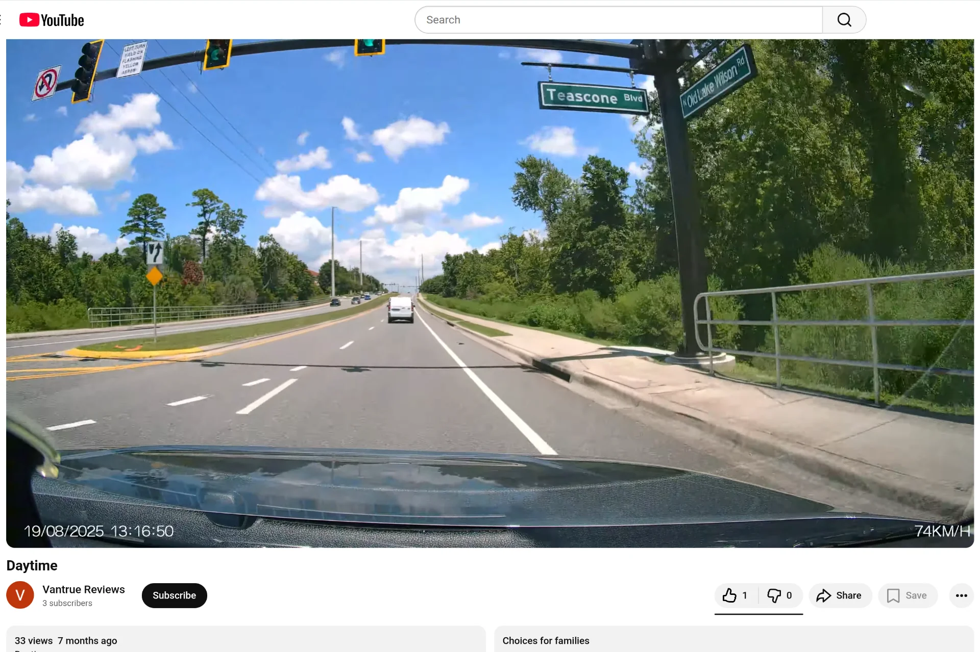

Are you in USA, and spoofing your location with VPN?
You have videos driving around Florida on your YouTube Channel.
What’s going on here?

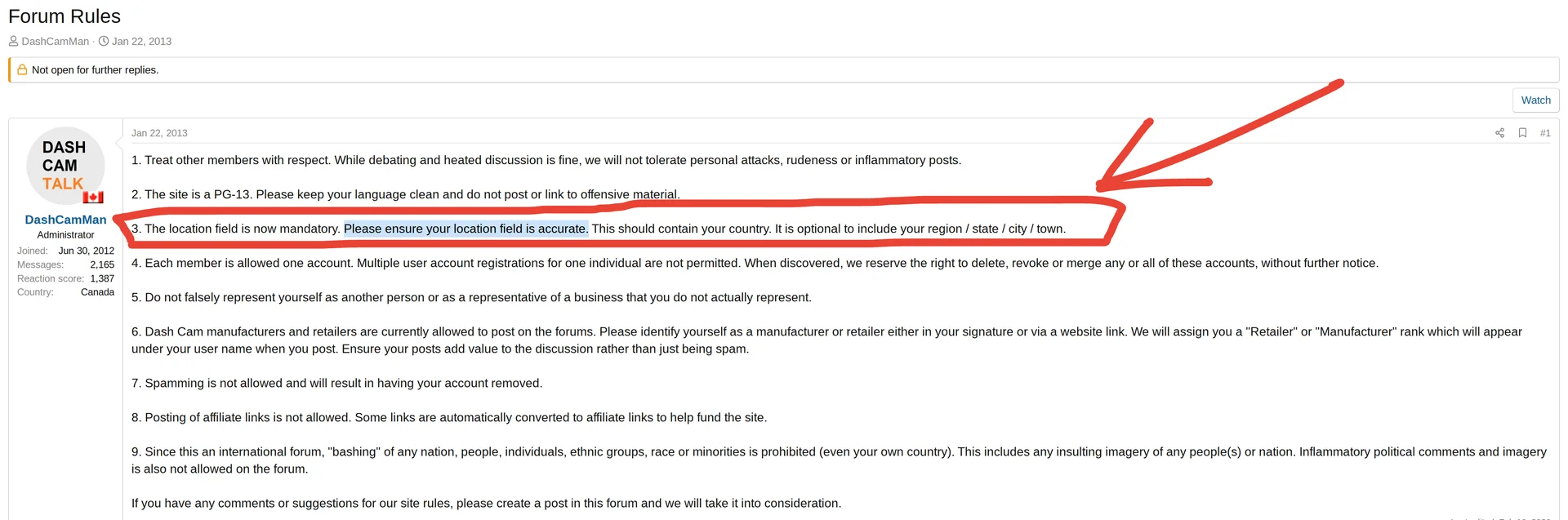

@DashCamMan
Is it a violation of DCT Rule #3 to knowingly spoof / fake your location, (not talking about traveling)? DCT FORUM RULES

1. I tested 50 hz and still had an issue. I reflashed the firmware, reset all settings, and tried 60 hz yesterday to see what would happen. Per my screenshots, the MicroSD card isn't in the camera. I haven't gone back out to my car to play with the camera again. I'll retest the 50hz setting again. It's called troubleshooting.
2. I traveled to Florida to go to Disneyworld and visit family. Per Vantrue, I took their camera with me to capture footage. Plenty of Europeans at Disney. Actually, almost everyone there during my visit were Europeans on holiday. Your point? People travel. Do you want photos from me in Italy, England, and other countries around the world?
3. @Chuck McCoy you've been down this alley already. @DashCamMan already told you that I'm not on a VPN.
