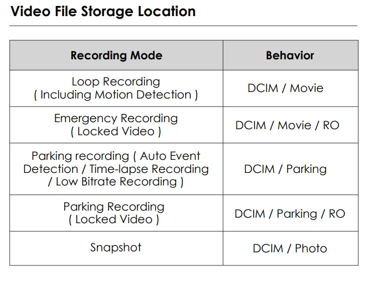

My understanding behind boot delay is it gives X seconds before the camera powers on after the car starts. I don't think this would have any bearing on the camera already being turned on and running during parking mode. The boot delay helps for certain vehicles where the camera might not get proper voltage immediately at start, and thus has it wait X seconds before booting.
Yes, the files in the RO folder are the same locked files you here after car starts and camera makes the "Snapshot" sound.
Correct - During a standard engine start (when you press the brake pedal and the start button simultaneously), the camera does not have enough time to switch from "Parking" mode to "Driving" mode.
Therefore, the triggered "event" video will be a parking video file saved in the (RO) folder. (Edit)
I am not sure, but the first driving video file could also be saved in the (RO) folder. (Edit)

There is only one "RO" folder for the A329S series of dash cameras. It stores emergency videos from normal recording mode and parking mode impact videos in the DCIM\Movie\RO directory.
The A119 Mini 2 & A119M Pro do have a "Parking\RO" directory.

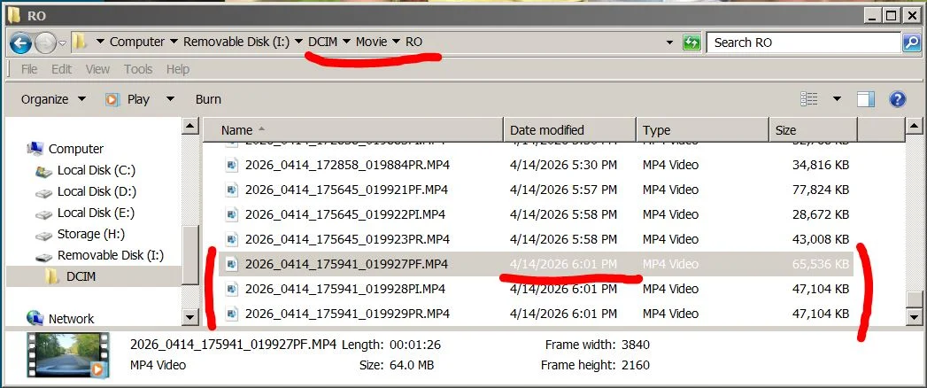

The problem description to me is that the transition from parking mode to normal recording mode is triggering an immediate "driving" impact event right as the dash camera has returned to normal recording mode. When it has occurred in my car, the engine has already been started and it has been idling for for almost 5 seconds. There's no obvious reason the A329S is triggering a driving mode impact event recording for that situation.
Ok, thanks. I've been trying to understand whether it's a parking event file or a driving event file that we're discussing.
I agree there's no logical reason for a driving event to occur if the engine is idling.
I have the same g-sensor settings as you (parking high, driving low). I think all the driving event files on my card are manually triggered when I press the remote button, although I will review them to be sure.
Correct. For me it's immediate when I start my car. For you, it's 5 seconds later. Either way, the Event Lock Triggers with the motion of starting vehicle, causing a bunch of unnecessary files to pile up in the RO folder. This is an issue / bug that I have raised direct with Viofo Support, and they'll be adjusting the sensitivity. Let's see what happens.

This is not a driving Event Lock issue, the Event Lock Triggers while the dash cam is still in LBR parking mode!
It’s a parking Event.
For me, it's a driving mode issue. The file that gets moved into the RO directory is a normal mode file F/R/I created right as it returns from LBR parking mode to normal recording mode, not a LBR PF/PR/PI file.

The first video is still in parking mode - Event saved in RO folder; The video cuts out the moment the dashcam switches to driving mode.
The second video is the first driving recording, saved in regular movie folder (continues from the parking Event recording).
