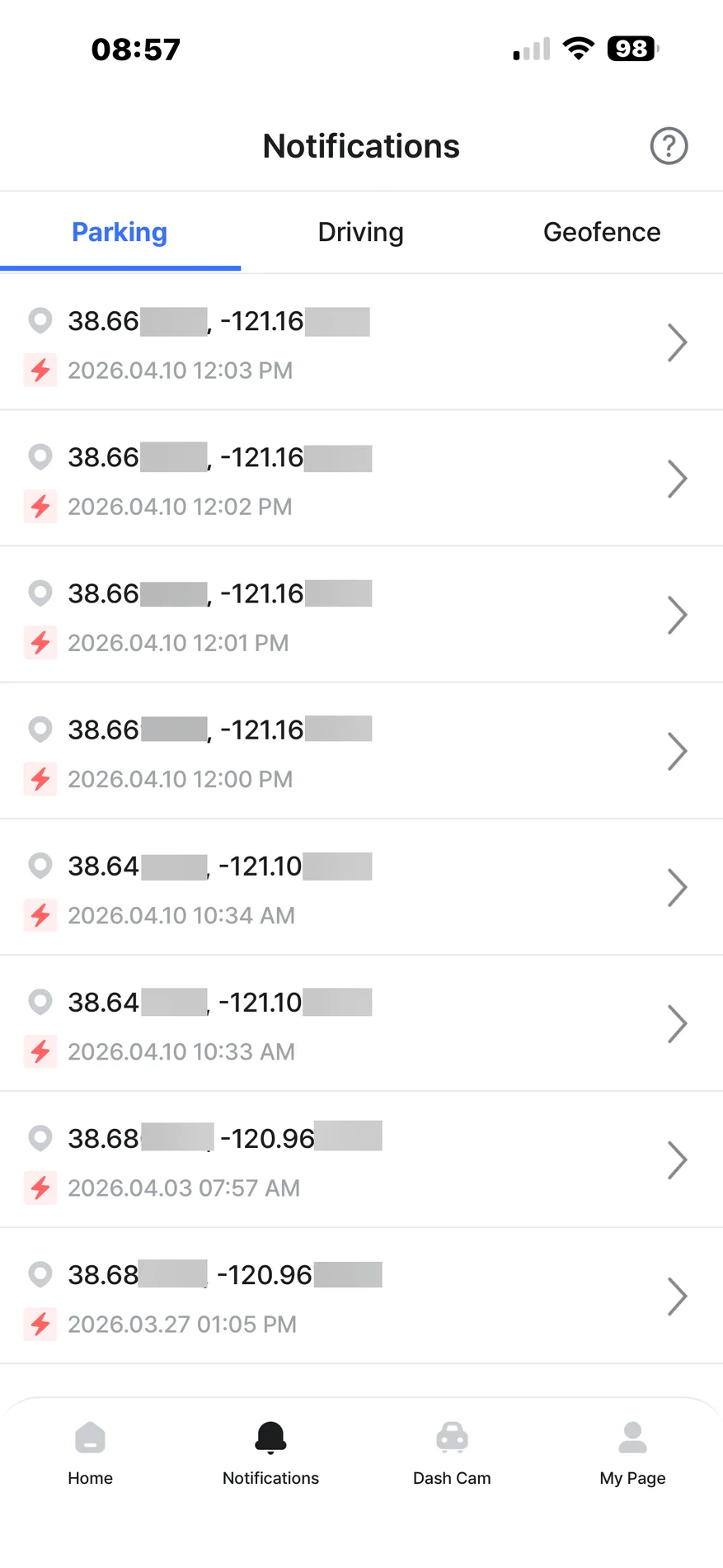

Yesterday during my weekly 3-hour drive [four parking mode sessions], I had the U3000 Pro configured for radar parking mode. As I observed before, the U3000 Pro would detect motion near the vehicle and it created motion parking mode files ["MOT" files in the "motion_timelapse_rec" directory] without a notification being sent.
When impact events occurred, the U3000 Pro would use the LTE connection to send push notifications. The Thinkware Connected app has entries for the impact events in the "Notifications" section. In the screen for each notification, there are thumbnail images from the front/rear cameras of the impact event.
When I tapped on the "Front View" image, the message on the bottom appeared: "Check the dash cam". The U3000 Pro was powered off at the time [this morning] I clicked on the images.
View attachment 90786View attachment 90787

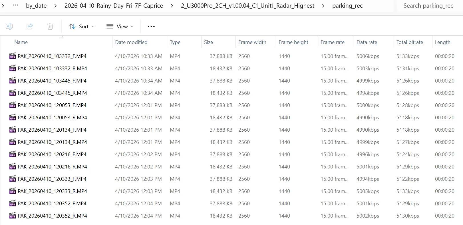

Since I added the LTE module to the U3000 Pro, the memory card has a new "hidden" directory of ".parking_rec_sec". In that directory, there are "PAS" video files with a resolution of 1280x720 @ 15 fps for each impact event. Those files appear to be the video files the app will attempt to access [if the dash camera is on].
The other change I noticed is that the "PAK" files in the "parking_rec" directory for each impact event had the front camera resolution dropped from 3840x2160 to 2560x1440 @ 15 fps. I'm assuming this is due to the fact that the new ".parking_rec_sec" video files are being created at the same time.
