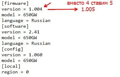

I also tried updating the firmware from 1.003 to 1.005.
