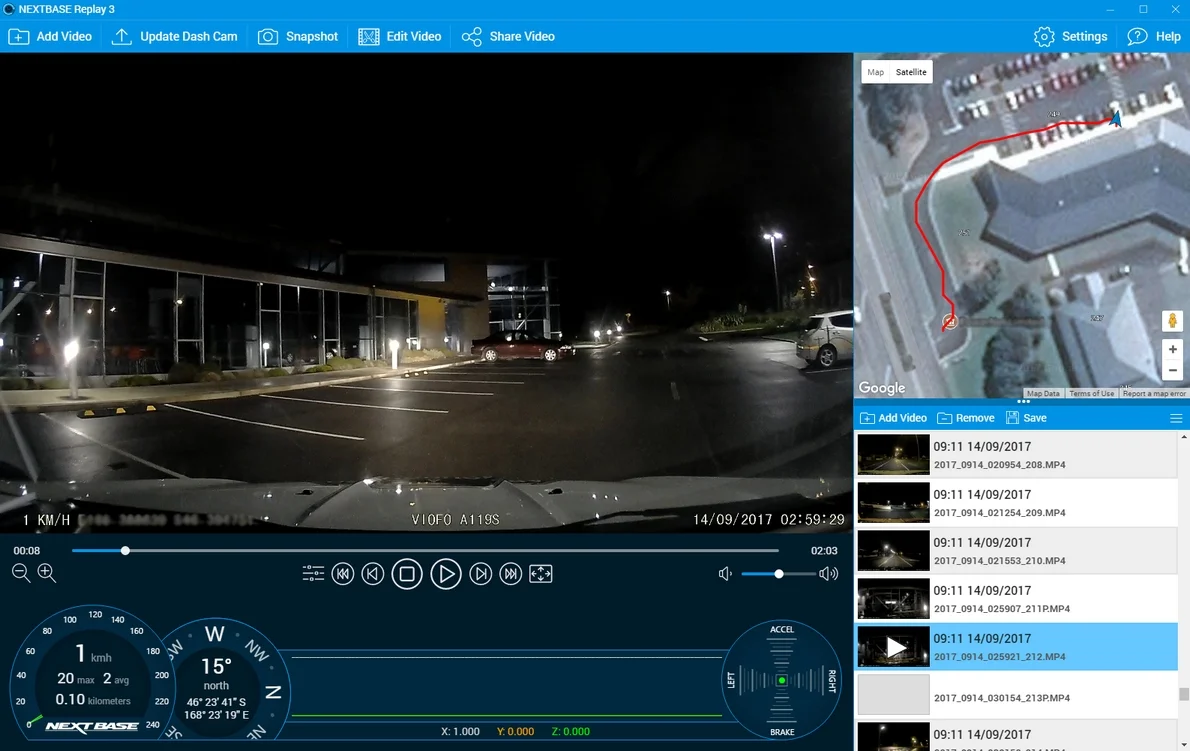

As we now know, RegistratorViewer will now not parse the GPS data from Viofo A119S files, and Dashcam Viewer is expensive and the UI is convoluted IMHO, so I went looking for an alternative, and found this...
Nextbase Replay 3
Seems to parse the GPS data from Viofo A119S files just fine, UI is pretty slick. The only caveats I can see are, the filename parsing is messed up (mine shows 09:11 14/09/2017 for every file), and if you select all files on your SDCard, the programs takes a while to catalog them, also doesn't recognize the locked file folder.

I have installed the program and it plays sort of ok then the GPS cut in and the video became blocky
I will test on a new laptop I just bought
I've been playing with this for a couple of days and it appears to work fairly well (HP core I5 laptop running Win 7 Pro) with SG9665GC files and A118C files (both with GPS). Map positioning appears to be correct as is the speed and compass displays. File names appear correctly. What it does not do that RV does is combine files into 'trips' - or if it does I haven't yet found it.

Thanks so much for pointing me in this direction having happily used Registrator Viewer for many years with my previous mini 0801 GPS camera and had desperately been looking for a programme to use with my Viofo A119S GPS version in order to see GPS map footage..
Having just installed this above programme from Next Base I must say how very happy I am with it.. The GPS Google maps are spot on and the programme is quite easy to navigate which includes a zoom in/out facility of video footage.. As mentioned in earlier above post all files loaded show the same time date however if you look below the time date on each file you will see correct time in 24 hr format with date ie 17092017 and time (inc seconds) 180515..each additional file will have the correct time you will be looking for in 24 hr format so easy to narrow down a search.. So overall this is a great addition to Registrator Viewer for your A119S if you want to see Google GPS maps alongside your video footage.......

Good to see it works for you as I was in the same boat desperately looking for a app to replace RegistratorViewer. The only other feature I'm missing from Replay 3 is speeding up the playback. @NextBase Tiffany "Hint, Hint"
