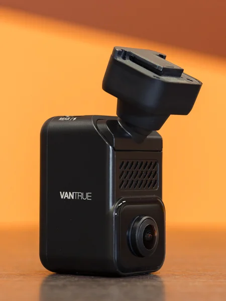

The E360 clicks into a GPS mount which in turn slides into an adhesive base. The ball socket in the mount permits a range of vertical angle adjustment, in addition to left and right. This is useful when fine-tuning the camera orientation to achieve the best front, cabin and combined 360° views. There is no tension adjustment in the mount, however it feels secure and in testing so far it has shown only a small amount of vibration. Hopefully this continues through long-term testing and hot weather.
Although there is some vertical angle adjustment in the mount, I found that I needed to aim the camera as far down as it would go to aim the lenses horizontally. E360 owners with a shallower screen angle may find this to be a problem, resulting in more sky than ground and a warped horizon.
The E360 is powered via the GPS mount which has a USB-C port on one side. The E360 supports an additional rear camera - this is connected directly to a USB-C port on the top of the camera body rather than the GPS mount. This arrangement is OK if you do not intend to remove the E360 often, but does leave a cable hanging loose which might be an issue for some people.

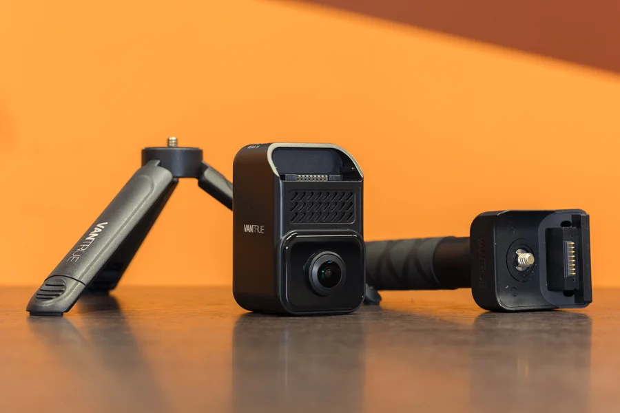

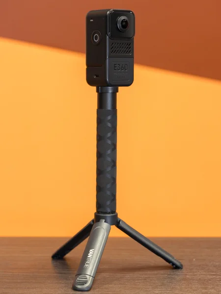

Vantrue sent me the E360 Ace package which includes a rear camera and a handheld mount, plus a hardwire kit and a 512GB microSD card.
The handheld mount screws into the top of the E360 and connects to it via the same set of pins as the GPS mount. The handheld mount contains a pair of 18650 batteries that power the camera (there is no battery inside the E360).
The mount can then be attached to the supplied mini tripod, or to any other suitable attachment point with a standard 1/4" screw thread. In later testing, I intend to use the E360 mounted on a full-size photo tripod to bring the camera view up to eye level.
When mounted (upside down) on the handheld mount the E360 doubles up as a 360° semi-action camera, however it is not intended to compete against a dedicated 360° action camera such as the Insta360 or GoPro MAX. The E360 is not waterproof, does not have an internal battery, and does not have image stabilisation, so you can't use it on your ski helmet or attached to a bicycle. However it does work fairly well with steady hand movement, and it's better when mounted on a fixed support. I may use it for occasional short video clips to document my photography trips.

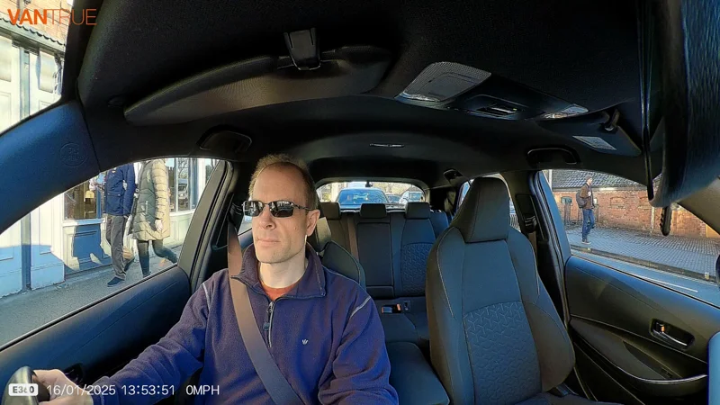

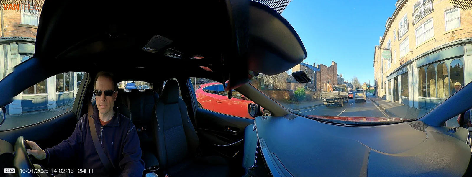

The E360 has a number of resolution options which change how the 360° video is presented:
5.2K Panorama (5184x1944)
Both 180° videos are stretched to fit a rectangular 4x3 aspect ratio, then stitched to create an 8x3 panorama.
The merge includes exposure adjustment of both videos, probably to achieve a less visible stitch. The result is a darker interior and brighter exterior than the separate videos (compare to examples below)
Dual Fisheye 1944P (5184x1944)
Both original 180° fisheye videos are displayed side-by-side in a single 8x3 panoramic video. These appear to be the full-frame 2592x1944 videos captured by the IMX675 sensors.
The lens projects an image circle over the 4:3 ratio sensor which crops the top and bottom edge. No dewarping or exposure adjustment here.
Fisheye + Fisheye 1944P (2592x1944 + 2592x1944)
Both original 180° fisheye videos captured in separate 1944P files.
1944P + 1944P (2592x1944 + 2592x1944)
The original 180° videos, stretched to fit the 4:3 rectangular frame
1440P + 1440P (2560x1440 + 2560x1440)
Similar to 1944P+1944P above, but cropped from 4:3 down to a 16:9 aspect ratio and removing some of the unnecessary sky and dashboard at the top and bottom of the view.
Comparing the left and right edges of 1440+1440 to 1944+1944, the coverage appears to be slightly wider at 1440P.
This is my preferred resolution option on the E360.
