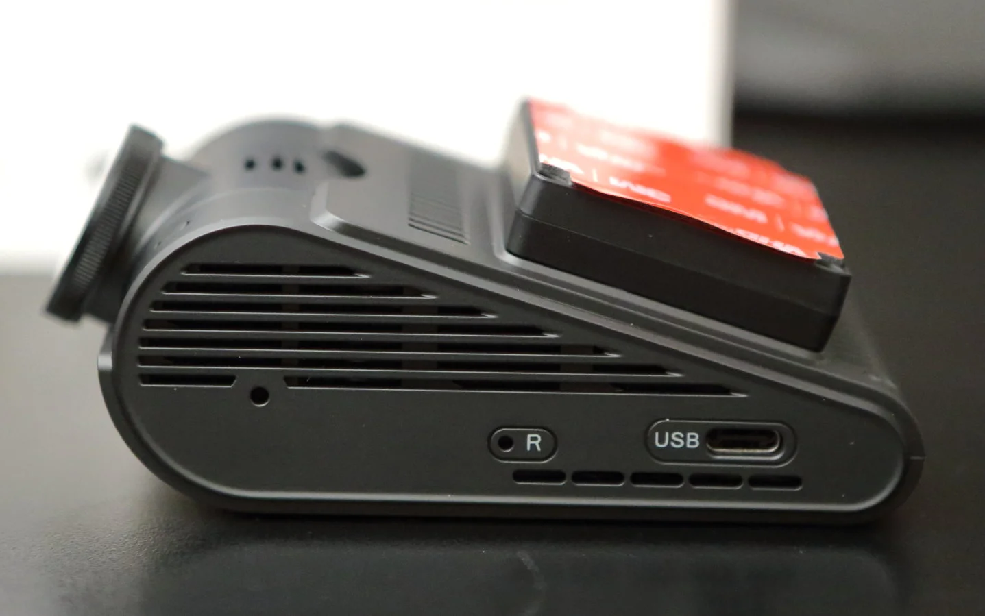

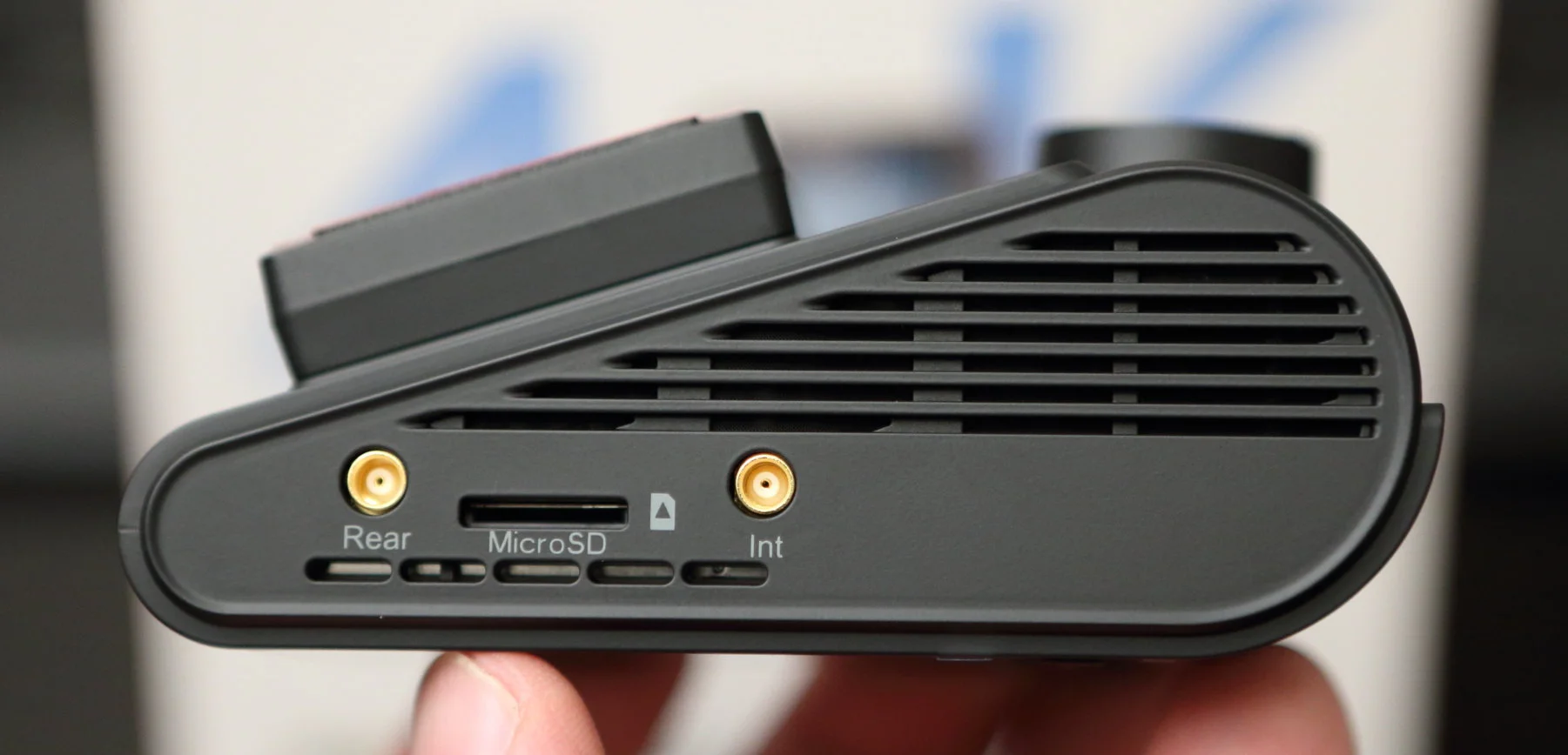

The left side of the camera features plenty of ventilation slots, a reset button, and a USB-C 3.0 connection point to an external solid state drive for longer loop record times. It's not labelled, but I suspect the single round hole nearest my thumb is the microphone hole. You can also see the GPS unit mounted on the right side of the image with the red 3M VHB adhesive already applied.
The A329 manual makes a special point that the USB port on the unit itself is NOT for use with the 5v power supply. The USB-C port on the unit itself is strictly for connection to a SSD or to your computer for file transfer. The USB power supply is intended to be input through the GPS unit ONLY.
On the right hand side of the camera, you can see the micro SD card slot that will accept up to a 512GB card. You can also see the small, coaxial connectors for the 2K internal/telephoto camera and the 2k rear window camera as well as additional ventilation holes.

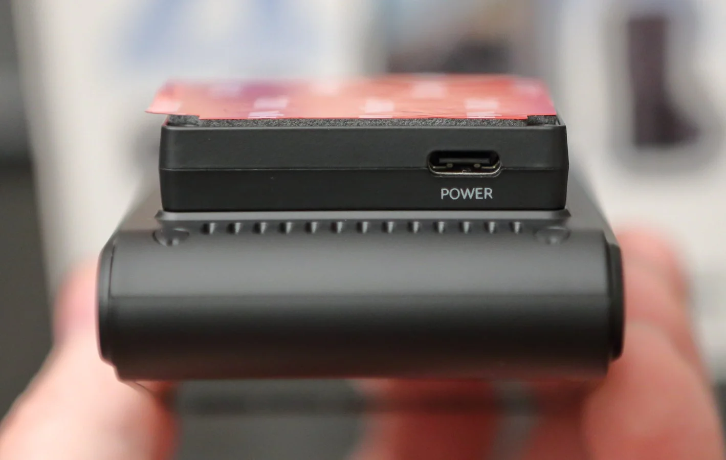

Looking at the top of the unit, you can see the USB-C power entry port that is part of the detachable GPS unit. The GPS unit slides sideways to disengage. This allows you to separate the camera from the GPS unit once it is installed on your windshield.

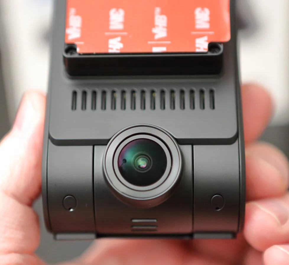

And at the bottom of the unit, you can see the main forward facing camera.
In the view of the main camera lens above, you can also see a number of reflected hues (red on the periphery, greenish toward the center) that indicate the presence of anti-glare and anti-reflective coatings that have been applied to the individual lens elements.

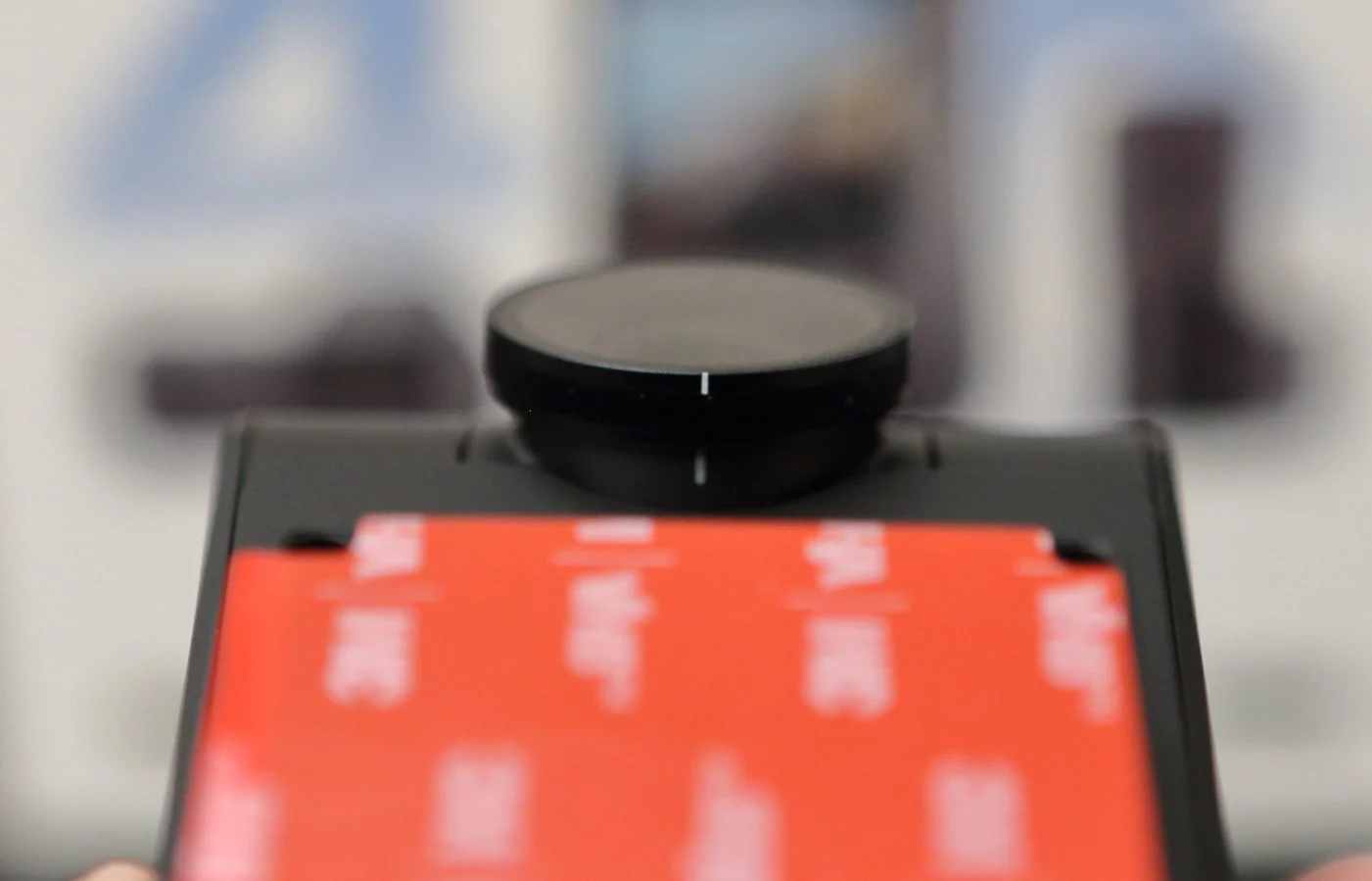

Like its predecessors, the main forward facing lens has a nice little alignment mark that is useful when installing the circular polarizer that is included in the camera packaging. Just align the white line on the polarizer with the white line on the lens, press it on, and you're all set to go!
EDIT: actually, rotating the polarizer counter-clockwise by about 10 degrees from what is shown in the image below results in better glare reduction for the front camera.

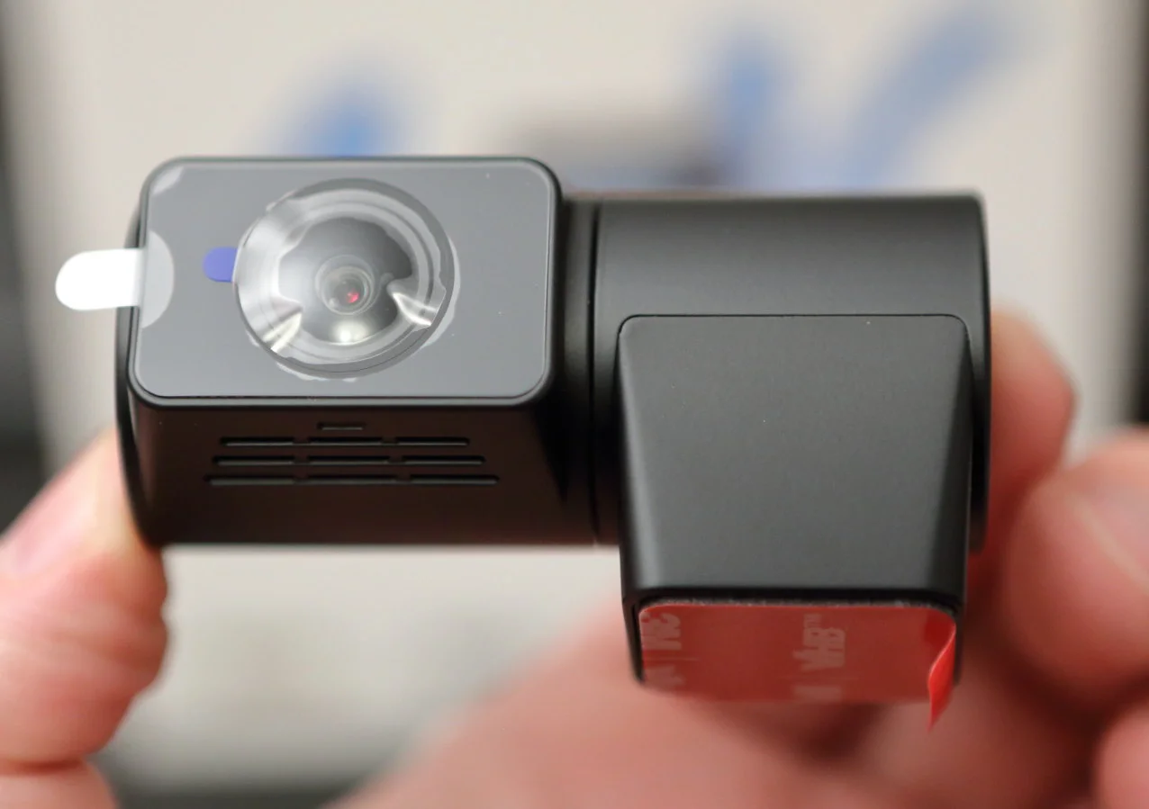

Here are the forward facing telephoto and the rear window cameras. With the exception of how they are labelled, they appear nearly identical.
Here is the "top view" of the camera (which is a little arbitrary...). You can see the ventilation slots around the camera's sensor on the right hand side. If you hold this up to the light, you'll see straight through the camera. I could post another photo of the "bottom view" of this same camera, but it is exactly identical, so it's not worth the space here. 🙂

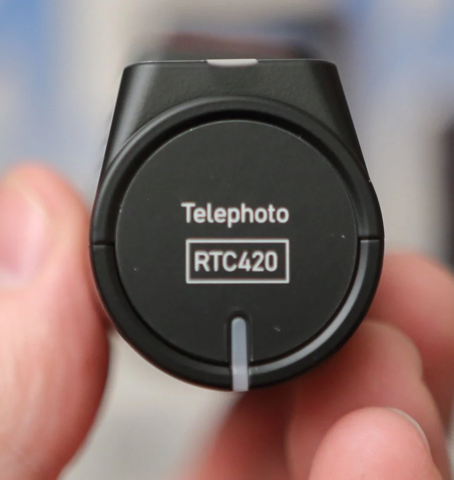

The front 4x telephoto camera features an F2.0 lens with a 35° field of view. Those of you who are familiar with photography (real cameras, not cell-phone crappy cameras) will recognize the familiar and necessary tradeoff between a longer focal length and the resulting smaller aperture. The same is true here.
Both "accessory" cameras have a translucent vertical, white LED below the model number that wraps around the corner of the camera housing. This LED glows ever so softly to indicate that the camera is receiving power (something I very much appreciate for diagnostic purposes!). It is just bright enough to discern during the daylight and is clearly visible while simultaneously being VERY unobtrusive for night time driving. Well done, indeed! 👍 Sorry for the out of focus image. I'll have to see if I can remake that one - the camera is already installed in my car.
The rear camera features an F1.8 aperture with a 160° field of view.

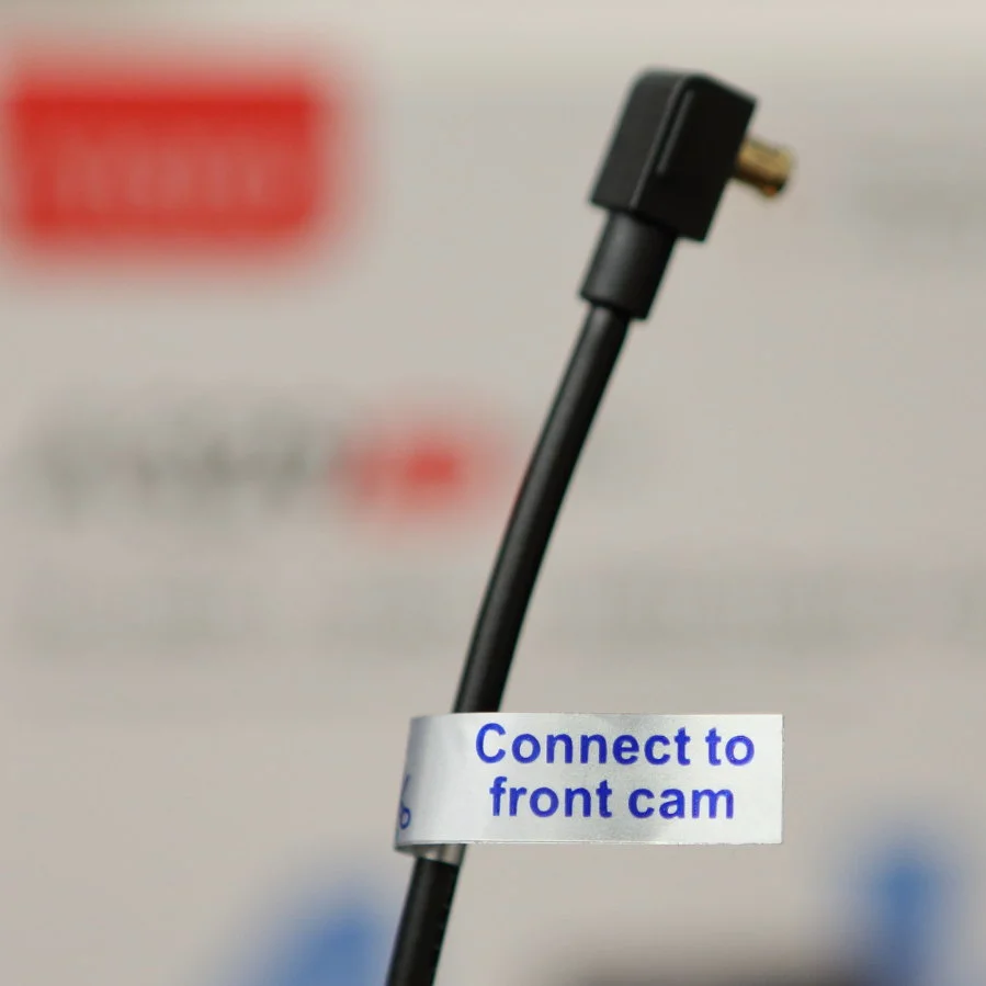

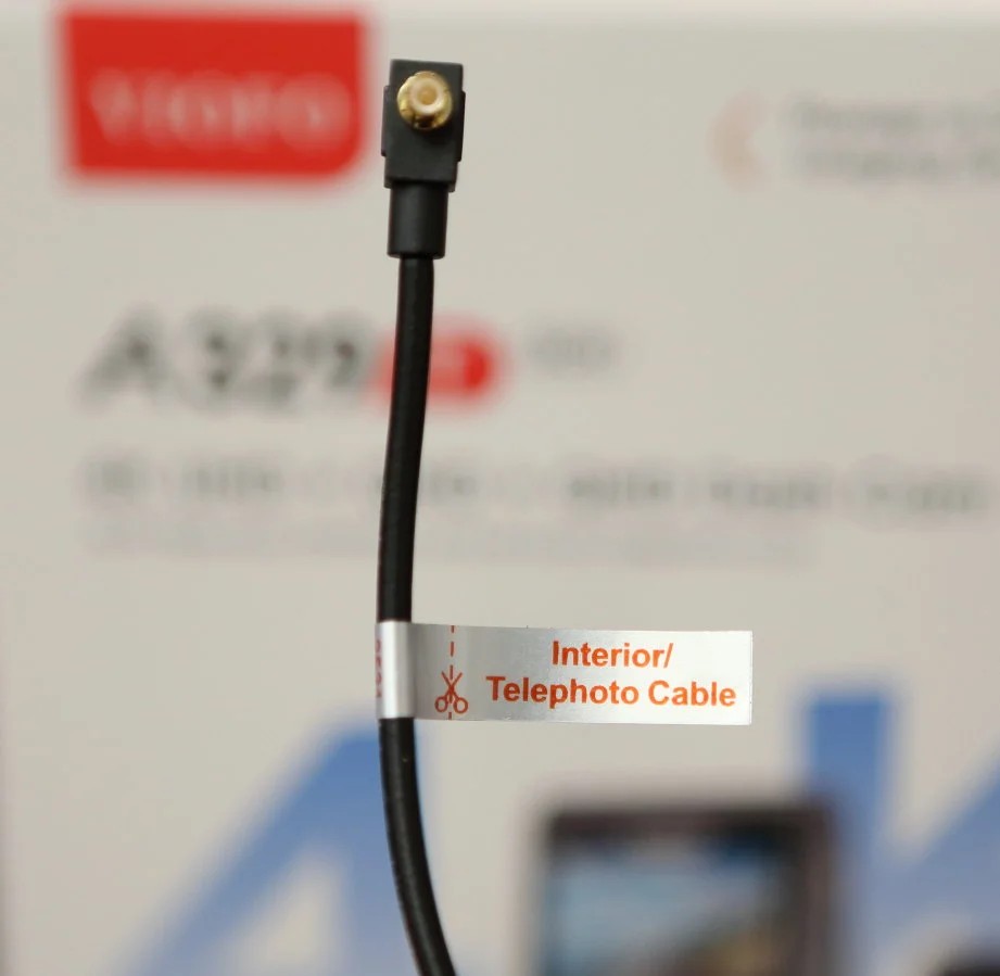

The first coaxial video camera is about 1m (3.3ft) in length and is intended to connect the front telephoto or cabin camera to the main camera unit. The ends of the wires are even labelled to help make sure you don't mix things up as you are setting things up during installation. I'm a big fan of clarity that reduces the opportunity for errors!
The second coaxial video cable is about 6m (20ft) long and is meant to connect the rear facing camera to the main unit. The ends are similarly labelled. The end that emerges from the rear camera features a straight connector, whereas the the end that plugs into the main camera up front has a 90 degree angle connector to keep the wires neat and tidy up front on your windshield. Love this level of attention to detail!
...and the end that plugs into the main camera up front...

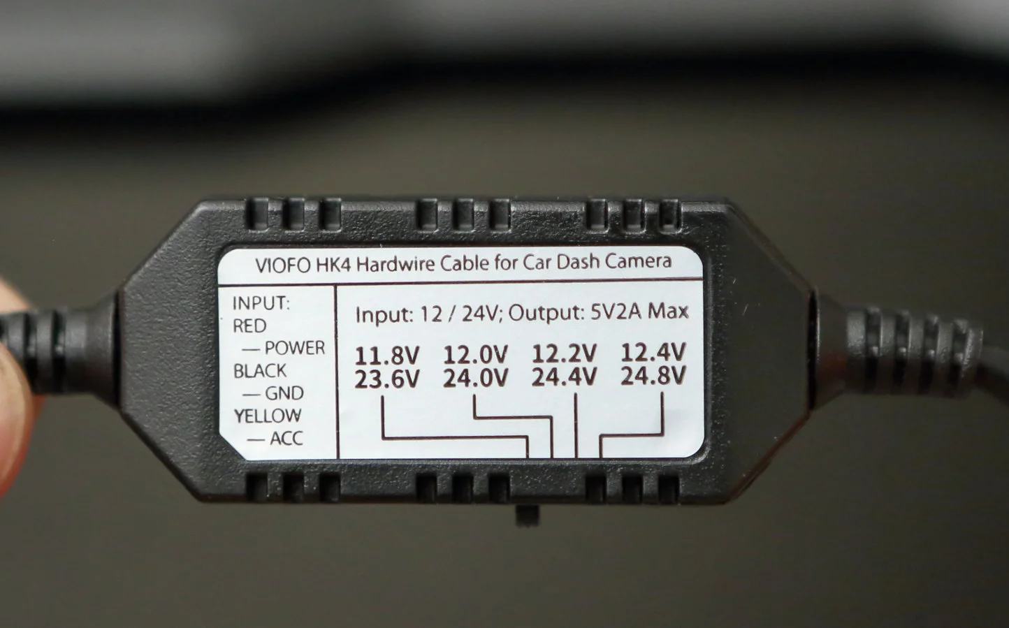

The HK4 hardwire kit seems to be 99% identical to the previous HK3-C kit that I already have. To my eye (so far) the only difference is the straight (HK3-C) vs 90 degree bend (HK4) in the USB-C connector at the end of the hardwire cable.
The voltage regulator box converts 12/24v from the vehicle down to 5v for the camera. It has a "battery saver" feature built in with four switchable voltage levels that will turn off the camera in order to prevent running down the car's battery. This helps insure that you don't return to a dead car battery.

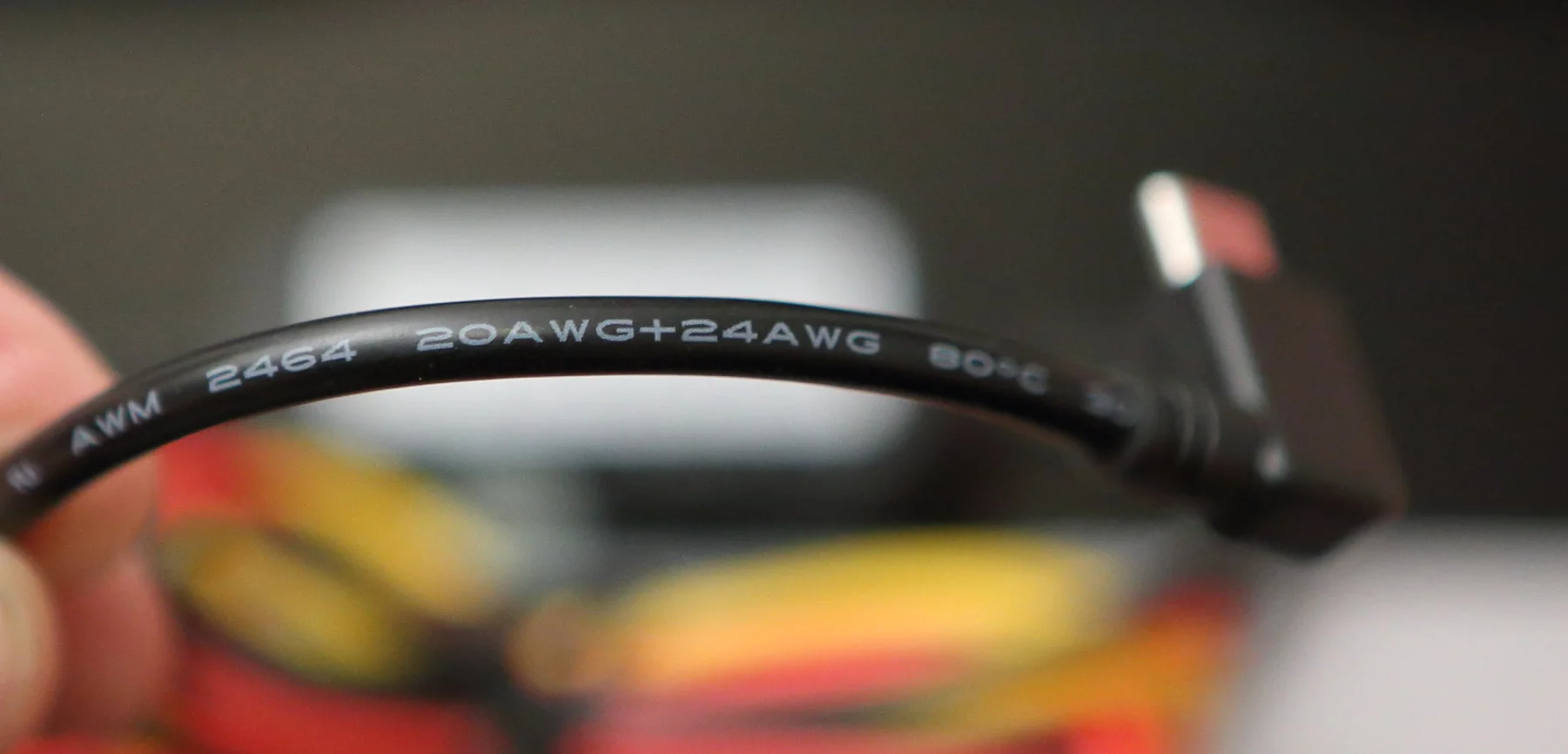

One of the things I also appreciate is substantial/sturdy wiring. The power cables in the Viofo hardwire kit are 20g wires which helps to minimize voltage sag over long wire runs. The 24g wire is the yellow trigger wire that toggles parking mode with drive mode for recording - it doesn't need to deliver any real current, so it's fine that it is thinner gauge wire. I'll have to do some voltage measurements to compare the HK3-C to the HK4 to see if they are indeed the very same regulator, just with a different shaped connector on the end (I suspect this is the case). In his earlier message, @Chuck McCoy was referring to my previous tear-down of the HK3-C hardwire kit as I was exploring it's behavioral characteristics while building my LTO parking battery. I would guess that opening the HK4 case will reveal a newer revision of the same PCB in the HK3-C given that time that has gone by. I did order an HK6 regulator that should arrive tomorrow, so I'll have a look at that one, too. I'm curious to learn about the Bluetooth enabled hybrid parking mode control that it affords and how that will interact with my DIY LTO parking battery (Build images and circuit schematic). I'm not sure if the BMS will shut down my battery first, or if the hardwire kit will shut down the camera first... I think I set the BMS to turn off at about 12.0v, but I don't remember at this point.

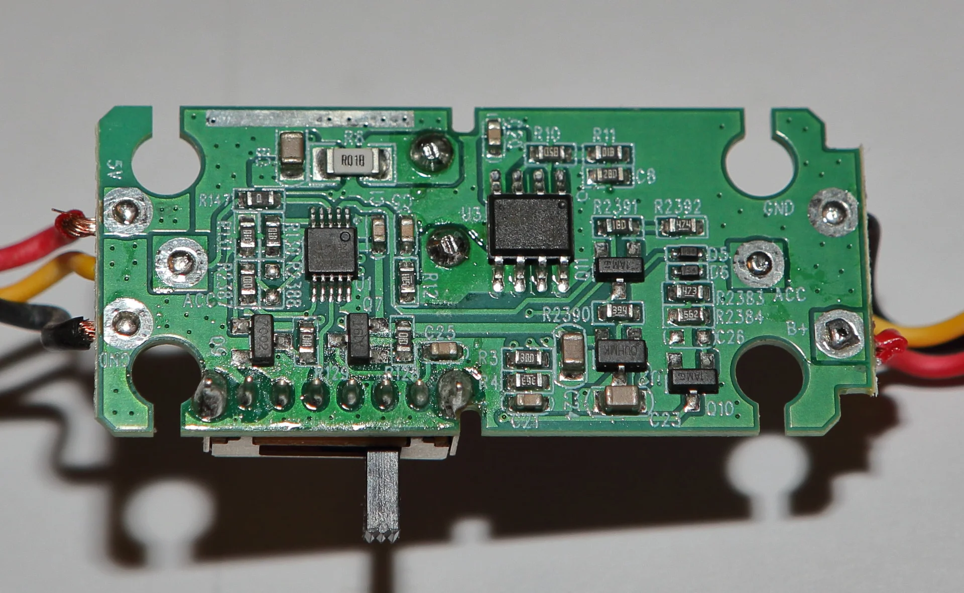

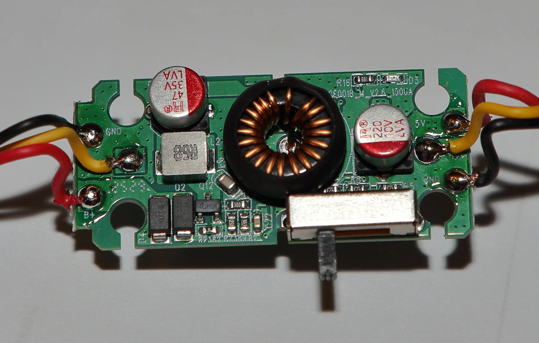

Here are a few images of the inside of the HK4 regulator. It is clearly an updated design when compared to the HK3-C regulator. I presume the redesign is intended to increase its power efficiency. My measurements indicate that it consumes about 0.1w in drive mode and hair less (~0.09w) in parking mode. At the USB-C end of the cable, the regulator provides about 4.96v with no load, and about 5.05v with a 6w load.
This is the top side of the HK4 regulator board, 12v input is on the left and the 5v output is on the right.

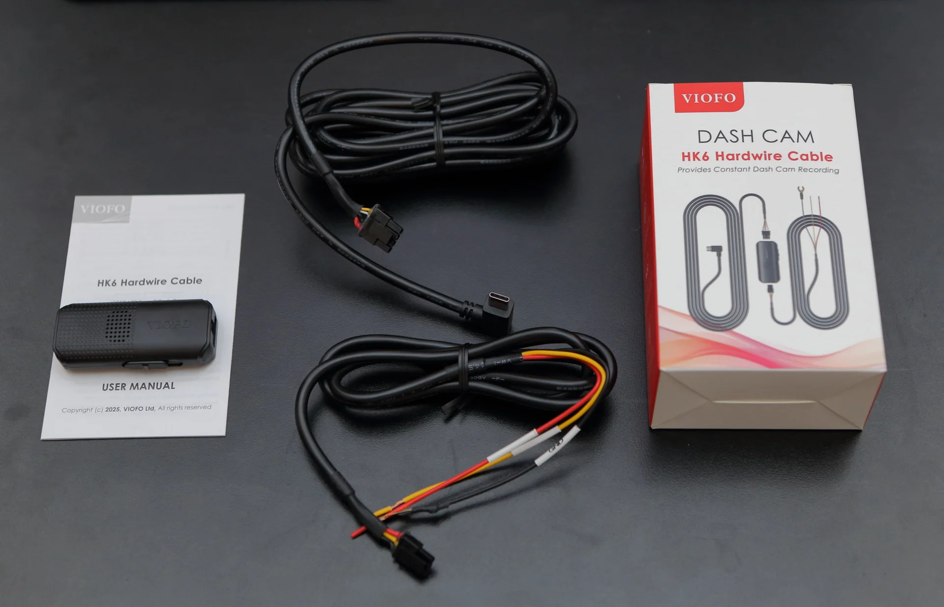

I also picked up an HK6 hardwire kit as I am curious to learn about how the hybrid parking mode settings will interact with my LTO parking battery that has a voltage range of 15.9v to about 12.0v or so (I don't hardwire to the car's fuse box).
The HK6 is an entirely different modular design (detachable cables) that provides a few extra features, which are pretty cool. The cable that connects the HK6 to the car's battery/electrical system is 1m in length. The USB-C cable that connects the HK6 to the camera measures 3m, or about 10ft. With the combined length of these two cables (4m or about 13ft), there is plenty of length to reach where you need it to. For my 4-door sedan, the power cables reach more than half way across my front windshield, all of the way to the back of the car, and into the trunk where my parking battery lives. And there is still a little bit of length left over... Awesome!

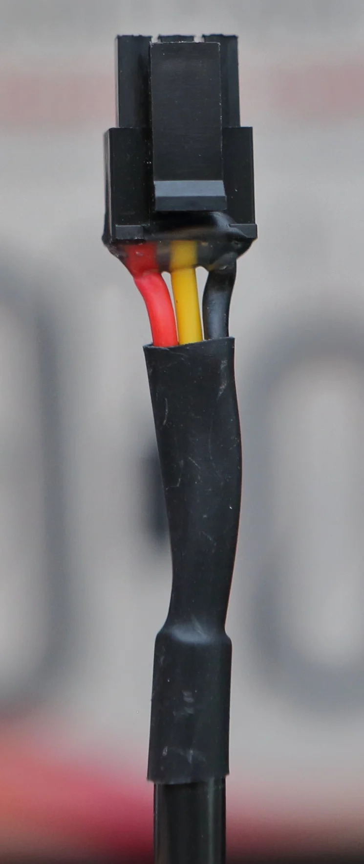

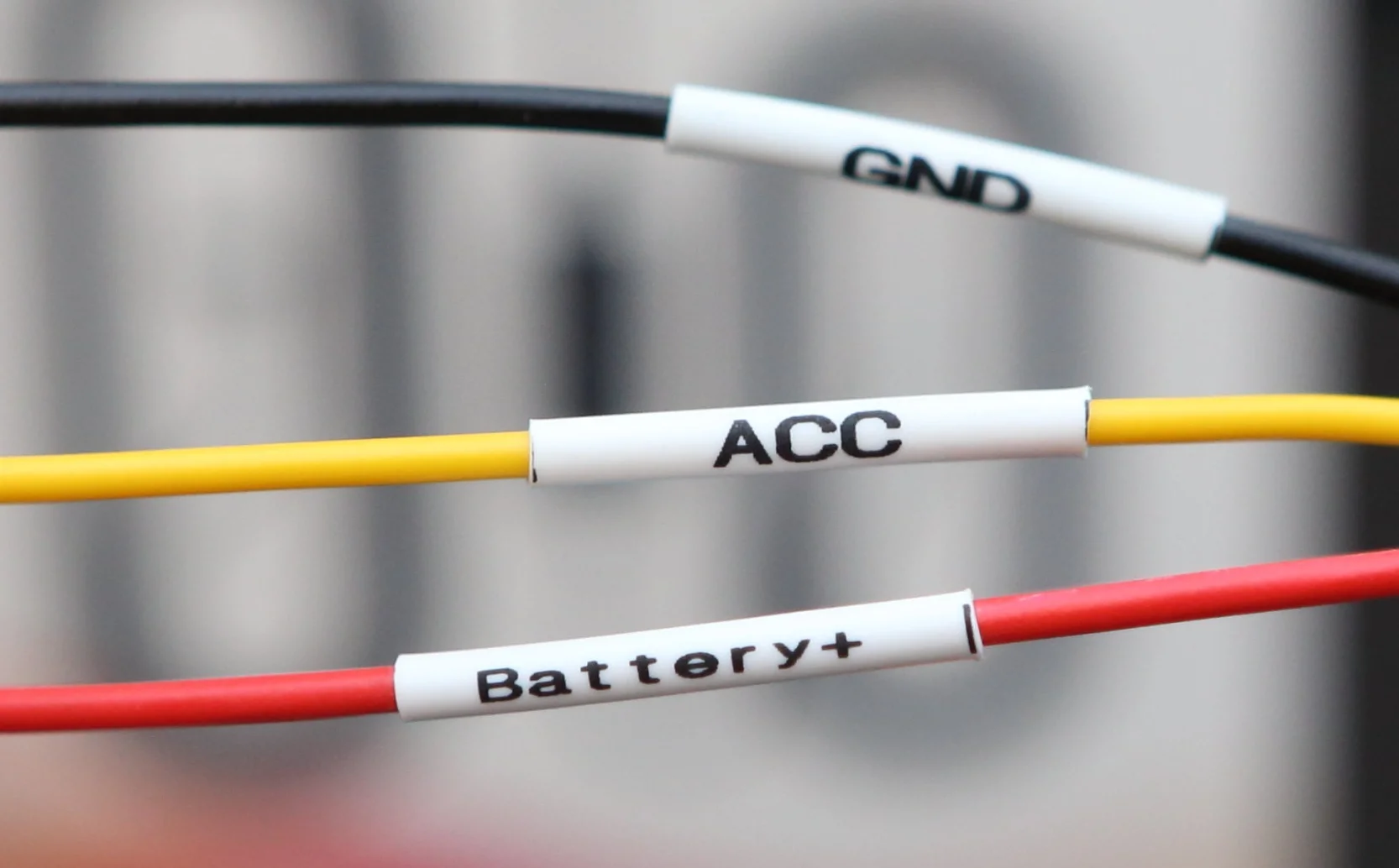

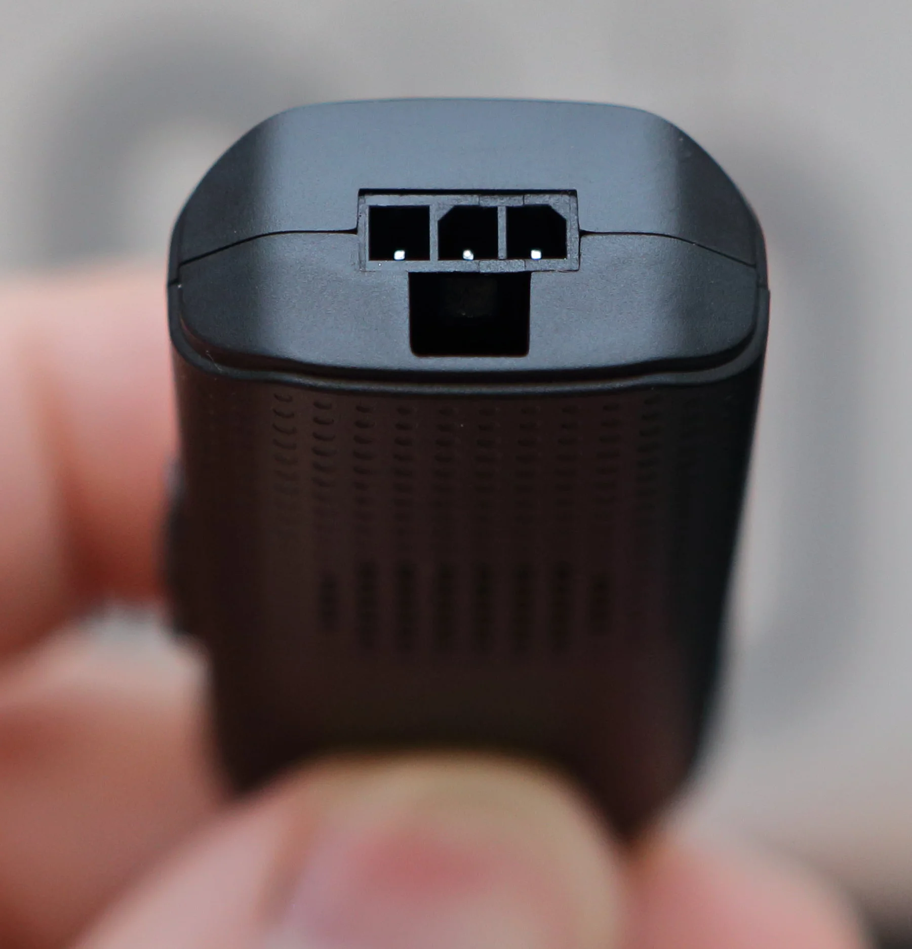

The 12v input side of the HK6 has the usual 3-wire arrangement, complete with labelled wires so you don't inadvertently mix things up during installation.
This is the 3-wire power supply connector that connects your fusebox to the HK6 regulator itself. I appreciate the additional glue at the back side of the clip to hold the wires to prevent wiggling which will also prevent premature wire failure.

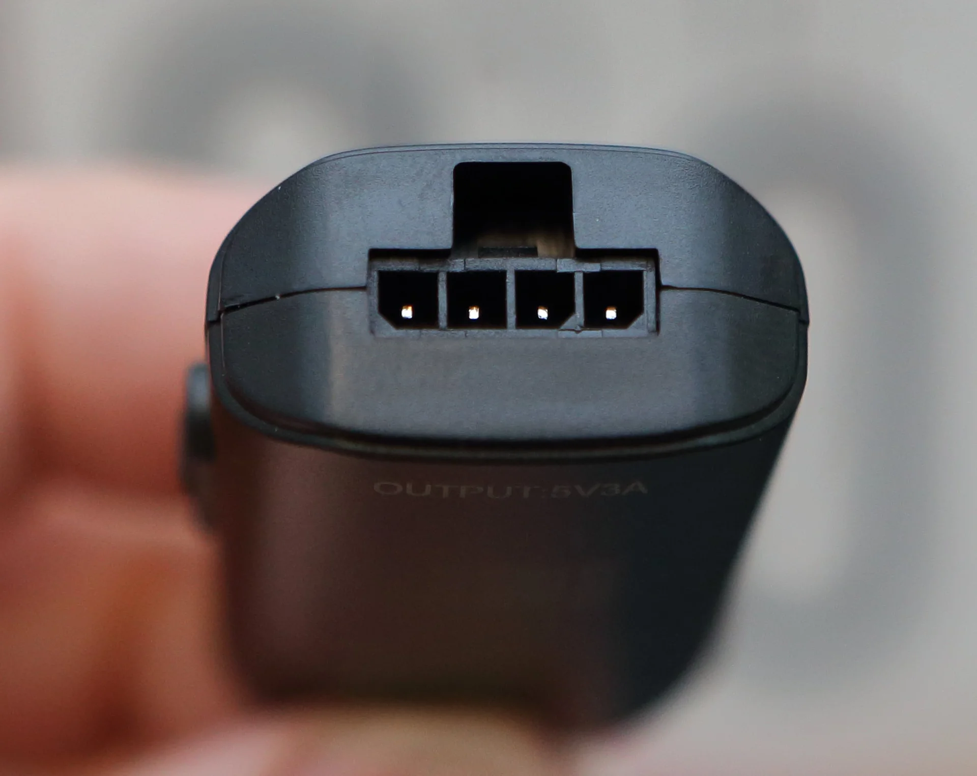

The opposite side of the HK6 regulator has a curious 4-wire connection instead of the usual 3-wire (red + black for power supply + yellow to toggle park/drive mode). This extra wire enables the hybrid parking mode and the communication of battery voltage level that overlays the dashcam video.

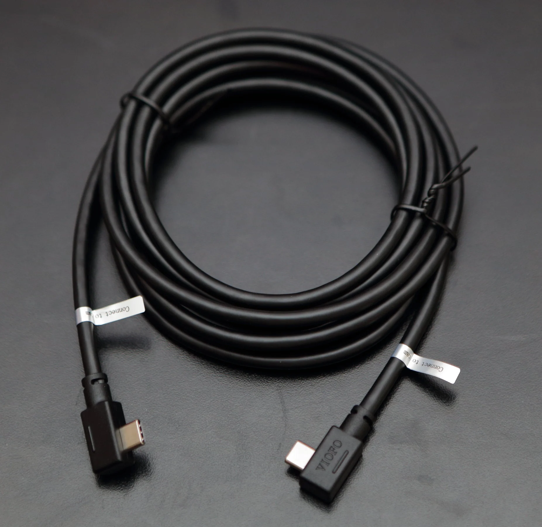

And here is the USB-C wire that connects the HK6 to the Viofo dashcam. Again, I appreciate the added glue to hold the wires in place - this is robust cable construction 👍
EDIT: I've also made a few measurements to map these four wires to the USB-C pinout in Post #70 below.

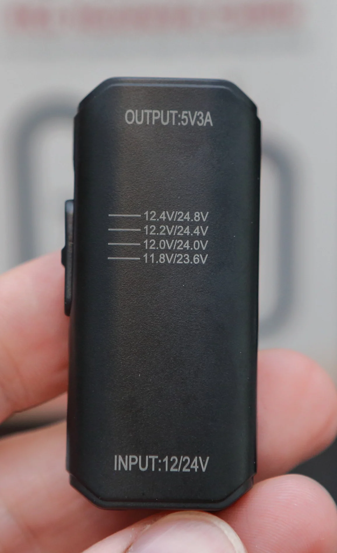

The regulator itself has a 4-position switch that allows you to select the level of battery protection you desire when hardwiring to your car's fusebox.

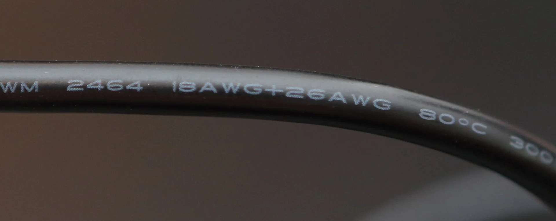

Another interesting design change for the HK6 regulator is the use of thicker 18ga wires to deliver the power to the dashcam. I'm a big fan of "over designing" things, especially power supplies! This has the added benefit of delivering power to the camera more efficiently (less voltage loss over the cable length). The 26g wires are for triggering park/drive mode and communicating flags to the camera to control hybrid parking mode as well as battery voltage. These are very low current draw applications, so heavier wire is of less benefit. I haven't yet spent the time to map out the specific signal voltage levels present on the yellow and white wires.

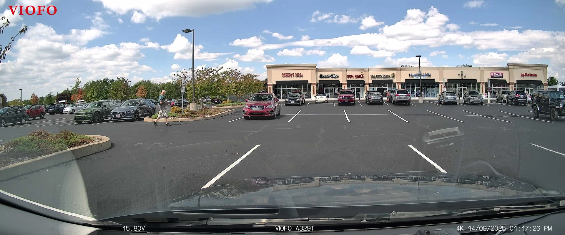

Here are a few early images to demonstrate the differences with HDR on and off as well as to illustrate the differences between the 4k main camera and the 2k 4x telephoto lens. Initial impressions are VERY impressive!
First up, here is a JPG image (that the forum will likely convert to WEBP and simultaneously downres) at maximum resolution from the front camera. HDR is off (no marker in the stamp on the image). The voltage of my parking battery is also indicated at 15.79v (fully charged). Resolution is 3840x2160 and the JPG file is 532kb in size. For all of the images in this post, there is also a circular polarizer installed on all cameras.
Here is the same scene with HDR turned on - note the "HDR" stamp in the bottom right of the image. The HDR process creates a bit of a warmer/yellow cast to the image - which is fine by me, I will prioritize image detail ahead of color rendition for any dashcam (something I would not tolerate from my digital SLR camera).
I much prefer the "letterboxed" 20:9 aspect ratio that crops off the top (don't need more footage of clouds) and bottom of the image (don't need to see my dashboard and radar detector - I know they are there), resulting in 3840x1600 resolution (481kb file size) as seen below. Without the additional footage of the clouds, my wife teases me that I'll miss capturing footage of the UFOs flying overhead... 😉

Yep, that's next 🙂. Didn't have time to drive circles today waiting for the traffic patterns to be "just right" for more dynamic captures. I figured I'd start with the easy/simple stuff and go from there.
Even these static comparisons show a difference, though, and it's the most basic and "controlled" environment to compare features and image modes (though, there were some clouds in the sky, so some scenes were more sunny than others). I now have 4 cameras in my car, lined up side by side so they don't "interfere" with one another and I have another long drive on Thurs so I should be able to capture some good footage explore full sun vs shade with moving targets.
Given that HDR is a technique that involves combining multiple images, HDR is likely to be more effective with static scenes during the daytime like I posted above When both cars are moving, overlaying images is potentially more likely to result in some blurring of the image, depending on specific circumstances.
