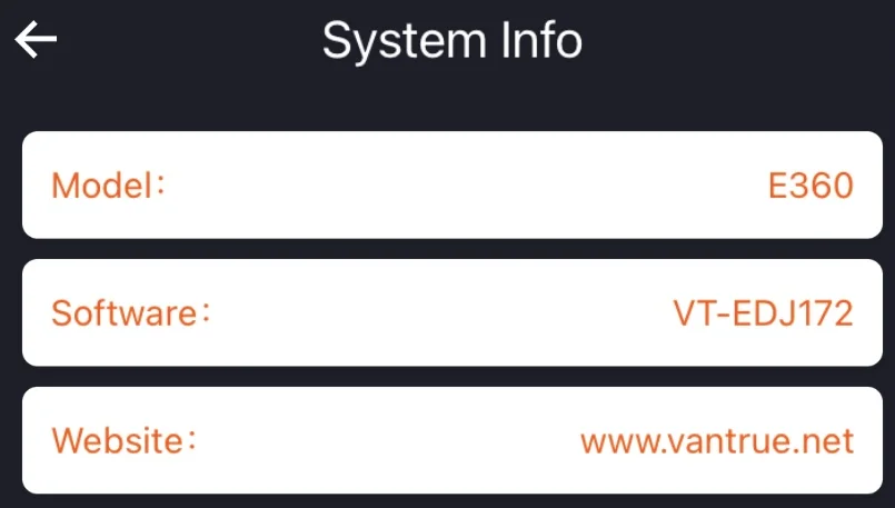

Here is my software version:
The power on/off behavior that I’ve reported so far involves having the camera attached to the hand held mount with the batteries in the handle. Mine powers up by pressing and holding the oval power button on the handheld mount for 2-3 seconds. This turns on the battery power and the camera turns on right away. Holding the round power button on the camera for another 3 count turns the camera off. Mine doesn’t do the power cycling that you are reporting.
You are still on old FW. Maybe that is why you are not seeing the issue. I updated the unit to VT-EDK271 very early so I cannot claim that that it is a FW regression.
Try to update your dashcam to the latest FW...
Same here. One of the first things it asked me was to update so not tested other firmwares. Also it was getting so hot on my desk that there is no way it wouldnt get damaged in a car.
