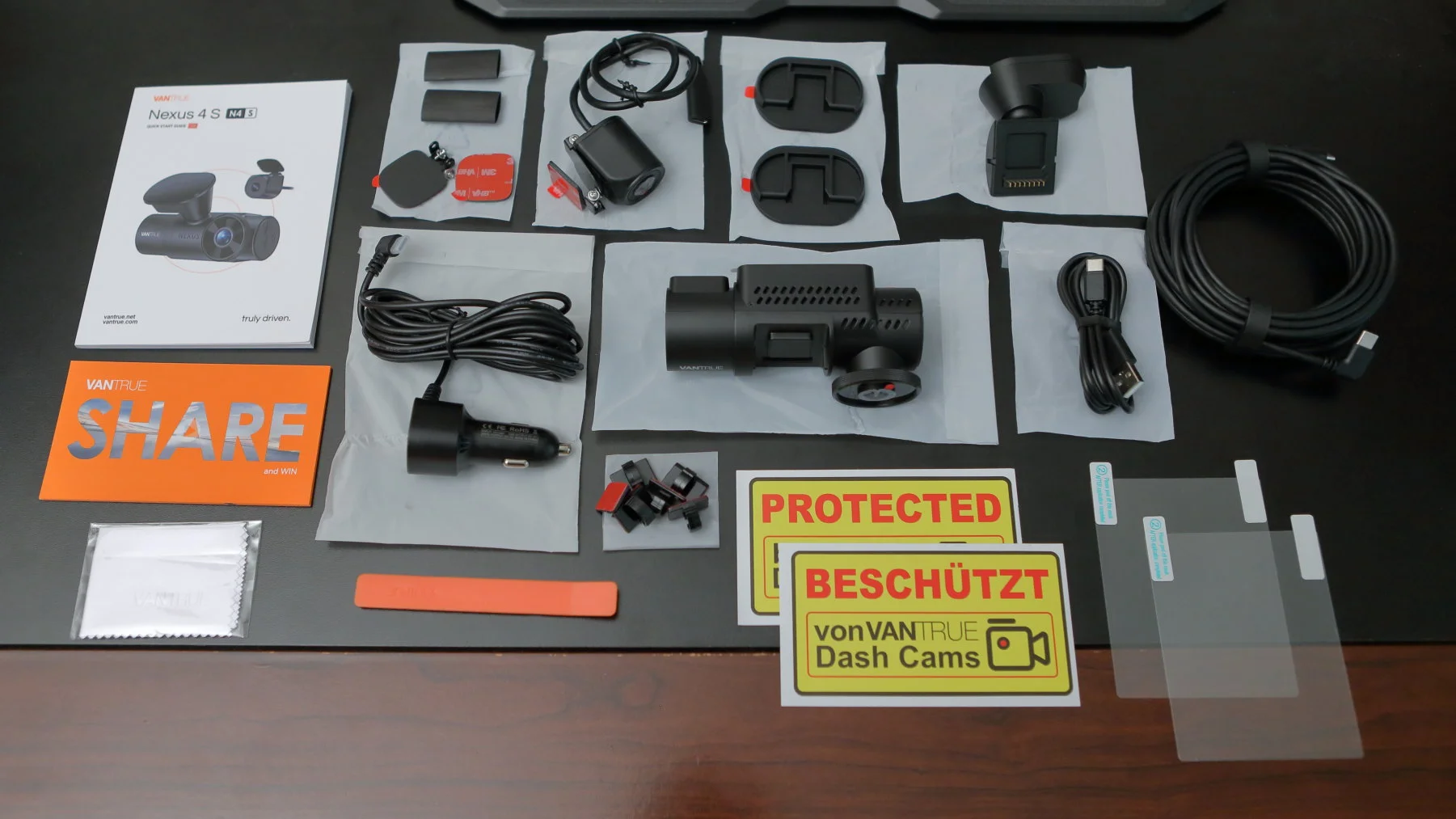

Below is everything that is included in the Nexus 4S box:

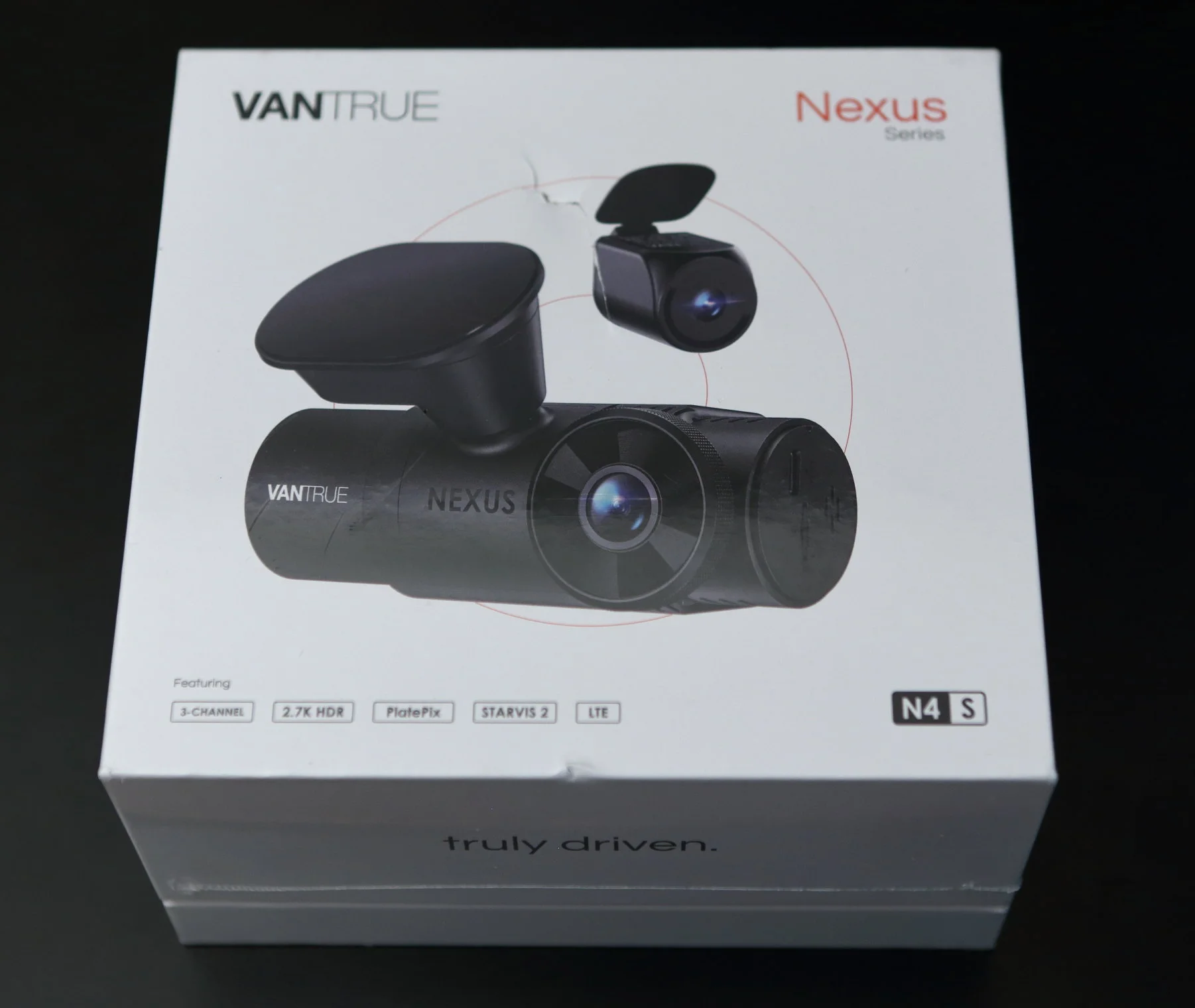

Here is an image of the shipping box as it arrived at my house earlier today. Looks like something heavy with a sharp edge was dropped on the box. Whatever it was made it through two separate layers of corrugated cardboard...
...and then all of the way through the product box as well. Here is the inside of the product box:
Fortunately, the next layer inside the box was the user manual, which showed no signs of impact at all. Great job, Vantrue!
This illustrates the value of sturdy product packaging. There is no accounting for what happens once the product gets shipped... In this case, all is well.
This is the main camera module for the Nexus 4S. The dent in the front is the magnetic mounting location for the GPS/windshield mount. You can also see the trademark Vantrue bulls-eye lens. This lens is exactly the same size as the lens on the E1 Pro camera, so the same circular polarizer will fit fine. Also obvious are lots of ventilation holes on the top.
The rear of the camera features the orange on/off push button switch on the left, a wide aspect ratio screen in the middle, and the cabin camera on the right. The symbols on the orange on/off switch are illuminated for easy access during night driving. This is a nice touch! A quick press of the power button makes an image and locks the current video whereas a long press turns the camera off.
This is the left side of the camera. You can see the USB port that powers the rear camera, the micro SD slot, a recessed reset button (that I've never had to use on any of my Vantrue cameras) and what I'm guessing is the speaker behind the four vertical slots. I do appreciate the vertical alignment of the USB-C slot to orient the cable toward the headliner, but I would appreciate more if all of the USB cables attached to the same general area on the camera to keep cable clutter a bit more neat when the camera is installed.
Below is the right side of the camera that contains the cabin camera and, of course, the camera model.
Here is the bottom of the camera, which features four buttons (the screen is not a touch screen).
The button on the left toggles record mode with a quick press and turns the screen on/off with a long press.
The second button toggles the microphone on/off with a quick press and toggles parking mode with a long press.
The third button switches among the active camera combinations with a quick press.
The fourth button activates the menu with a short press and toggles WiFi mode with a long press.
These buttons also serve as menu navigation. You can also see lots of ventilation holes, the microphone, and the serial number that I blurred.
The top of the camera features lots more ventilation holes to help keep the circuitry cool.
And finally, here is the screen that faces the cabin. Compared to the E1 Pro and the E360, the screen on the N4S is pretty large, measuring 40mm wide by 30mm high.
The cabin camera on the right has four IR LEDs built in, one in each corner around the lens. These can be controlled with the app and can be set to AUTO, ON, or OFF. It's funny to see how much dust there is when you shine a bright light on things for a closeup image 😉
The windshield mount houses the GPS unit and also has the USB-C power input adapter. It features a magnetic mounting plate that holds the camera VERY firmly. It's so firm that it took me a while to figure out how to disengage it from the camera again! Turns out, you just pull it straight out from the camera...
There is a fair degree of movement available in the swivel clip. Here is an image with the mount swiveled as far down as possible.
And this time swiveled up as far as possible:
The mount will also swivel left and right, which I REALLY appreciate because it seems that no matter how hard I try, I never get my Viofo camera quite level with the road when I install it. If the windshield of your car is very vertical or very slanted, you might not be able to angle the camera enough to get a level view of the road. I'll do an installation in the next day or two to see how things go.
You can also rotate the cabin camera up or down by a fair amount. Here are two images with the cabin camera tilted to its extremes. This first image is with the cabin camera tilted fully upward, about 45 degrees...
...and then fully downward by another 45 degrees, for a total of 90 degrees of movement.
Here is the rear window camera. It is new design that allows mounting either inside the rear window or, due to its IP67 water resistance, it can be mounted on an external surface of your vehicle. The built in cord for the rear camera is ~50cm/20in long and features a USB-C female connector.
Here is another view of the unique mounting bracket for the rear camera. There are two hinges and each has a full 180 degrees of movement to it, so you can mount the rear camera on virtually any surface with any orientation. There is even a menu setting that allows you to flip the image before it gets recorded.
The rear camera bracket folds up completely flat on top of the camera and opens up nearly completely flat as well. Here is a side view.
It does not appear that the rear camera will accept a circular polarizer:
Here is a better view of the USB-C female plug. If you are mounting this on an exterior surface of your car, you'll need to undo a trim piece and run the wire under the trim. The USB-C connector is fairly large.
One of the little pouches contains an additional mounting plate for the rear camera and it comes with a pad of 3M VHB already attached, plus one spare adhesive pad. Both pads have a nice little pull tab as you can see. It is difficult to overstate the value of those little pull tabs. If you've ever cut and placed your own VHB, you've no doubt struggled with separating this stuff like I have. It's infuriating, hence my appreciation for the pull tab!! There are also a spare set of mounting screws and two lengths of shrink wrap if you choose to install the rear camera on the outside of you car (it has IP67 water resistance).
Like the E360 Pro camera, the N4S windshield mount comes with TWO detachable clips that stay put on the windshield, enabling you to easily move the N4S between two different cars with ease. As is customary, 3M VHB has already been applied and comes with a handy pull tab for easy installation. While they look similar, the clip that mounts to the windshield for the N4S is slightly different from the adhesive windshield mounts for the E360 camera.
The windshield mounting plate (on the left in the image below) for the N4S camera is highly similar to, but slightly more rounded than the one from the E360. The N4S mount will "click" into place for both the N4S and the E360 GPS mounts. However, the windshield mounting plate from the E360 fits the N4S GPS mount, but won't click/lock into place.
Also, I appreciate that Vantrue changed the 3M adhesive for the windshield mount from light grey to BLACK. This blends in better and provides a cleaner look from the outside of the car.
The utility outlet power cord is a new design. The power adapter that came with the E1 Pro and the E360 had a removable tip that revealed a replaceable fuse. This newer utility plug does not appear to have a tip that unscrews, though I am told there is indeed a fuse inside. I need to ask how to access the fuse because it's not obvious...
You can also see the current ratings of 2A for the USB-A port and 3A for the USB-C cable that plugs into the camera's GPS unit. The USB-C cable measures 11.5 feet, so it has plenty of reach.
There is still the nice green LED to show that adapter is indeed receiving power.
Placing the "original" utility plug from the E1 Pro (which is identical to the one that shipped with the E360) next to the "new" utility plug that shipped with the N4S, some additional physical differences emerge. The image below highlights these difference. The new plug features a slightly tapered barrel shape - it is more narrow at the tip than at the base where the wire attaches. This new plug is also more narrow than the original plug by a small, but meaningful, amount. Further, the electrical spring tabs on the new barrel are more narrow by more than one full mm. The end result is that the newer utility plug does not fit as snugly or as securely into the utility port. When I insert the older, original plug, it goes in and stays in, exactly where I put it. It requires a bit of force both insert and remove it from the utility port. When I insert the newer plug that came with the N4S camera, it is much more loose in the socket and when I fully seat it, the spring loaded tip pushes it back out a little bit. This could be a problem if the utility plug wiggles itself loose due to vibrations in the car that result in the camera losing power and shutting down. You might not necessarily notice this as you are driving and have the radio on.
Needless to say, I prefer the original design because it seats itself much more securely in my car's utility port.
The last divider box contains some adhesive windshield clips to keep the wires in place for those that don't want to play with removing A-pillar pieces, the now familiar 1m/3.3foot USB-A to USB-C power cable, a 20-foot USB-C cable that connects the front camera to the rear camera, and an orange plastic crow bar for lifting vehicle trim pieces and/or tucking wires into hard to reach places.
