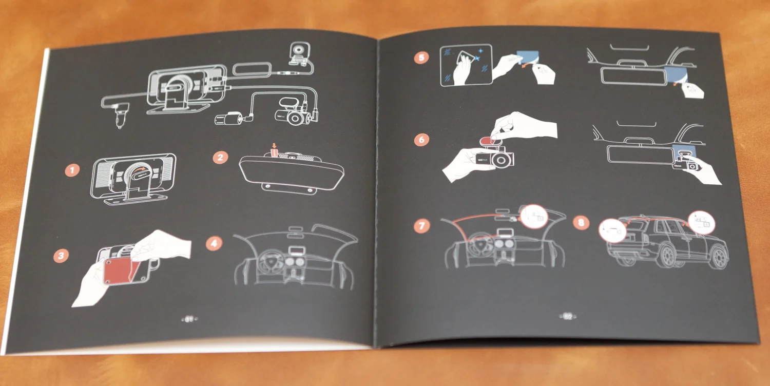

The Quick Start guide (lower left in the above image) is a very nice set up guide for how and where the camera and cables get connected, conveniently written in the universal language of images along with QR codes for installation videos and the PDF User's Manual. Both are very nice!

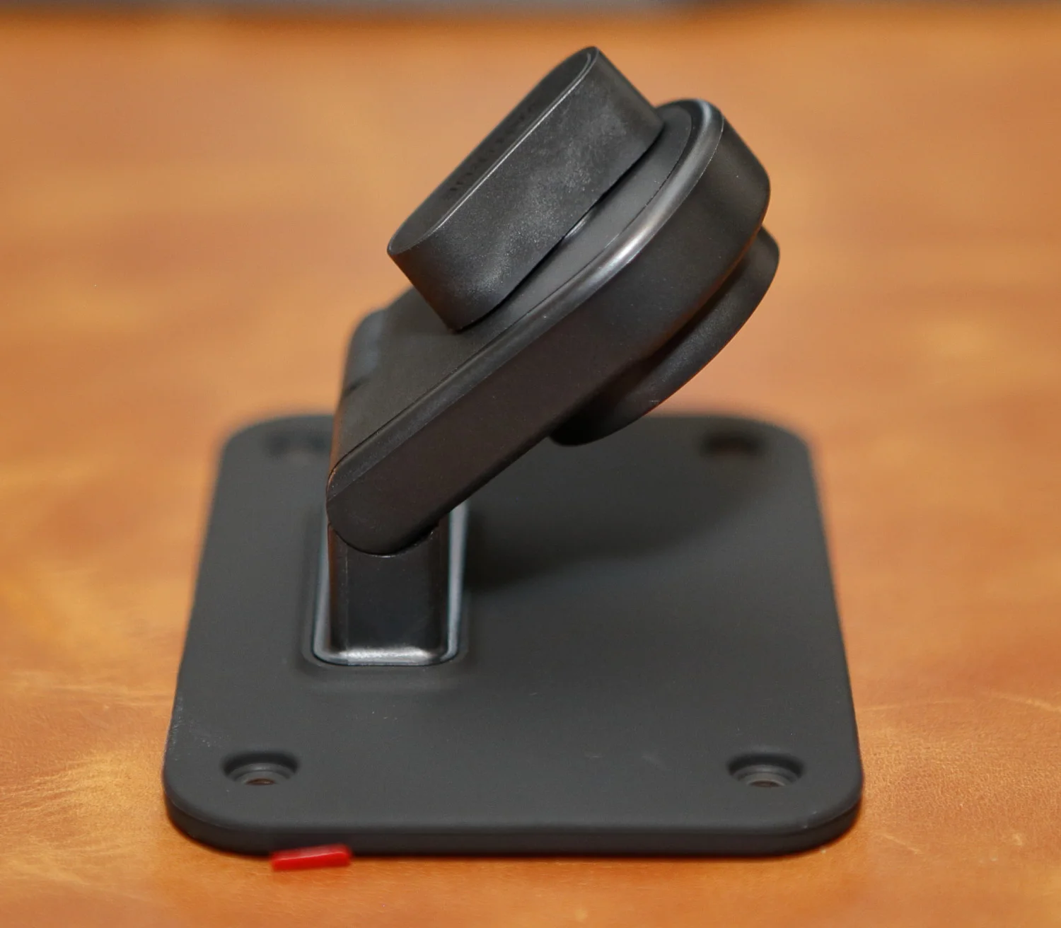

Here is a side image of the main camera with the mounting surface as far forward as it will go. As you can see, this camera will clearly mount on a fully vertical front window like on a bus or a truck. This is a very nice feature!
And here is the same perspective with the mount rotated fully in the opposite direction. This greatly increases the range of mounting positions and locations for the forward facing camera!

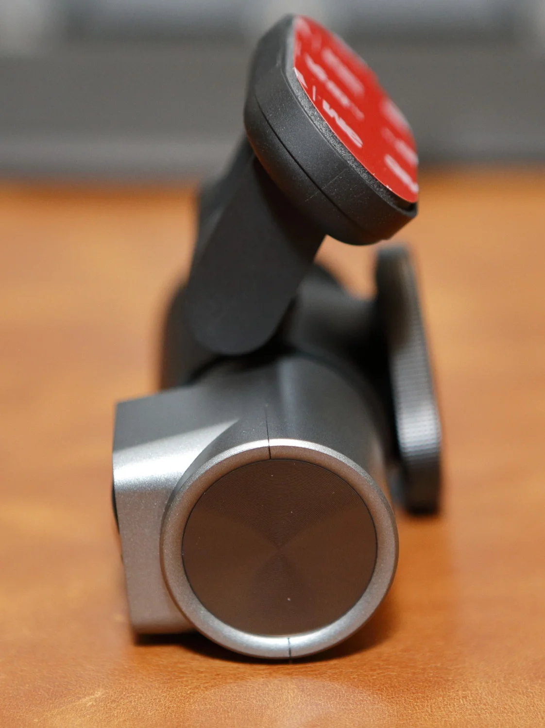

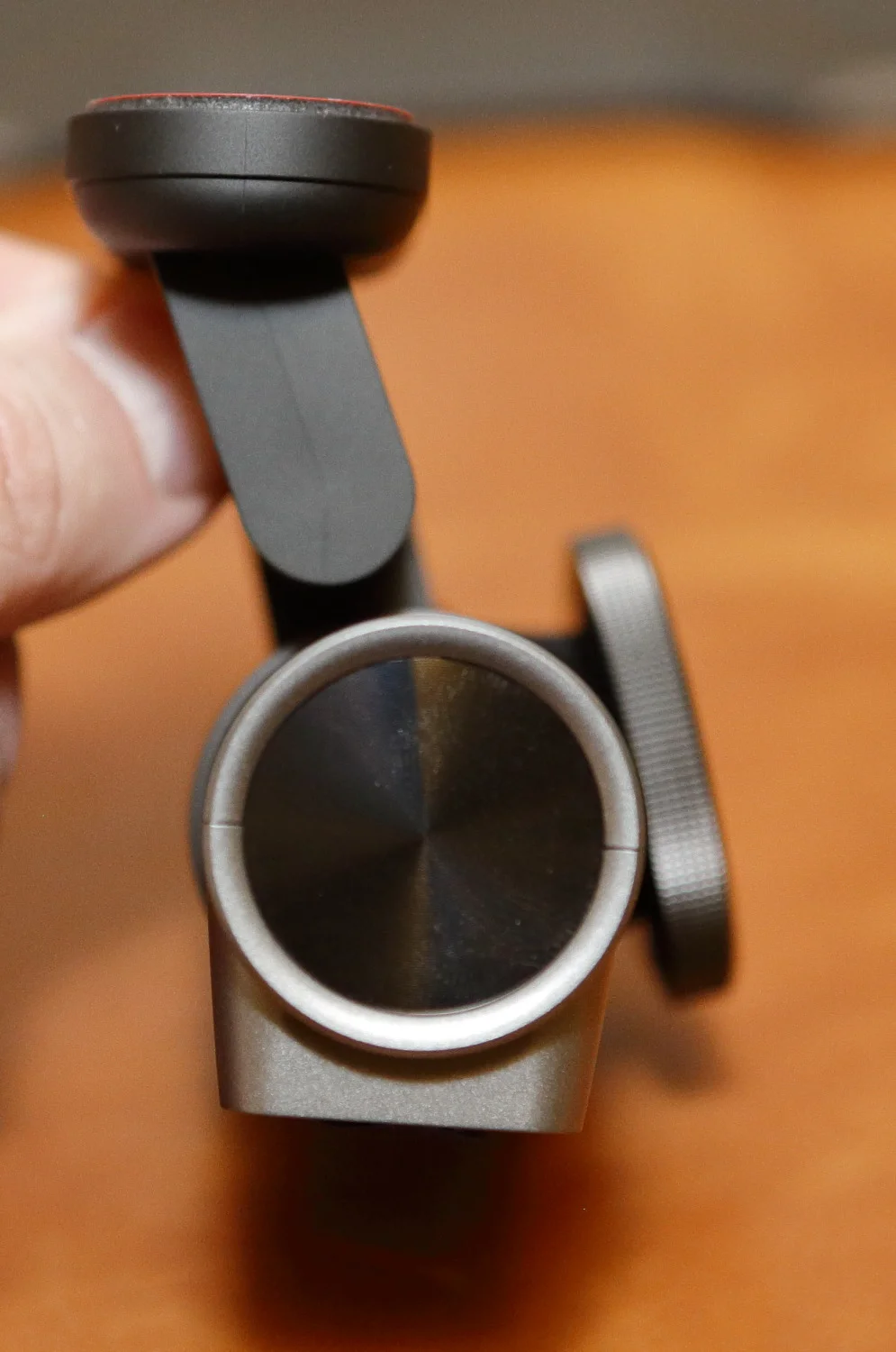

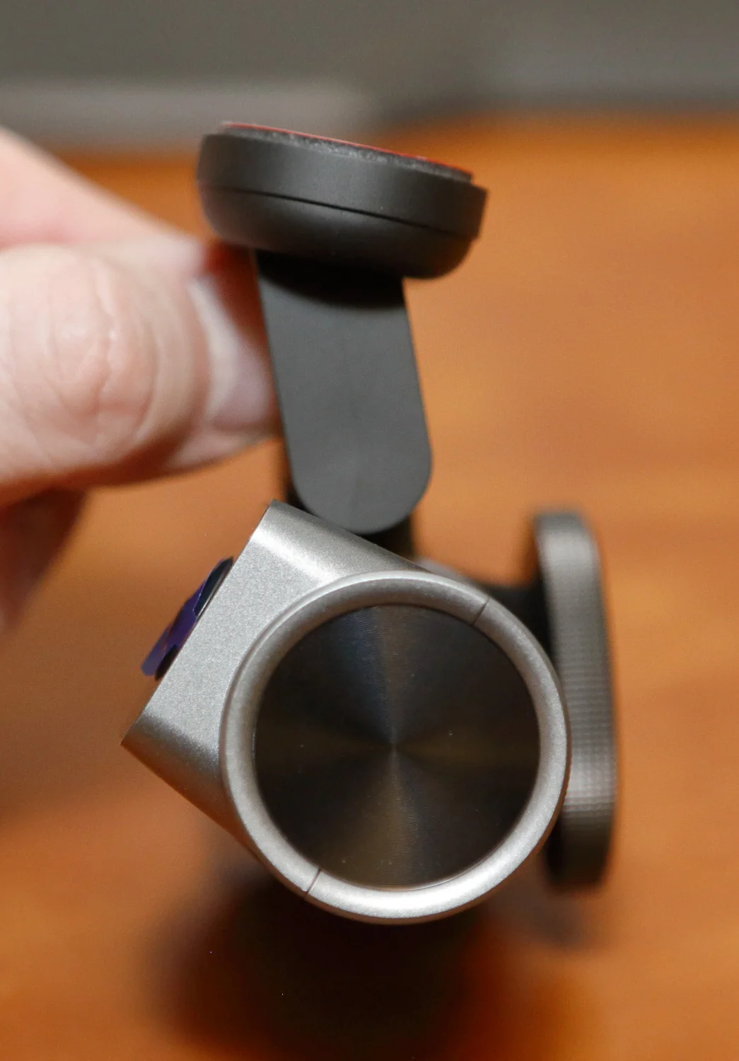

Which takes us to the first, cool, new feature for the main camera. It sports a brand new windshield mount design that is pretty awesome! You might have noticed in my images above that the mount looked a little "crooked." I noticed this as soon as it came out of the box and though that I had somehow damaged it already. But then I discovered what was going it: it's a SWIVEL MOUNT! Super Awesome! If you are like me, it's next to impossible to mount any dashcam square and level on your first try. Then you're stuck trying to remove the 3M VHB or repositioning the static mounting sticker. What a pain... But not anymore!
Check this out - here is the camera with the mount swiveled as far left and right as possible:
And at the opposite extreme. This will provide a greater range of options for how and where you mount the main camera. Very cool! Thank you for this very thoughtful feature!!
For a size comparison, here is the main camera from the P2 (on the left) next to the larger N4 Pro S camera (on the right).

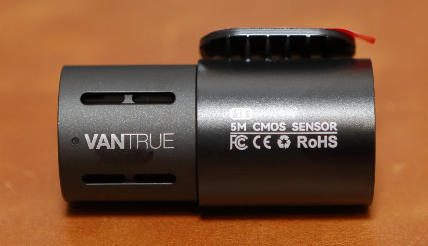

Here is the rear camera, which also sports a number of new and welcome features! First, it's pretty tiny, which I especially appreciate as I have about 4 or 5 cameras lined up across my rear window at most times for comparison purposes. I also understand that we have DashCamTalk user @jsmith to thank for this design improvement over the older "accordion" style mount from earlier camera models. This barrel shaped camera will eliminate vibrations in the resulting video stream.
Don't forget to remove the lens protector...
Here is the rear view of this rear-facing camera. As you can see, some air vents have been added to help keep the sensor cooler. The camera barrel appears to rotate through a full 360 degrees so you can aim it wherever you need. Like the front camera, the rear camera can be mounted on a fully vertical rear window like you might find on a pickup truck. And, best of all, the rotation of the camera features physical detented stops every few degrees that will help prevent the rear facing camera from moving once you install it. This was a suggestion that I made to @Jeff_Vantrue with my review of the N5S camera. Thank you for listening to my input! Also visible directly to the left of the "V" in Vantrue is another small LED power indicator light so you can tell the camera is receiving power.
Here is the side view of the rear camera - it's a regular USB-C connector (no orientation keying as we see on the main camera unit):

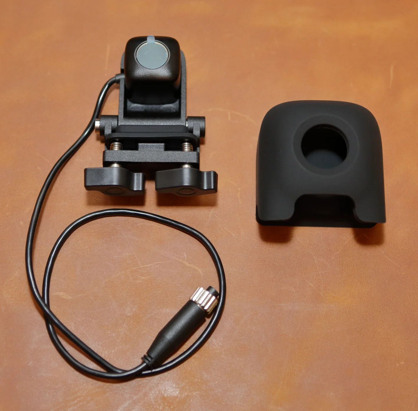

And, finally, here is the star of the show and the last component that is tucked into the first sub-divider box: (drum roll, please...) the forward facing Thermal Camera Unit!
Here is the front of the thermal camera, encased in its protective rubber shell and attached to the hood mount clamp.. You can also see the tethered cable with the screw-terminal at the end. I don't know that the actual resolution of the thermal sensor is, but in the thermal imaging world, "medium resolution" is generally in the vicinity of 340x240 pixels and "high resolution" generally means something closer to 640x480 pixels. Thermal cameras generally have a spectral range of 8µm to 14µm, and are referred to as "longwave" cameras.
Here is the rear view of the camera. It has a rather thick and substantial rubber cover that protects it from debris while mounted externally on your car. The two thumb screws that you see on the bottom of the camera open up a small clamping mechanism that attaches the thermal camera to the rear edge of your hood.
This is the thermal camera with the rubber protector removed. The thermal camera itself is quite small.
In the image below, you can see that I've opened the hood clamp by turning the screws.
Here is a better view of the open hood clamp. The top and bottom layers of the clamp are made from firm by still soft rubber to protect the paint on your hood. From the side view, you can also see the stainless steel barrel screws that allow you to pivot the thermal camera up or down once it is mounted on your hood. I very much appreciate the additional screws in the event you inadvertently lose one or two of them!
This is a close-up image of the cable connector for the thermal camera. As you can see, it is a 6-pin keyed connector, so it plugs in in a single orientation. I also appreciate he red rubber/silicon sealing ring to keep water out of the cable connection. This is another nice touch that illustrates thoughtful design.

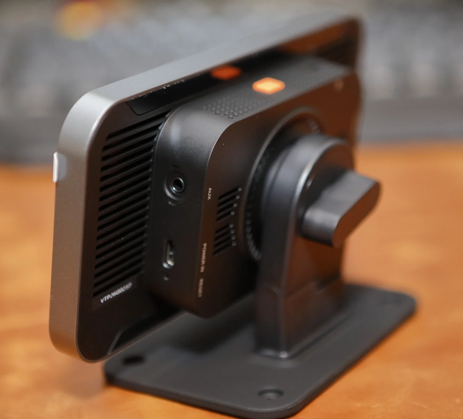

Here is the rear of the display module with the mounting plate removed. The threads on the back are exactly the same as a standard 1/4" threaded insert into a DSLR or a video camera for a tripod mount 👍. Perhaps this will make finding a suction cup mount a little easier... I'm reluctant to use an adhesive mount on my leather dashboard.
You can see the labels on the back where each of the cables go, so hookup should be pretty straight forward. Cables mount into the sides of the unit, and the SD card is inserted into a slot on the top.

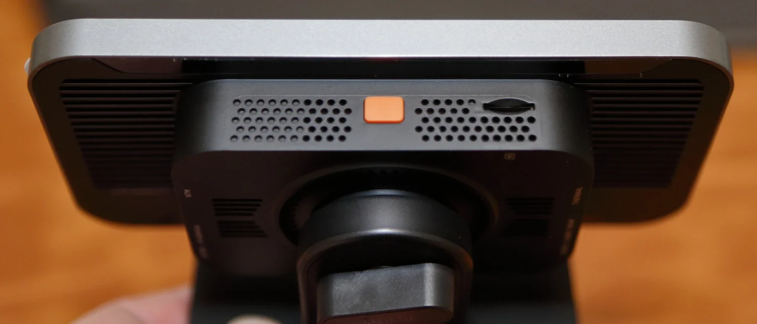

Here is the top view where you can find the power button and SD card slot. Pushing and releasing the button quickly toggles the display screen on and off. Push and hold the orange button to turn the camera on and off.
The adhesive mount is hinged and swings through a pretty wide range of angles, so mounting should be pretty flexible to account for a variety of dash configurations and still letting you see the screen with ease.

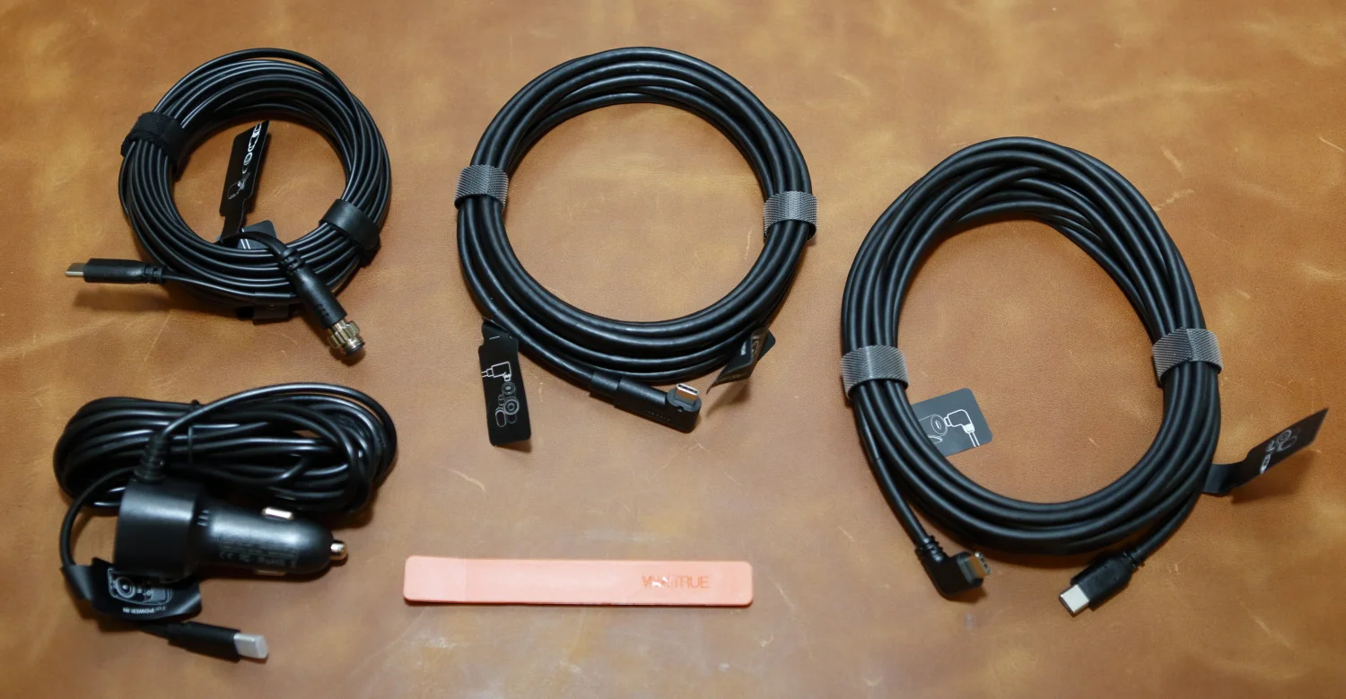

The second inner divider box contains all of the cables that are necessary to connect the camera modules together. A new feature for Vantrue with this camera is the inclusion of very clear cable labels so you know exactly where each cable gets plugged in.
First up is the utility port power adapter that has a USB-A port on the plug and a USB-C connector at the end of the cable. As has been discussed many time here on the forum, it is important to use the power supply cord or hardwire kit that actually comes from the manufacturer. This is especially important for the P2 because it's power draw is much larger than other cameras. This one needs a 5v 3A power supply. The only Vantrue hardwire kit that supplies enough power is the VP05 (II) hardwire kit. The others don't have the ability to deliver the needed current.

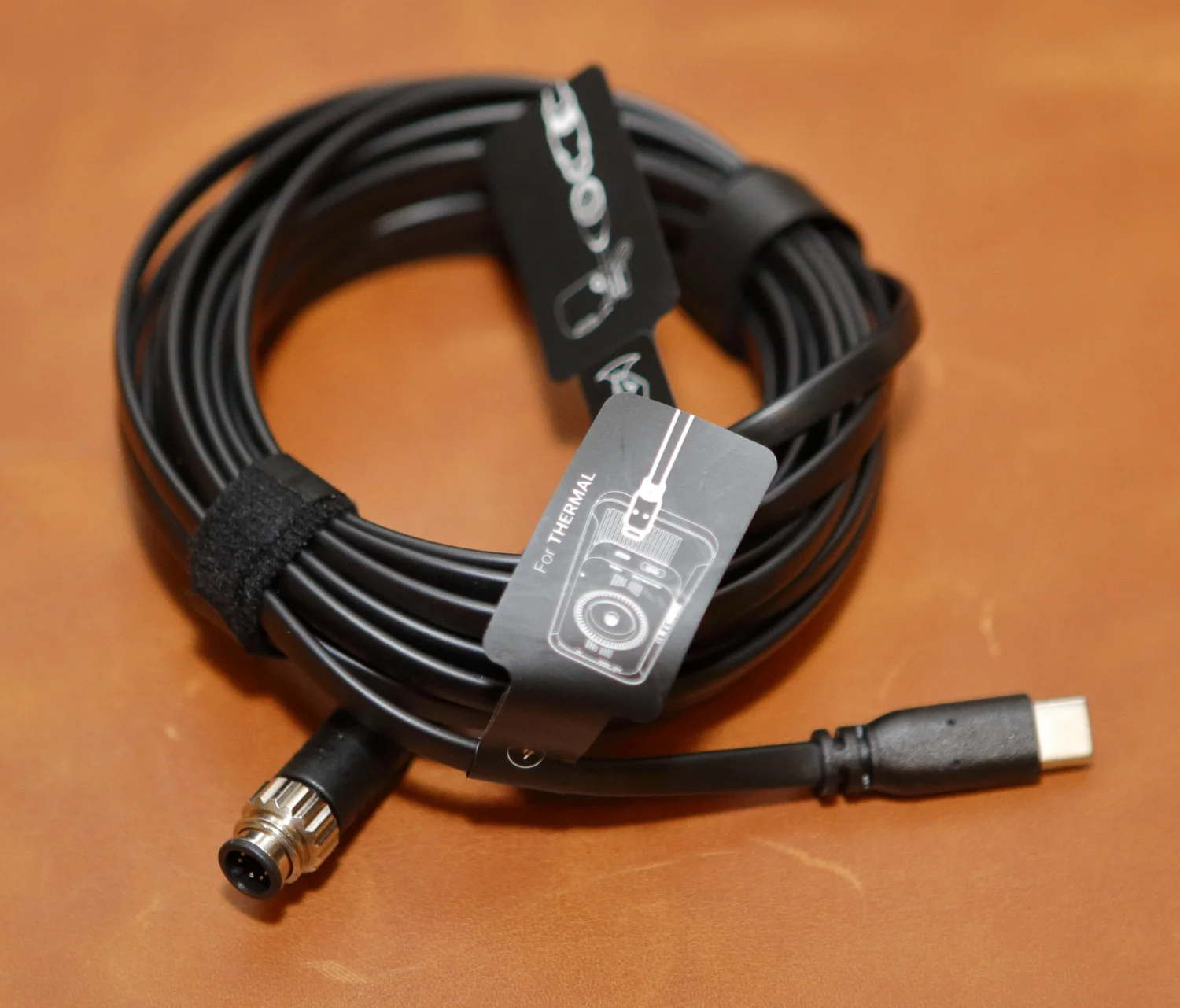

The cable that connects the thermal imaging camera to the display unit is a flat cable, rather than the usual round USB-C cable.
The thermal camera cord measures just over 2mm thick and a bit over 5mm wide. This is a nice change from the externally mountable cameras from the N4S, N4 Pro S, and S1 Pro Max that have round cords. This one will pass more easily over rubber door seals due to it being flat instead of round! This was a specific recommendation that I made to @Jeff_Vantrue so it's nice to see this being implemented! I really appreciate seeing suggestions from the forums showing up in new product releases!
And a closeup of the male 6-pin barrel connector:

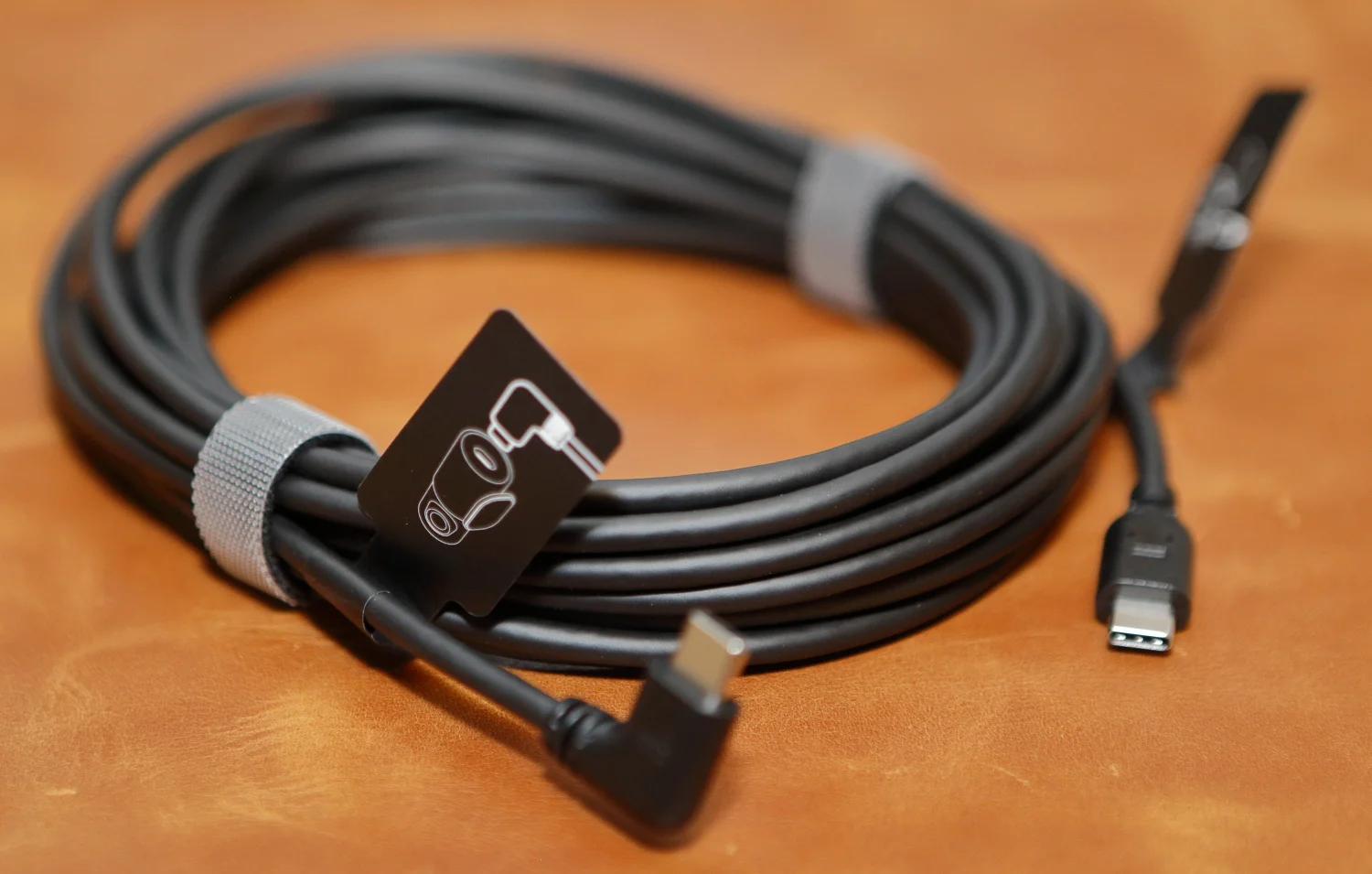

The longer of the regular USB-C cables is for connecting the rear camera
And the shorter USB-C cable connects the main camera to the display unit:

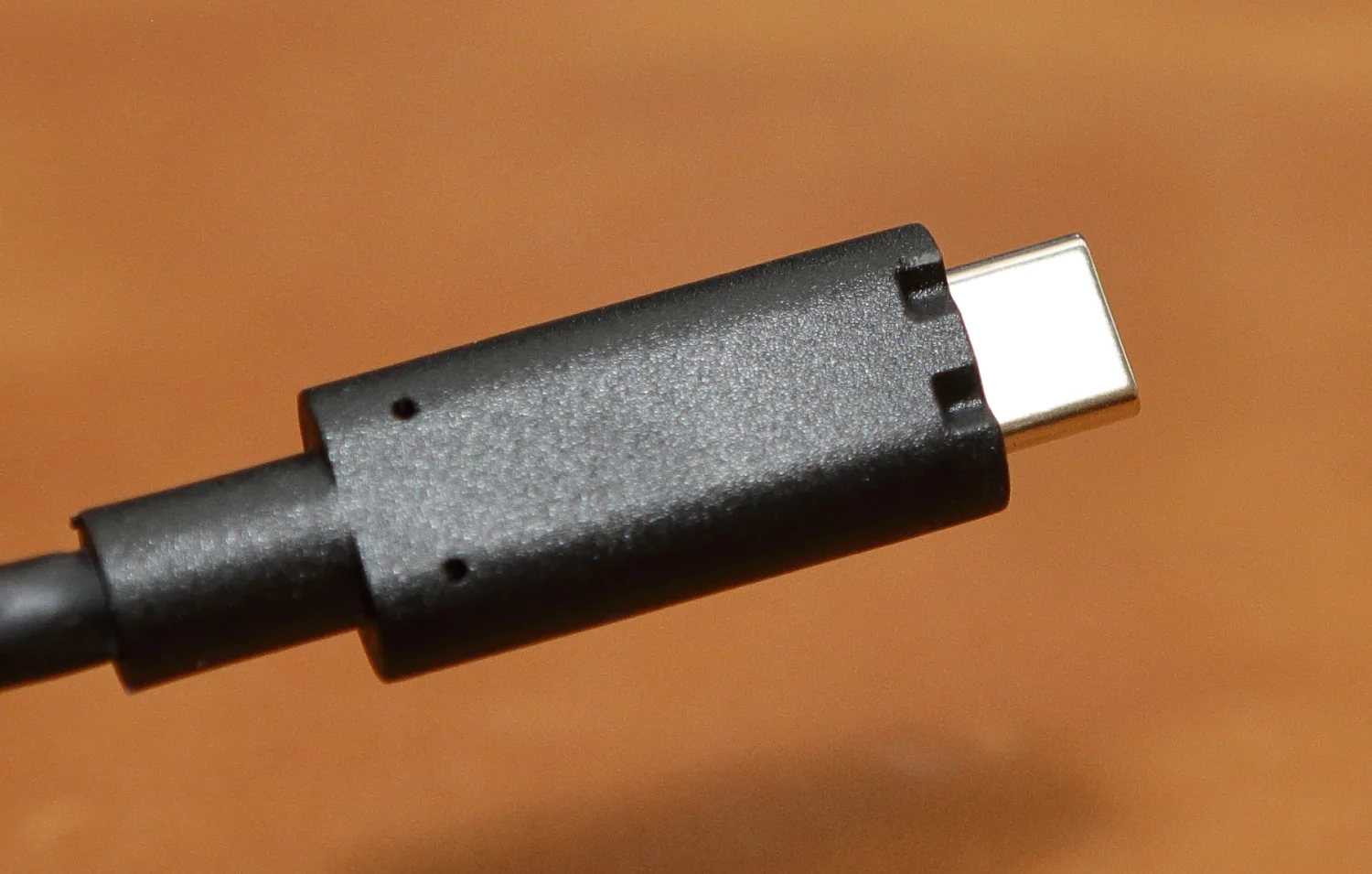

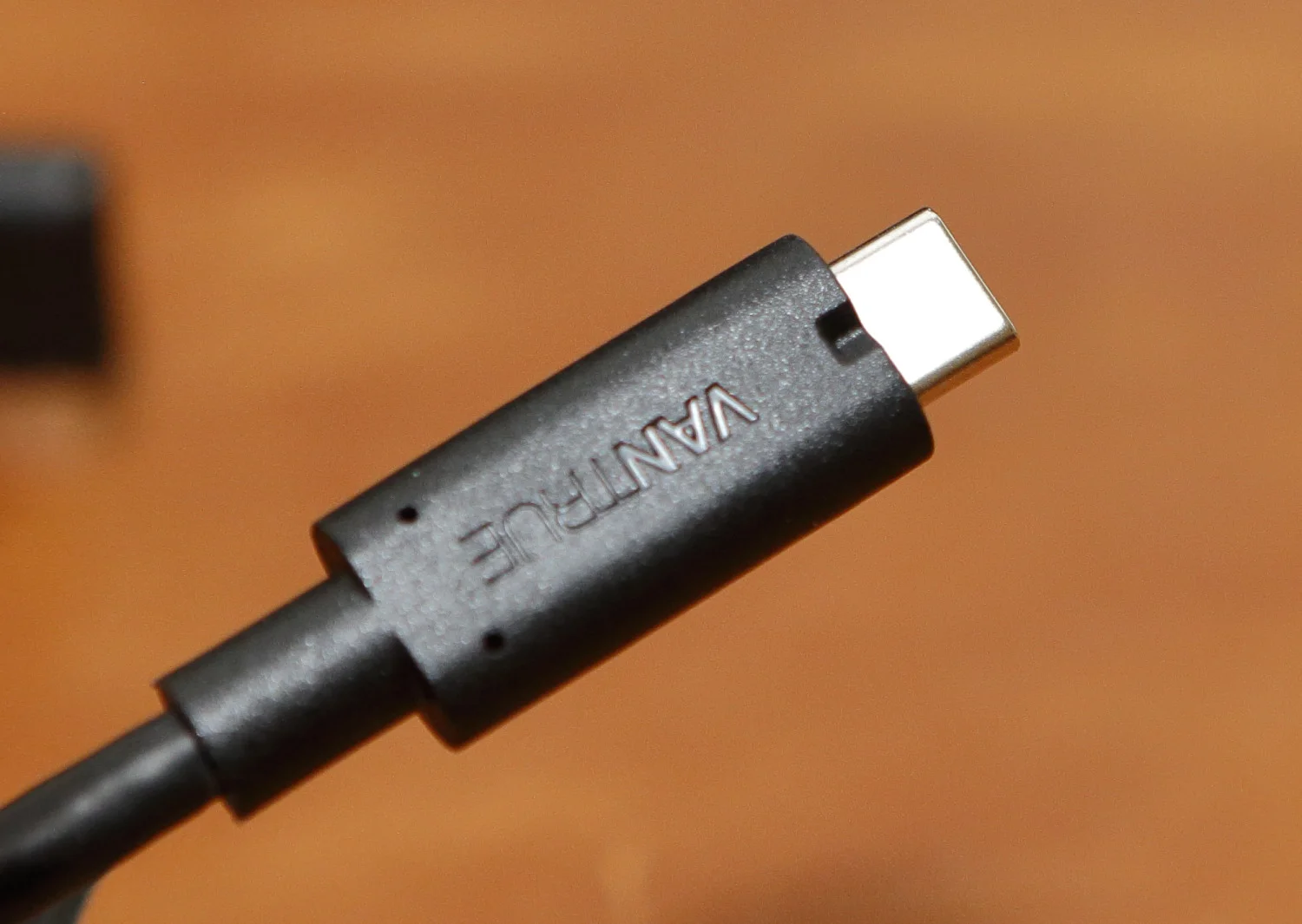

As I pointed out earlier, the USB-C ports that connect the main camera to the display unit appear to be keyed so the USB cable can only be attached one way. Looking at the ends of the USB cable, you can see corresponding indents molded into the cable ends, so it's impossible to mix up the cables.
and on the other side of the same cable end:
The cables are easy to distinguish as each has a nice tag on the end. I appreciate that these cable ends are black instead of white, so if you leave them in place, they don't stand out quite so much.
