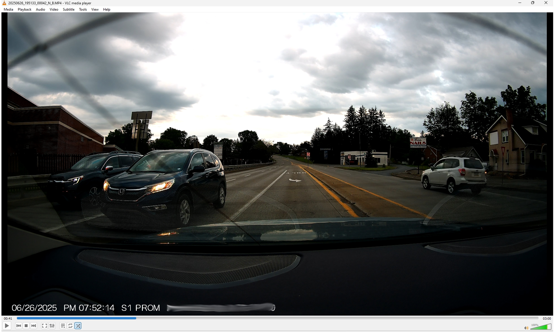

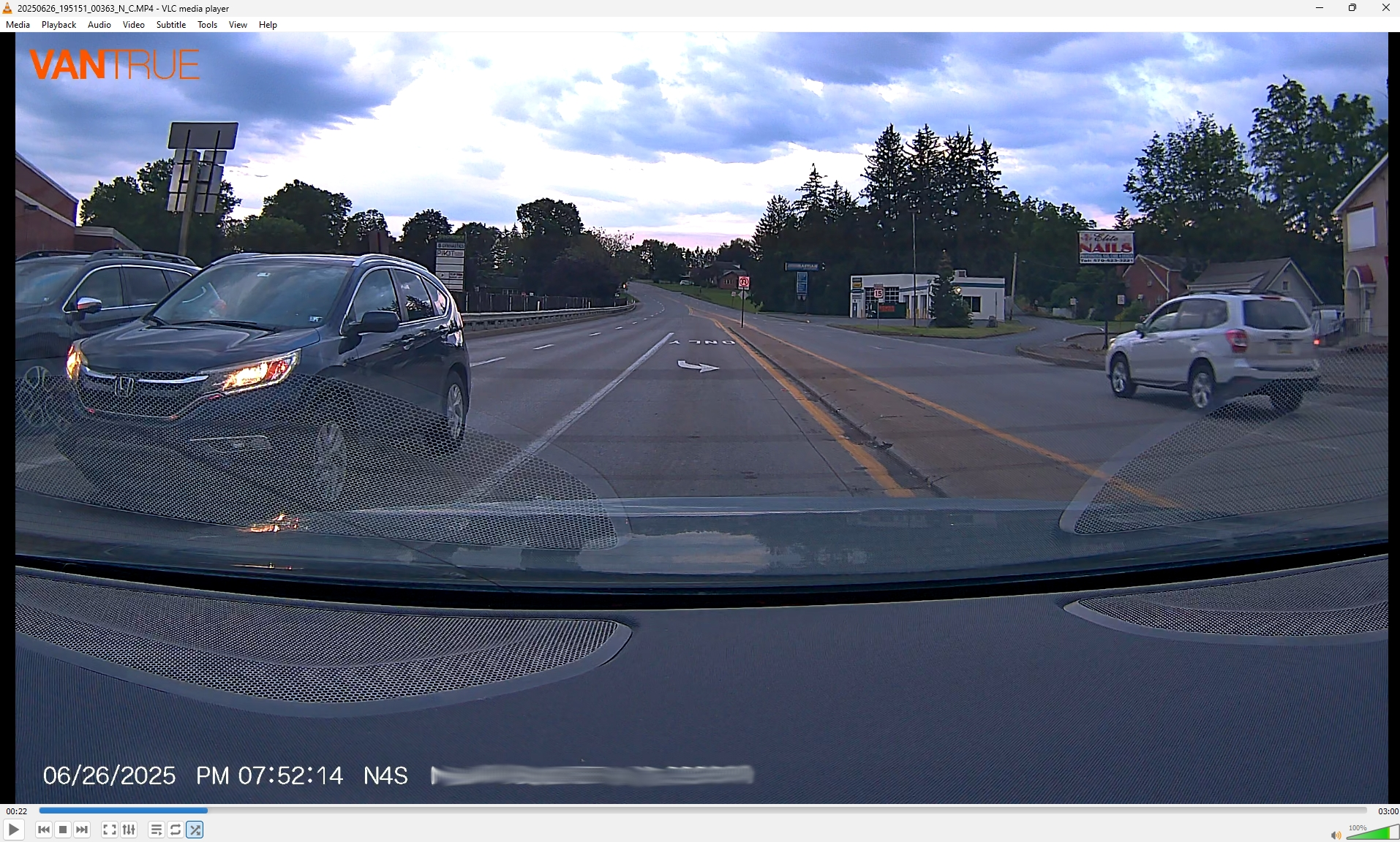

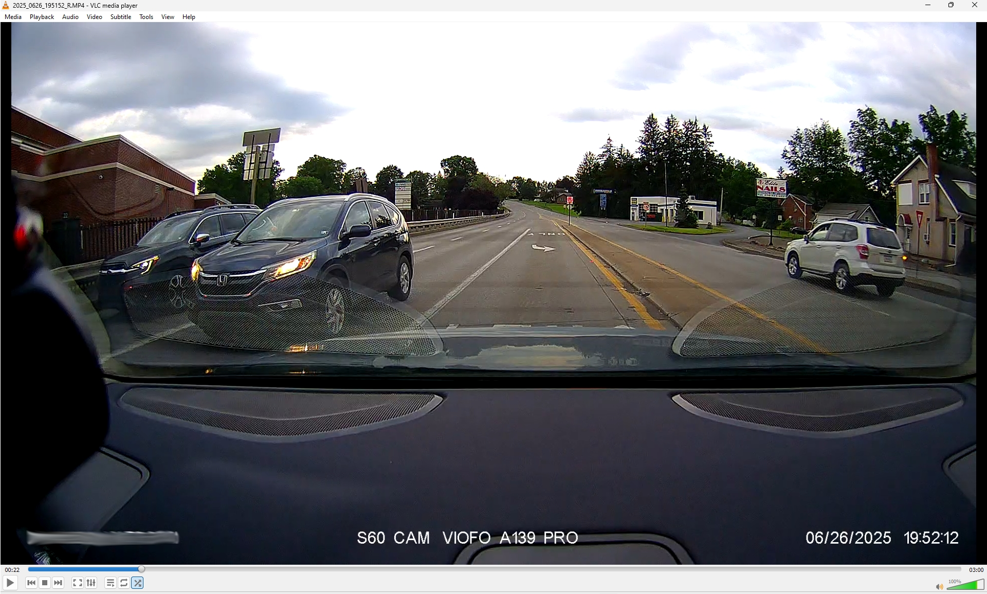

Here is my first set of comparison images, all three from the rear cameras this time. This might not be an ideal comparison as I neglected to align the vertical aim of each camera. The N4S shows a bit more sky than the A139 Pro does, and the S1 Pro Max shows yet more sky.
The A139 Pro seems to have the most realistic color and lighting (most true to what the eye sees), it also has about the same horizontal angle as the S1 Pro Max.
The S1 Pro Max has the greatest amount of contrast and the lowest level of overall brightness in the foreground. It also exhibits the least amount of window reflections. Enabling HDR might show some positive impact on this image.
The N4S shows the brightest overall rear image, the greatest amount of color, the least contrast in the image, but the greatest level of window reflections.
Viofo A139 Pro rear camera, no HDR function, 1920x1080P, 30fps, 16.4Mb/s:
Vantrue N4S, rear camera, HDR off, PlatePix on (not sure if this impacts the rear camera), 2560x1440P, 30fps, 14.3Mb/s:
S1 Pro Max, rear camera, HDR off, PlatePix on (not sure if this impacts the rear camera), 3840x2160P, 30fps, 23.8Mb/s:

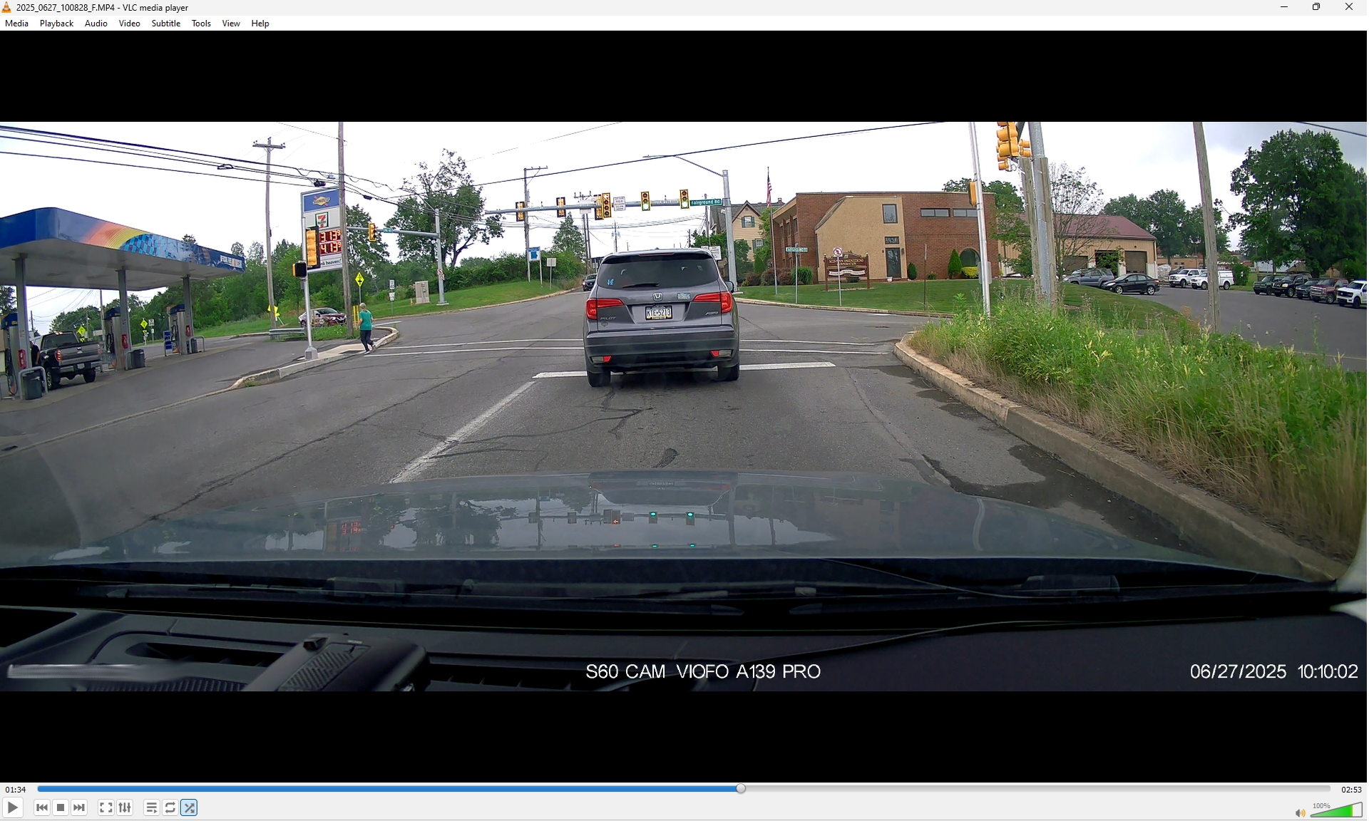

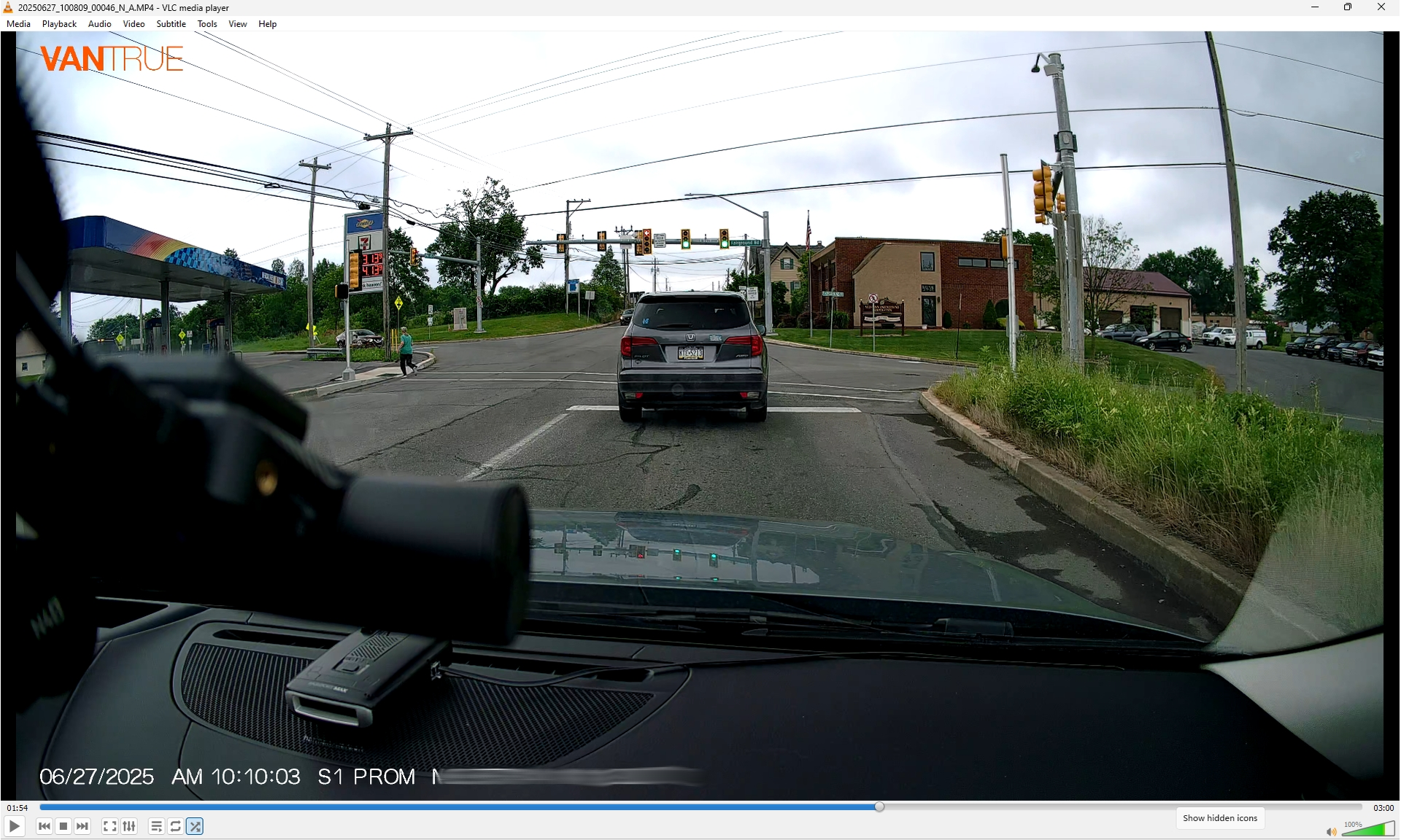

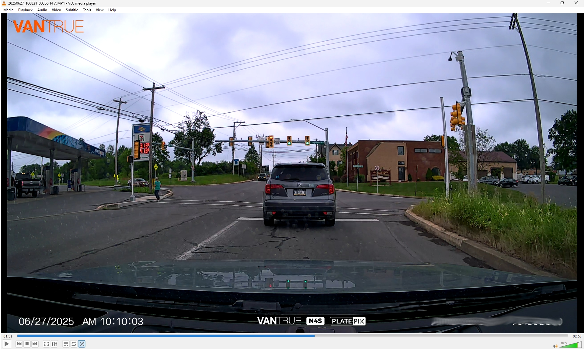

I've been waiting for a day with some nicer weather to make some more videos. Here is a comparison across the S1 Pro Max, the N4S, and the Viofo A139 Pro. The A139 Pro and the S1 Pro Max have very similar horizontal angle of view, the N4S is slightly more narrow in framing. The light had just turned green, so I was moving relatively slowly at this point, likely 5-10 mph.
First up, my Viofo A139 Pro, 3840x1600P, HDR off
Then the Vantrue N4S: 2560x1440P, HDR off, PlatePix On
And the new S1 Pro Max, 3840x2160P, PlatePix on (I think - I need to check the stamps setting in the menu), HDR off:

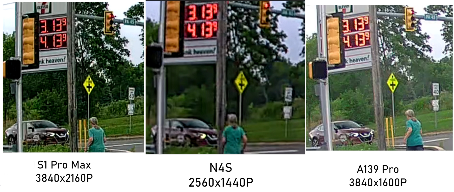

And some detailed comparisons. I used CapCut to zoom in 200% on the same areas for some resolution/clarity comparisons. Earlier, I had noted that the N4S has greater linearity than the A139 Pro. This shows the S1 Pro Max does even better, the sign at the gas station exhibits the least amount of curve due to lens distortion. The S1 Pro Max does the best job with the illuminated prices as the gas station, keeping them from being over exposed or blurred. Also, the speed limit sign is best rendered by the S1 Pro Max.

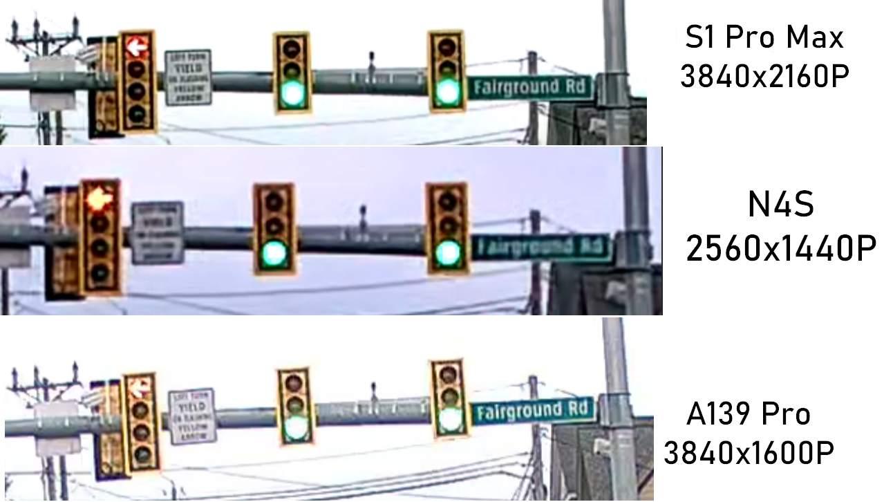

And the road sign and traffic light detail from the same frames above, also zoomed 200%. The S1 Pro Max and the A130 Pro offer similar detail (both use the same Starvix 2 IMX678 sensor, so this isn't a surprise, however the S1 Pro Max features additional image processing which seems to give it a slight edge in fine detail and readability. The greatest difference can be seen in the power line over the "Fairground Rd" sign.
The clarity advantage seems to go to the S1 Pro Max, but the N4S has that nice IR illuminated cabin camera that makes it ideal for taxi/rideshare use, or to keep an eye on new drivers when they go out with their friends.

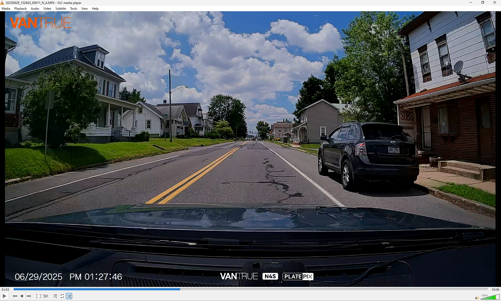

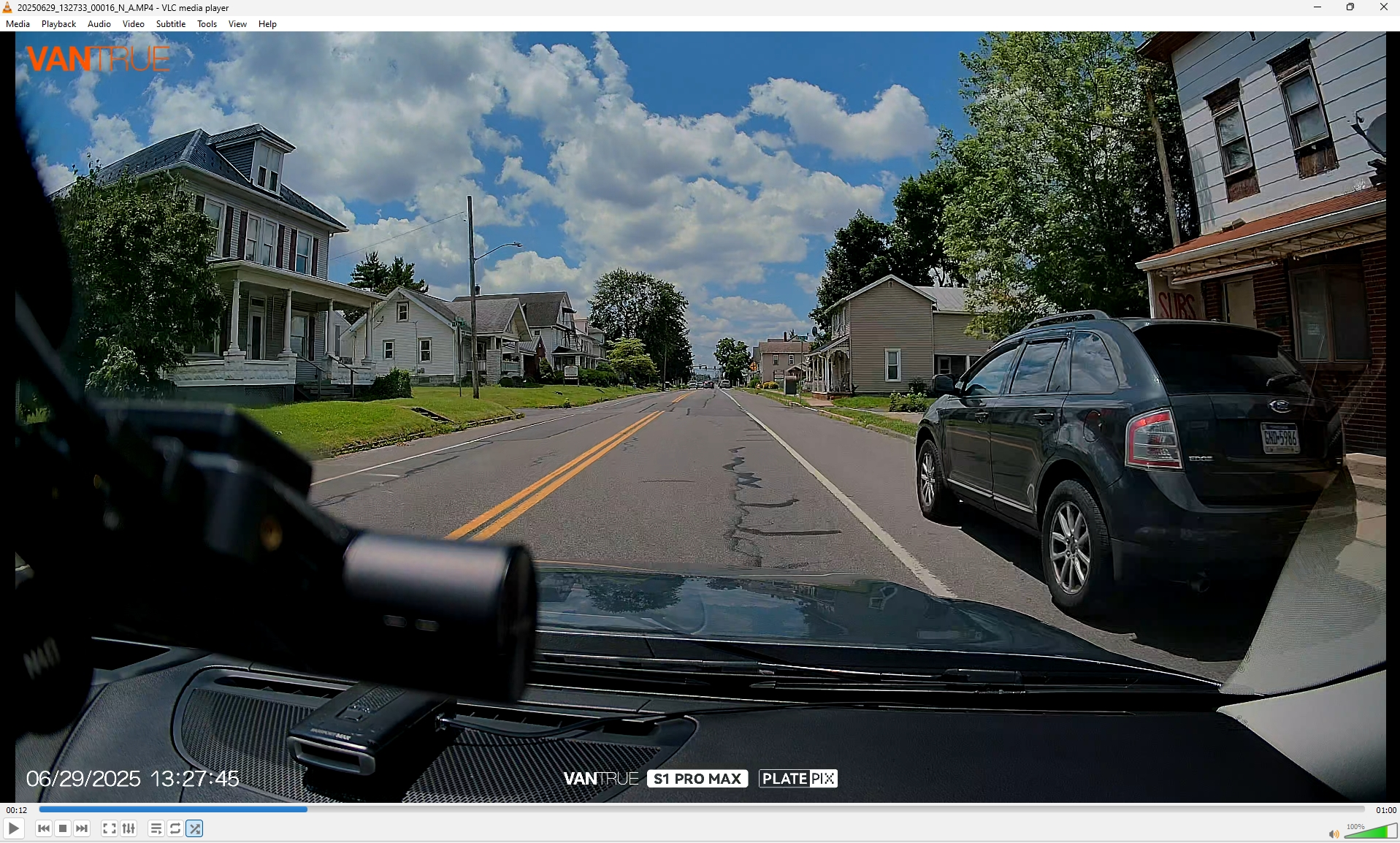

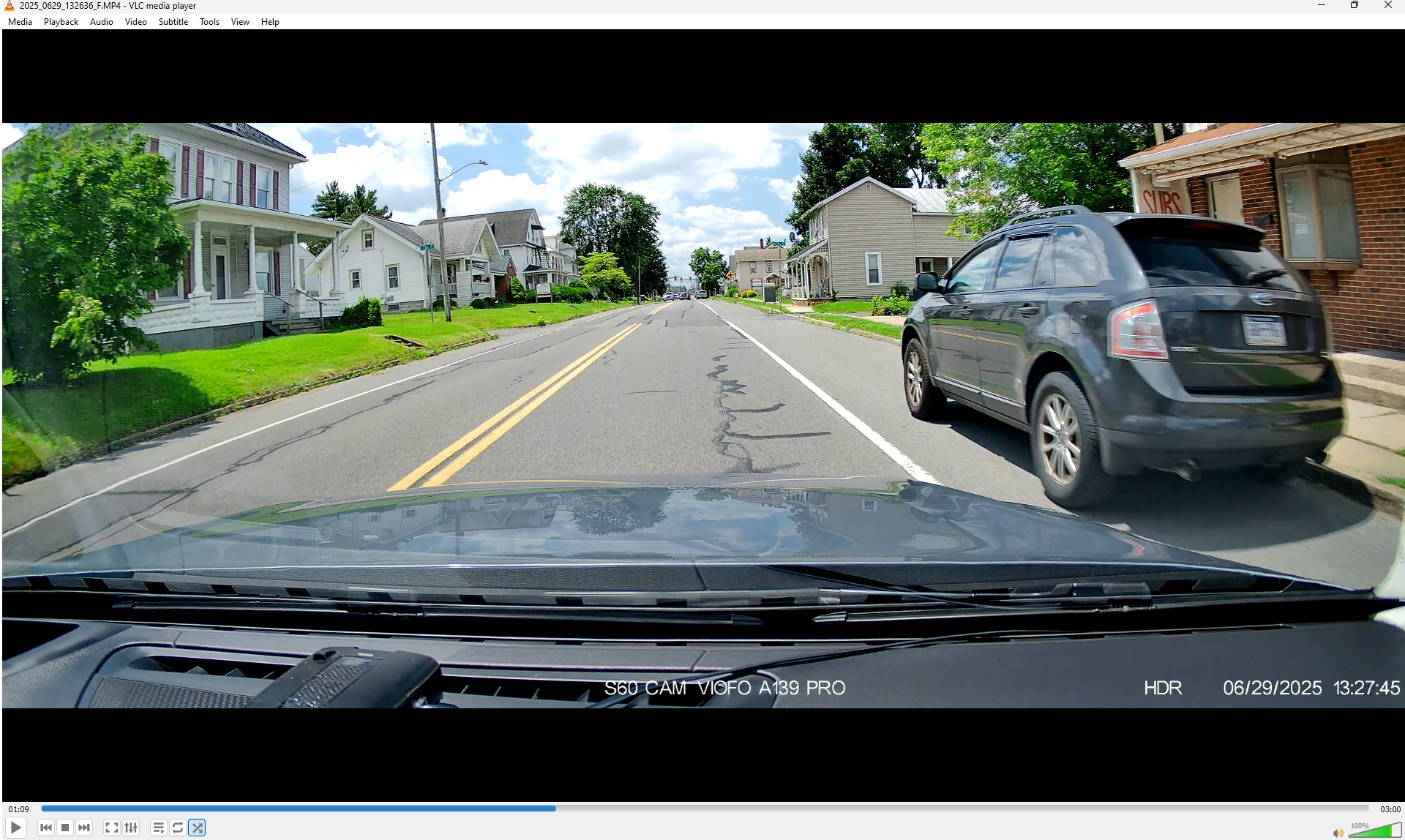

My previous images were made on an overcast day, so here are a trio of images made on a bright sunny day from the same three cameras. I was moving at 35-40MPH at the time. All three cameras are wearing a circular polarizer. There are three primary observations here:
1) The license plate capture is better on both Vantrue cameras with PlatePix than with the A139 Pro. HDR is enabled with all cameras, I've also got PlatePix enabled with the two Vantrue models.
2) Looking at the tree leaves, the Viofo A139 Pro looks most "natural" to me. The N4S image looks more "processed," and the S1 Pro Max image looks the most "processed" to my eye. I do a TON of photography with a 35mm DSLR, and the Vantrue images look like a ton of "unsharp mask" has been applied - more with the S1 Pro than the N4S, but that might also be due to the differences in resolution.
3) The Vanture N4S and S1 Pro Max images still look a pinch darker and/or exhibit more contrast than the A139 Pro.
Viofo A139 Pro:
Vantrue N4S:
Vantrue S1 Pro Max

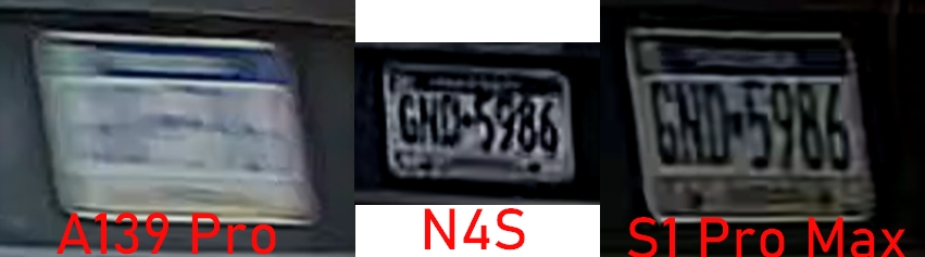

And here are some additional 200% zooms using CapCut:
First up, license plates for all 3 cameras. The A139 Pro is completely unreadable and the S1 Pro Max is the clear winner for readability.

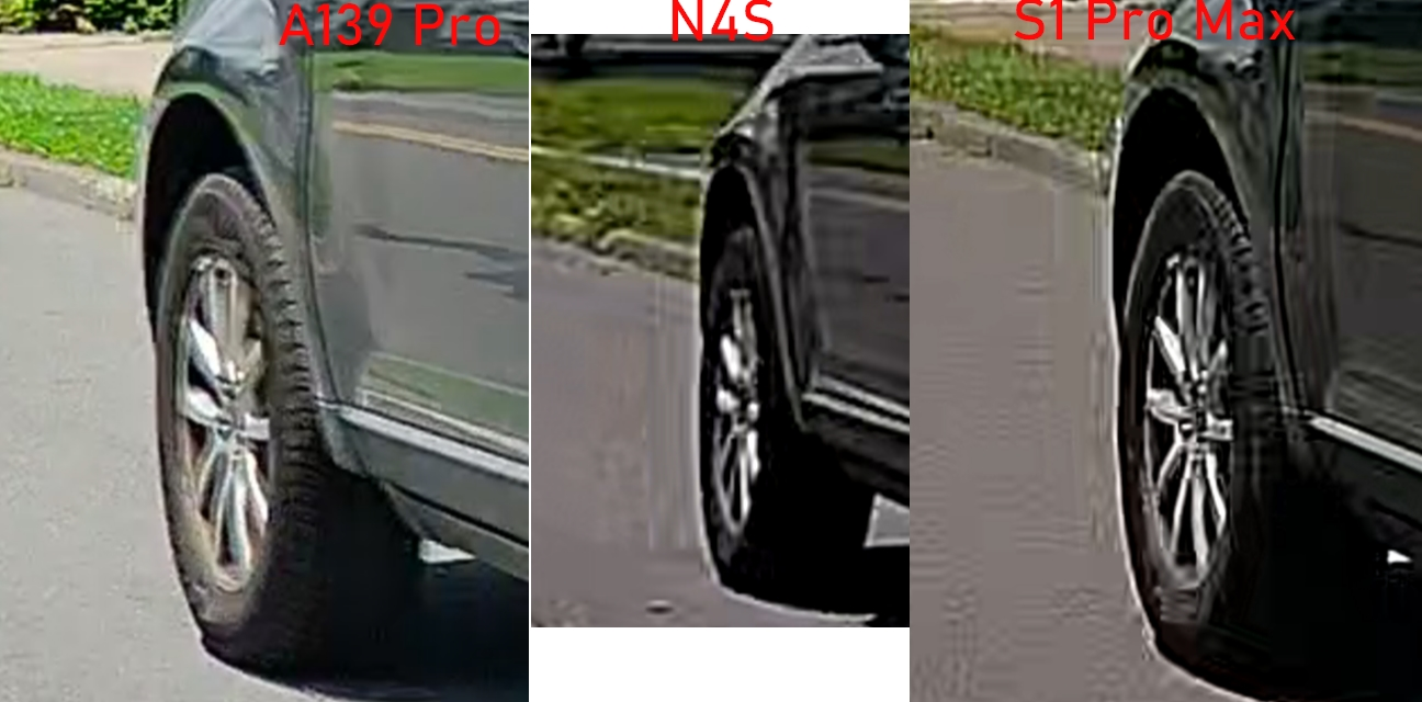

Next, a 200% zoom of the front wheel of the parked car. This one best shows the digital artifacts introduced by the relative amount of sharpening and MPG compression for each camera. The A139 Pro clearly exhibits the fewest digital artifacts, but this is not a surprise given that it has the highest bitrate and file size per unit of time.

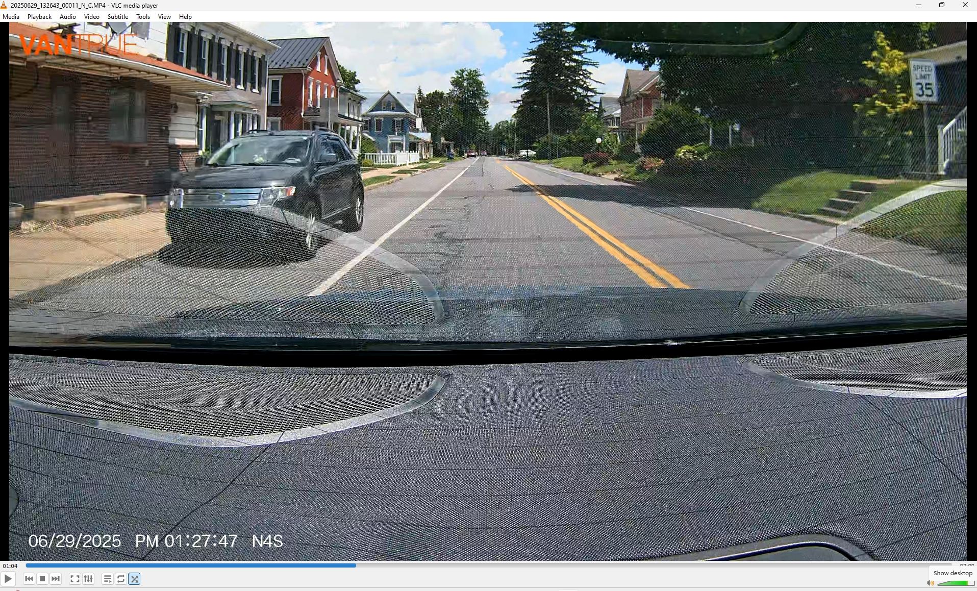

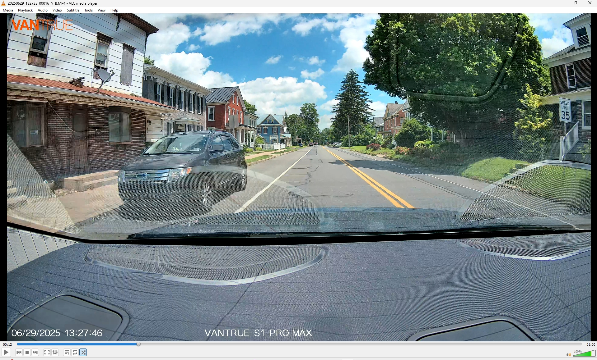

And here are some rear camera images that include the same parked car as the images directly above.
All three rear cameras REALLY need a polarizer to cut the glare. One is available for the A139 Pro, I wonder if it will work for the Vantrue rear cameras as well?
The A139 Pro is the best at handling reflections and is again the brightest image of the three
The N4S is the most linear (least distortion), and is still the darkest of the images (note the lack of shadow detail in the tree on the right). Rear defroster lines are most visible here.
The S1 Pro Max curvature at the edges looks very similar to the A139 Pro. The defroster lines are least visible in this image
A139 Pro:
N4S Rear Camera:
S1 Pro Max:
