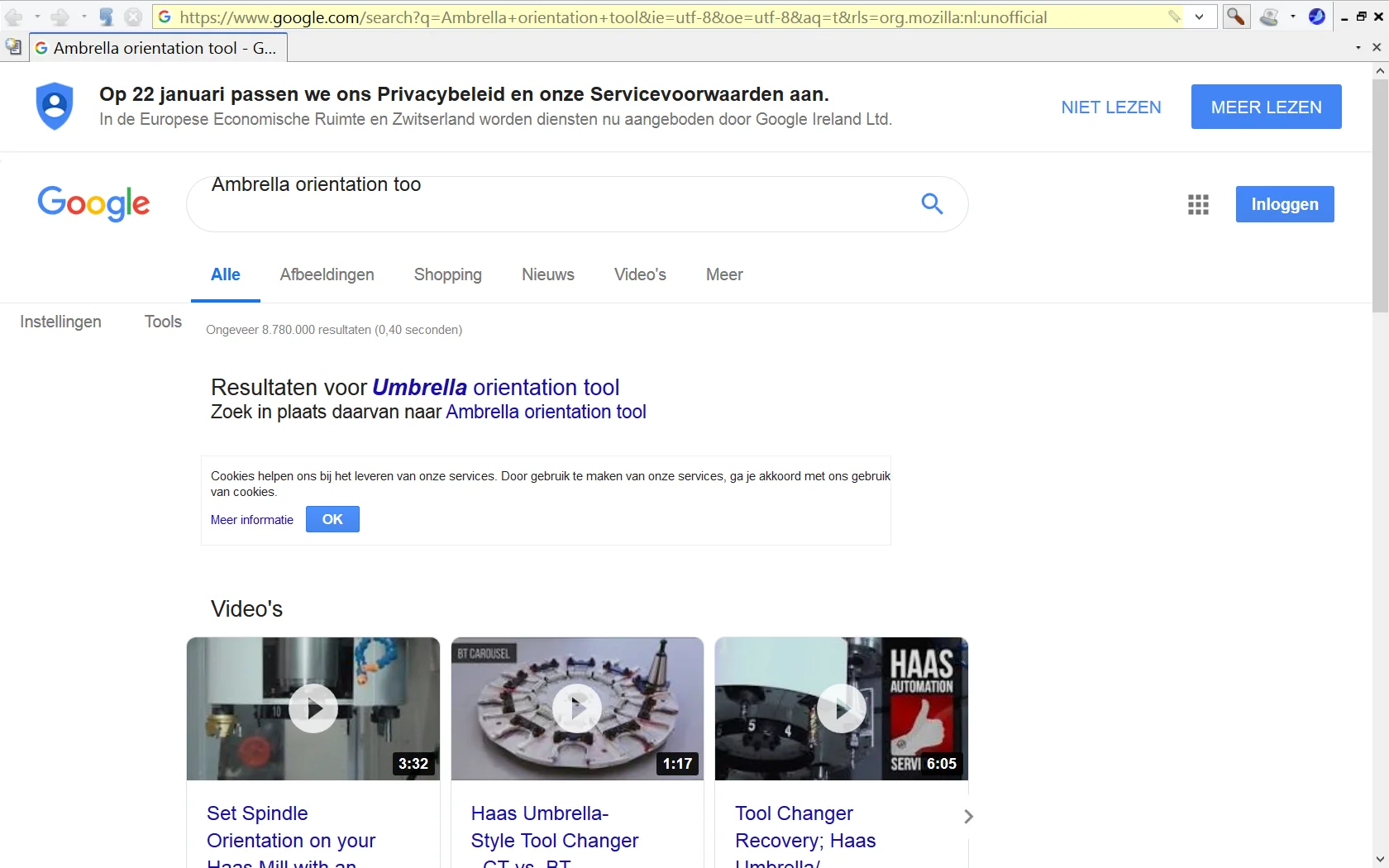

tried that, guess what Google showed up.... :LOL::LOL::ROFLMAO:(y)
I also tried gsensor, orientation tool but got nothing.
If anyone has any idea, or has the tool, please let me know.
