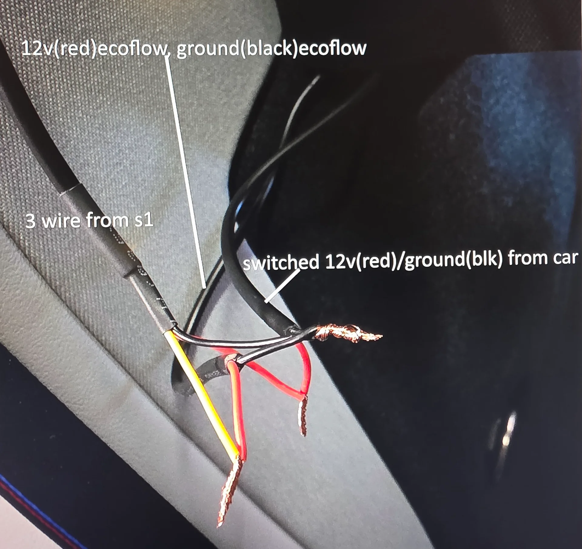

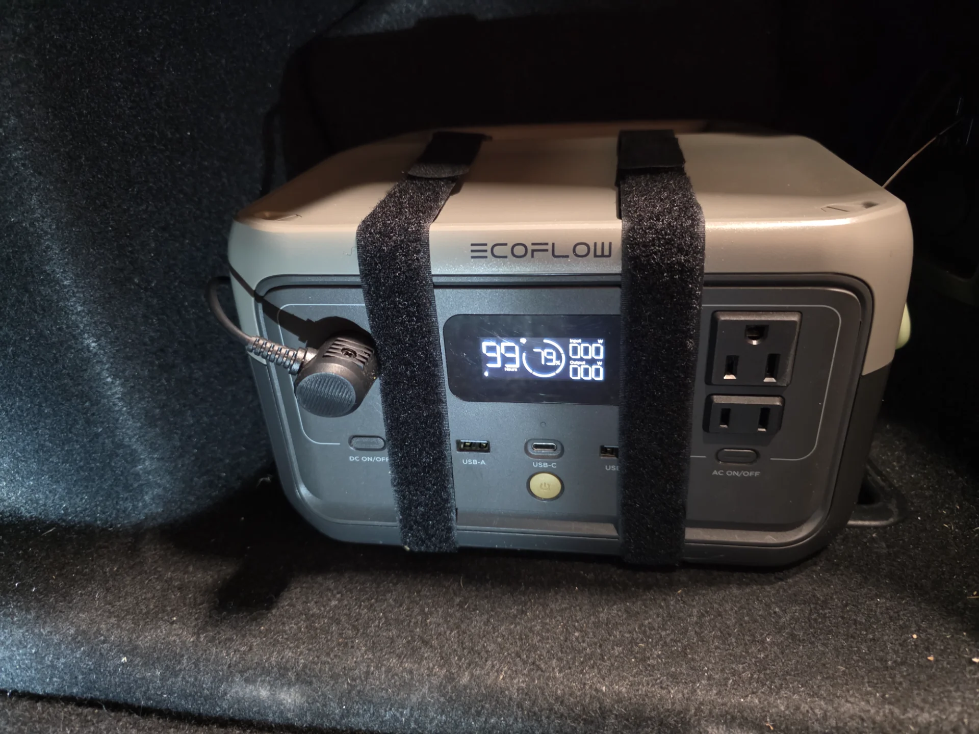

Here's how im powering the s1 with my ecoflow, using the 12v port rather than usb.
If you're using a switched 12v from the car you also need to use the ground from the car which is connected to the ecoflow ground, that's how i got parking mode to work, without the car ground it wouldn't enter parking mode.
