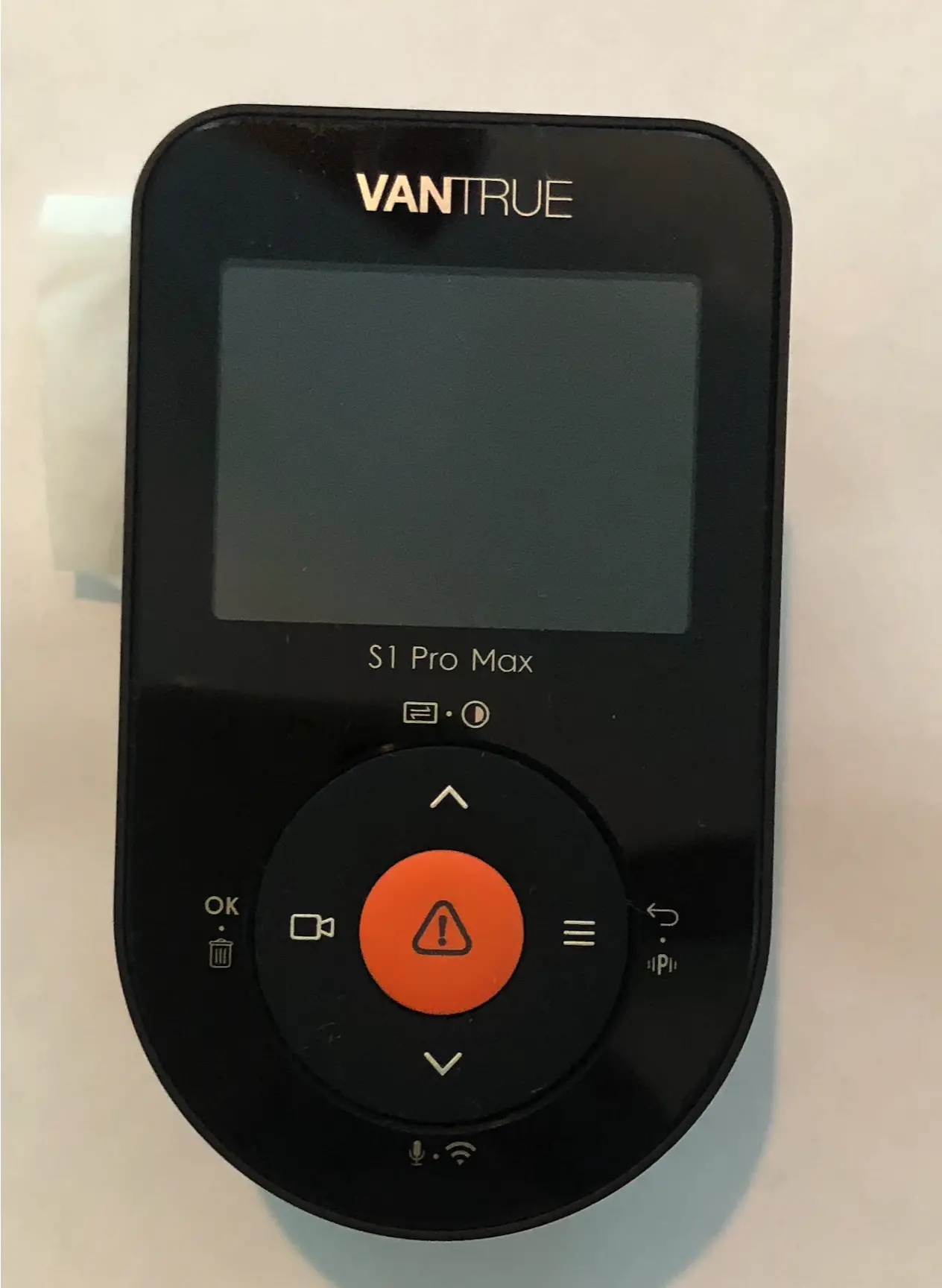

The S1 Pro Max has a very simple front user interface with a finger friendly pressure sensitive control ring (dense squishy foam not hard plastic)

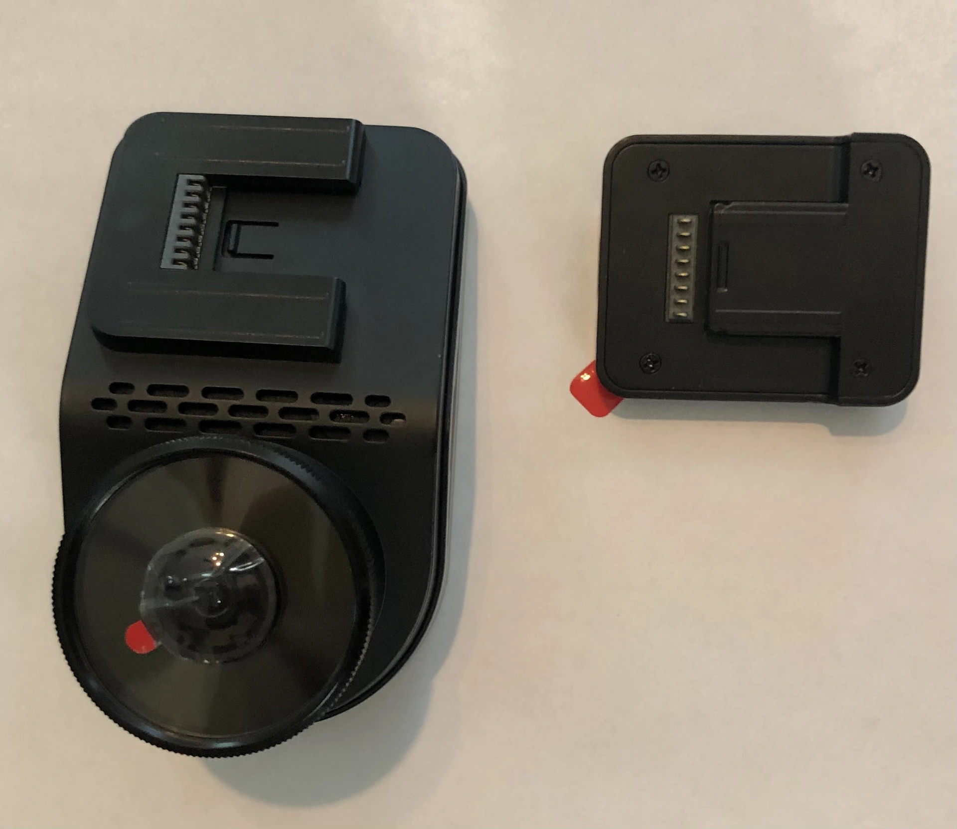

The front camera lens rotates and is adjustable in all directions.
All cables exit from one side which makes for a clean install
I'm glad the SD card reader is on the same (right) side since I'm right handed and it's easier to access.
One of these days somebody will figure out how to make an SD card slot easier to insert/eject so that my fat fingers with no fingernails don't keep launching the card from the spring loaded slot 😳
The GPS module is easy to install and remove. On some cameras there is a super human magnet that only Thor can remove.

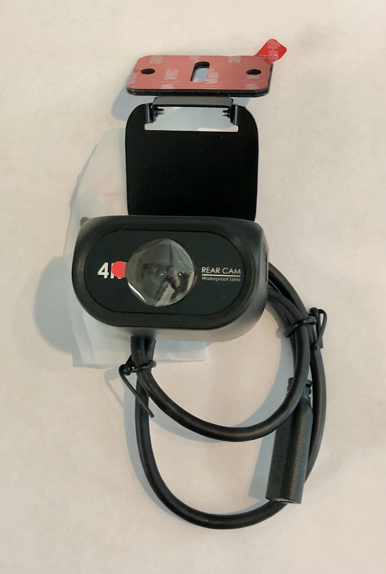

The rear camera has a two way swivel bracket which should make installation easy

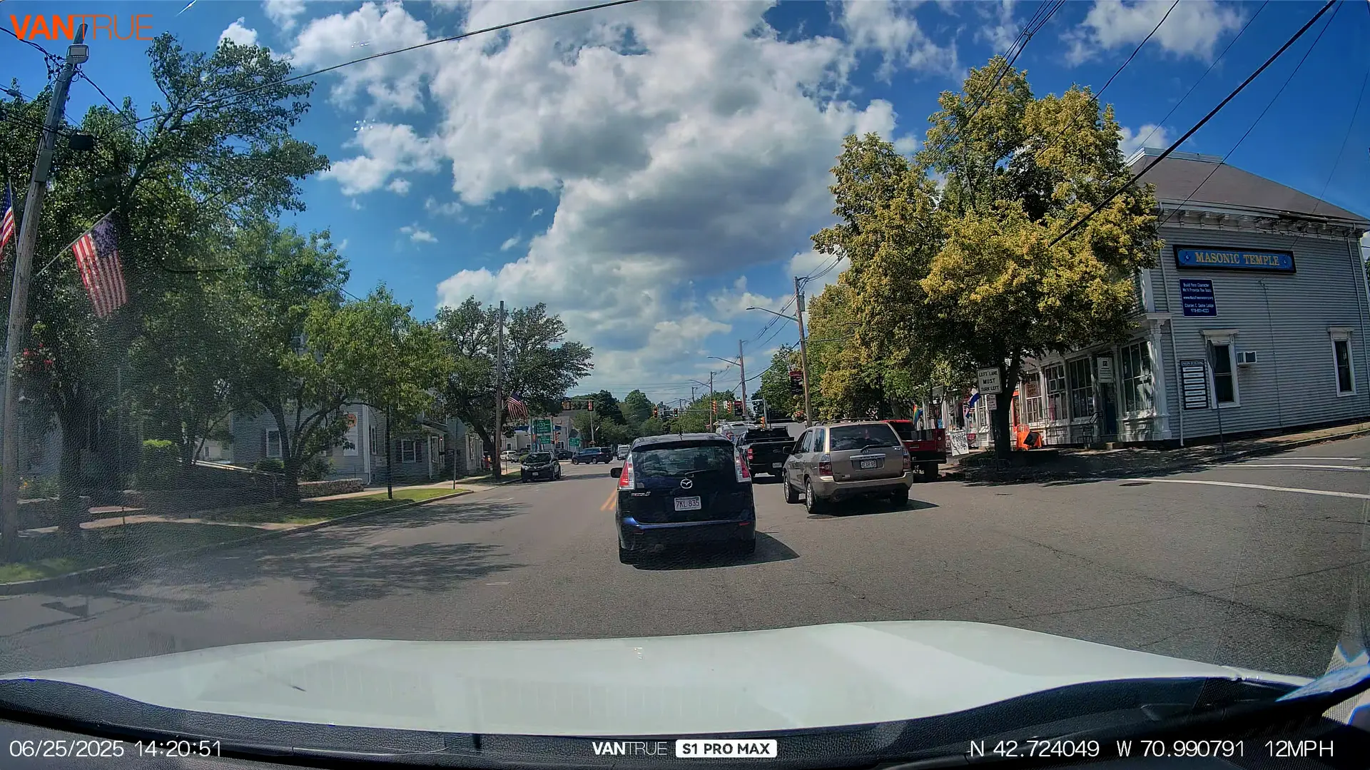

Here is a still shot comparing A229 Plus 2K with S1 Pro Max 4K.
The S1 Pro Max has the overall crisper image as expected. I should not have HDR turned on for the A229 Plus.

You can definitely tell the 4K (S1 Max pro) vs 2K (A229 Plus) difference. The S1 Max Pro is far more crisp.
I wonder how the night comparison will fair. Lower definition allows more light due to larger pixels. Waiting on your report from night screenshots.

I don't think there's much difference between the two pictures
The yellow building on the left looks a bit over exposed on the top (Viofo) video. It's washed out and has less detail. I'm wondering if it's because I had HDR turned on during the daytime.
In general I think the lower (Vantrue) image has slightly more crisp detail. The sky also looks more saturated on the Vantrue (brighter, deeper blue).
I've noticed in general, Viofo images of the sky tend to be more washed out, sometimes the entire sky looks white when Vantrue is deep blue.

RAV 4 is a PITA to install rear camera with hatch.

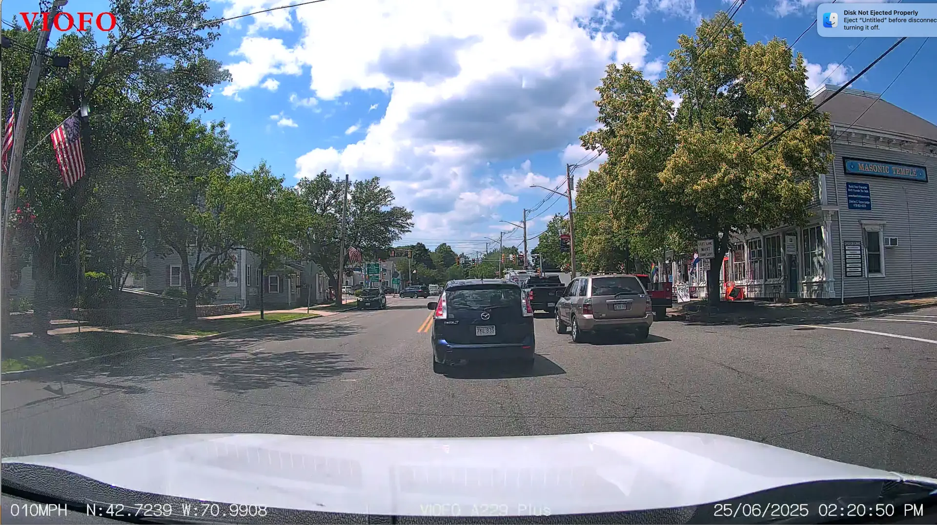

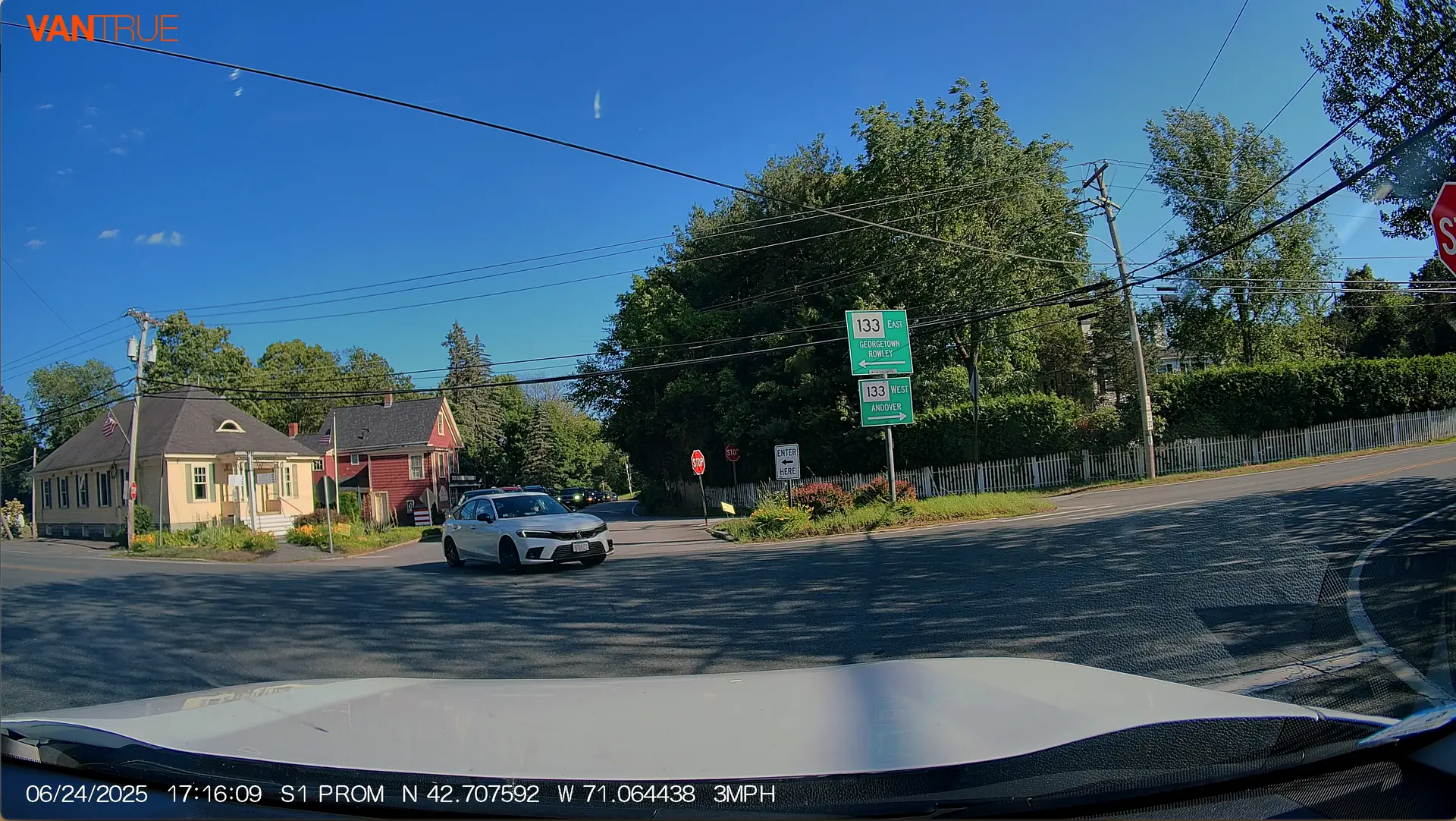

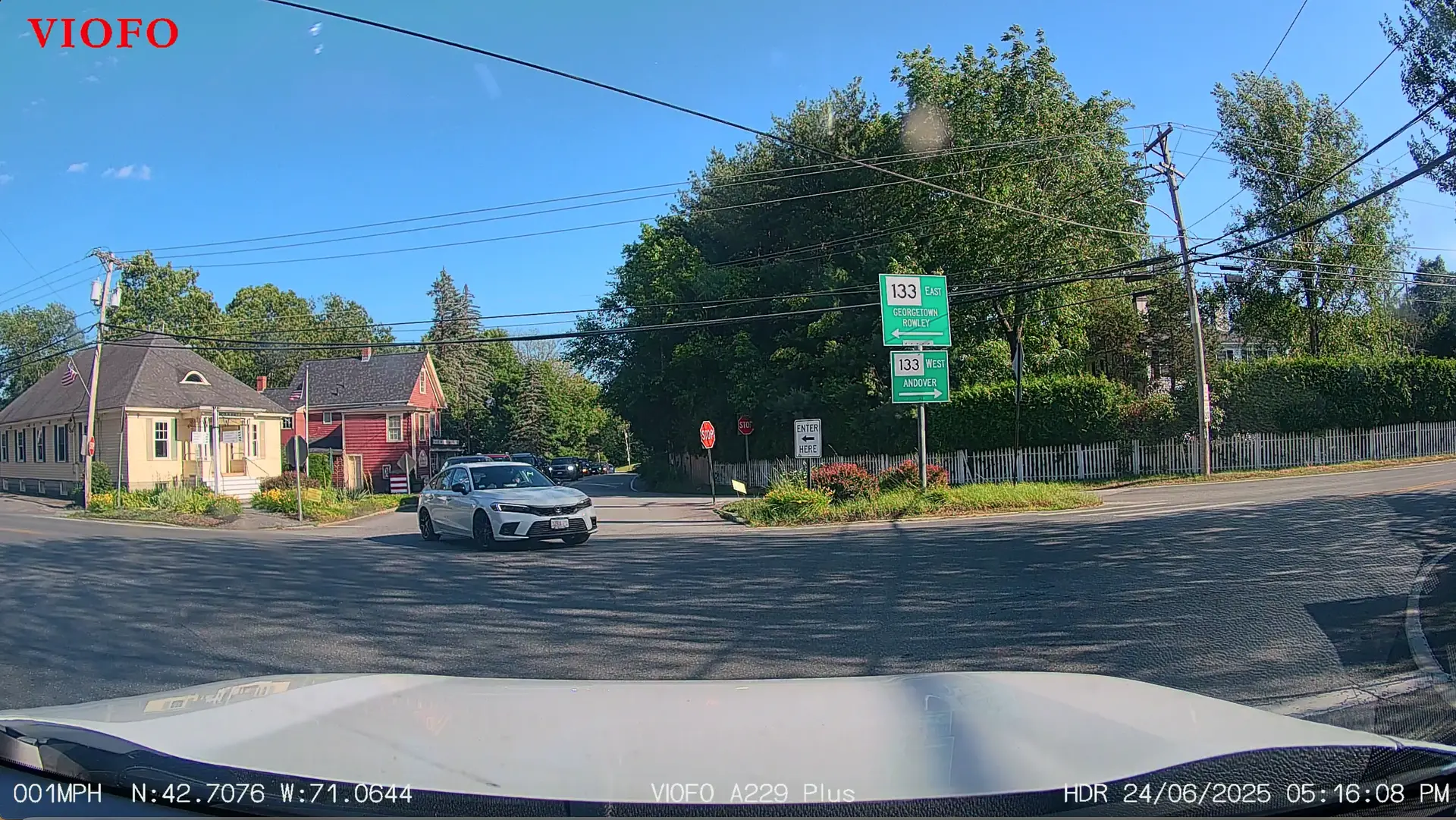

More daytime footage, this time HDR is OFF on A229 Plus
I definitely need to get CPL filters I see lots of glare on the left side of images
Colors and Resolution look better on S1 Pro Max but for a 2K camera the A229 Plus is not bad
A229 Plus
S1 Pro Max
With the S1 Pro Max, darker areas seem a bit too dark. The black truck lost detail and also under the trees.

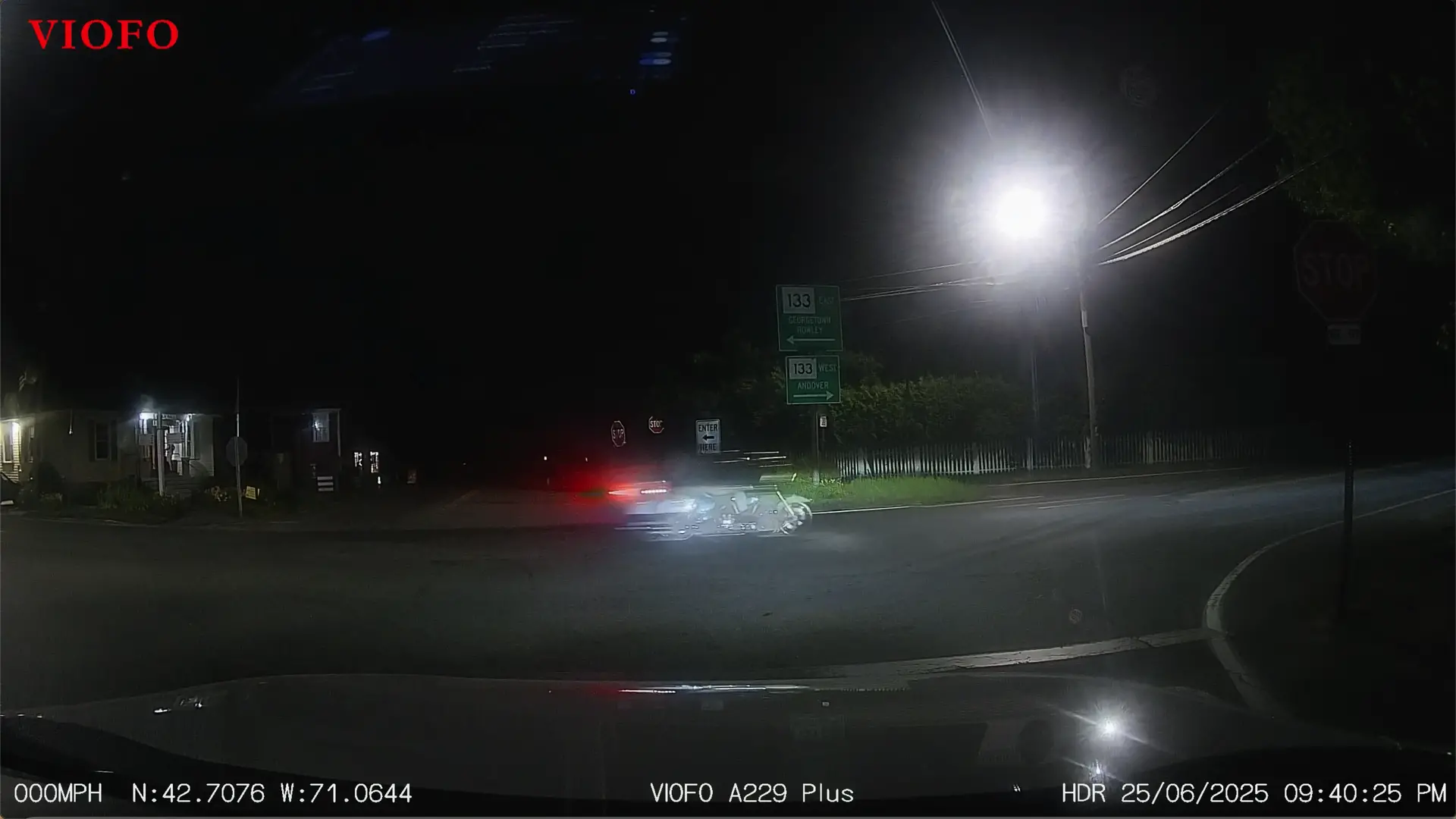

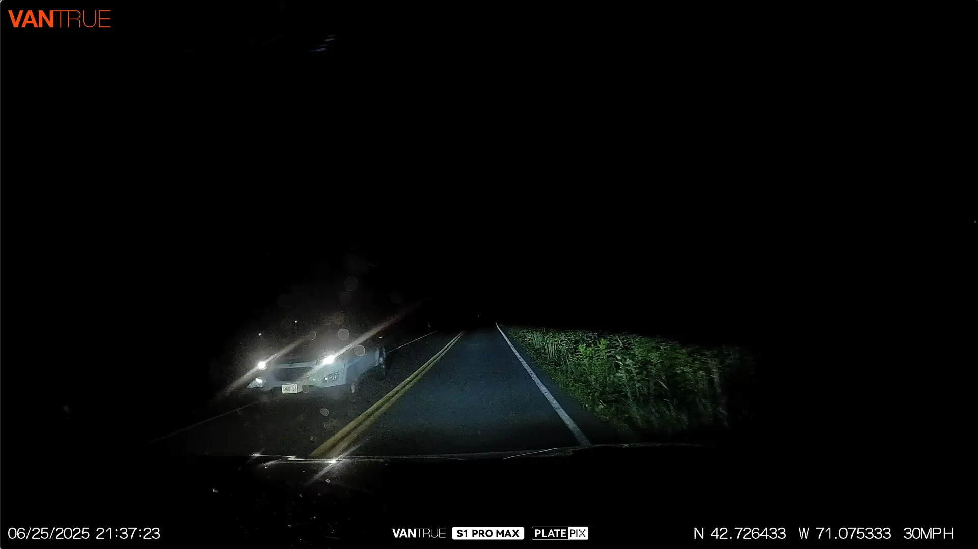

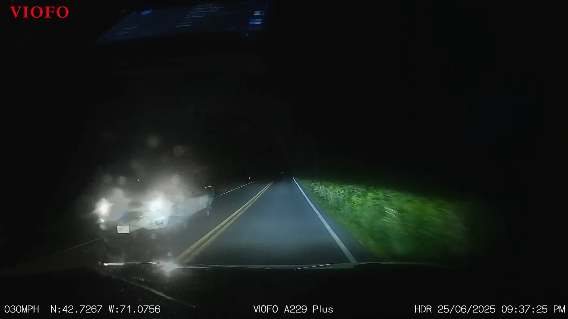

Night time footage of S1 Pro Max and A229 Plus:
S1 Pro Max shows much greater detail where my headlights were directly shining, such as the motorcycle (first and second images) and the license plate and front of an oncoming car (third and fourth images)
Areas not lit well by my headlights are very dark and in some cases cannot be seen at all (yellow building on left) with the S1 Pro Max
I also noticed that the PlatePix timer is operating independently of the HDR timer, it can be set to its own timer value, which is not what I saw with the N4S. I'm using F/W S1PM_VT-EEE181 2025-06-11 11:23:37
A229 Plus HDR ON
S1 Pro Max PlatePix ON
A229 Plus HDR ON
