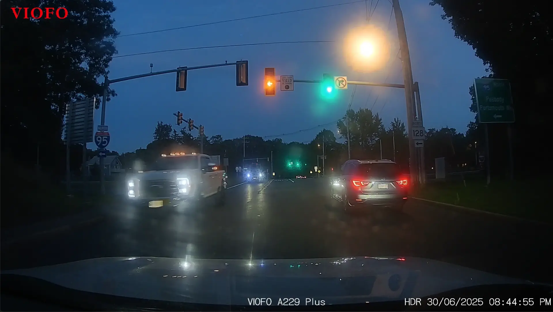

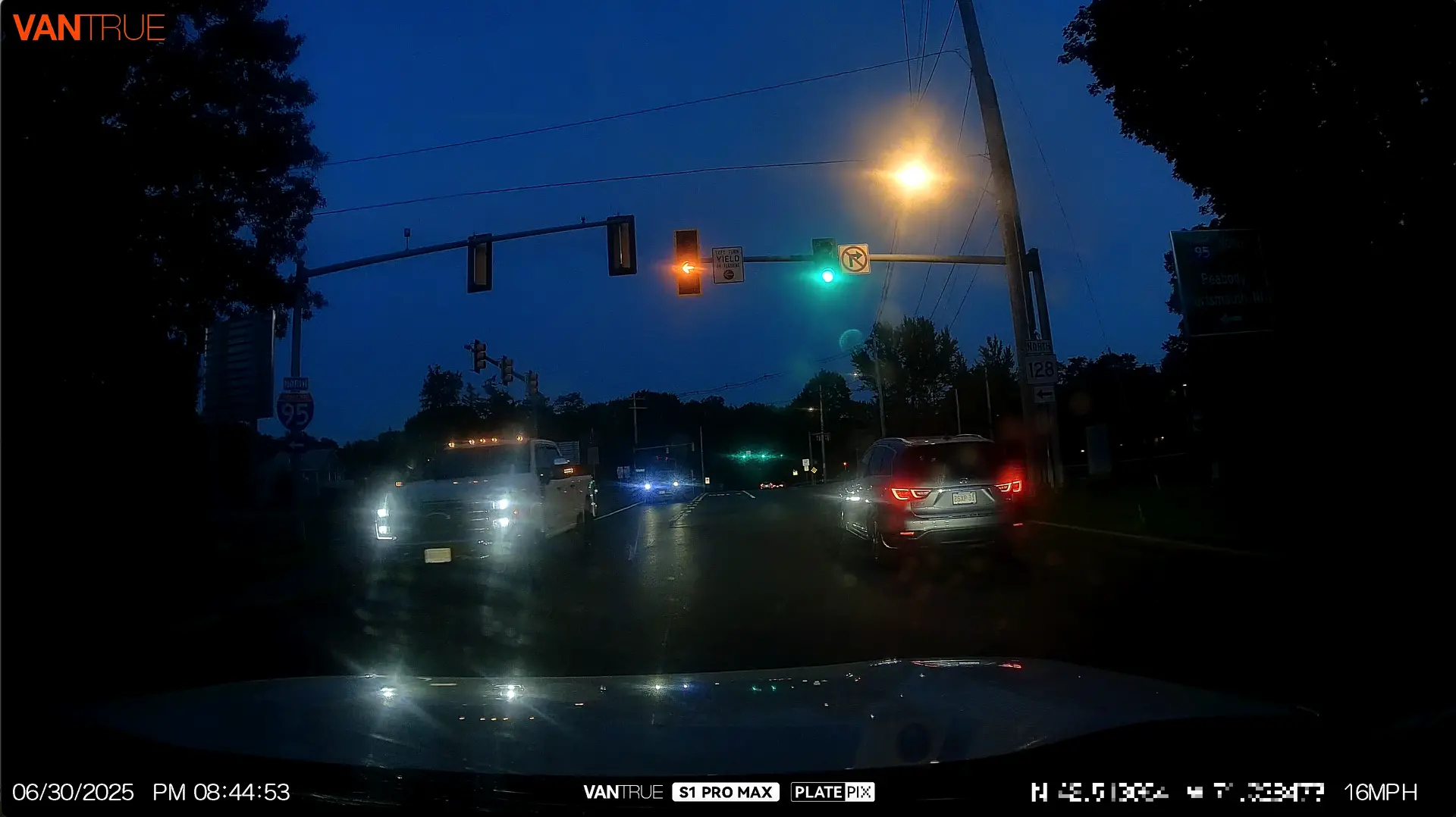

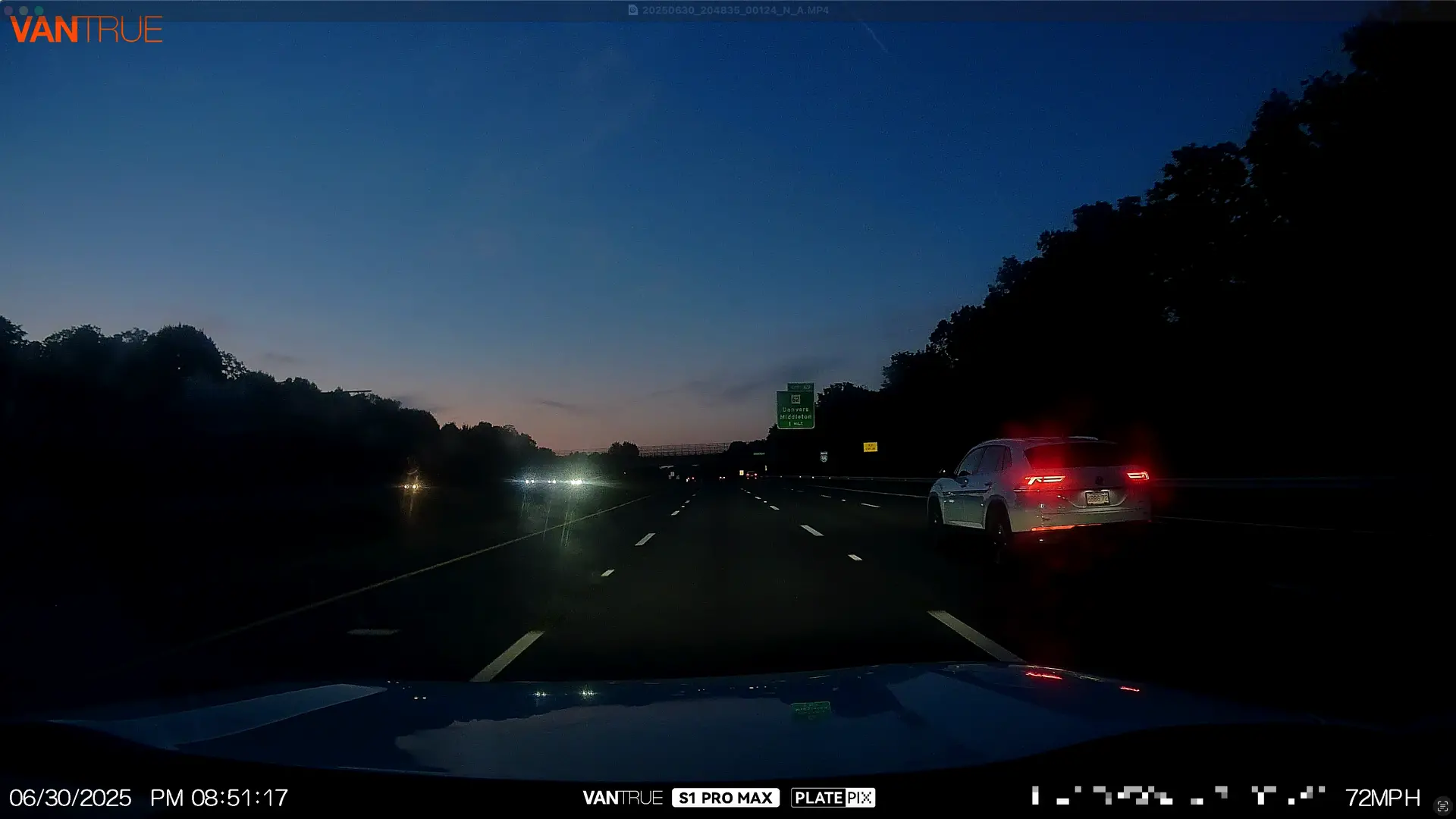

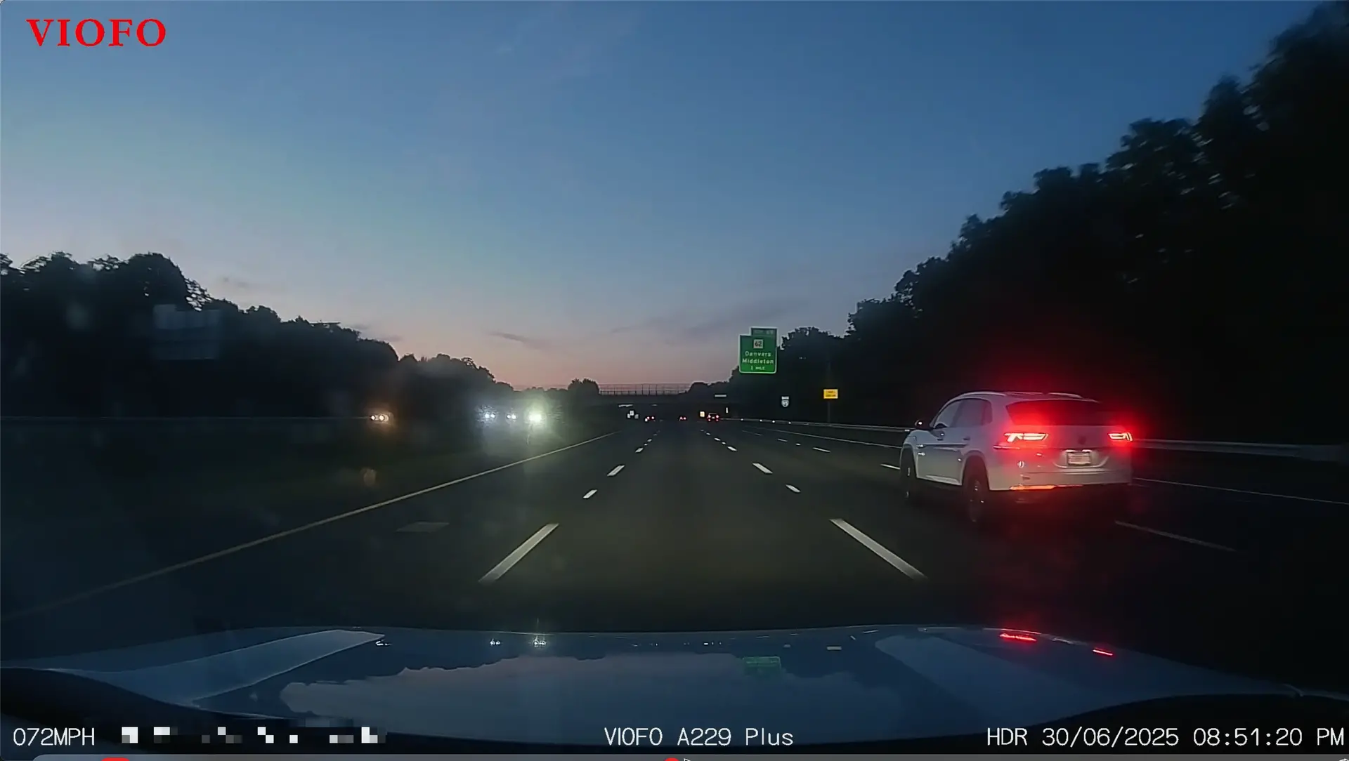

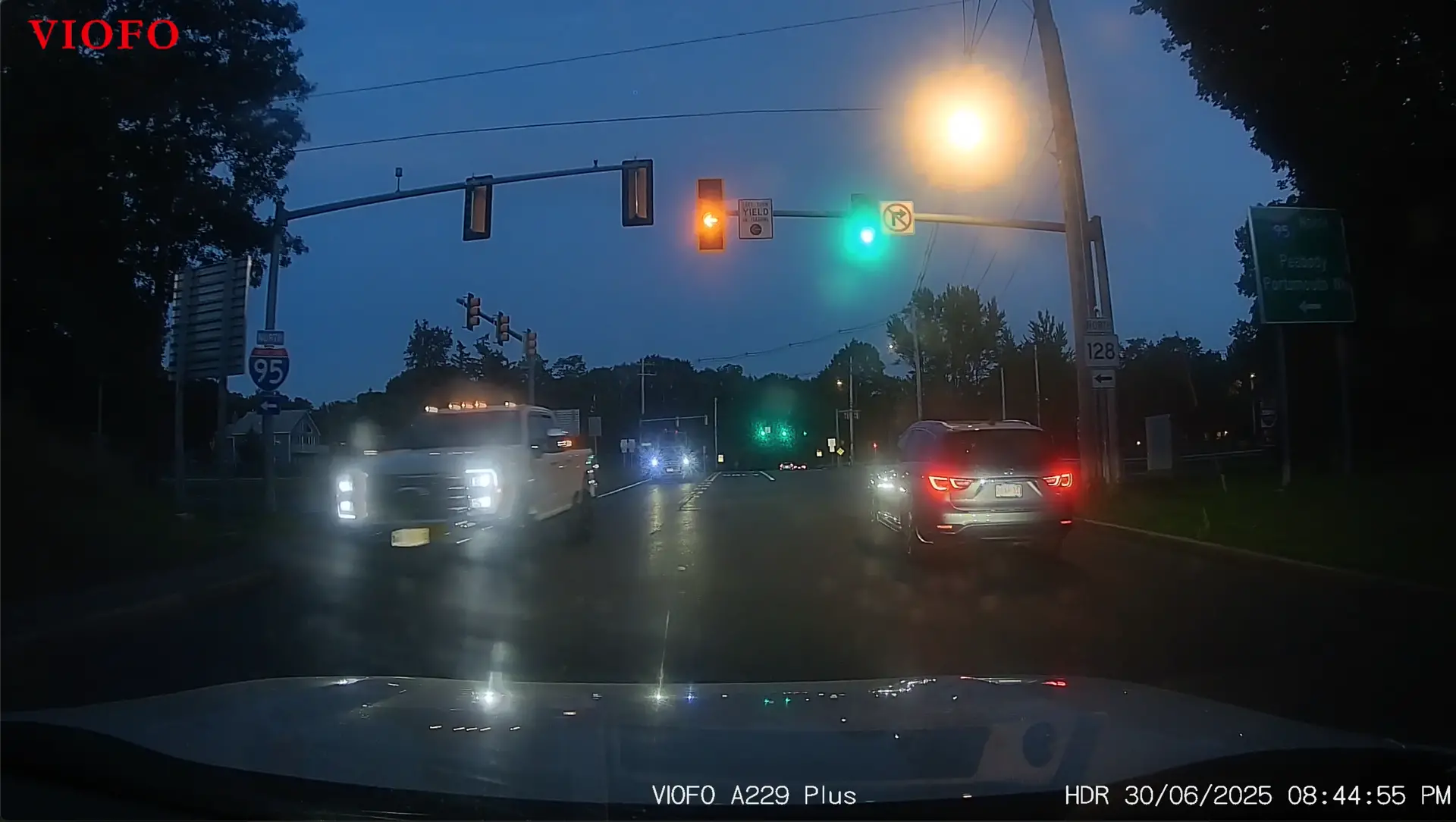

More nighttime footage this time on the highway.
Motion blur is evident on the oncoming truck plate with both cameras but the plate traveling in the same direction is clear on the S1 Pro Max. (4K vs 2K camera)
The Viofo still has no GPS lock
S1 Pro Max PlatePix ON
A229 Plus HDR ON (Still no GPS lock)
Again the S1 pro Max performance looks better (4K vs 2K camera).
Noteworthy is the white car on the right blew past me at a high rate of speed but the plate is readable with the S1 PRO MAX.
A229 Plus HDR ON
A229 Plus HDR ON

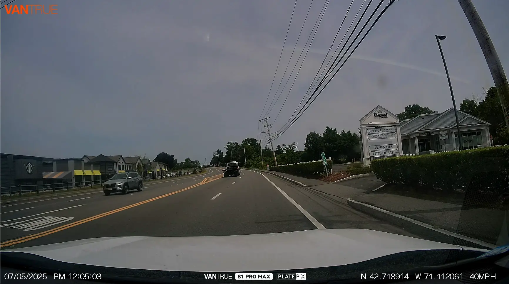

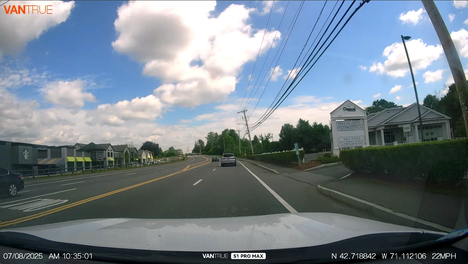

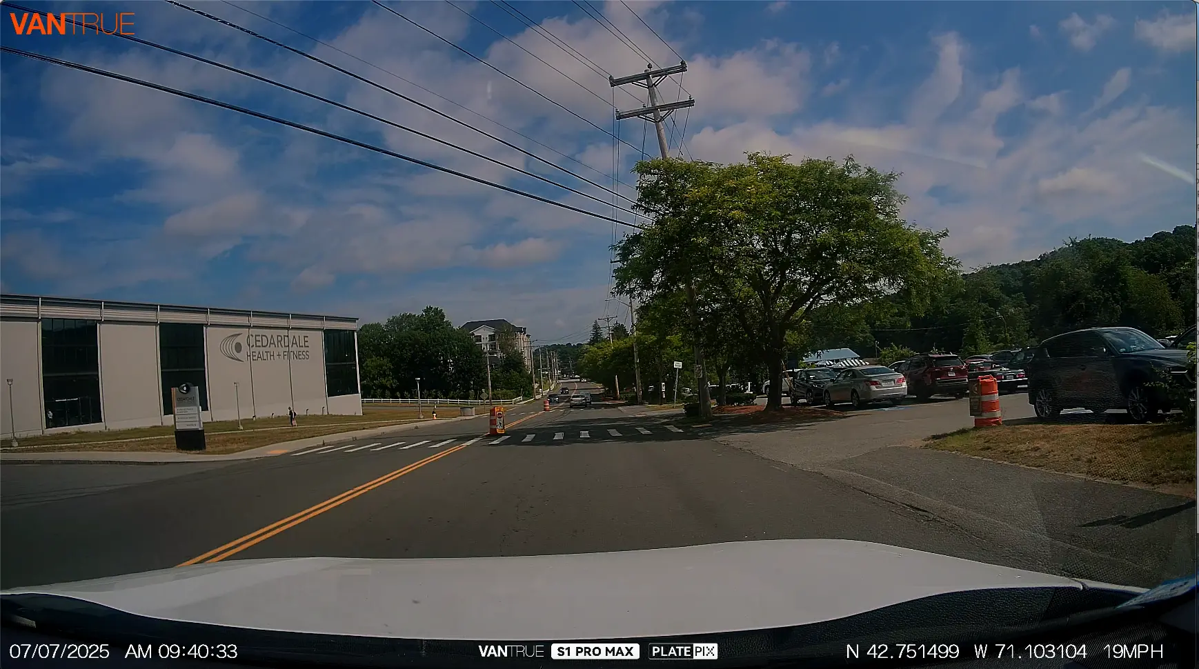

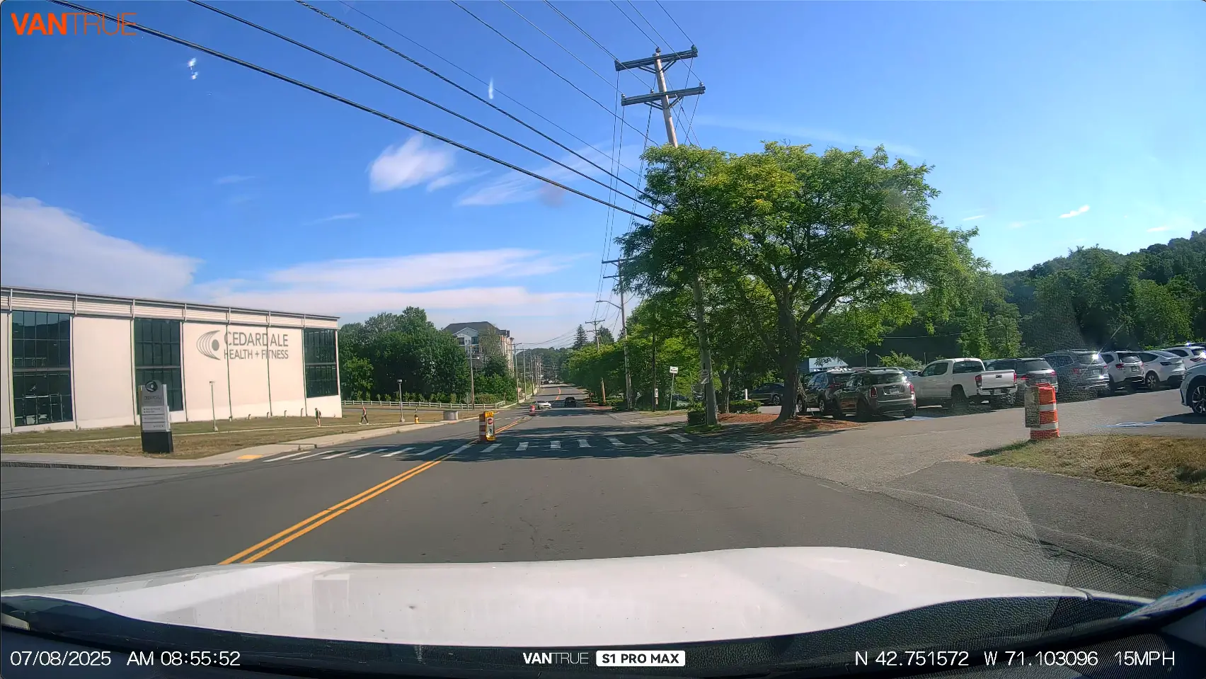

Each of the S1 Pro Max's cameras run at 2160p (4K). The image is very crisp, albeit darker. You can see noticeable clarity differences between the 4k S1 Pro Max and the N4S.
I'm posting the same footage WITH and WITHOUT PlatePix enabled to show an apples to apples comparison. I wanted to see how PlatePix impacts the same image under similar lighting conditions.
PlatePix is mostly meant to obtain accurate reading of license plates in various lighting conditions but since it's pretty impossible to get the same cars in the same spot, I'm using signs as a comparison.
I can definitely tell when PlatePix is enabled even without seeing the "PlatePix" stamp. The overall image has deeper blacks and some of the detail gets blurred in the very dark areas.
In general, under normal lighting conditions with this small sample size, the signs are a little easier to read with PlatePix at the expense of losing detail in darker areas of the image.
N4S PlatePix OFF ------ I can read the smaller "Cedardale" sign on the left a little better WITH PlatePix enabled.

N4S PlatePix ON
N4S PlatePix ON
