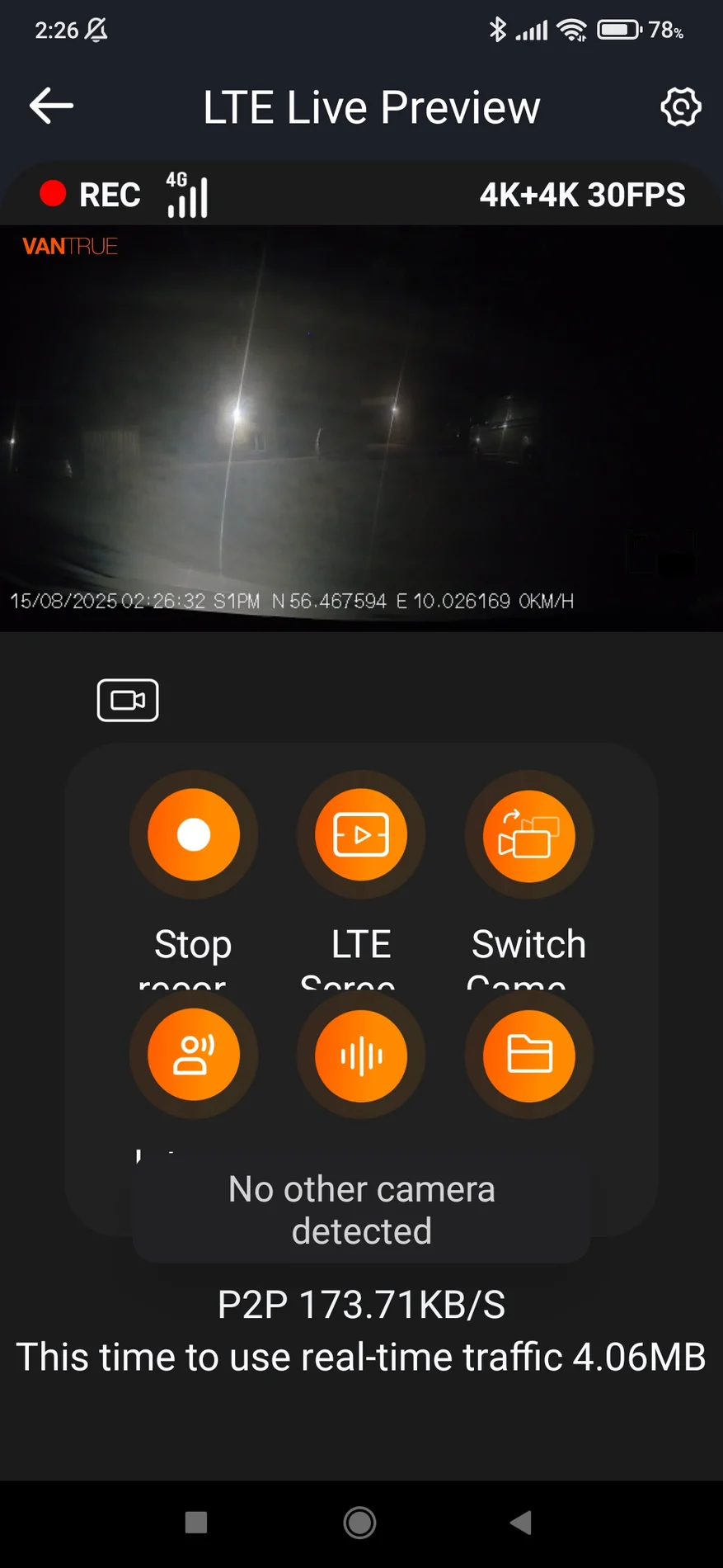

The live preview freeze when the LCD turn off.
Also on my phone the live preview from the rear camera looked like OMG i forgot to remove protective sticker, but then home looking at raw footage i cant really see any problem ( not looked eagle eyed on this yet )
remoting in, just fine except only the rear camera seen to exist.

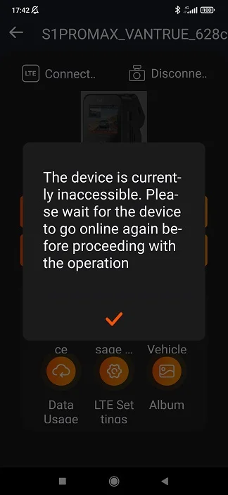

Well that was then, remoting in now is not possible at all, the LTE say it is connected but the camera ( wifi ) always appear to be disconnected, i am now trying quick awake but the camera can not be awaken and it always time out.

I just checked. If the S1PM is in parking mode and the screen is on, I can connect via LTE and see a live preview. If the S1PM is in parking mode with the screen off, I can connect but there is no preview.
@Jeff_Vantrue this seems to be related to connecting to the S1PM directly over WiFi, where the connection drops if the screensaver is active.
Connection with dashcam screen on:
Connection with dashcam screen off (notice the bitrate is lower):

Okay so i am a bit freaked out today, today aside for the wait for system to wake up, i have always been able to LTE into the system, though it do take a few tries some times, i get successfully connected and then BAM i am thrown off, and i have to try again granted with shorter wait and most often a live preview.
I dont see the screen saver doing anything, io have tried to LTE into system while car and system on / driving, and with the screen saver engaged, absolutely no problem.
I have tried to stop, wait for system to go into parking mode and then LTE in, and also a success and the screen saver is on when the system wake up.
I do wish that the 4G and system was always connected, well aside for ultra low power use parking guard mode where of course you would have to wake up the system before you can get to see anything.
But otherwise in higher power use parking modes, shouldn’t the connection be there in like seconds / instantly ? i would prefer that.
Just did a LTE into the system, and the car been sitting parked for at least a hour in the back yard, and it still worked, though i did have to do 2 attempts, first attempt waking up system and spinning dots " loading " screen, but then after connection get kicked off, and so press LTE again to connect and now in this #2 attempt i get the wifi like rings in water loading screen and then in a couple of seconds BAM and connected.

sorry to know that you have issue with the LTE module. Could you please provide the app's log file so our engineers can further analyze and fix the issue. In the app's "About" page, tap the "About" text at the top five times or more, and a pop-up will appear to share the log~
