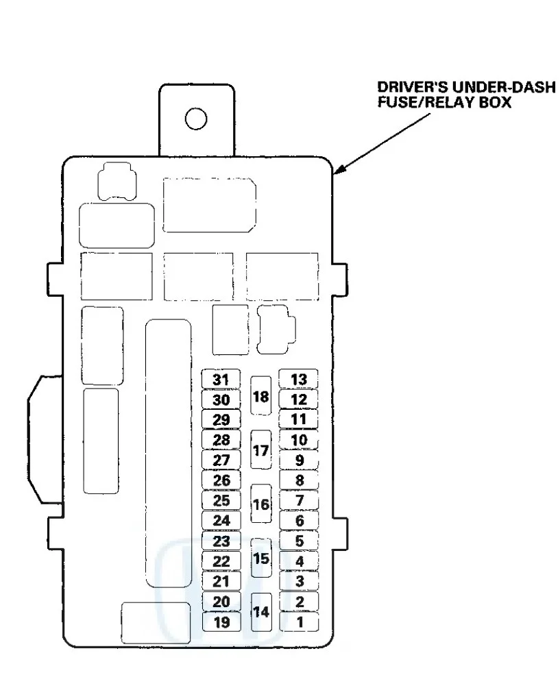

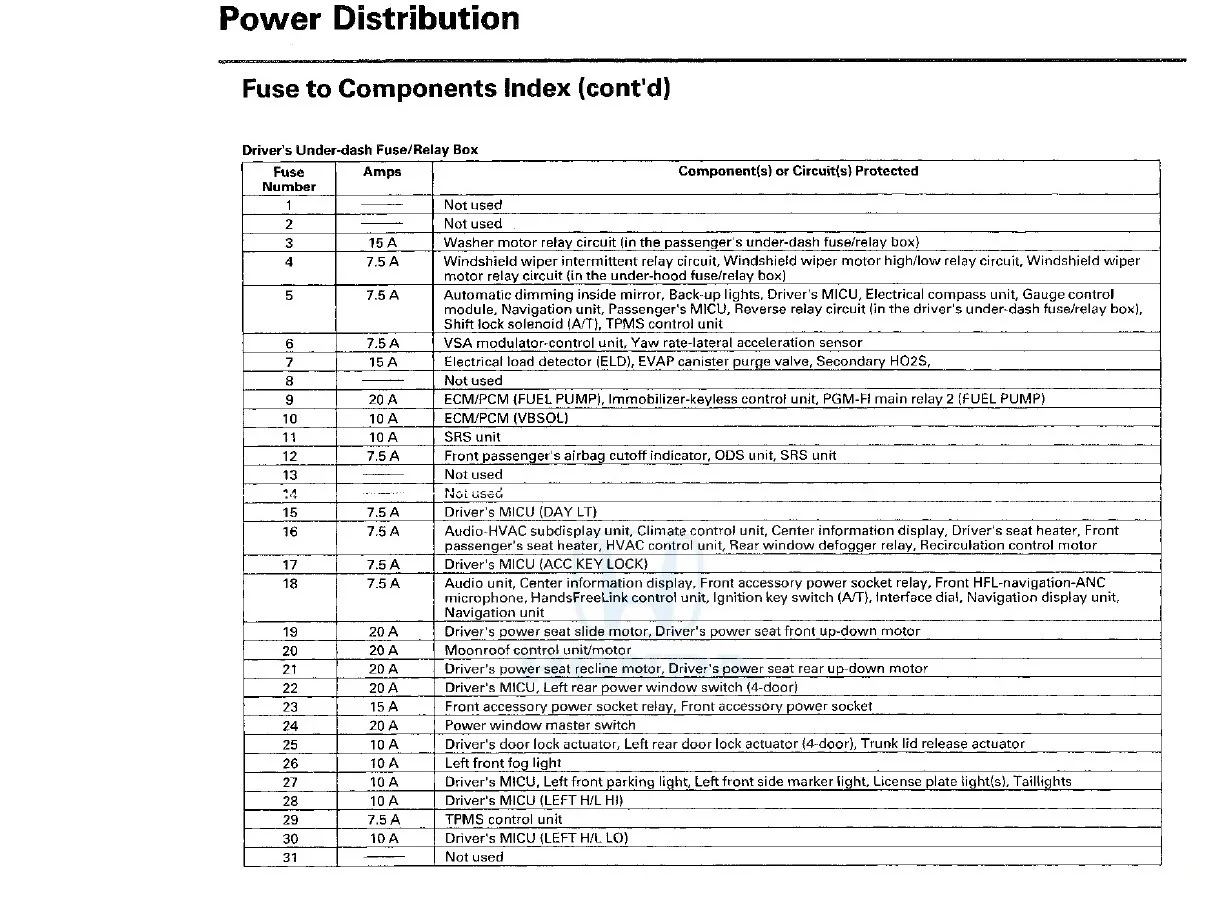

Right now both the front and rear dash cams are permanently out of focus. Changes in weather won't bring it back to normal. I have used ammonia-free windshield cleaners without luck and made sure lenses are spot clean too. I still want to believe in the brand that I initially paid $400 for. I saw it at that time as a safety investment and went after what I considered to be the best product available in the market. But honestly I haven't seen my money's worth so far. I came to this forum to share my experience and hopefully find a fix. I am also attaching the fuse box schematics for your consideration.

Beeping while driving would point at an intermittent rear camera connection or memory card error. Freezing could be power fluctuations CANbus issues with the 3-wire hardwire kit. (wrong fuse slots)
I don't have recommended fuse locations for a 2008 but I do for a few years newer. (should be the same or similar usually)
