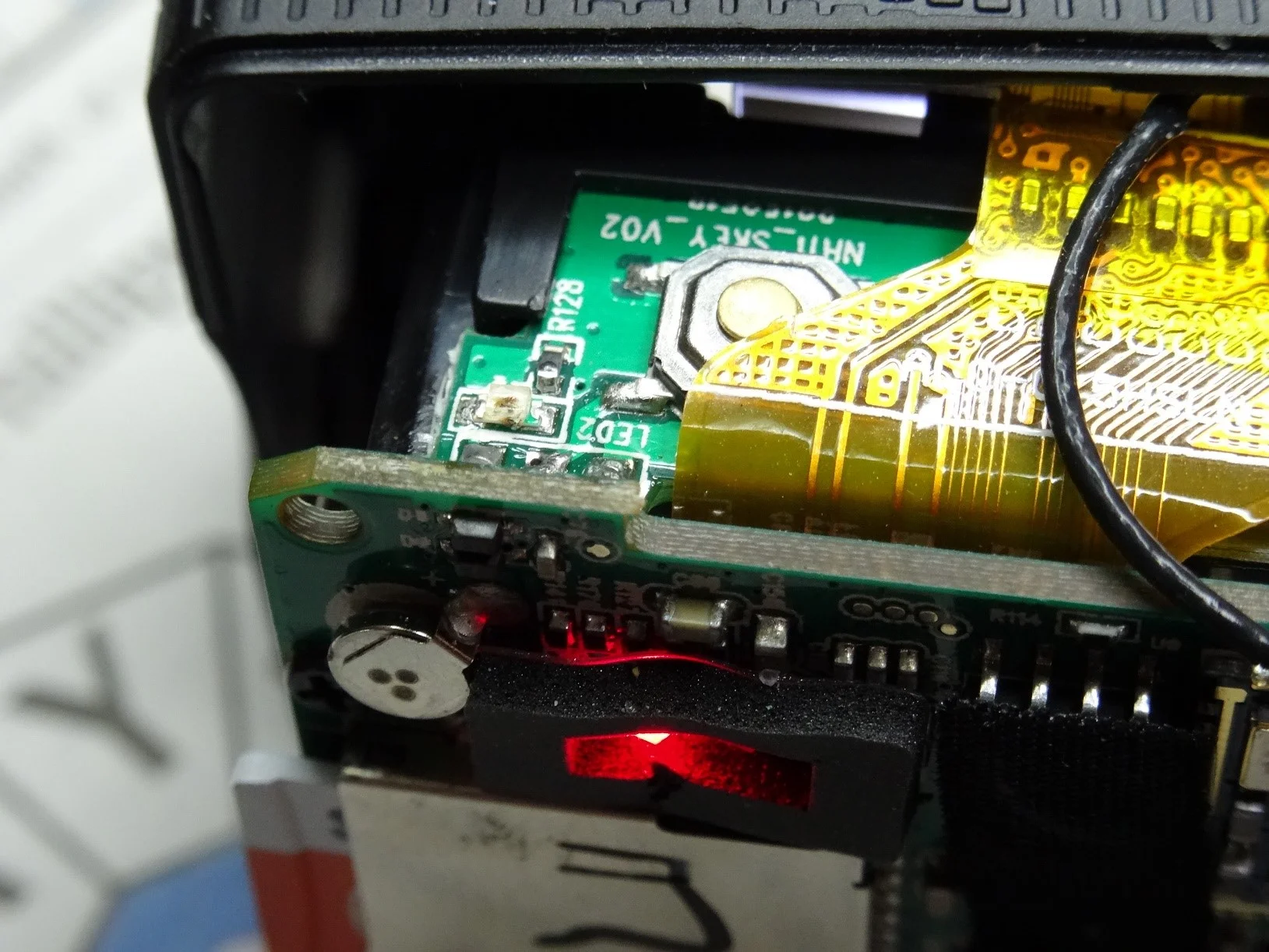

I recently found that the shutter/select button was behaving intermittently along with flickering of its adjacent work status light. Soon afterwards they both failed completely. I can start/stop recording using the remote, but have no direct control of shutter or settings. Any advice gratefully received.
I thought that too, so took it apart and checked. All ribbons intact. Interestingly, the tiny circuit board that the top led and shutter button are mounted on seems to be soldered onto the main board at 90 degrees with 3 big blobs of solder. I'm wondering if the board could have been bent and broken the connections somehow. All put back together now with no change. I can't control the settings with Finalcam as its settings mode crashes the app on my Nexus 7 and FNcam only has basic settings. Maybe the long-awaited Gitup app will make it possible to change all the settings.
You can make direct connection with the #1 and #2(from left to right) solder, after connected, it works like press the shutter button once, so we can know if anything wrong with the main PCB or only solder problem.

Thank you @gitup for the suggestion. I will try this later today and report back.
I dismantled the camera again and tried your suggestion, @gitup, but without success. The shutter did not release in camera or video mode and I could make a selection in settings mode. See photos that shows red light not illuminated. 1609a.jpg DSC01612.JPG DSC01615.JPG
Correction: ...and I could NOT make a selection in settings mode.

If the little PCB underneath the button is not in place anymore, then you should re-solder it. If it is still there, the little switch underneath the button is broken. Im that case the little PCB must be replaced.
