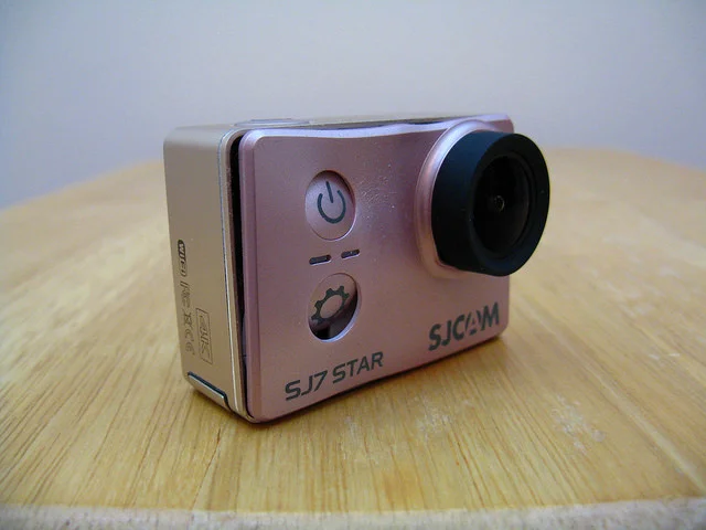

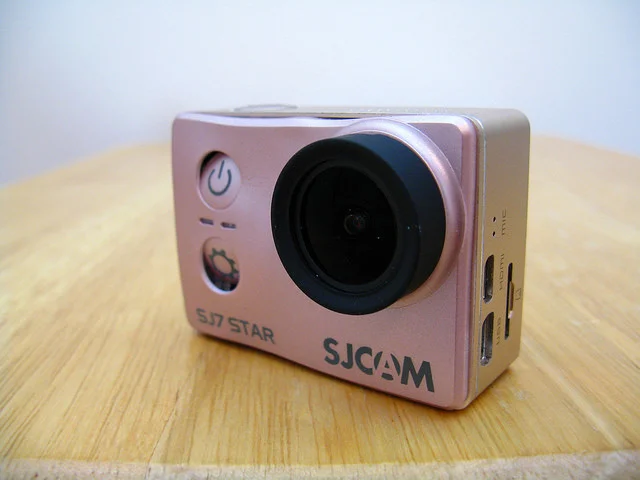

After 3 hours of use as a dash camera my SJ7 became warped and deformed. I was using it with the battery removed, powered by a USB power bank. It was mid-afternoon in Georgia, USA. Outside temp was about 29°C (85°F) with the A/C running in my vehicle and one stop of about 30 minutes with the windows rolled up. Interestingly, the camera recorded video the entire time right up until I discovered the problem and disconnected the power bank. This leads me to believe the internals are largely okay, that the problem was exposure of the camera face to the sun.
The camera is now inoperable. Due to deformation I can't get the battery into the compartment. When I connect an AC or DC adapter or USB power bank the camera doesn't turn on even though it's in Car mode. I tried using the On/Off button after connecting the external power source but because the front is so warped the button doesn't work.

I also had a dash cam deform in the sun. It seems some manufacturers use cheaper plastics. Here is a response I got in another thread:
we use ABS PA777D material for dash camras housing, which survive up to 115C
while the normal ABS-V0 will be deformed when 85C.

It's a unique Salvador Dali camera - very valuable as a work of art :D
If only they had used a metal front and buttons to the case!
@kamkar1 did say his got "almighty hot" too.

SJCam just sent me an e-mail that answers a few questions. I hope they don't mind that I'm copying it here in the interest of accuracy:
The camera's electronics use a protection circuit that cuts off power when it reaches dangerous levels. The reason we inform users about the battery being removed is an additional layer of safety, and it is very strongly advised should anything fail.
About your question about the front panel, yes, it is made of plastic and should withstand some heat without warping. Excessive heat, on the other hand, may cause it to deform if left in this state. Most cameras, not just SJCAM's, will generate heat during operation, and will most likely generate more heat when using high performance modes.
Yes, it supports power via power bank. 2A is also okay.
