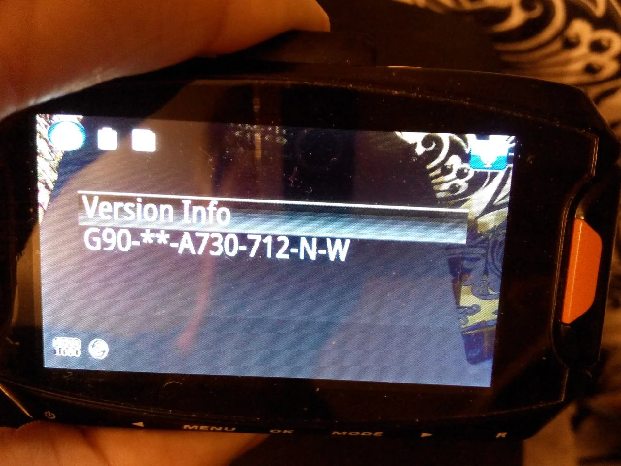

A few days ago I received my Blackview BL950 on this firmware:
Anybody heard about this firmware? New it or old?

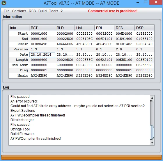

In A7Tool I see 28.10.14 date if it's about something said:)

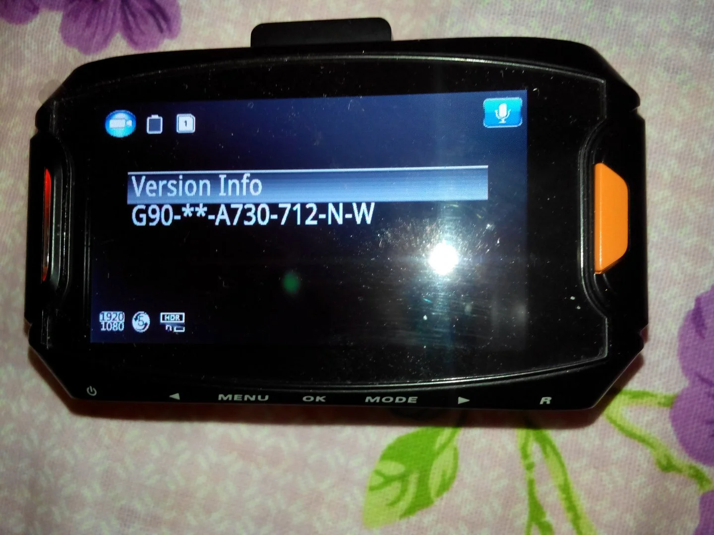

I found that my backup don't working, sorry for that. Yesterday I made a working firmware G90-**-A730-712-N-W.
I made a comparison of sound between firmwares SVN r441MP and G90-**-A730-712-N-W. On G90-**-A730-712-N-W sound quieter but clearer.

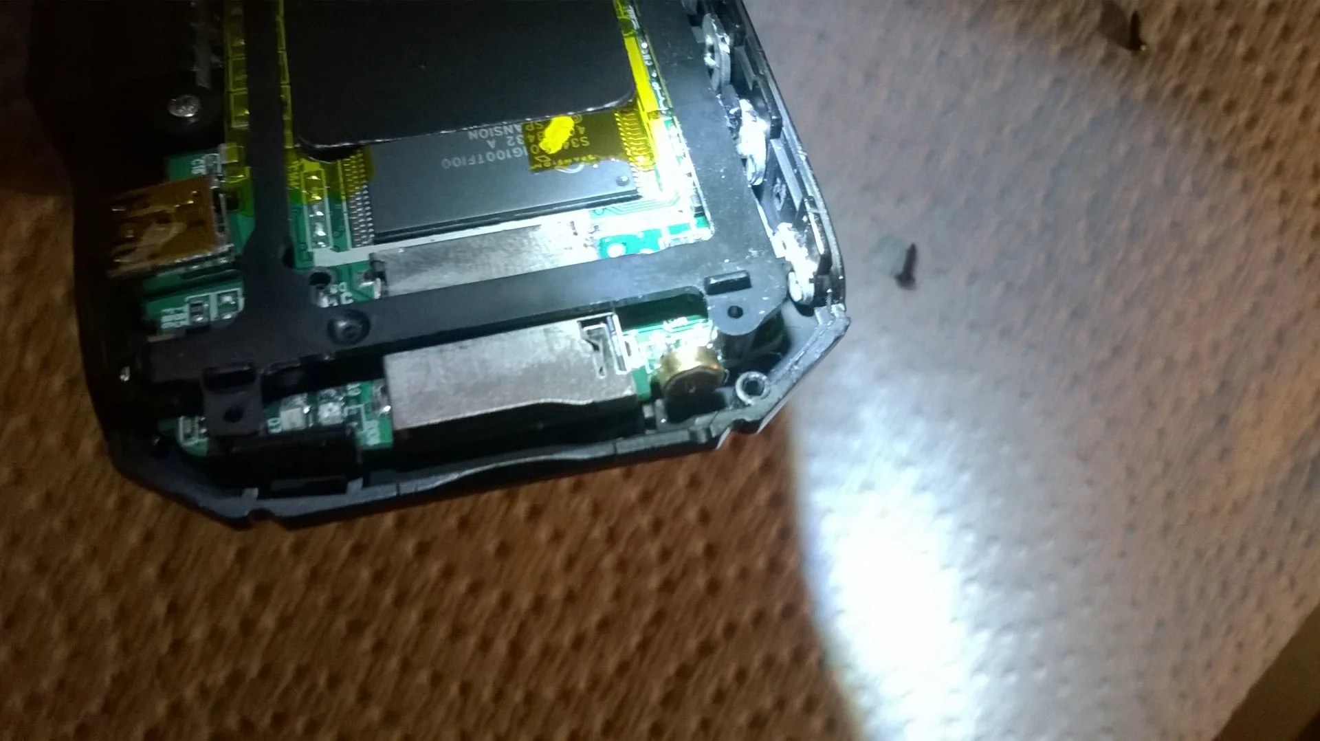

My G90 originally came with firmware 428 ( can't remember if it was that bad like the ones above) and its audio performance is much better with the 441 than the A730. It's possible the mike inside the unit might be making contact with the casing?

working? обновлять можно?
Yes, it works. Обновлять можно, также я выложил это в теме G90 на taker.im.
