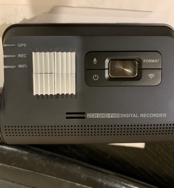

Successfully Surviving Overheat, Heat Sinks Helped A LOT!

All these extras for the Blackview.. Want to reflect the heat? For free? Simply go to a window store that tints windows and ask for some samples or scraps ... I put a small strip of Titanium heat control film just above the DR900s back last December.. Works great..Cant even see it from the outside

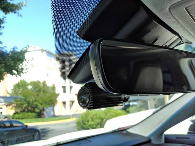

$3 dashcam mount from China
Pros:
Looks a lot more professional
Cons:
Dashcam more visible to outsiders now
Lexus has a huge windshield notch thing and that cuts into the image because mount is just a tad too short
Centering would allow notch reduction, but prevents the use of heatsinks
Heatsinks mutes the mic to about volume level 1 (when set to 5)
But hey, for $3 vs $100 for the blendmount I'll live with those cons.
$10 CPL filter, $6 heatsinks, $3 mount. On a $600 MSRP dashcam yeah I'm cheap LOL

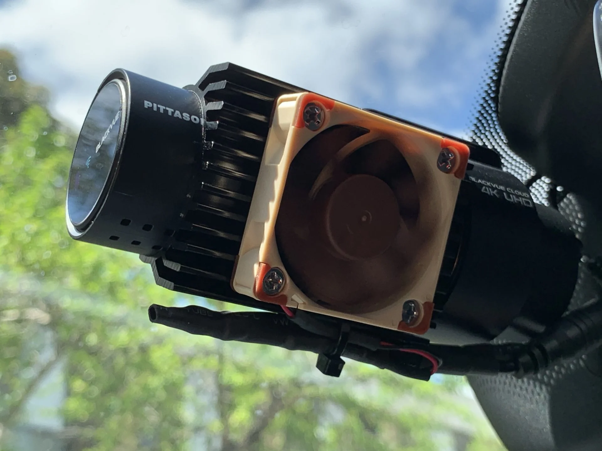

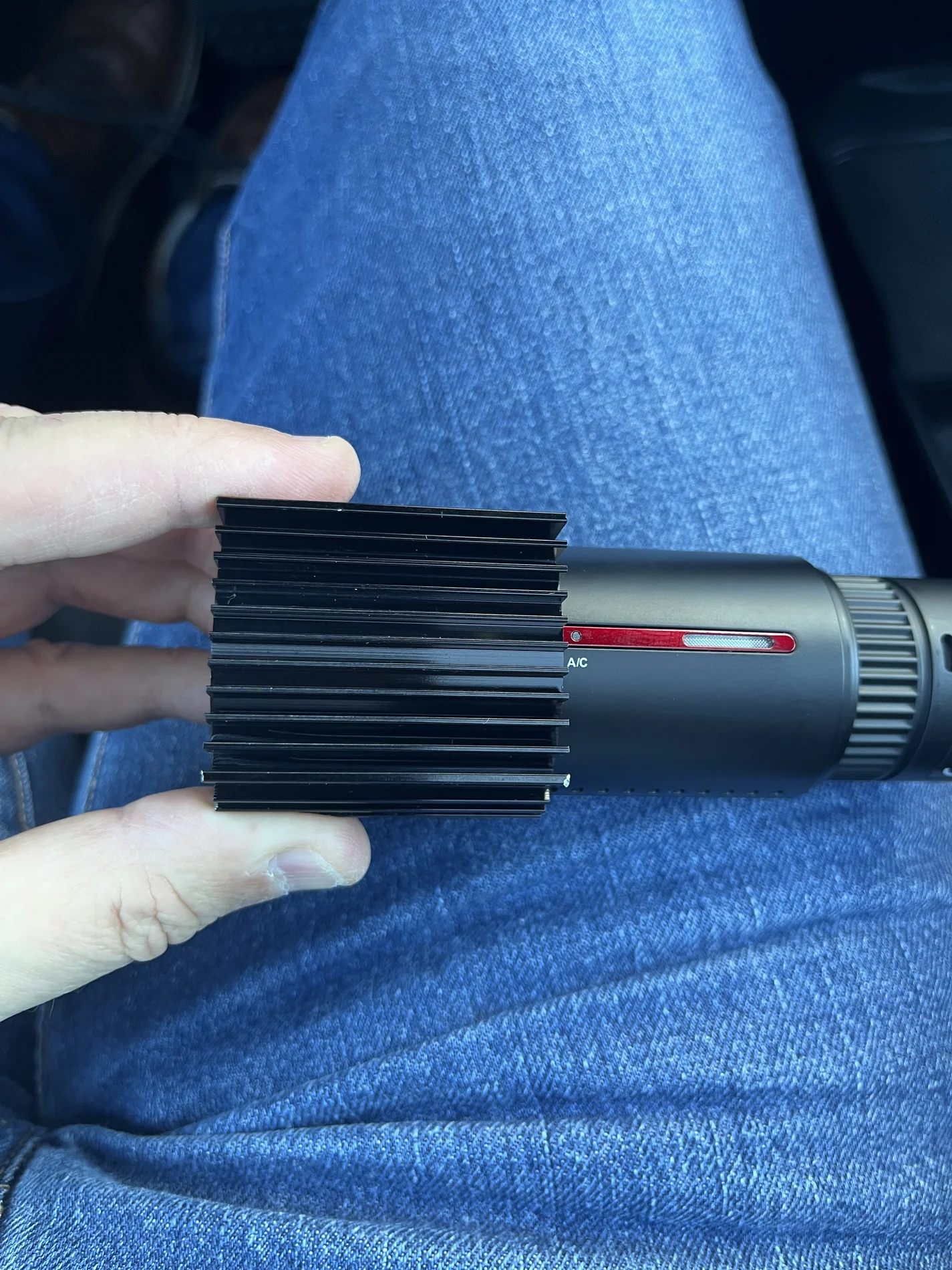

I’ve had 3 x CPV heatsinks on my DR900 for a few months now but as soon as spring came along it started overheating.
My case is unique in that the windscreen is both very inclined and has literally no frit or tint, so it’s always getting a good sunbathing session.
So far this has saved it from overheating but it I doubt it will when it’s 45C in the summer.
You’ll find these heatsinks all over eBay and the fan is a Noctua A4x10 FLX with a low noise adapter.
Spliced a 3.5mm/1.35mm right angled extension cable for power.
Bunnings has M3x12 countersunk screws that worked perfectly.
If you’re taking this project on yourself I’d suggest forgoing the low noise adapter as it’s already very quiet and using a bare aluminium heatsink if you don’t mind the look.
You can combine 30mm and 40mm heatsinks to maximise the area but I used 2 x 30mm to prevent all the vent holes from being covered.
Also, don’t go overkill on wire gauge or it’ll become an ugly heatshrunk tube like below.
The thermal coupling between the internal components, the case and the heatsink isn’t very good to begin with, but it could be improved using some EK 0.5mm thermal pads. Personally I don’t think this will make a huge difference.
Edit: I reckon moving the 2 x 30mm heatsinks apart leaving space in the centre whilst having the heatsink tilted as far down as possible will push air into the lower vent holes - This would make a significant difference judging by the teardown on FCC.

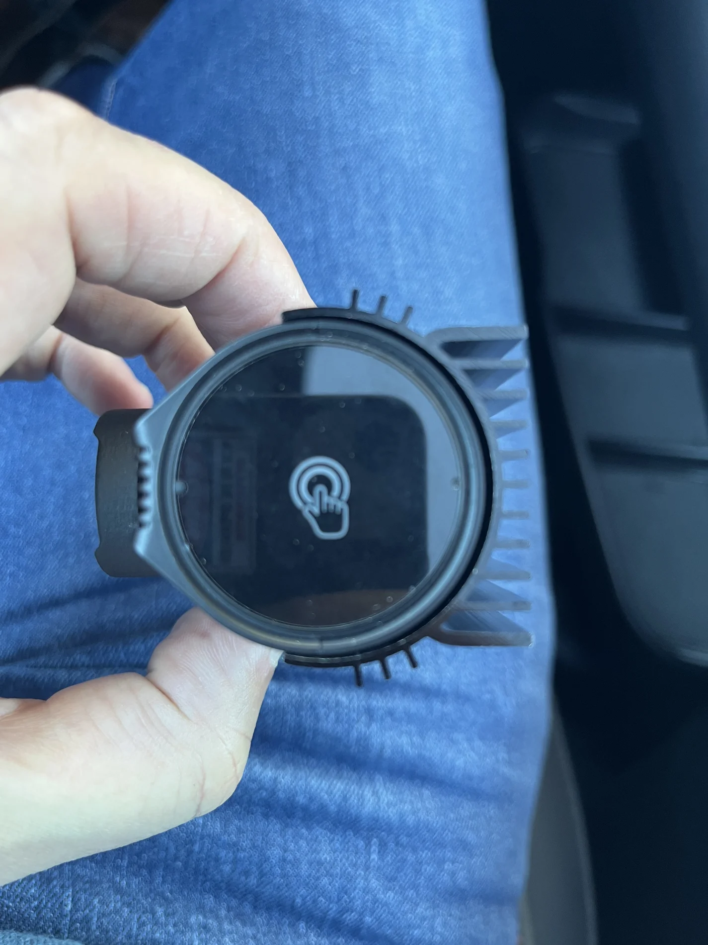

It's the A119 filter. But it fits very loosely.
I took out the lens and made my own pressure mount and I must say, it looks very professional hehe.
Here's the file for anyone with a 3d printer, just rename to stl.

Did you do a fitment test first to see if it snugly fits onto the dashcam? If it fits then you'll have no problem putting the lens on it. I used PETG to avoid warping.
This damn thing took me 19 revisions make. First version was a C clamp but it blocked the recording led so I opted for a friction mount.

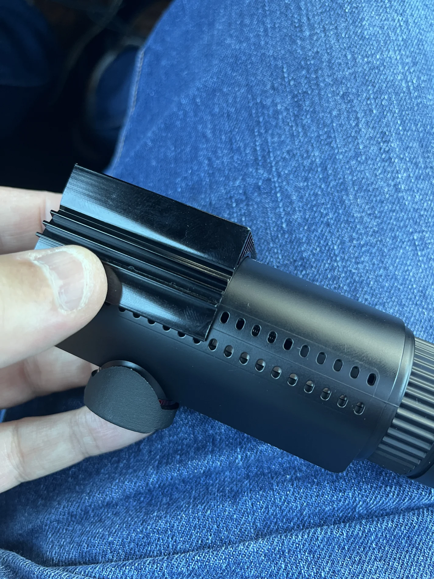

Very informative post. The thing I didn't like about my heatsink was that it muffled the speakers almost completely. I used a dremel to create a little channel or "river" so the sound can travel outward towards the power plug. It doesn't need to be deep and it works amazingly well. Level 5 volume sounds like lv3 now.
