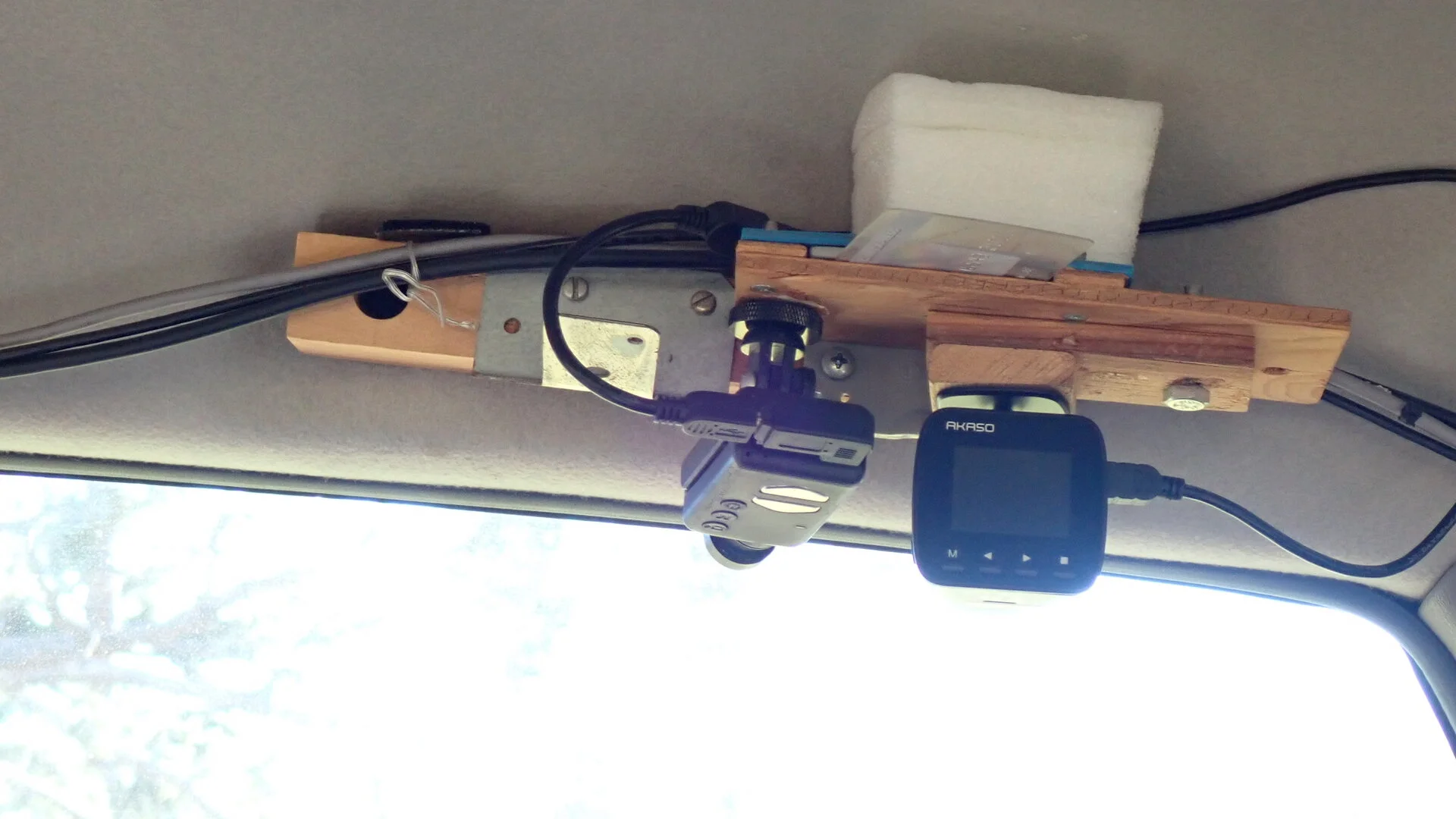

Any ideas how to mount side cameras if you do not have fixed side windows in your car? Thanks.
Then it get rather problematic.
Mounting off the headliner ( which i have done with single cameras ) well that is no good if your curtain airbag deploy.
My best brains storm is to mount off the door plastics where it approach the window, but as it is rarely flat there, you probably need to devise some mount or adapter.
The + is down there is about as far as a curtain airbag reach, but then again it is within reach of kids if you have those and they like to meddle with things.
Either way you will have to DIY something for sure as there are no ready to install side systems.
I had a pair of B1W cameras for recording the side views. Then I replaced them with a Viofo A129, which has 1080p IMX291 both front and rear for good night vision, and a low bitrate parking mode.
Side cams in most cars will require some ingenuity and DIY with mounting. I cannot envision any way to make a suitable mount that would work well across a wide range of cars that would still be solid and aesthetically pleasing. Side cams are not easy to do well, and they don't "blend in" like front and rear cams do where factory sensors and 3rd brake lights are expected to be seen. The B1W's sleek rounded appearance makes it look more like something factory installed, and the mounting scheme is such that it's DIY friendly for side mounting. But currently it has issues 🙁
What I'd really like to see is the B1W updated with the IMX291 which is currently one of the best low-light sensors and it does well daytime too. For most people that would make an ideal side-cam IMHO 😎 My old 'bus' is far different than nearly anything else, and side-cam mounting on the metal surrounding the doors and windows is a breeze with many alternatives.
You do need to pay heed to airbags in wiring and mounting side-cams, as well as places where cables may over-flex, get pinched, or get pulled out, but otherwise it's just another dashcam, only in a less-than-common location 😉
For your next vehicle, you could plan on getting one with fixed side windows, like many SUVs. So, it's a matter of priorities because, of course, if the side cams are more important to you than the type of car, then you could get a car with fixed side windows right away and viola! problem solved.
I replaced the ceiling grab bars with a piece of wood which gave me many options for mounting the cameras.
