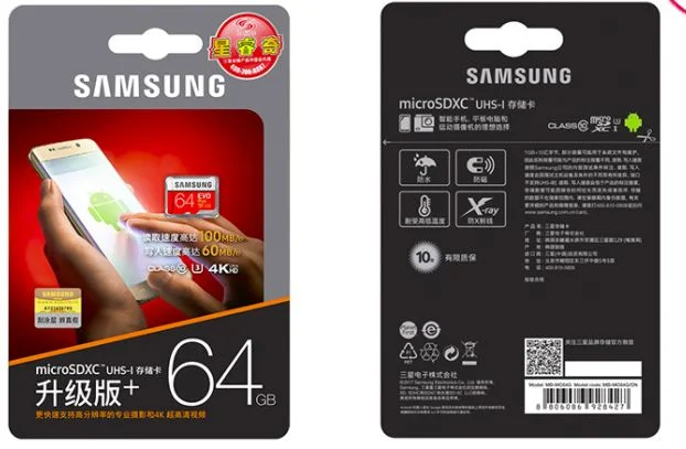

I advise you to try with card brands like Sandisc, Samsung or Kingston, Class 10 U3. I do not think it is related to the temperature of the camera, rather, with the fluency with which the data is coursing to the writing on the card. My second Thieye I received from Amazon UK, was the same as the first camera returned to Bangood, with a Toshiba Exceria class 10 U3 card, was for stopped recordings around the minute of start, then it was a card error. I put a Samsung evo and work fine all time.
Using Samsung EVO PLUS (NOT older EVO + as sold in Australia ) and filming times seem OK.
Problem: I get white screen (keeps recording) and camera locks. As cam heats possibly. I have to remove battery. :(
