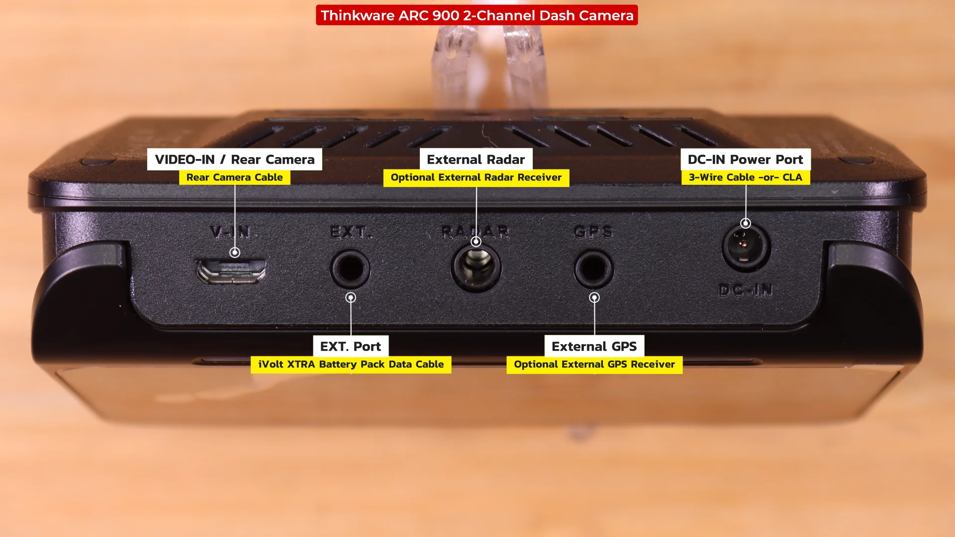

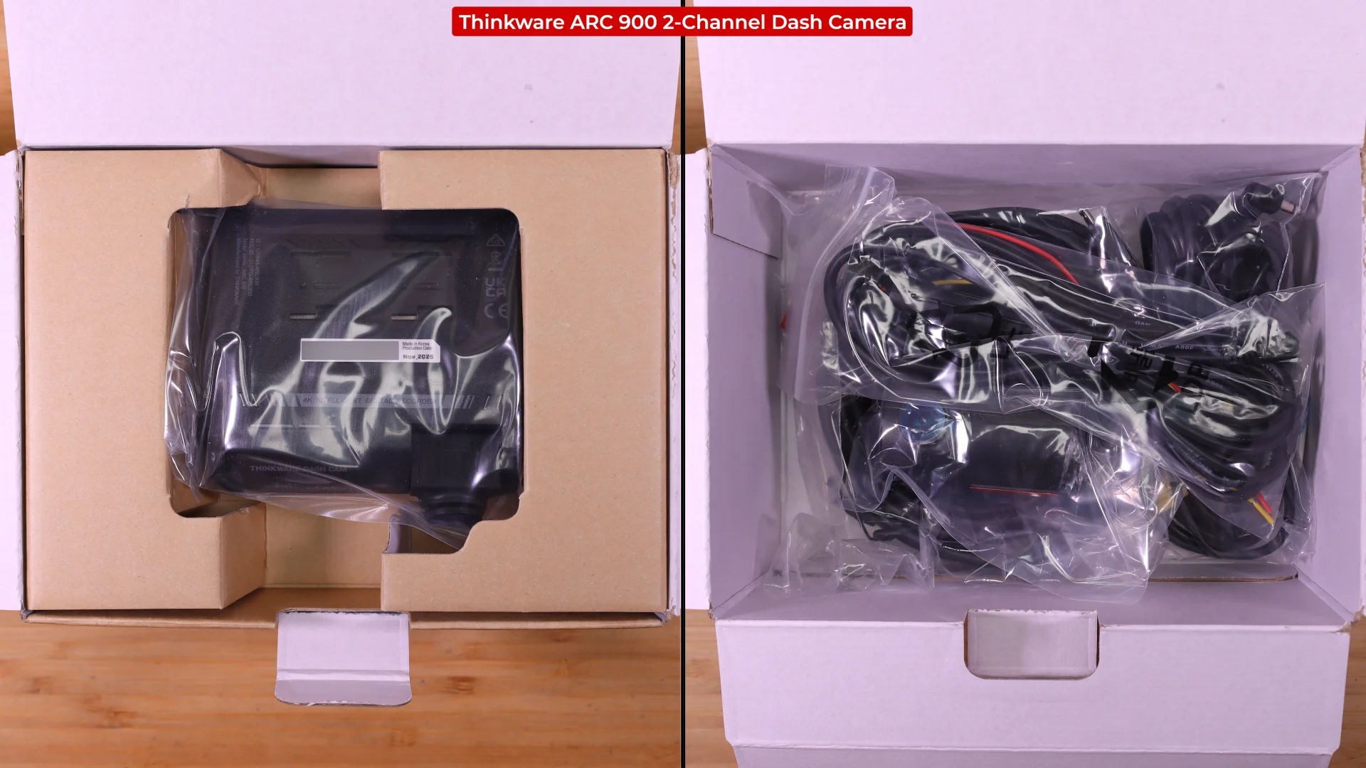

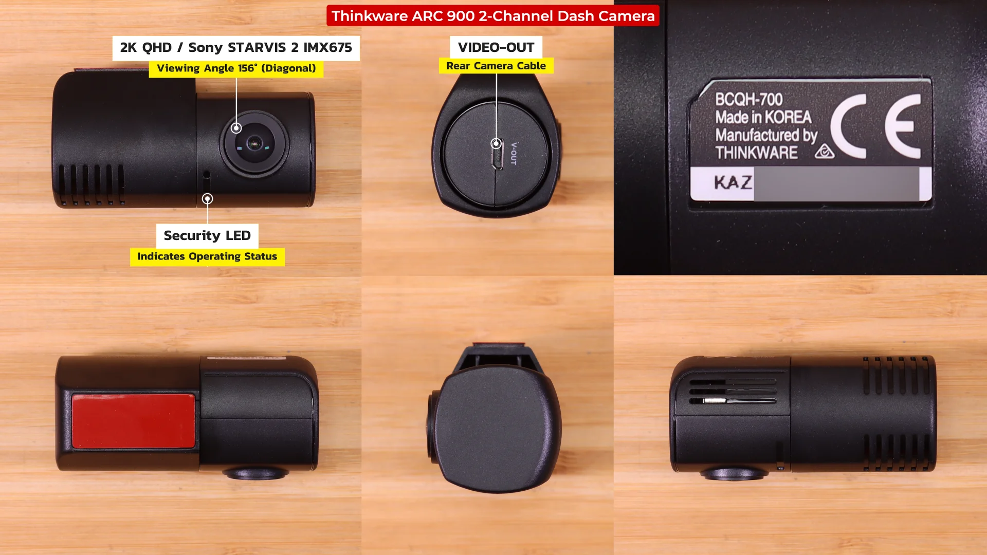

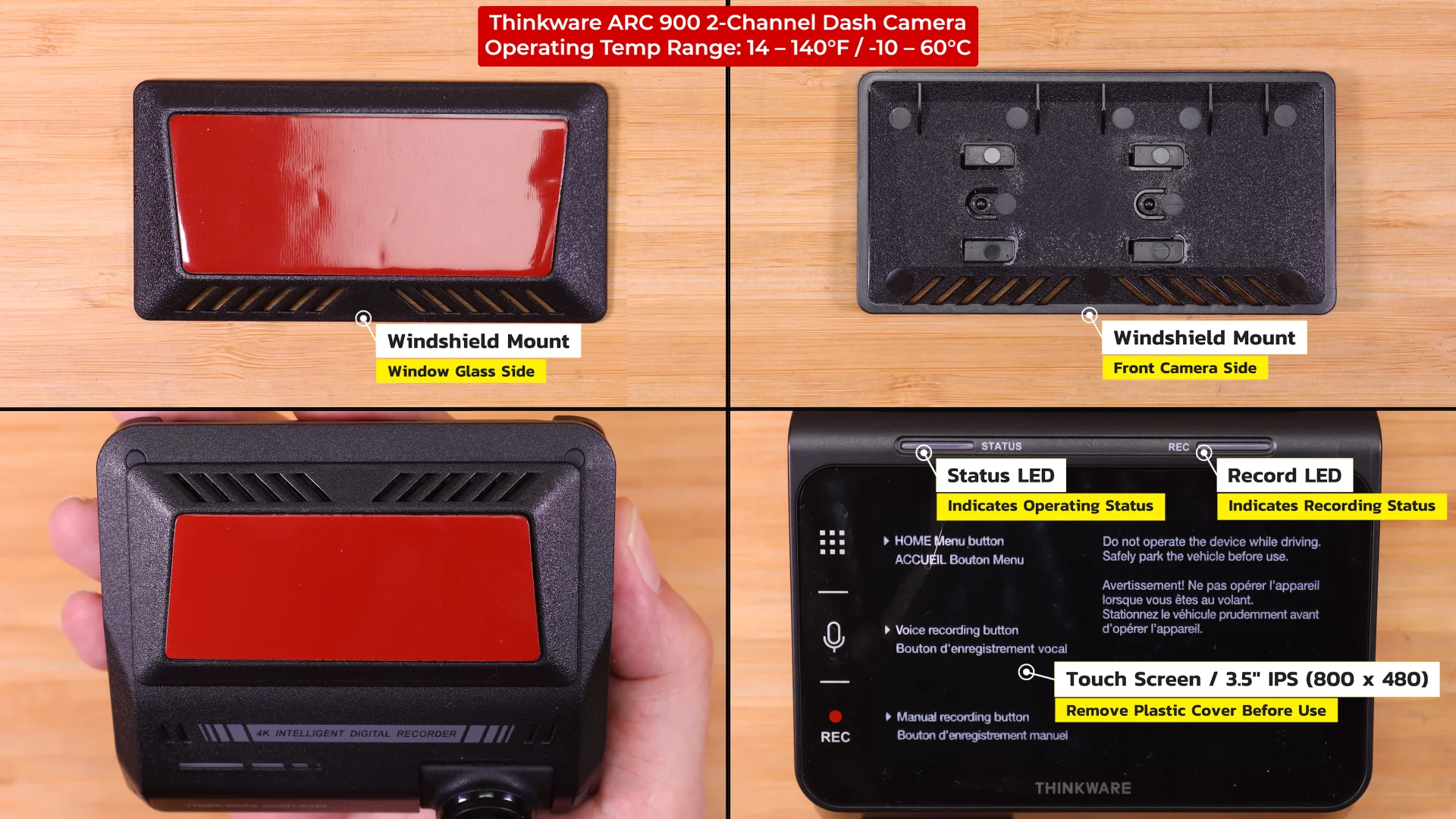

Here are my unboxing pictures for the ARC 900:
Box Outside / Contents:
Unboxing_Pics_4k0.webpUnboxing_Pics_4k1.webpUnboxing_Pics_4k2.webpUnboxing_Pics_4k6.webpUnboxing_Pics_4k8.webp
4K UHD - Sony STARVIS 2 IMX678 - Front Camera:
QHD - Sony STARVIS 2 IMX675 - Rear Camera:

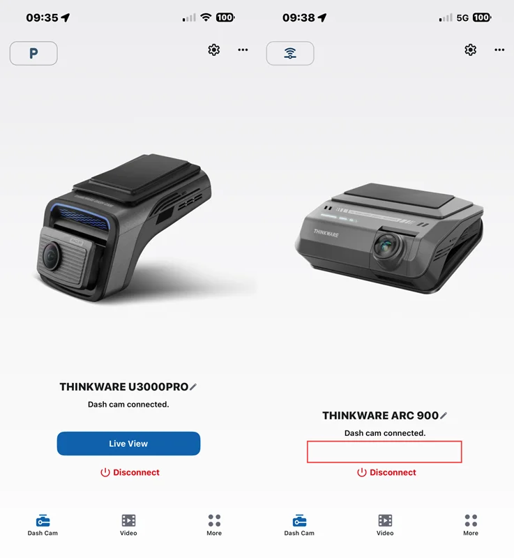

In @Onetenner's review thread, it was already mentioned that the Thinkware "Dash Cam Link" [DCL] app does not have a "Live View" option for the ARC 900. I also found this to be the case and it's very annoying trying to adjust the rear camera view angle [up/down] when you can't see the rear camera in the DCL app. Most Thinkware dash cameras have the "Live View" feature available, but not their most recent model[?]. I placed a red box in the area from the ARC 900 screenshot from the DCL app where it would have the "Live View" button if the feature was available.

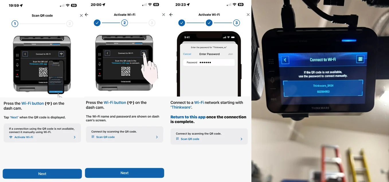

Another Wi-Fi related annoyance, is that you must scan a QR code on the ARC 900 screen every time you want to connect it over Wi-Fi via the DCL app. This makes it necessary to mount the ARC 900 on the windshield in a location that the QR code can be scanned.

If I remember correctly, there is a password option rather than using the QR scan - I had the same issue as the screen was obscured by the rear view mirror...

You are correct, there is a manual method of connecting to the ARC 900's Wi-Fi. The first time [or before you install it in the vehicle] you need to see the Wi-Fi password that is shown on the screen so you can setup the Wi-Fi connection on your phone.

Hi @rcg530
Thinkware Dash Cams with LCD screen don't support live view using the app, as you can use their LCD screen for adjusting the field of view of the dash cam for both front and rear.
Here's how to use its screen as live view for installation
