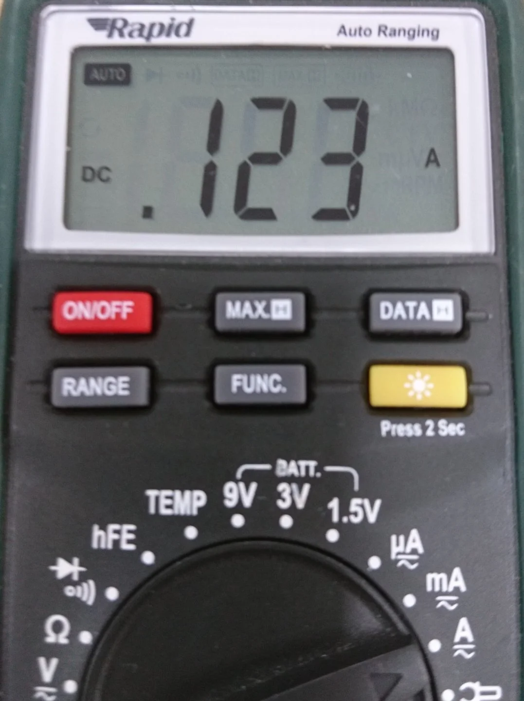

Great does it draw much power, i.e. continual recording or motion sensing or time lapse?
I don't know whether to go for this F50, X550,F770, the X550 looks a bit unstealthy?
F50 Normal recording mode it's sitting around this 0.123 amp

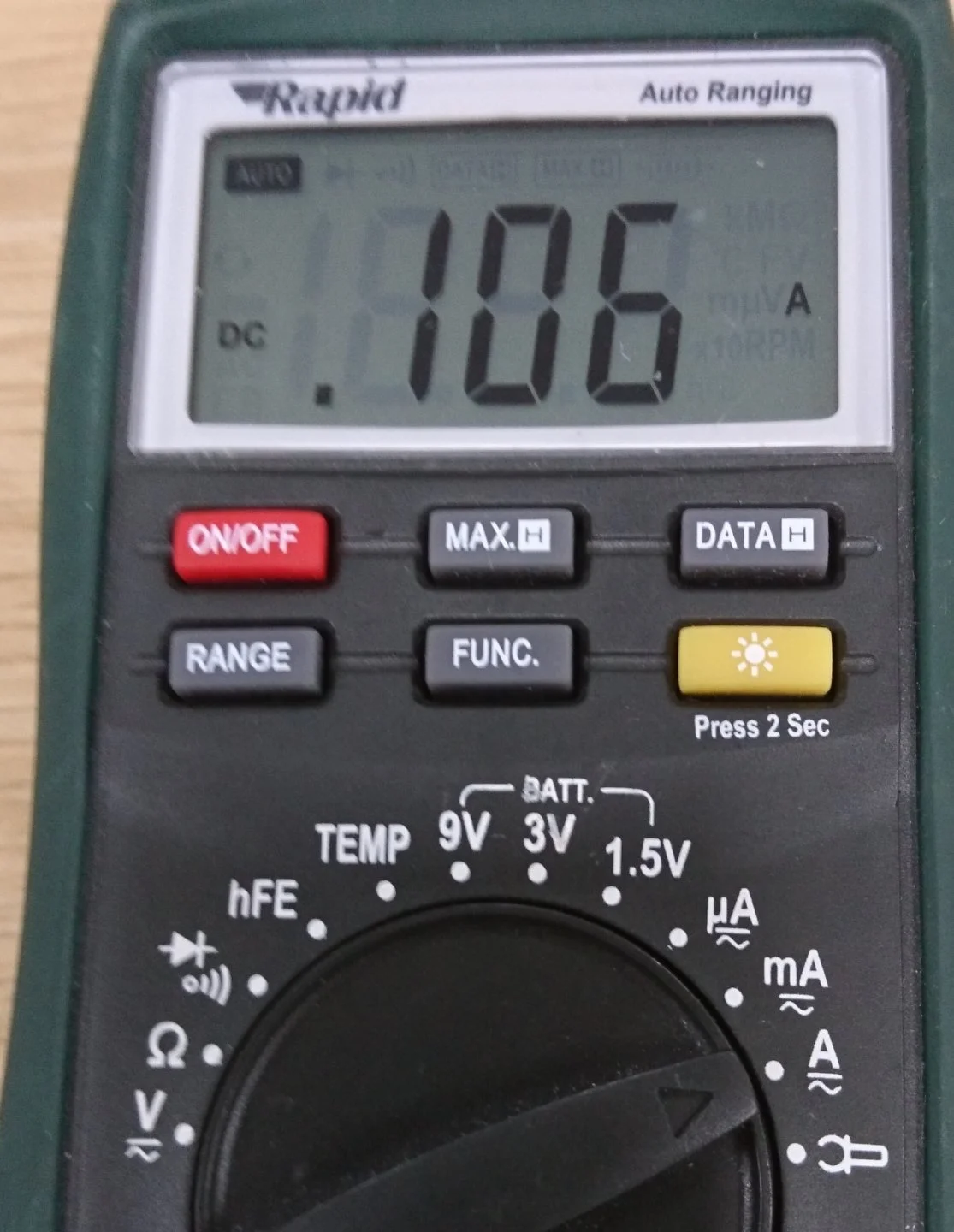

Parking mode (No time lapse on F50 model) is sitting around 0.106 amp
