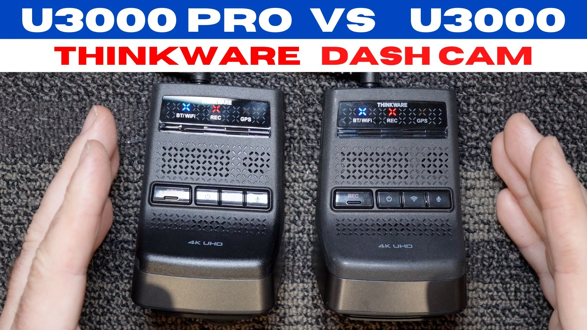

Video dropping soon
Thanks for the video! Cool to see some details like the radar portion in the rear cam rotating with the lens so that it stays facing directly behind.
HDR on the front cam does look like it helps, but I'm still a little underwhelmed by the nighttime video from the front cam. I'm curious how much of an improvement there is with the rear cam going from Starvis to Starvis 2.

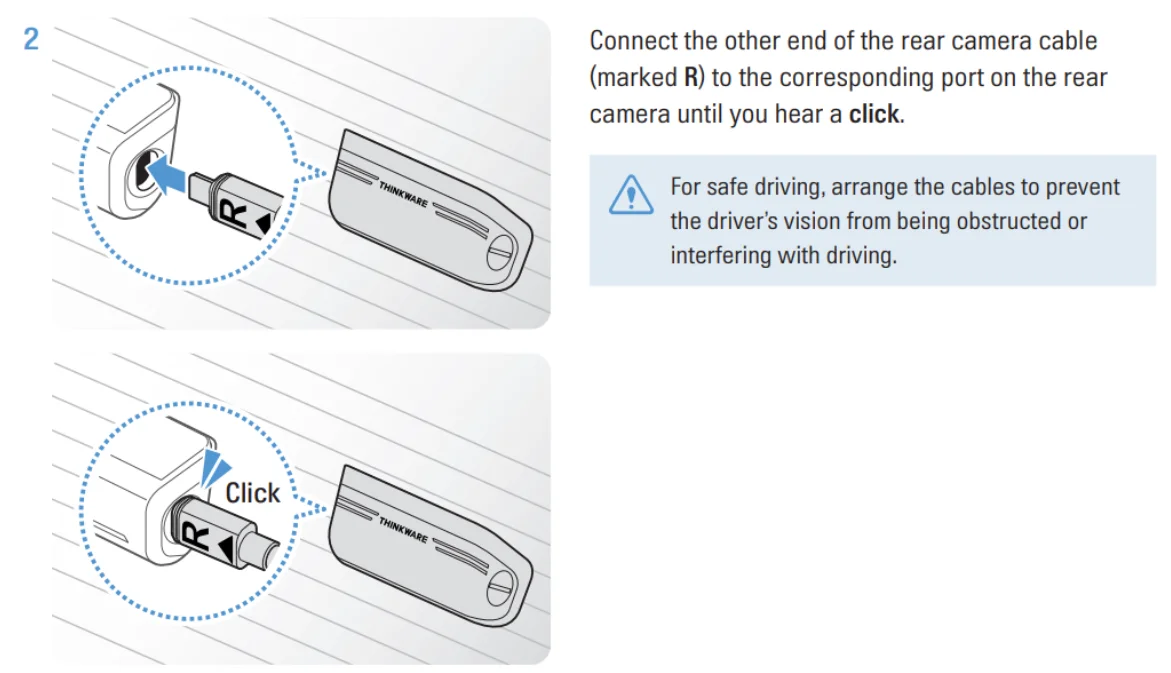

The big thing with the U3000 rear camera's radar feature not working was that the rear camera cable was not getting fully inserted into the rear camera cable connector.
The problem was that the rear camera cable would easily push into the connector on the rear camera and that's where some users would stop inserting the cable. A typical approach for USB computer cables. That would result in the rear camera being powered and video recorded for the rear camera, but the rear camera radar system was not powered and/or connected with the front camera since the connector pins in the rear camera cable had slightly different lengths. If you pressed in the rear camera cable until there's a slight "click" that would "lock" the rear cable into place and all of the pins in the cable were in contact with the corresponding pins in the rear camera connector port, the rear camera and the rear radar feature worked.
If the cable is the same [which it is], that could still be an issue for people having problems with the rear camera radar feature "not working". I know Thinkware improved how the rear cable "snaps" into place in later U3000 production cameras/cables. Thinkware added more info in their help system about making sure the rear camera cable is fully inserted until it "clicks" into place after I found the root cause this issue:

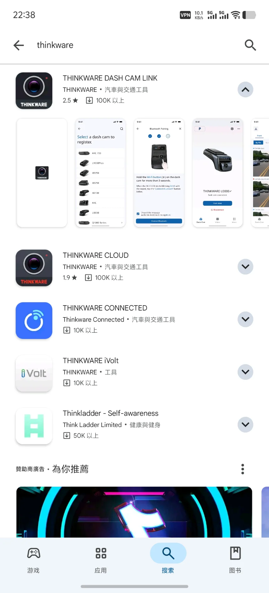

so please give me help. thx very nuch
i buy u3000pro from thinkware hongkong reseller and i use it in shanghai China
and when i install thinkware dashcam link app from google play
and install many tiimes
the app cannot show the u3000pro .just show the old u3000
i cannot connect u3000pro with the app
so what promble? it is very strange

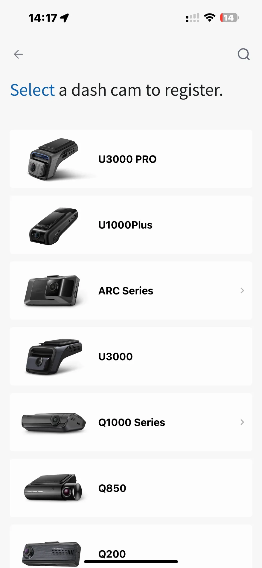

It's there in my app - where are you downloading it from?
Mine is version 2.3.4 but thats on an apple device

i want to know thinkware can send me a apk file ..... and install my android phone
now i take 600usd buy this and now i can not use it
that is crazy
it never happen for other brand like korea dashcam blackvue and vueroid
