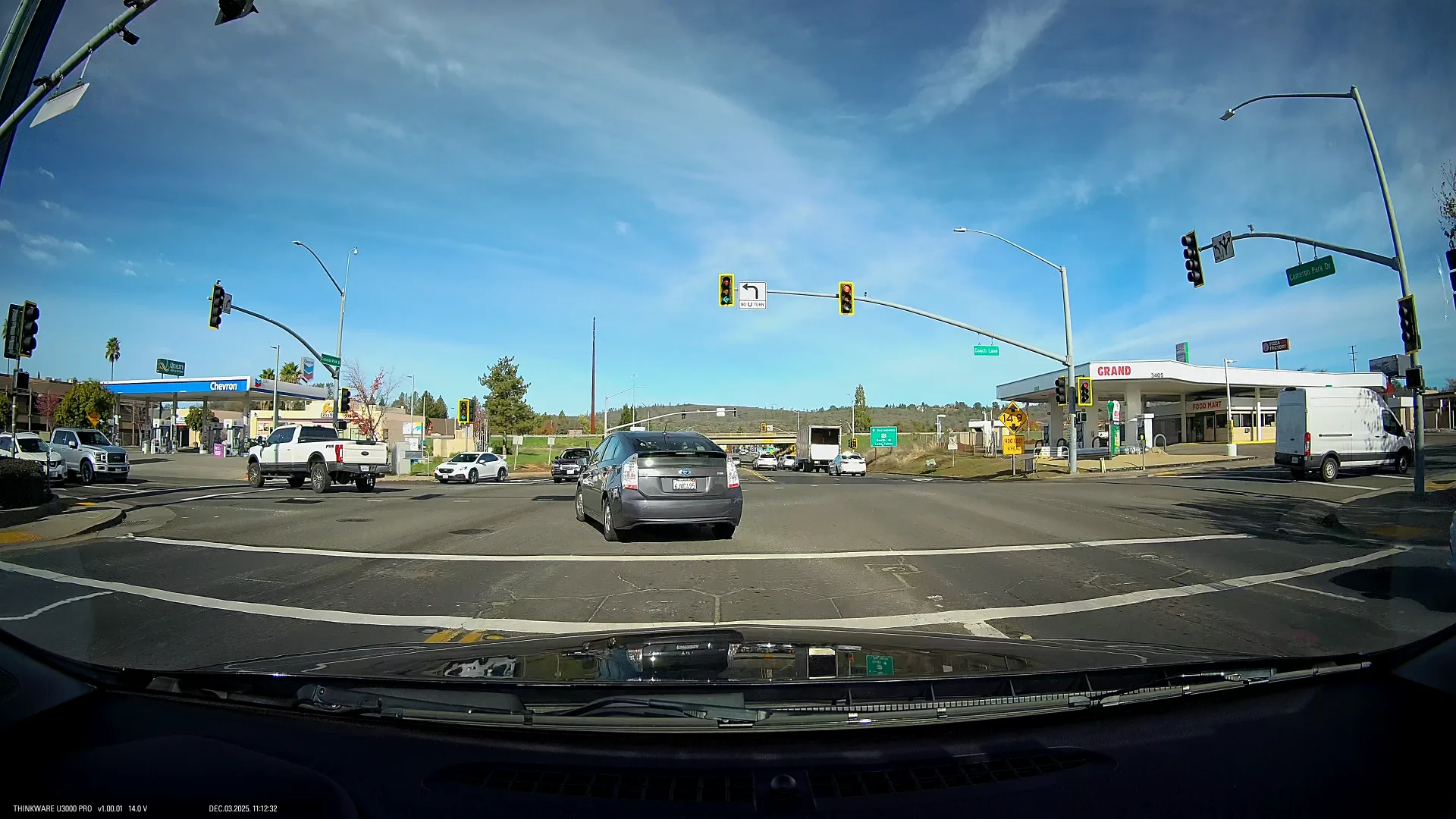

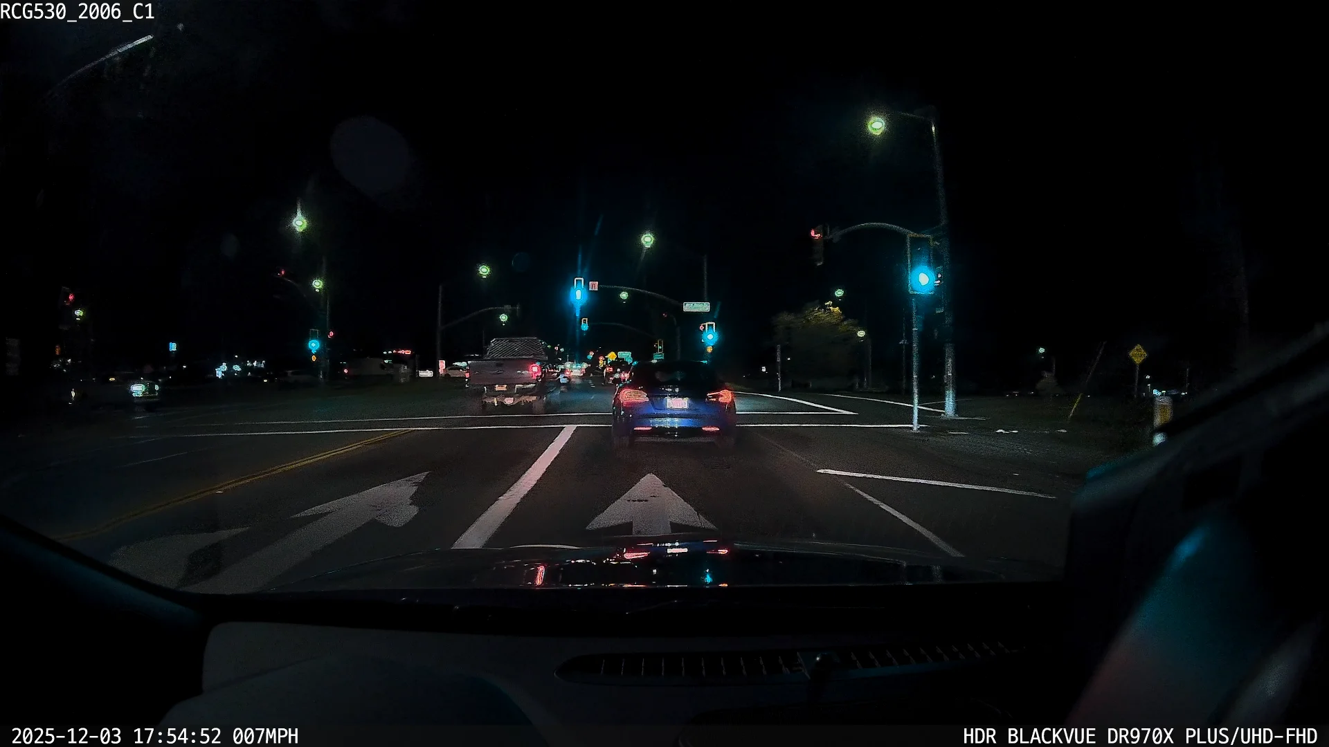

Here are frame grabs from the five dash cameras I have in this car.
BlackVue DR970X Plus v2.006 HDR/CPL / Thinkware U3000 Pro v1.00.01 HDR/CPL / VIOFO A229 Pro v1.4_250918 HDR/CPL / VIOFO A329S v2.0_251029 HDR/CPL / VIOFO A229 Ultra v1.1_250926 HDR/CPL
01_20251127_080558_NF.mp4_snapshot_00.53.webp01_U3000Pro_REC_20251127_080559_F.MP4_snapshot_00.23.webp01_A229Pro_2025_1127_080612_002471F.MP4_snapshot_00.09.webp01_A329S_2025_1127_080615_006089F.MP4_snapshot_00.04.webp01_A229Ultra_2025_1127_080617_003109F.MP4_snapshot_00.05.webp
It looks like I need to tweak the aim of the U3000 Pro front camera a small amount [upward] since there's a large amount of the dashboard in the field of view. The U3000/U3000 Pro front camera adjustment can drift a small amount just after you move the front lens assembly based on the resistance based adjustment mechanism used in this unit. I used a different phone to align the U3000 Pro than I usually use, so that is likely why the alignment is not quite where I want it to be.

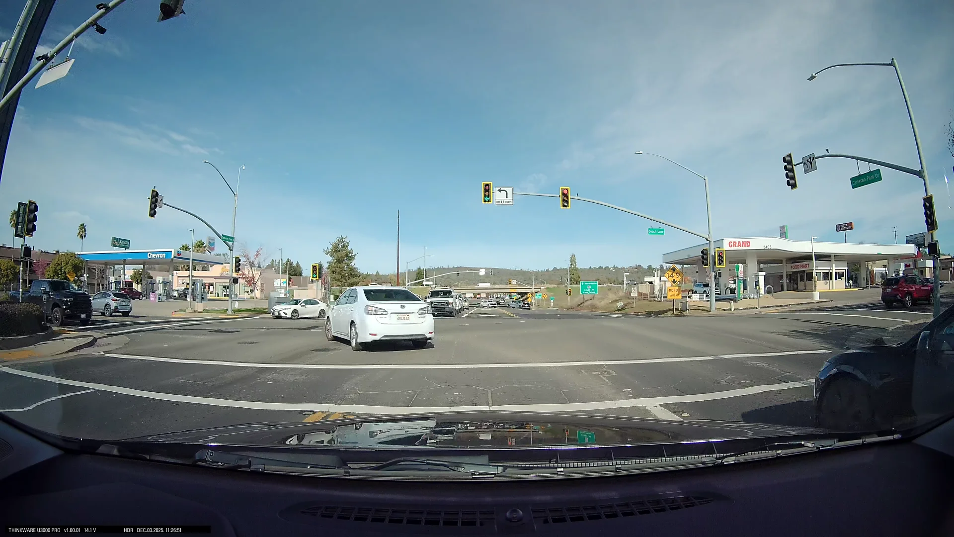

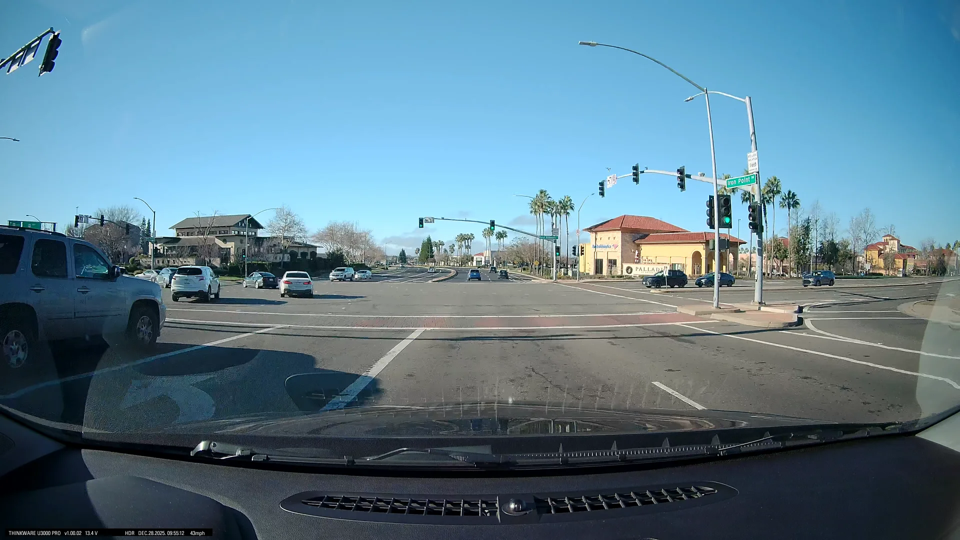

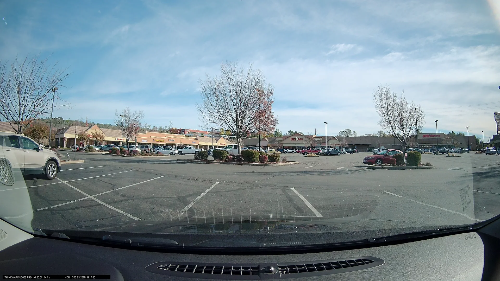

I drove my car for a quick trip into town. I had the U3000 Pro configured with its HDR setting set to "Auto" for the first part of the trip which appears to be "Off" for daytime. I'm asking Thinkware to more clearly define what "Auto" means since the U3000 Pro user manual does not address what "Auto" means [ambient light exposure based is my guess]. There's no HDR Timer that I can find. The front lens aim was moved upward a bit, but it might be too high. The Thinkware app alignment line for the top/front edge of the hood is still saying I should move it further up, but that would make the front camera aimed far too much at the sky. The CPL filter was installed on the U3000 Pro. It's a stick on CPL filter. Once the CPL filter is installed, you shouldn't take it off.
Left = HDR "Auto" [Off since it's daytime] / Right = HDR Enabled
01_u3000pro_hdr_auto_off_REC_20251203_111624_F.MP4_snapshot_00.07.webp01_u3000pro_hdr_on_REC_20251203_111659_F.MP4_snapshot_00.01.webp
02_u3000pro_hdr_auto_off_REC_20251203_110425_F.MP4_snapshot_00.56.webp02_u3000pro_hdr_on_REC_20251203_111959_F.MP4_snapshot_00.56.webp
03_u3000pro_hdr_auto_off_REC_20251203_111225_F.MP4_snapshot_00.06.webp03_u3000pro_hdr_on_REC_20251203_112559_F.MP4_snapshot_00.52.webp

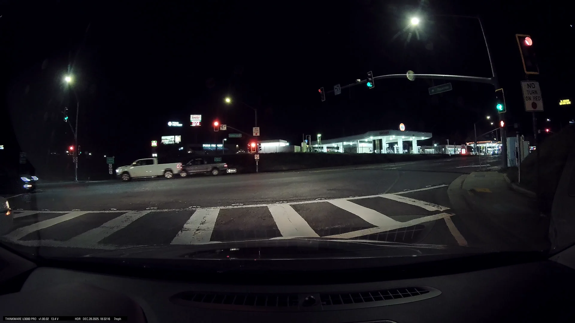

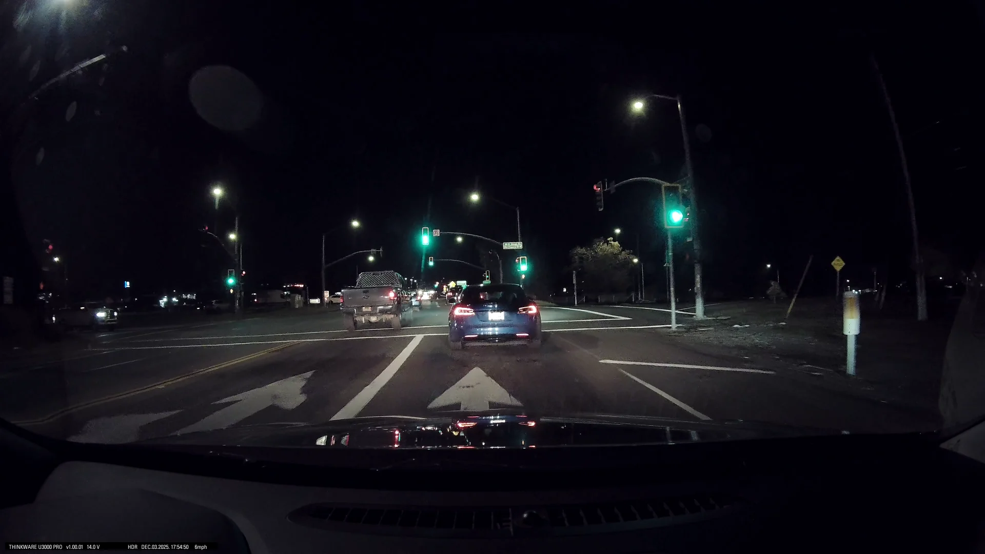

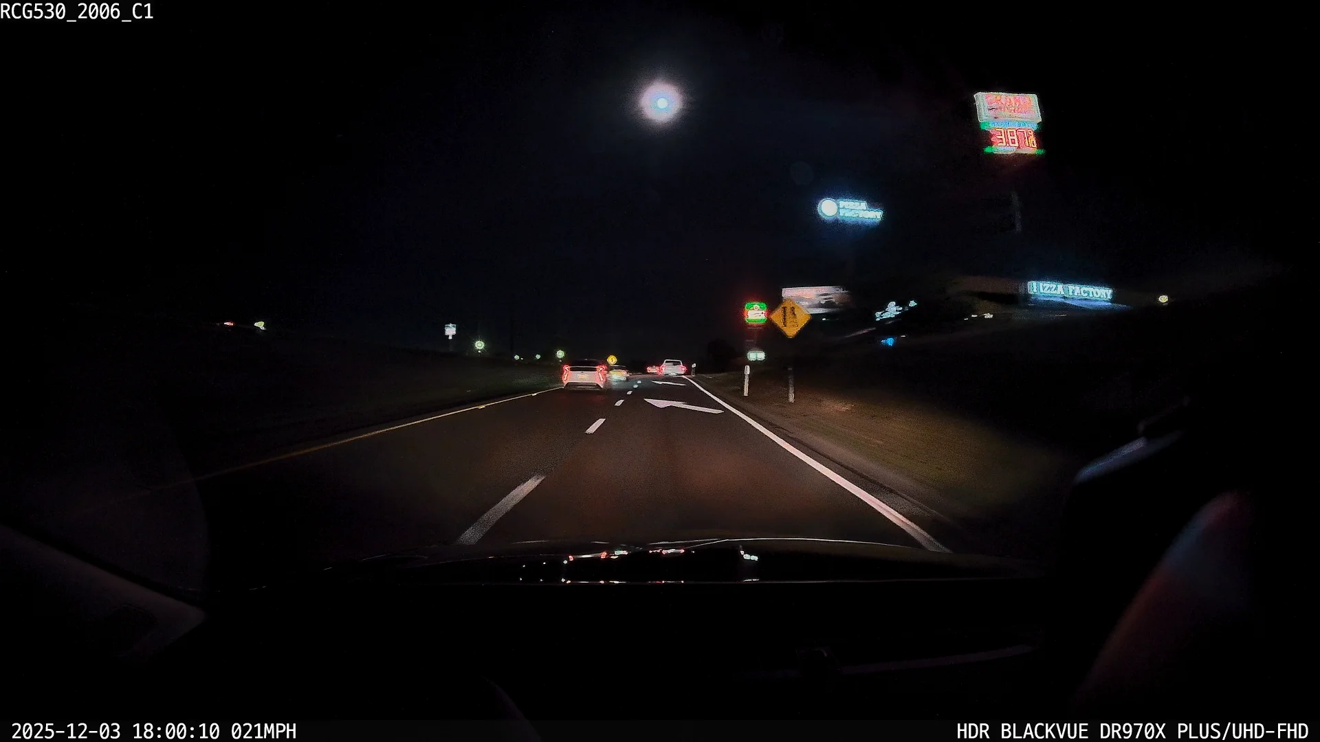

I gathered some nighttime footage with the U3000 Pro and five other dash cameras. I'll start working on a video with day/night video samples tomorrow.
I have HDR enabled on all dash cameras and the CPL filters are installed. A user will not be constantly installing/removing a CPL filter, so I left them on for this drive. The U3000 Pro CPL filter has an adhesive ring on it, so you wouldn't want to install/remove it on a continuous basis.
01N_U3000Pro_HDR_CPL_REC_20251203_175953_F.MP4_snapshot_00.16.webp01N_DR970XPlus_HDR_CPL_20251203_180007_NF.mp4_snapshot_00.03.webp01N_A229Ultra_HDR_CPL_2025_1203_180006_003335F.MP4_snapshot_00.03.webp01N_A229Pro_HDR_CPL_2025_1203_180007_002807F.MP4_snapshot.webp01N_A329S_HDR_CPL_2025_1203_180008_006423F.MP4_snapshot_00.00.webp01N_S14K_HDR_CPL_20251203_175948_INF_F_N.mp4_snapshot_00.20.webp

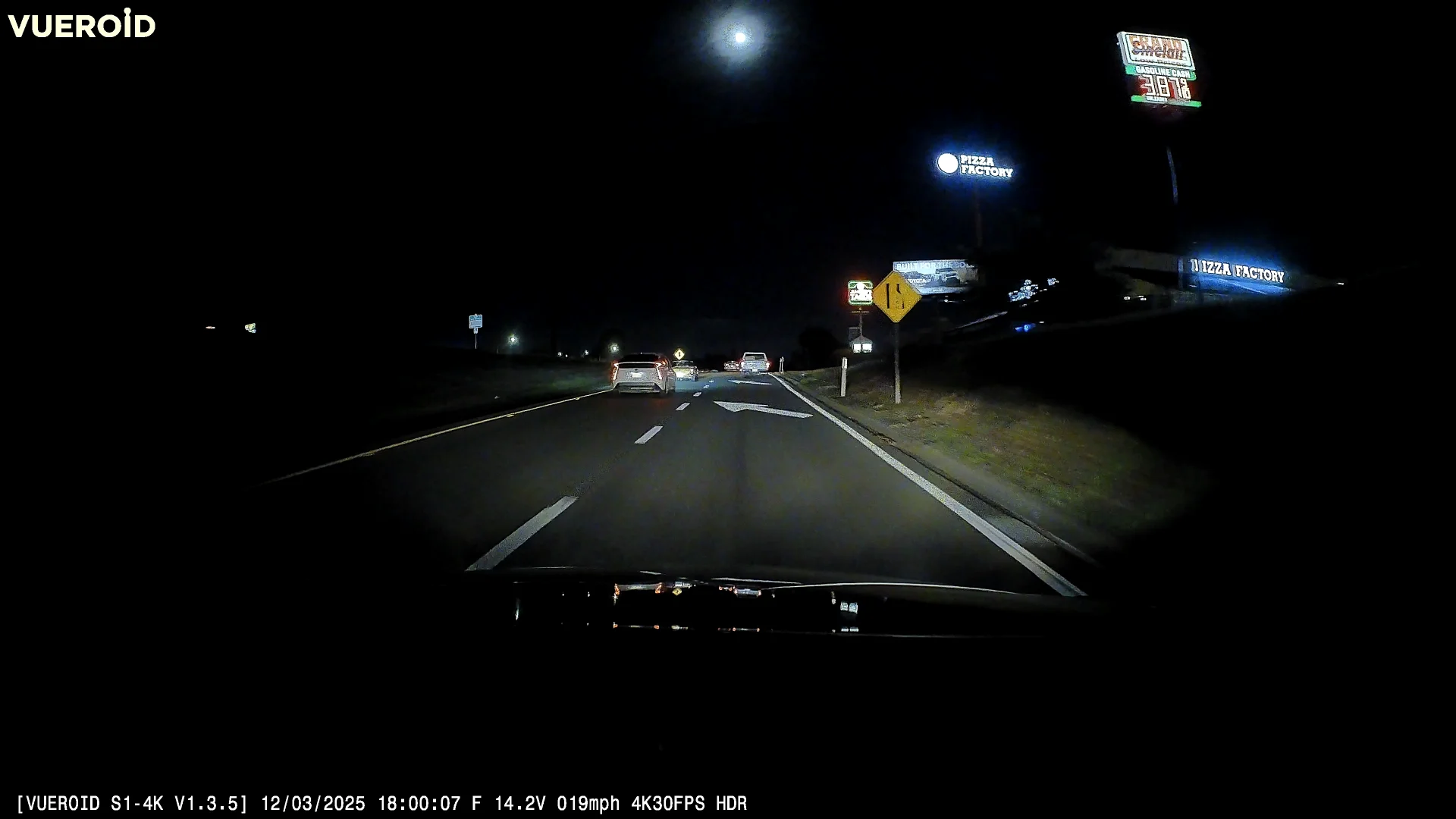

Frame grabs from a location where my car's headlights are shining directly on the rear license plate from the car in front of my car with about 1.5 car lengths between them. The U3000 Pro shows a white blob instead of the plate characters while most of the other cameras seem to pickup the plate characters. The BlackVue DR970X Plus shows some of the characters on the edges of the plate. I'll include this example in my video with day/night video samples.
02N_U3000Pro_HDR_CPL_REC_20251203_175353_F.MP4_snapshot_00.57.webp02N_S14K_HDR_CPL_20251203_175448_INF_F_N.mp4_snapshot_00.01.webp02N_A329S_HDR_CPL_2025_1203_175406_006405F.MP4_snapshot_00.43.webp02N_A229Ultra_HDR_CPL_2025_1203_175406_003323F.MP4_snapshot_00.45.webp02N_A229Pro_HDR_CPL_2025_1203_175407_002789F.MP4_snapshot_00.44.webp02N_DR970XPlus_HDR_CPL_20251203_175404_NF.mp4_snapshot_00.47.webp
View attachment 88431View attachment 88430
View attachment 88428View attachment 88429
View attachment 88426View attachment 88427
Did you have the polarising filter fitted for those shots?
View attachment 88446View attachment 88445View attachment 88444View attachment 88442View attachment 88441View attachment 88443
There's definitely some work to do to improve the focus / image processing, the same goes for the images above, the signs look very 'soft' compared to the other brands processing.
Thanks - I installed one on the U3000 Pro I briefly owned. Looking at the reflections, it wasn't clear if you'd fitted the polarising filter or not.

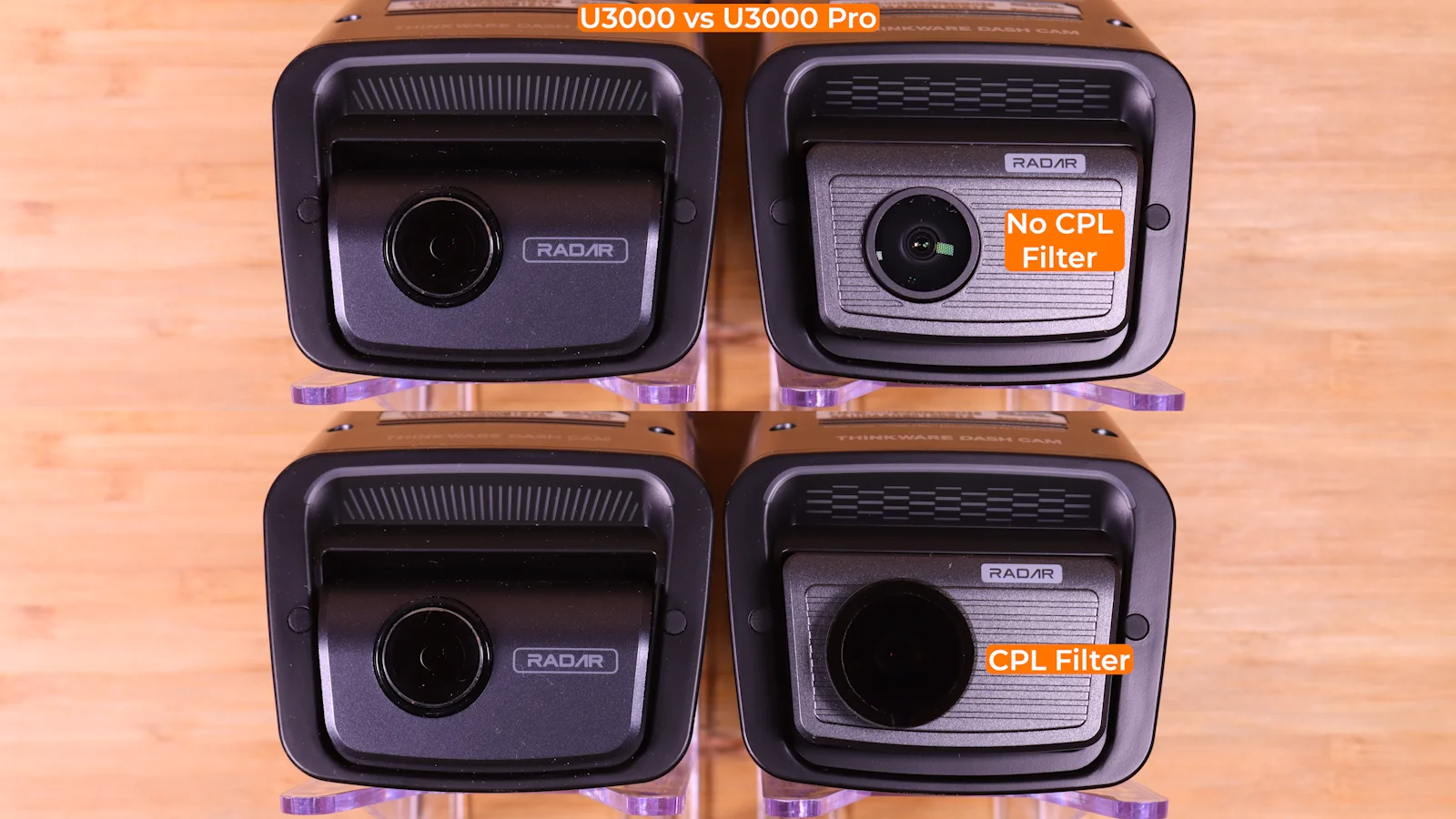

U3000 vs U3000 Pro - Front Camera
The U3000 Pro front camera USB-C port is used when you purchase the optional LTE module or the optional interior camera. Only one of those two optional accessories can be used with the U3000 Pro front camera at a time.

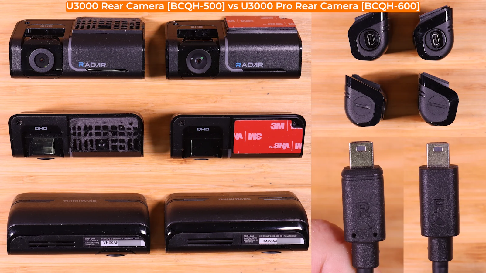

U3000 vs U3000 Pro - Rear Camera
The U3000 Pro rear camera is a 2K QHD camera using the Sony STARVIS 2 IMX675 image sensor also with HDR support.

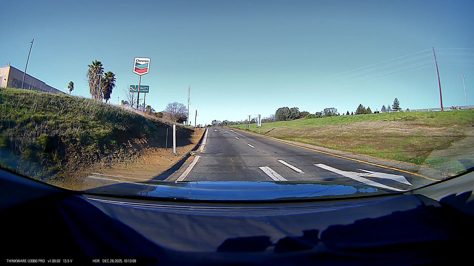

Here are a few day and night frame grabs from the U3000 Pro front and rear cameras. I show the day frame grab and then the night frame grab from the same location. The window glass was cleaned before each drive.
I posted the frame grabs from a BlackVue Elite 9 dash camera in this post: BlackVue Elite 9 - Testing/Review - RCG - Post 40
I posted the frame grabs from a Vantrue N4 Pro S dash camera in this post: Vantrue N4 Pro S - Testing/Review - Post 11
Front: Day = CPL / Night = No CPL
01_U3000Pro_Day_CPL_REC_20251228_095312_F.MP4_snapshot_00.13.webp01_U3000Pro_Night_REC_20251228_180752_F.MP4_snapshot_00.20.webp
02_U3000Pro_Day_CPL_REC_20251228_095512_F.MP4_snapshot_00.00.webp02_U3000Pro_Night_REC_20251228_180952_F.MP4_snapshot_00.17.webp
03_U3000Pro_Day_CPL_REC_20251228_101211_F.MP4_snapshot_00.58.webp03_U3000Pro_Night_REC_20251228_183152_F.MP4_snapshot_00.23.webp
