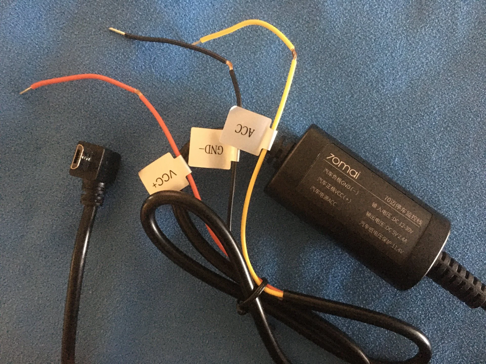

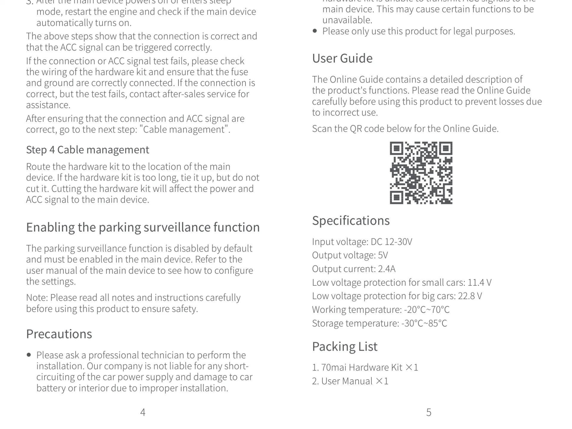

Also on the hardwire kit, I thought there would be a switch setting to set the minimum voltage cutoff but there isn’t. It’s just a sealed unit.
The low voltage cut of in some hard wire kits i only think is there when it is 5 V cameras, if the camera is 12 V then the low voltage cut off are often in the camera itself.
But i think ??? the A800 are powered by a USB plug so it too must be 5V.
I am wondering if you can access the hard wire kit from the camera and set a low volltage cut off that way,,,,,,, though i doubt it as that would be more complicated then a 3-4 position slider switch.
Yes if it is a micro / mini or USB C plug in the camera for power it is 5 volts, the hard wire kit is that 2 or 3 wire ?
It’s a 3 wire.
