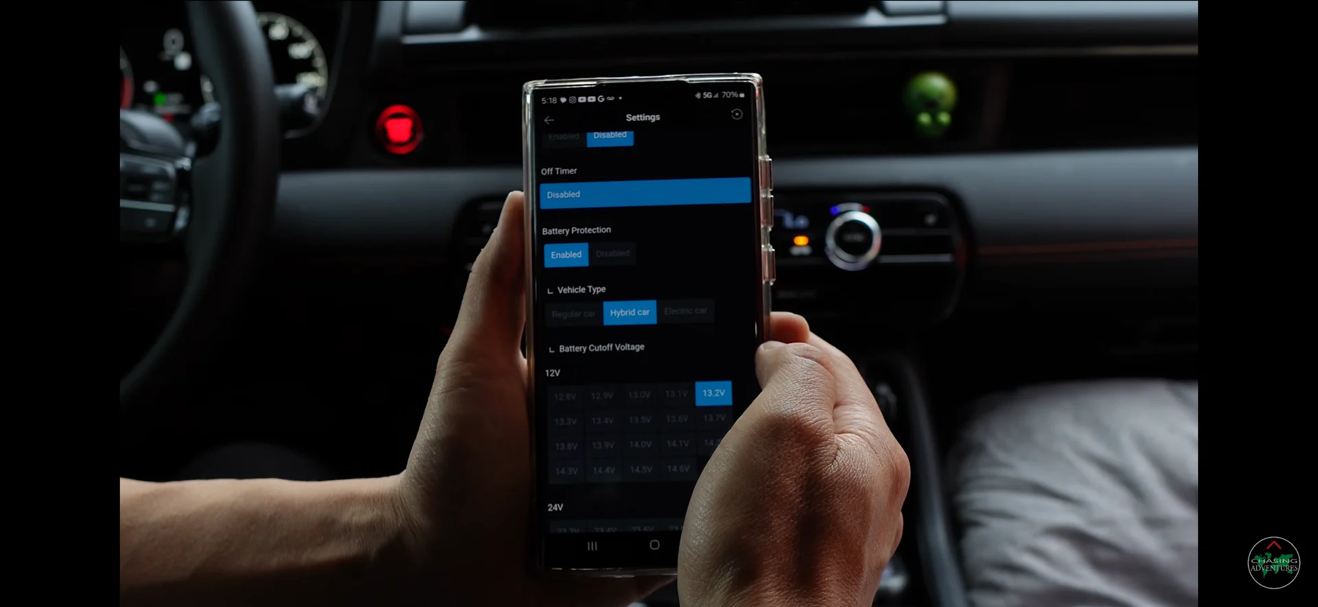

2025 Toyota Crown Platinum hybrid here. I’m VERY confused on how to set the 12v battery voltage to 12.4v. In the dash cam app itself, when you select vehicle type hybrid. 12.4v is nowhere to be seen. If I select regular car under vehicle type, 12.4v appears. I will be using the obd 2 power cable with the switch set for electric/hybrid parking mode. I don’t know if that and the app would get confused if I set to 12.4v under regular car type in the app. Please assist, thank you.

Additional question with my original post. My apologies for not being able to edit it. Since I’m setting it up for the first time. Maybe I don’t have to do any of that and knows it’s a hybrid? Or do I just go in the app, select hybrid and it defaults to settings or what? Thinkware is not clear or says anything about this stuff when setting up for the first time.

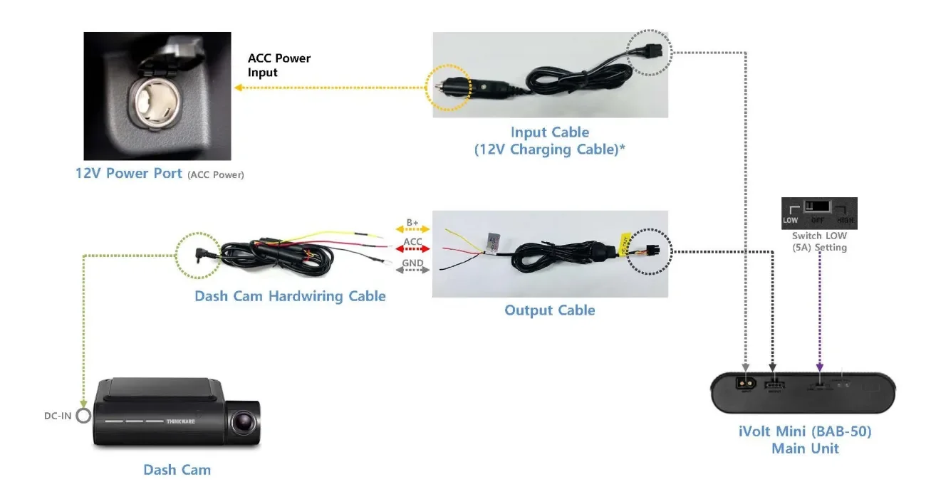

I am legitimately going crazy with this completely undecided. Because my install date is approaching, not sure on the included obd 2 cable route or battery pack. I needed to order the battery pack items to make the install time IF going that route. I really prefer the least invasive route install wise with the battery pack if it goes that way. I ordered the following,
iVolt mini battery pack
Hardwire cable (required)
12v power outlet charging cable
Made sure my 12v is not always on and it does shut down every time. Thoughts, opinions etc welcome to anything. Thanks.

You stated you are considering using an iVolt Mini BAB-50 battery pack. You also stated the vehicle's 12V power outlets turns off when the vehicle is turned off. You ordered the optional 12V iVolt Mini External Battery Input Cable (12V Charging Cable) and the dash camera hardwiring cable [if I read your post correctly].
If you follow this Thinkware example picture of how to install the iVolt Mini battery pack using the 12V charging cable, this should work well in your vehicle. You or the installer will have to splice together the iVolt Mini's "3-wire output cable" with the "3-wire dash cam hardwiring cable".
Genuinely cannot thank you enough for taking the time and posting such details. I have decided to commit with the battery pack install. I just feel much better for warranty purposes, Toyota cannot hassle me with. No hardwiring, and nothing will be taken away from the small 12v car battery. Win/win. Part of the hurdle was also the cost, but it’s an investment at the same time. My two 1080p Garmin cameras have served me well without parking mode. But since moving, I’m parked outside now.
Quick question, can you recommend a good quality low profile mini tap plug on Amazon? The iVolt mini battery pack does not include them for some reason. Apparently my Toyota Crown uses that style. I’m looking on Amazon, but a quick look has people complaining about quality/fitment. 🤷
In the configuration I pointed out last night for the iVolt Mini, it wasn't obtaining its charging power from a fuse tap. The iVolt Mini plugs into one of the 12V power ports that you stated turned off when the vehicle is off.
