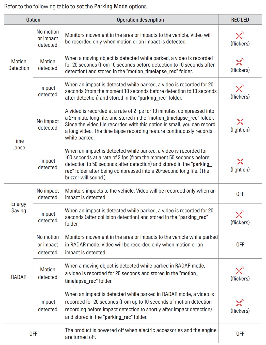

Here is the parking mode types supported by the U3000 Pro from the user manual:

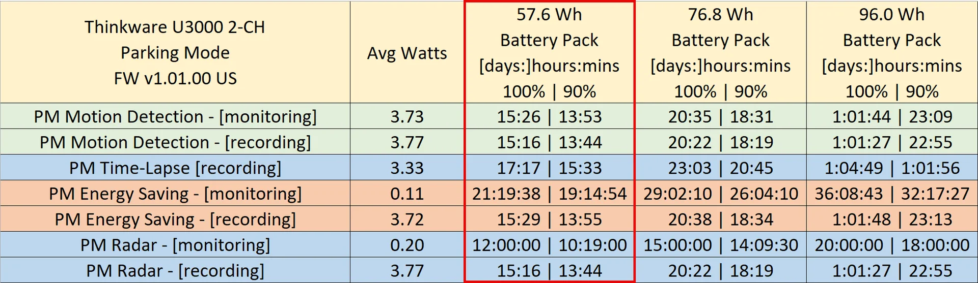

Here are my parking mode time estimates for the older U3000 2CH dash camera. The U3000 Pro power stats should be very similar to the U3000 power stats.
The iVolt Mini BAB-50 battery pack has a 57.6 Wh storage capacity. I've outlined in red the time estimates for that battery pack capacity. The 90% time estimates are likely to be closure to reality since no battery pack works at a full 100% efficiency level.

When a dash camera battery pack is used to power the U3000 Pro, the battery pack will turn on/off the dash camera ACC power signal based on the vehicle's ignition system state [On / Off]. That's why it only takes 30-seconds for the U3000 Pro to enter parking mode after turning off the vehicle's ignition switch. There's no need for the dash camera battery pack to make educated guesses.
Could you recommend any settings that won’t record a fart in the wind? While of course still being effective in radar mode? I’m using the default settings currently. I’m guessing lowering the radar sensitivity from medium default to low could help?
Reducing the radar sensitivity setting reduces the distance from the vehicle that feature should be detecting physical movement. There's a front and rear camera radar sensitivity setting to adjust as well.
The motion setting is greyed out to mid when using radar. What do I need to adjust to tame it down a bit? Or do you suggest just using defaults?
There are two radar specific sensitivity settings:
