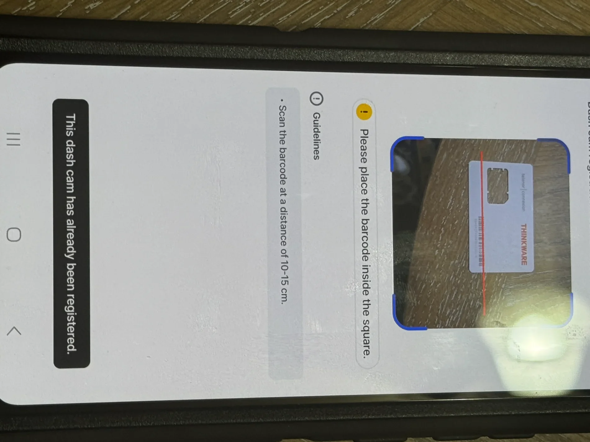

I have the thinkware connected app on my iPhone 16 and I always get the message
that the number is invalid when I try to certify the dashcam. So i tried the app on my wife's android phone and scanned the barcode
the apps says that this dashcam is already registered but it does not log into the cloud services.

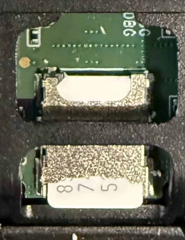

I actually fixed my issue and I’m all good now. I didn’t know that I needed to further extract the micro sized aspect of the SIM card and place it UNDER the metal shield in the LTE module. Once I did so - everything worked!
