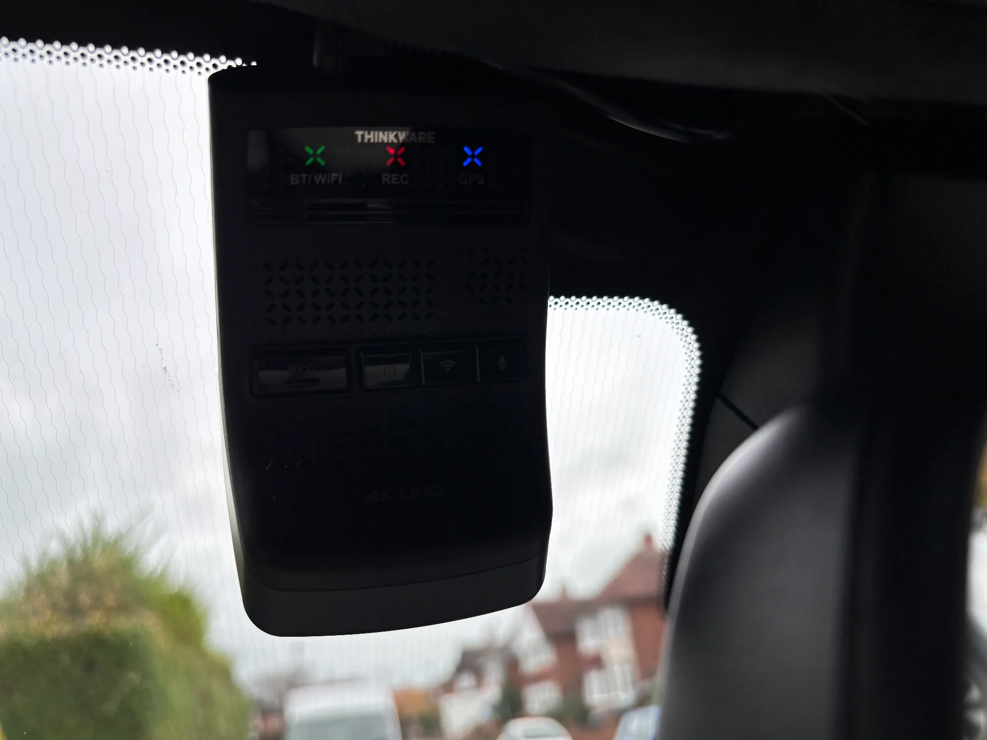

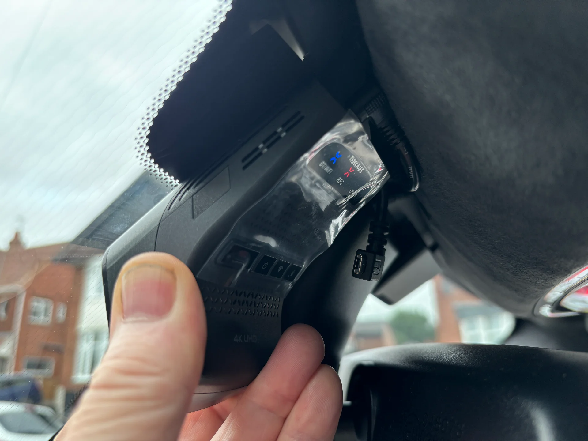

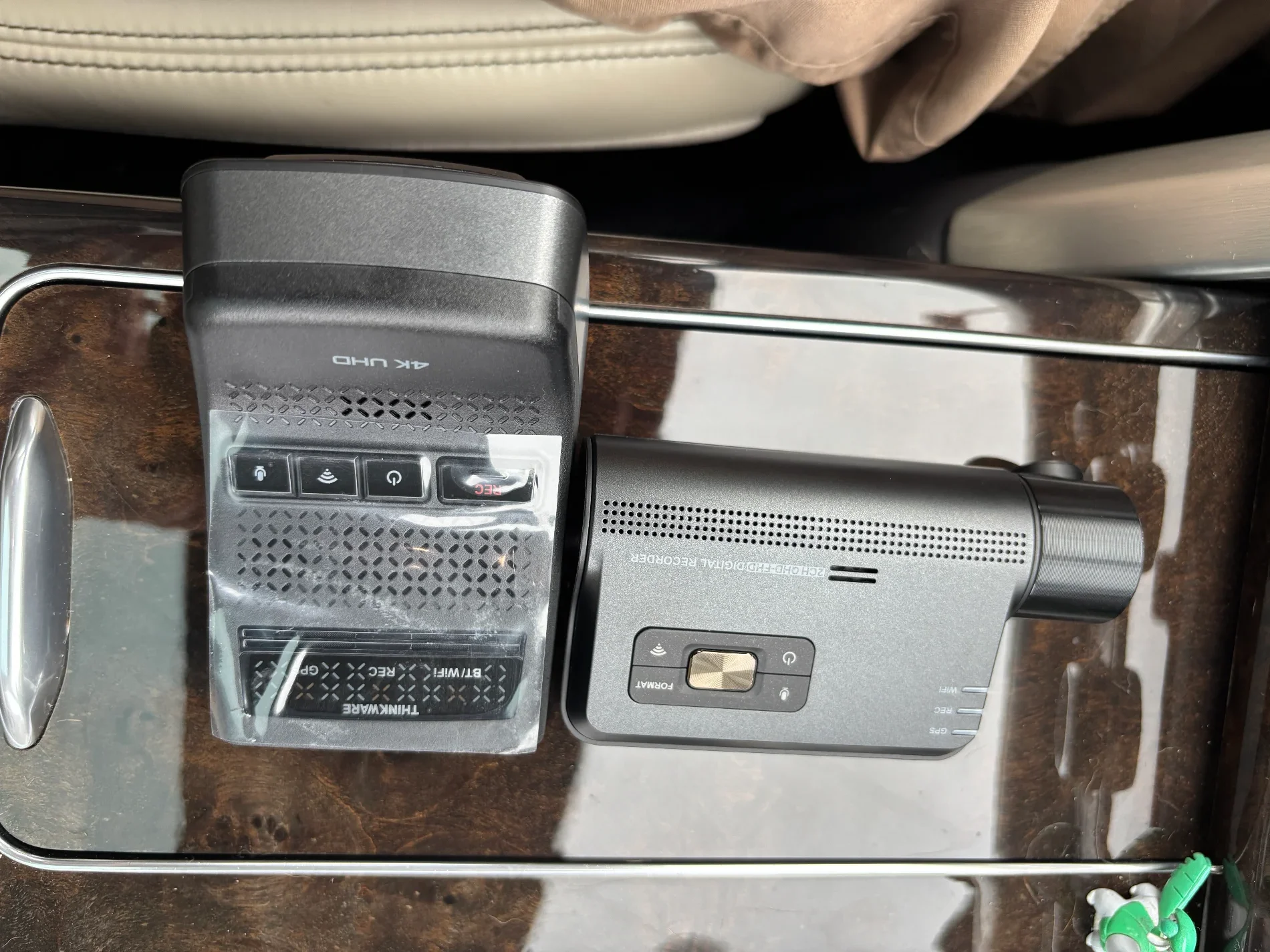

Connections - the Q850 has the connections on the side, with right-angled connectors, giving an unobtrusive mount - something that's important to me, hence part of the reason for choosing Thinkware as a brand, lack of screens and relatively small camera housings. The U3000 Pro has the connections on the top of the housing and the cables are straight, for me, this would mean that the camera housing is further down the screen - the housing is 'in portrait' in orientation, wheras the Q850 is 'landscape.
As you can see, once you add the connectors, it's quite a long camera...
The existing power connector is the same (except right-angled) and is connected to a vehicle-specific harness in the roof console, it works with the U3000 Pro so I bought a short Mini-USB right-angled extension to help shorten the camera profile.

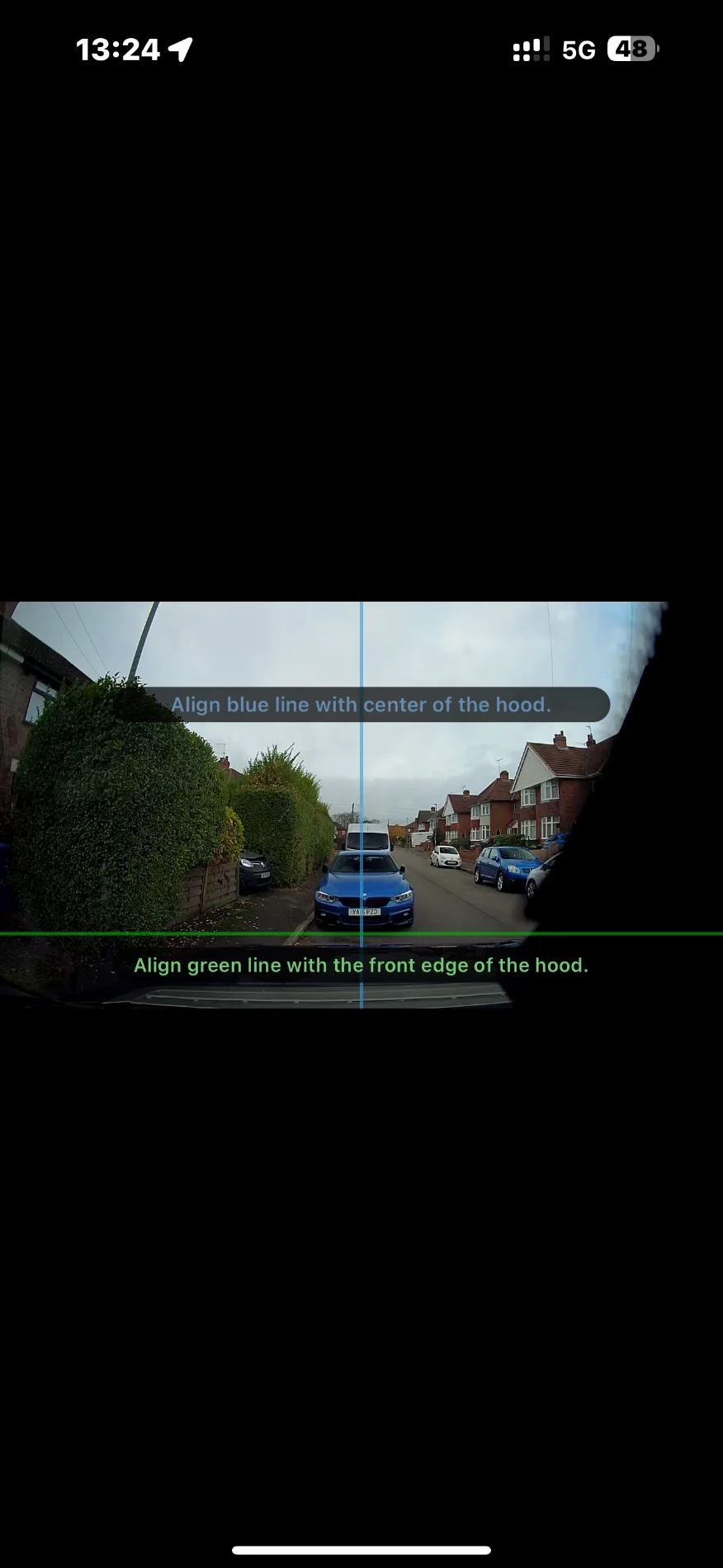

So far, all as expected - what I didn't anticipate however, was just how far from the windscreen the camera lens is - and the effect the mirror mounting frame (which is extra-deep due to also having a camera for TSR & LDW etc. contained in it) has on the wide-angle lens being a lot further away from the screen.
Consequently, I've had to drop the camera down and to the side to minimise (but not eliminate) the intrusion of the mirror housing.
Perhaps something to bear in mind if you like to keep things visually unobtrusive like me.

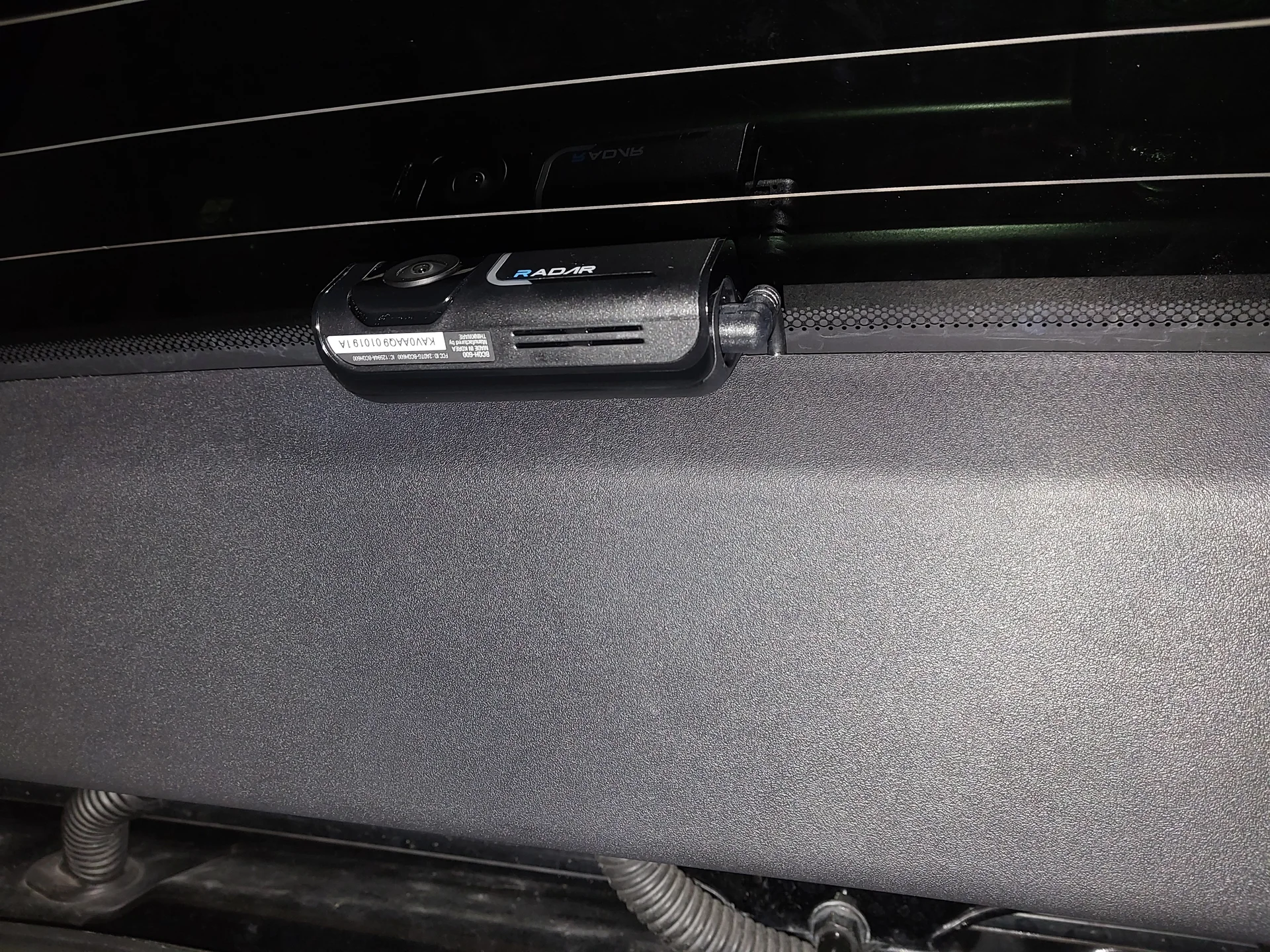

I've run in the cable for the rear camera but in the best British traditions, 'rain stopped play' and I've found an aftermarket circular polariser which I'm going to fit to the rear camera before installing it - the camera housing is curved around the lens but the mounting ring is flat, so I'm intending to fix the mounting ring with epoxy resin ('Araldite') before fitting the camera to the car. Here's the polarising filter.
https://www.ebay.co.uk/itm/162327017535
I'm not going to use the lens hood, the lens housing measures ~16mm but the item description says to add 2mm, presumably as the filter diameter is the outer dimension of the mounting ring.
