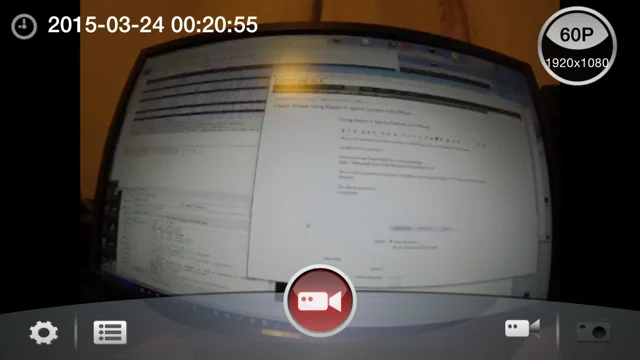

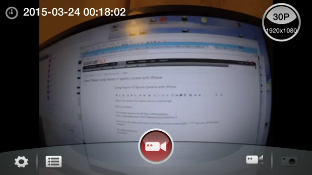

Download an app from the iOS Store called LinkinEyes:
https://itunes.apple.com/us/app/linkineyes/id750726978?mt=8
Turn on your Yi camera and connect to the Wifi connection named YDXJ_******* (the stars will be random numbers)
The default password is:
1234567890
Launch the LinkinEyes app on your iPhone / iPad and it should now connect to your camera and let you view live video and even better change the settings 🙂

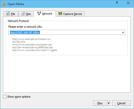

Now normally you can't access the camera via VLC from your PC as it needs certain commands sending to activate the RTSP stream.
So what you can do is connect from your PC to the Yi Wi-Fi connection using the credentials above, launch VLC and do Open Network Stream.
Enter the URL as follows:
Code:
rtsp://192.168.42.1/live
Click play - if it doesn't start playing straight away then just fire up the LinkinEyes app to send the relevant commands over and it should start to play a stream:

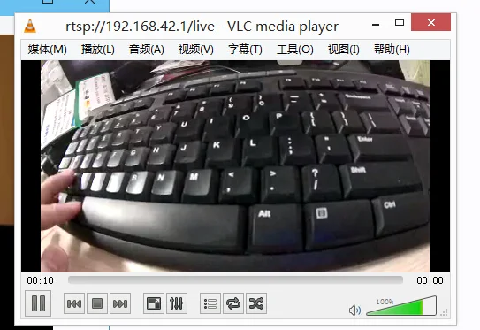

It also work for other wifi cameras, I see some users also use same way on SJCAM cameras, use VLC to play live stream.
Linkineyes seems developed by Ambareallea, but it is not stable when work with SJ5000 plus.
That's good to know thanks Bill 🙂
How's the 5000 series coming along?
Exactly same for SJ5000 plus, same RTSP address.

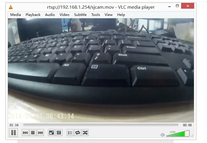

In SJ4000 WIFI, the RTSP url is rtps://192.168.1.254/sjcam.mov, but it only worked for latest firmware.

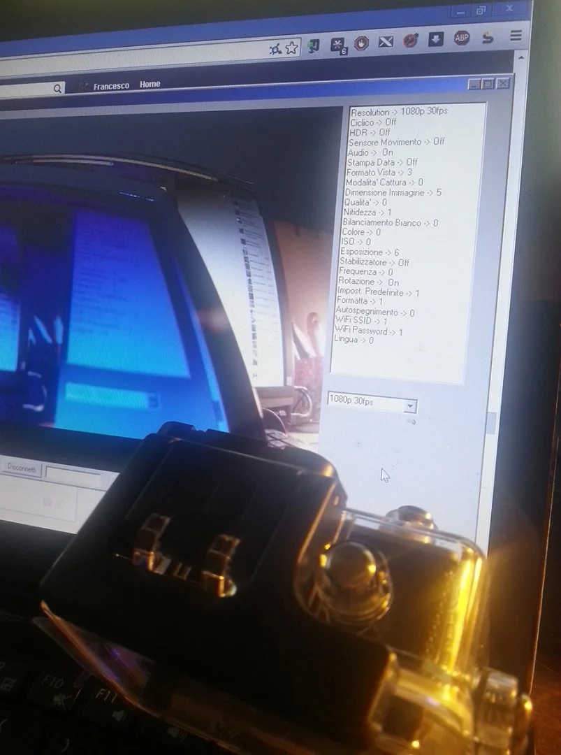

An Italy buyer send a email to me last year, I think he is professional, he developed a pc app to control the sj4000, even he found some CMD like http://192.168.1.254/?custom=1&cmd=3014
