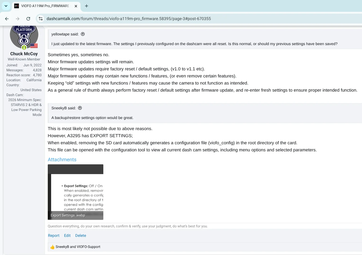

Just a quick question, will there be in the future an option to backup the settings before an update? Or even better, the update won’t reset all settings?
This customer frustration keeps coming up again, again, and, again.
Maybe we’ll get an update to all future user manuals;

Minor firmware updates settings will remain.
Major firmware updates require factory reset / default settings, (v1.0 to v1.1 etc).
Major firmware updates may contain new functions / features, (or even remove certain features).
Keeping “old” settings with new functions / features may cause the camera to not function as intended.

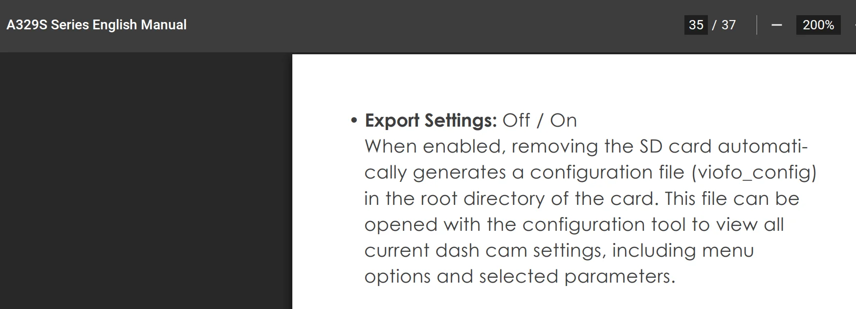

No one likes remembering and re-entering settings fresh.
That’s why VIOFO made “EXPORT SETTINGS” function;
When enabled, removing the SD card automatically generates a configuration file (viofo_config) in the root directory of the card.
This file can be opened with the configuration tool to view all current dash cam settings, including menu options and selected parameters.
(see attached screenshot)

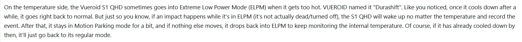

Hello, I would like to ask about the a329s feature.
-Does the viofo a329s turn off to protect itself when it overheats during low bitrate parking mode and goes into low power impact detection mode and turns back on when it cools down? Like the durashift feature on the vueroid s1 QHD. So the device doesn't completely shut down. Because what I observed is that when parking the a329s completely shuts down so there is no protection for the vehicle when the car overheats
