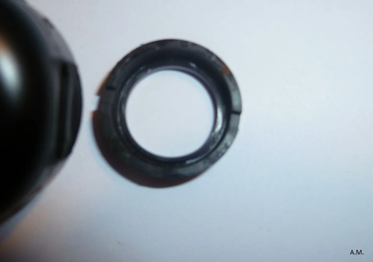

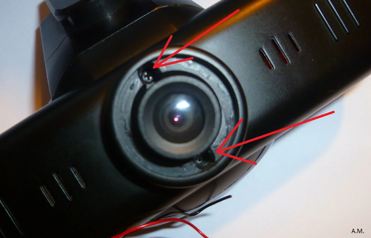

    Thank you rose1! It was exactly as you said! We have to twist the plastic ring. It has no thread. It is simply glued to the rest. The glue is quite easy to overcome. It is not a cyanoacrylate, but a butapren-like type of glue (like the one that is used when fixing shoes).
    There are 2 screws near the lens. It seems that trying to open without unscrewing them will simply damage the camera casing. Best solution to get rid of the lens barrel is to use pliers, vise and some insulation tape to protect from scratches.
    I am posting 3 images that show where those secret screws are. Those are pictures of a modified version with a new battery, etc. My version was overheating so the fan was installed. It had a DOA battery which was common with that model .
    After those fixes it is quite good camera, but the night quality is the main issue.
    Two secret screws and the glued lens barrel:
