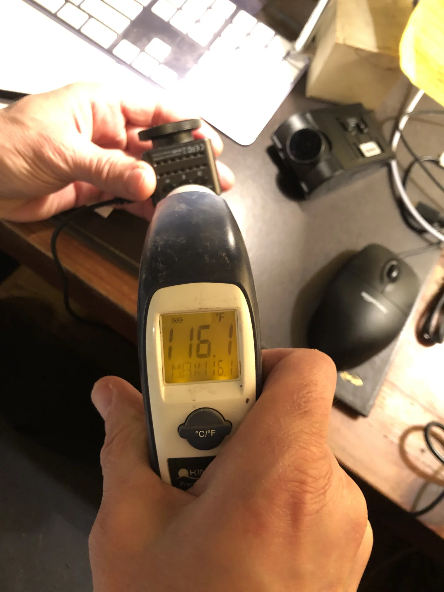

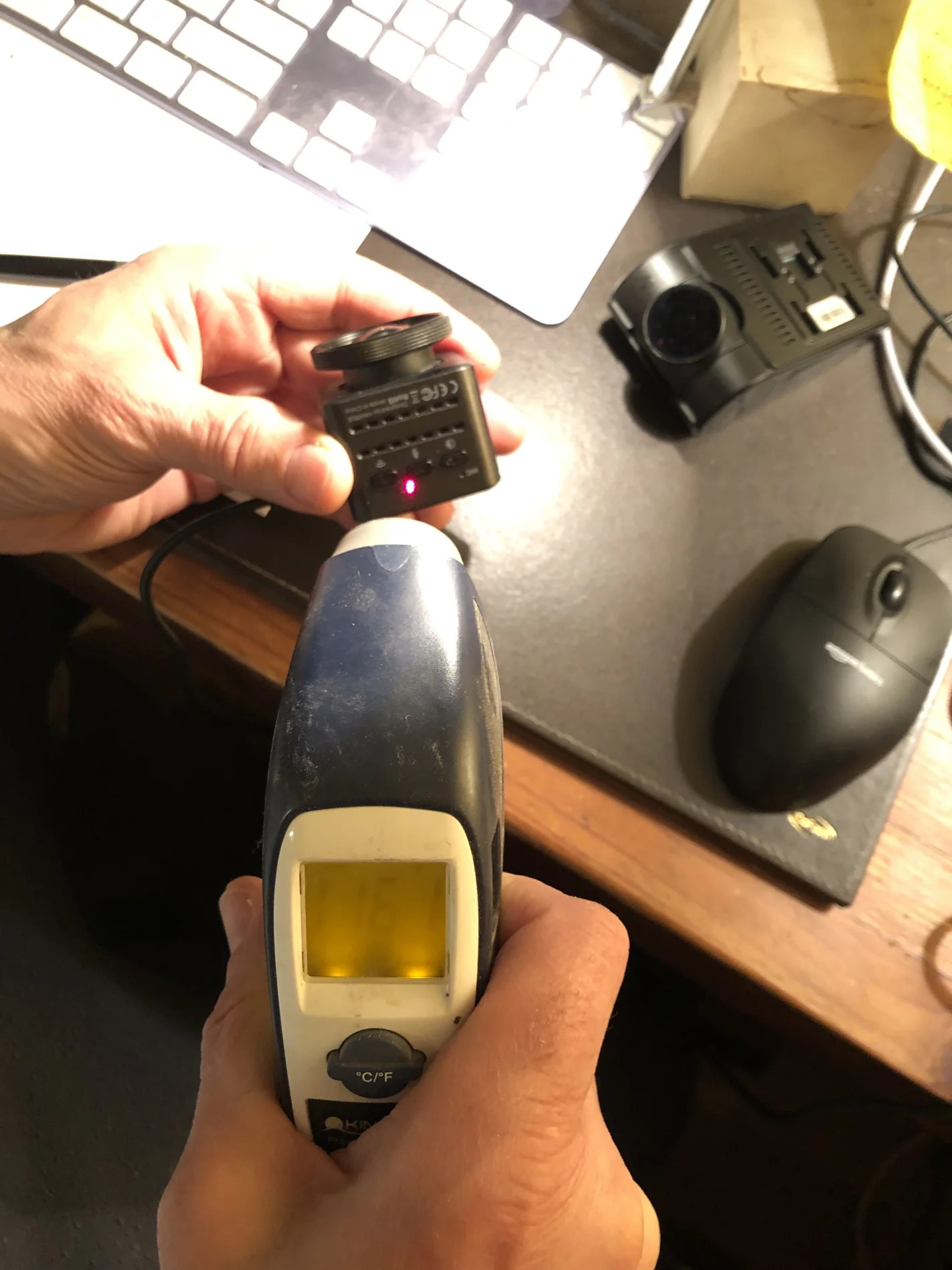

My first thought was "how can a 4K camera this tiny stay cool" so I measured the temperature using my IR gun. Not as good a test as using thermal imaging equipment but its all I have.
I removed the GPS module from both the A229 Pro and E1 Pro and powered each unit for 60 minutes while recording with both cameras at 4K resolution 30 FPS WIFI OFF at an ambient temperature of 69 F (20.5 C).
The hottest temperature (116 F, 46.6 C) I found was on the bottom between the buttons where you see the red dot.
E1 PRO 116F w:dot.webp

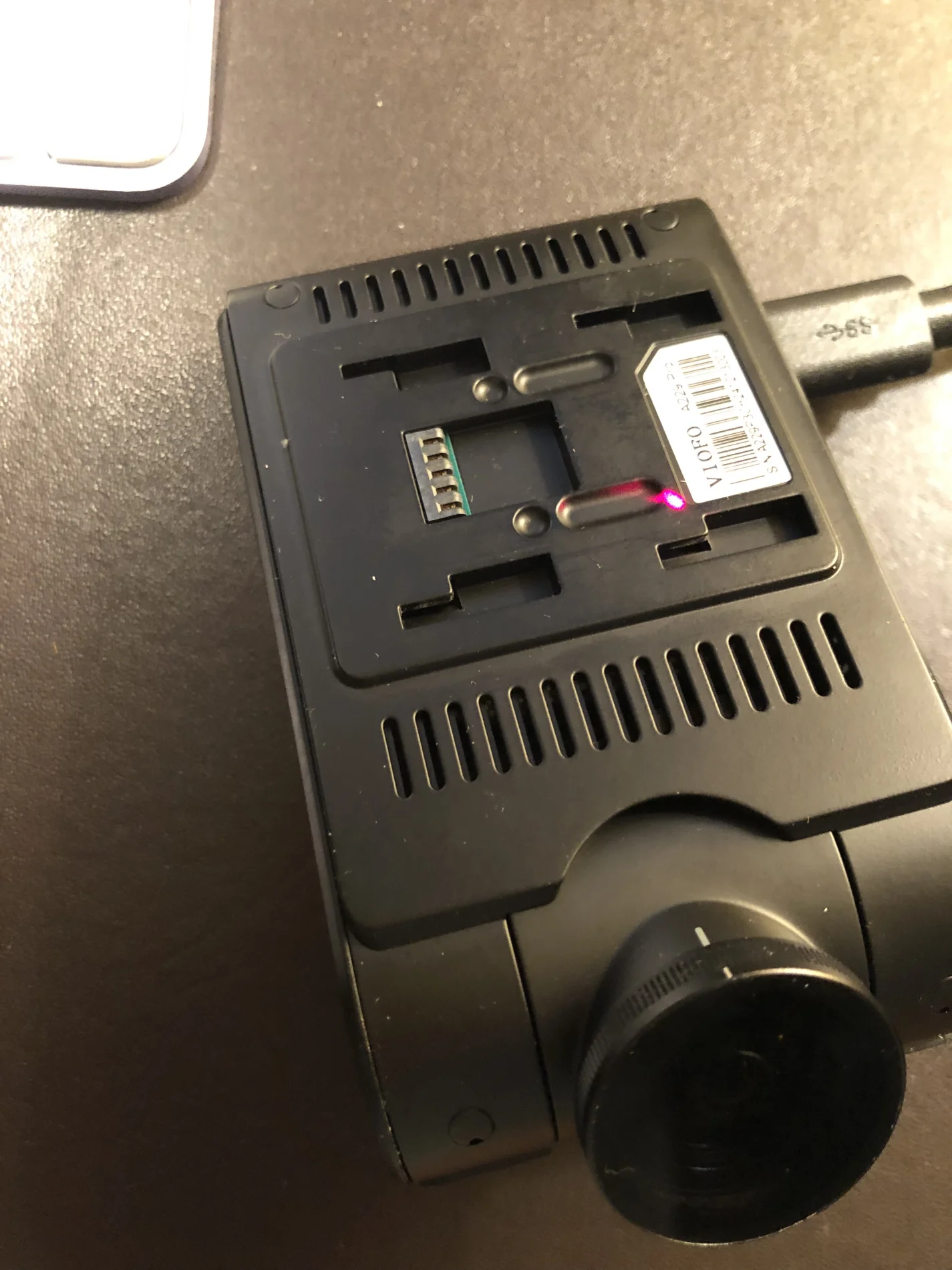

in comparison, the highest temperature I found on the A229 Pro measured around 111 F (44C) on the rear where the GPS Module would be mounted.
Considering the size difference, I'm surprised there was only a 5 degree F , 2.4 C delta. I think Vantrue is doing a pretty good job dissipating heat with this one channel camera (it does not support a rear camera).

Considering the size difference, I'm surprised there was only a 5 degree delta. I think Vantrue is doing a pretty good job dissipating heat with this one channel camera (it does not support a rear camera).
On a hot day, a 1 degree difference is enough to put a memory card into high temperature derate mode, where it stops working fast enough for live recording. A 5°C difference could mean that it fails on 5% of summer days instead of 0.5%. You are working in °F, so the difference is less, but still significant.
I suspect that when mounted in the car, the E1 will cool better than the Viofo, because of the mount design, they may be about equal in real use.

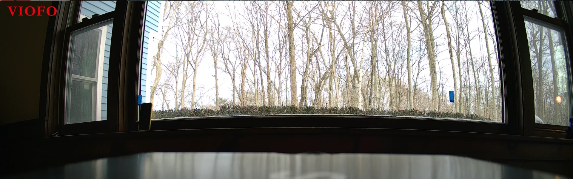

My original plan was to attempt to measure the actual FOV for both cameras but I found it extremely difficult to line up the cameras accurately. The slightest tilt made a huge difference in the view. The best setup is what Panzer had, a ruler in the background. The lighting was not great but my the takeaway is I don't see the wider view on the E1 Pro which I expected considering its FOV specification is 158° vs 140° for the A229 Pro. The FOV appears to be similar.
I do however notice the Vantrue color is more vibrant compared with the VIOFO which appears more washed out and dull.
View attachment 77911 View attachment 77912
I don't think it's color. I think it's exposure. Either the Vantrue has lower exposure than the Viofo or the Vantrue is doing a better job with HDR.
HDR was off in both cameras. The VIOFO has a polarizing filter but the Vantrue does not.
Interesting. Usually the CPL lowers the exposure on the sky when the CPL is rotated to reduce interior reflections off the glass making the sky bluer but in this case the Vantrue shows less exposed sky while the A229 is more washed out. Why did you leave the CPL off the E1 but not the A229 for the comparison?
The E1 Pro did not come with a CPL Filter.
I really should have removed the VIOFO CPL filter for an equivalent comparison but I had so much trouble installing it, I didn't want to mess with it again.
Do you have PlatePix enabled on the E1 Pro? That has an effect on the exposure. Also the two cameras may have different metering patterns, or exposure bias towards preserving highlights or for boosting shadows.
The PlatePix timer was OFF. It does seem like an exposure difference.
