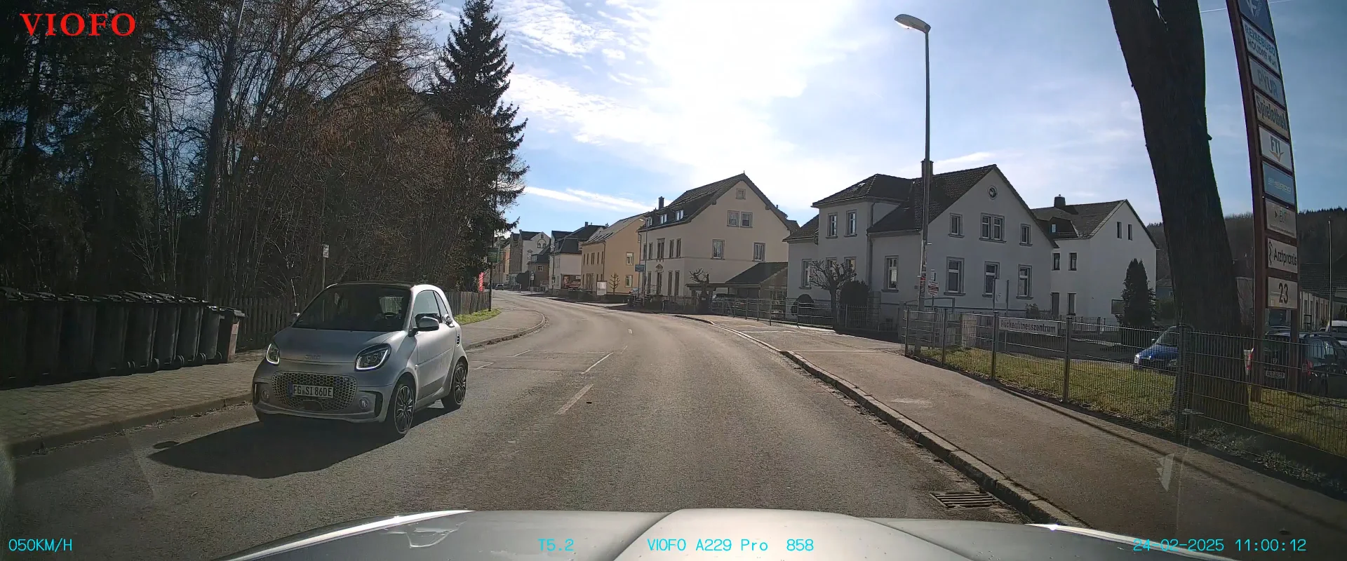

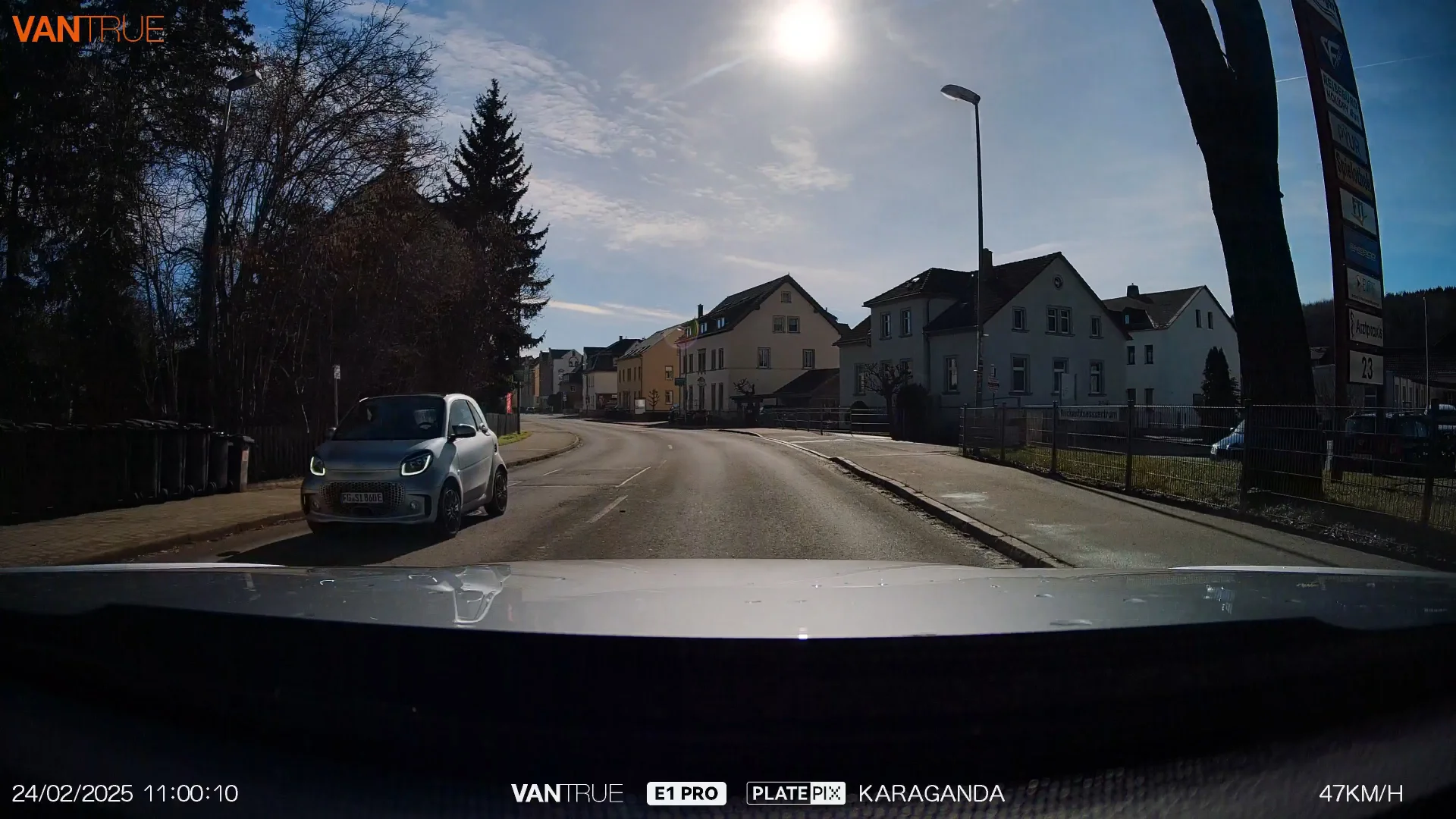

I am not a newbie, but I also made a mistake.
I forgot to set the same resolution on all models.
Viofo is installed near the rearview mirror.
E1 Pro installed on the dashboard.
View attachment 77927 View attachment 77928 View attachment 77929
What is the resolution set to for the A229 Pro? I am guessing 2K. I see 4K displayed in the A329 image. E1 Pro looks like 4K.
How did you mount the E1 Pro on dashboard? Sticky stuff? The way I mounted mine on the windshield its hard to avoid being obstructed by the nearby A229 Pro.
The resolution on the A229 Pro and A329 is 4K 21:9.
On the E1 Pro the resolution is 4K.
Just like you fixed your E1 Pro on the glass.
I have not used the PlatePix feature yet. I assume it's intended to be used to enhance plate readability at night since it's enabled using a timer similar to HDR.
I decided to test the new feature during the day.
I haven't reached night yet...
In post #28 you said you did not set the resolution the same on all models. I thought you were referring to the pictures in that post but evidently not since they are all 4K.
I meant the photos in that post: Viofo has 4K 21:9 resolution, while E1 Pro has 4K 16:9 resolution.
I think you need to adjust the lens angle on both models the same.
Exactly! You want to have the same "horizon line" in each camera as this will impact the exposure and the resulting image quality. When one camera is pointed at a bright sky, it will darken the exposure. Conversely, if the other camera is pointed at a darker road, it will lighten the exposure. I think the Vantrue camera has a way to display "cross hairs" in the image (using the app) so you can better aim at the horizon line to balance the relatively dark foreground with the relatively bright sky.
