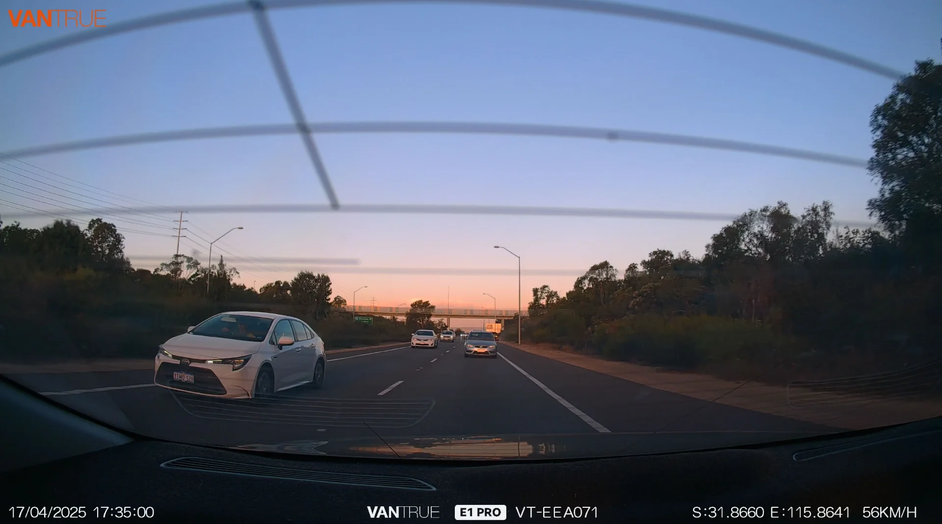

Plate capture comparison between the Vantrue E1 Pro and Viofo A329:
Just performed a quick comparison between the Vantrue E1 Pro and Viofo A329, at dusk. Both cameras had no CPL filter attached, and bear in mind that my vehicle has a 85% tint on the rear windscreen. Vantrue's PlatePix was also not used as this would have reduced exposure levels in the image. Recordings were performed at their native highest resolution of 4K30fps and 2K30fps respectively, with bitrates of 32MB/s and 27MB/s. Audio was better on the Viofo, but as they have the same bitrate, I am putting this down to the superior sampling rate of 48kHz, compared to 16kHz on the Vantrue. @Jeff_Vantrue
As you can see below, the plate capture on the Vantrue is admittedly superior, due to the increased video resolution available to the user. I also do prefer the image processing of the Vantrue over the Viofo. What can be noticed though is that also due to the increased resolution, the text on the green highway sign in the background is able to be discerned on the Vantrue, but not on the Viofo.
Presumably you used the A329 2K rear camera for the comparison with the E1 Pro 4K single channel, not the A329 4K front camera?
Looking at the images, I can't see much difference in plate readability between the 2K and 4K, however this website has resized the images to 1920β€ŠΓ—β€Š1069 and 1920x1077, so I'm seeing them at virtually the same resolution.
Having 3x the resolution on the audio definitely makes a difference, a big difference for those of us with good ears, even without extra bitrate. The microphone setup can also make a big difference though, especially to noise levels. Hard to tell what it is that makes the differences, although testing with and without a lot of road noise can give clues, ie stopped and high speed testing.

Correct, It was updated in the other thread but not here but that's exactly the camera, the A329 rear one
That explains a lot if you can't view the screenshot, will keep that in mind for next time.
