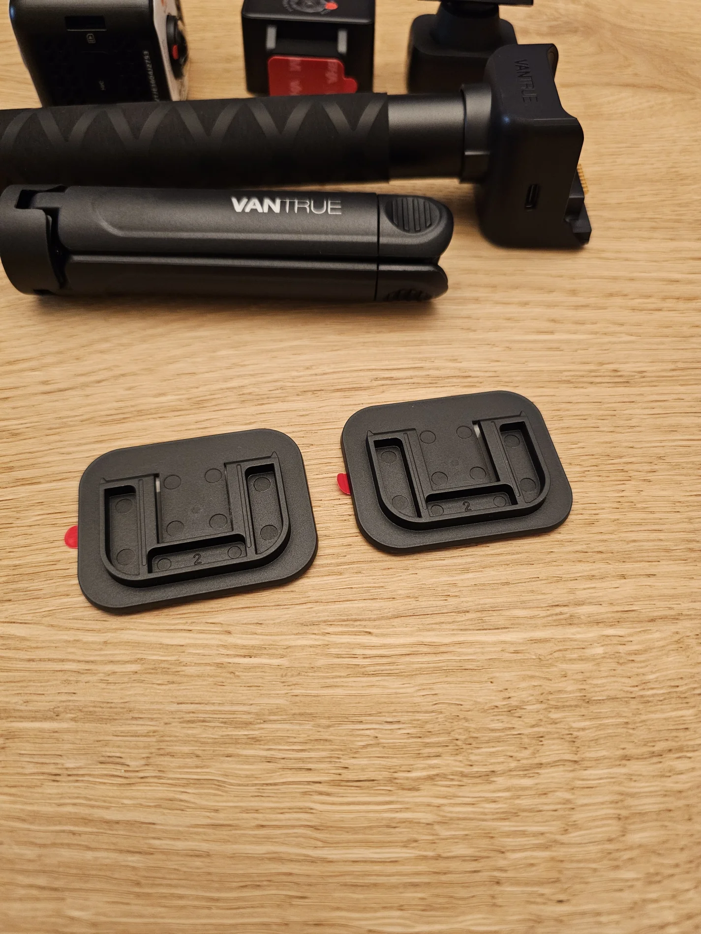

There are two sticky mounts included for the GPS module.
A suction cup mount would be awesome for rental cars and to allow a quick swap. Apparently the suction cup mount is in development.

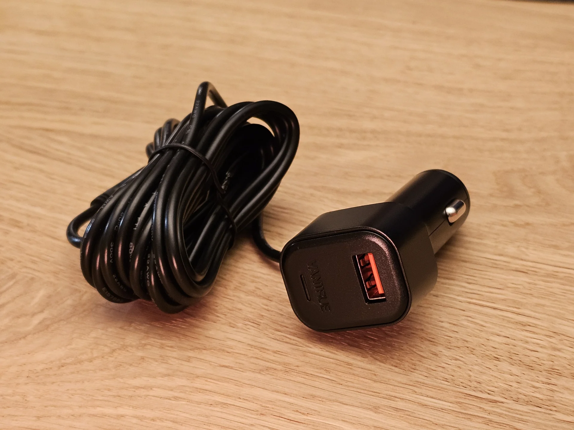

A simple USB A to USB C cable is also included.
I did however expect USB-C instead of USB-A on the Charger. We have 2024, nearly 2025... Please change this to USB-C in the future.

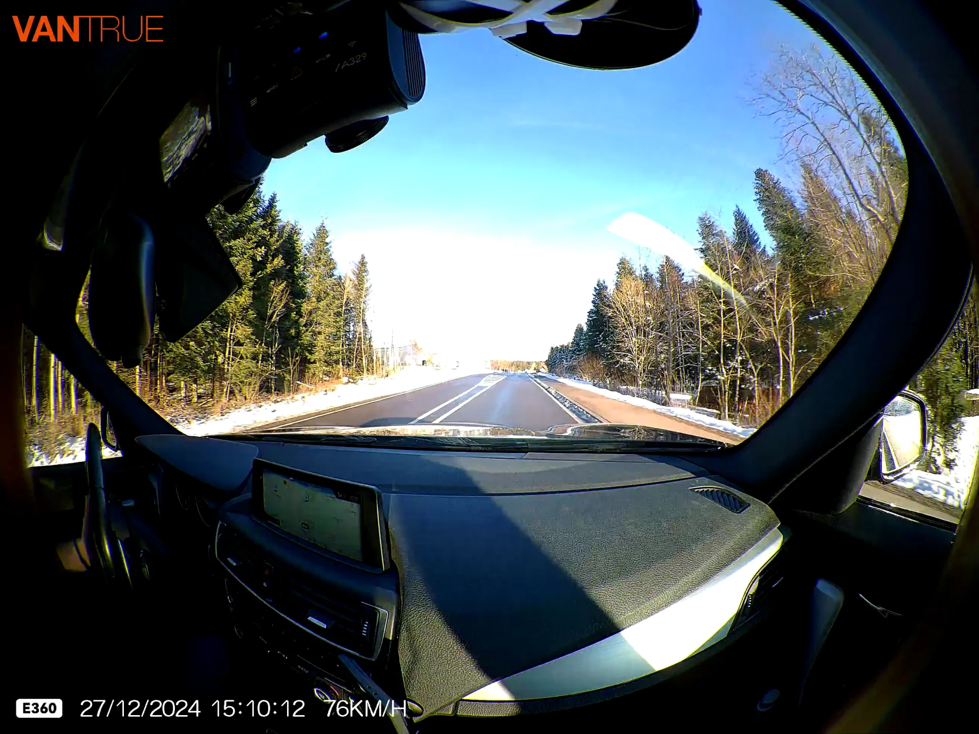

5.2K Panoramic View 30FPS:
On the left side of the image is a noticeable stitch. The steering wheels is also affected but not that bad.

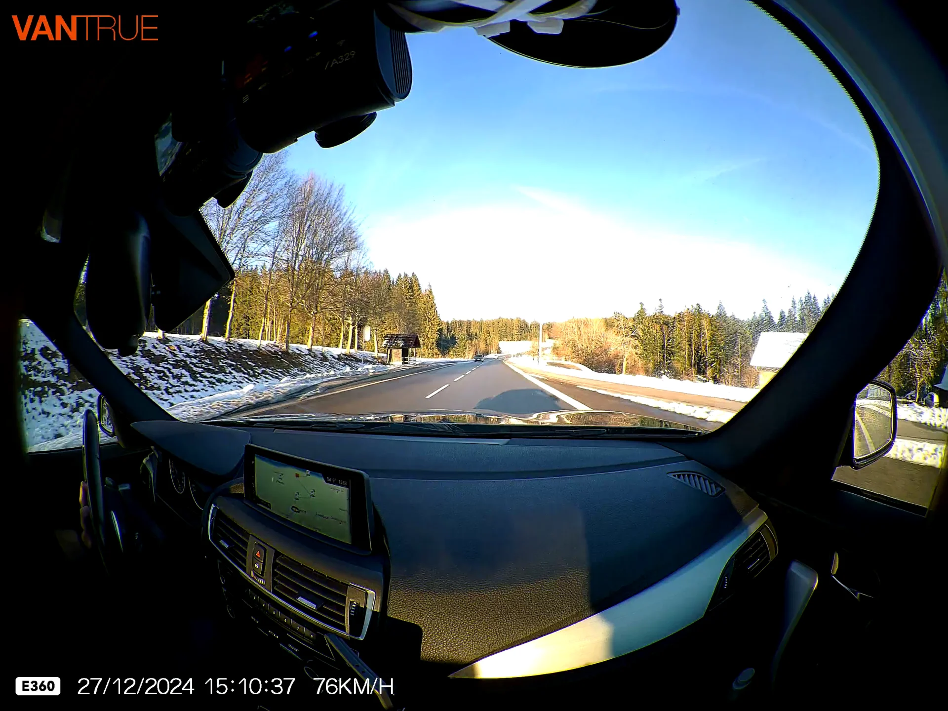

The camera does seem to struggle to find the correct position to stitch the image.
Here are some examples where the image does not add up correctly.
The car is parked. See the difference between the trees next to the A-Pillar? (click on the image and the cycle between both to better see the differences)
The same thing again, the stitching changes noticeably within one second. (click on the image and the cycle between both to better see the differences)

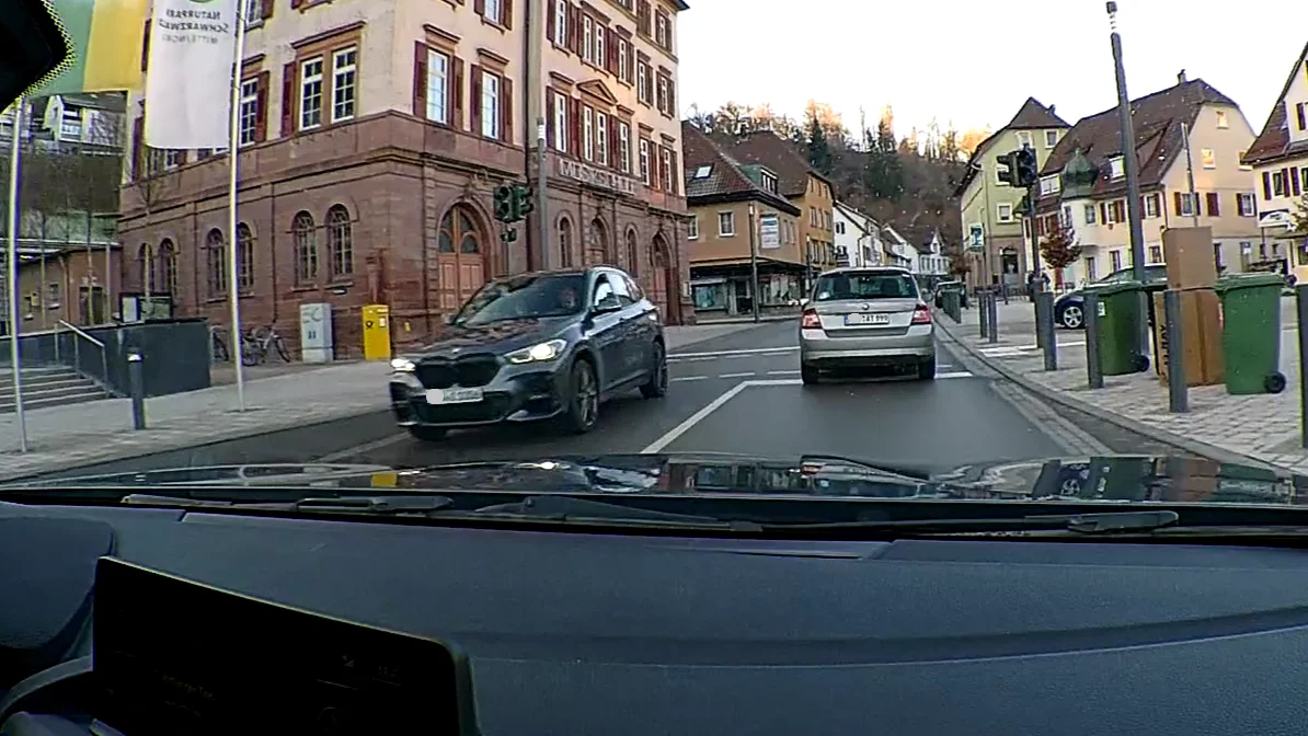

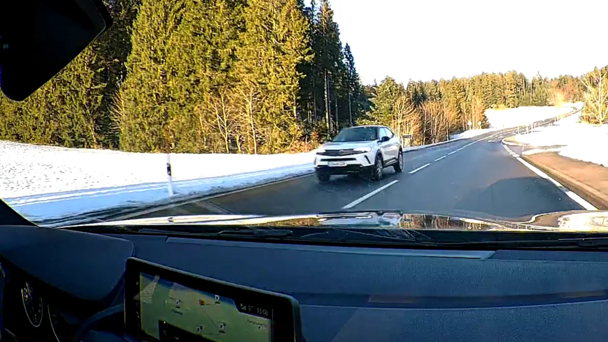

Plate of the car in front can be read.
Oncoming BMW not. I tried every frame.
Plate capture of the car on the side and in front is possible.
Also a nice view out of the side mirror.
