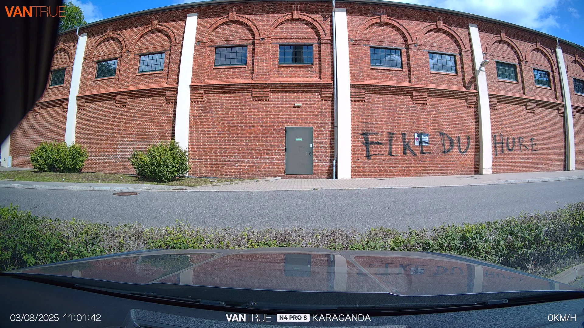

Vantrue N4 Pro S vs Viofo A329 Front Camera vs Telephoto Camera
N4 Pro S
A329
Telephoto
There are idiots everywhere, especially now.
Some time ago the wall there was clean.
Completely agree, I just couldn't resist to smile and reply after I translated it with Google translator.
This is the best place to check the lens for out of focus. 😉
Interestingly, when I look at DCT videos and screenshots from reviewers, I always try to find a brick or tile structure or something similar with small details to better assess the overall image quality.
The Vantrue's daytime screenshots and videos look really good, but the Viofo 329F still looks better/sharper to me.

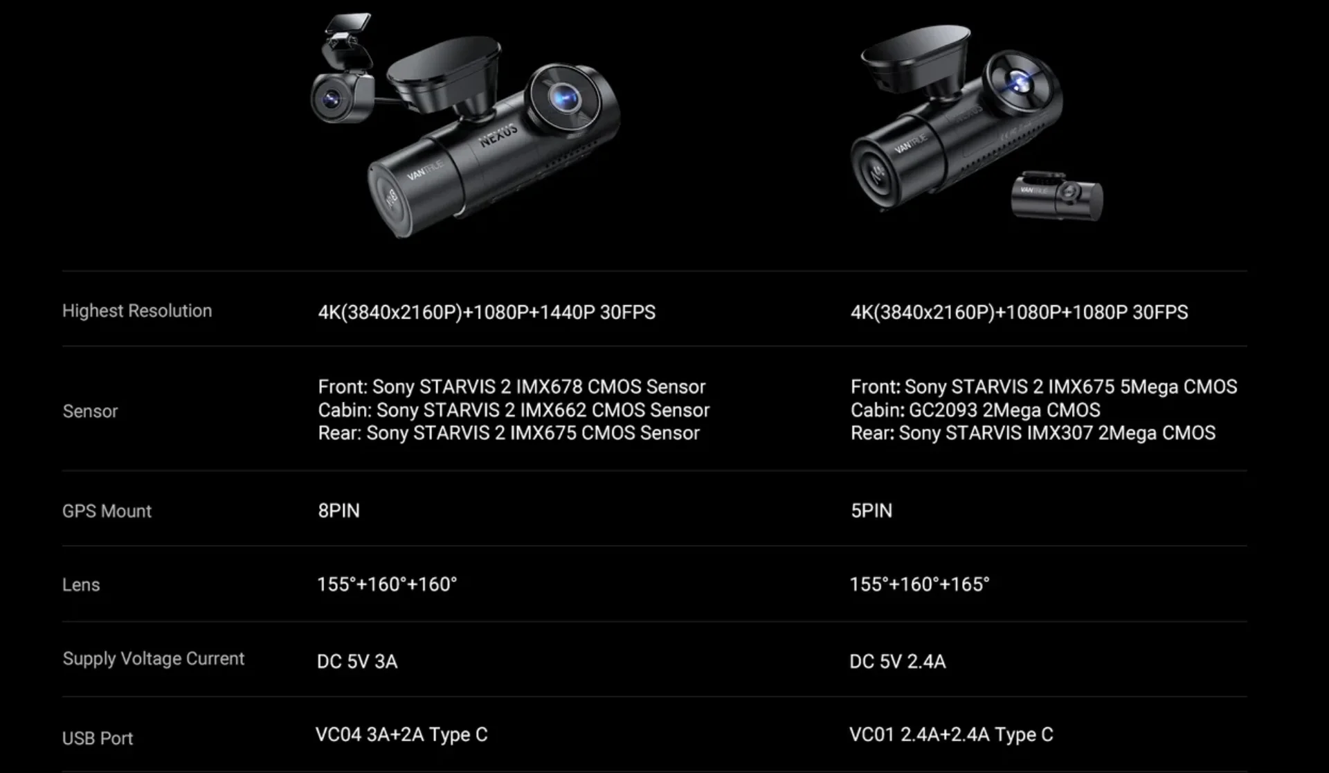

maybe n4pros front =n4pro?
oh i mean what different about n4 pro s front camera between n4pro front camera
The N4 Pro uses a barrel shaped rear camera. A much better design than the Extending Camera found on the N4 Pro S. I raised this concern to Vantrue, because the extending mount is subject to vibrations. A barrel shape is far sturdier.
Here are the technical differences:
the front camera of n4pro use sony imx678 also same as n4pro s
@indigo
The front cameras use different sensors. N4 Pro S uses IMX 678. N4Pro uses IMX 675. Even rear camera uses a different sensor on the N4 Pro S and N4 Pro. Please see screenshot above.
